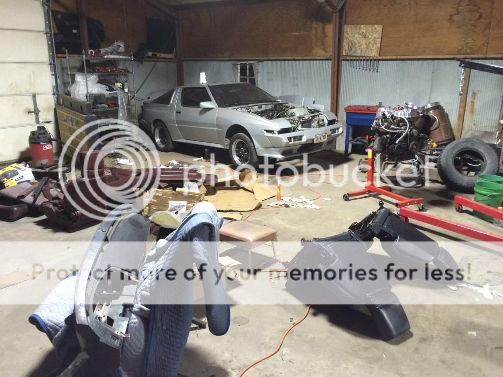

Well over the past couple weekends I finished swapping in my black interior finally (I dyed a lot if my maroon and reused it. But now have pieces from 5 different cars making up my interior ha). So now I will begin my engine tare down and rebuild and also repaint my engine bay.. Going to be nice to have a clean car with a built block next spring :D
