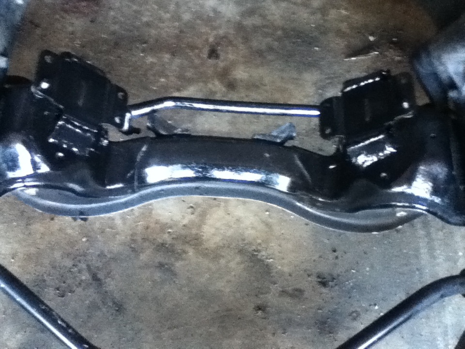

Hey guys,
So I am almost done pulling the 2.6 and accessories out of my Conquest. As soon as a corral the rust, I want to drop a carbureted 302 into it. I have seen the threads on how the mounts fit, that you have to fab up a tranny cross member, etc. But I haven't seen anything on what has to be done to the suspension? Do i have to beef it up or...?
