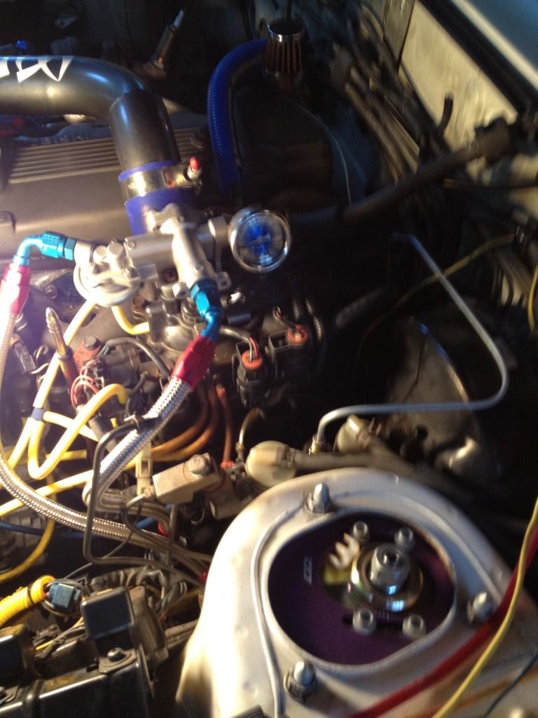

Busy Sunday , got a pile of BS (ABS that is) out of the Quest, pretty simple and it cleans up the engine bay
think shes ready to head to OC next week

I'm sorry to tell you this, but you have your camber plates on the wrong sides.
really, how should they be, i was sure they were marked when i put them on...

Posted 07 May 2012 - 04:50 PM
the camber adjustment should be parallel with the axle line. If you adjust them as is, it will affect the toe of the wheels.

Posted 07 May 2012 - 05:11 PM
thanks Tech i would have never known.. first suspension project, i had it aligned the other day too, will it urt if i keep it like this for now?

Posted 07 May 2012 - 05:39 PM
If it's aligned alright then it'll be fine until you can afford the time/money to get it done again after switching. If it pulls one way or another or has some other abnormal affect on steering, or odd tire wear then maybe sooner is better.
Sorry to detract from your post anyway. How's the fuel pressure when it's running?
Thanks for picking that out, i honestly wouldnt have known, and no one else said anything ( good eye) im learning by my mistakes, never messed with suspension , did it all myself it was a good experience... all i will have to do is swap the assembly's,right? ive had it  apart quite a few times lately, so im used to  it lol, if i did that now do u think i would have to get it aligned again, if so im gonna wait for a bit... it actually rides great though
i have alot of NOOB mistakes with this car, and ive owned her for 12 years
Fuel pressure running 40 ... i hope thats good :)

Posted 08 May 2012 - 11:06 AM
Yeah, if you get 'em swapped then the alignment should be checked again, perhaps the place that did it will fix it for free if you tell them what the deal is, and it was only recently. 40psi is good!
