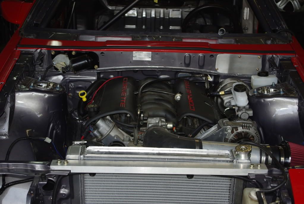

Mustang cobras aren't hydroboost. I have a cobra master and (vaccume) booster on my car due to fitment issues and it works great. The booster is smaller but thicker thana stock quests.
