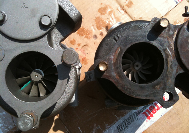

Indeed. The two wheels are totally different animals. I just replaced a TD05-18G with a TD05H-Super16G, take a look at the images below, the exhaust housing outlet is about 1/2" bigger than the TD05. The TD05H wheel dwarfs the TD05.
TexasQuest, the standard TD05 18G is a fun turbo with a little more up top than the Super16G has, but the differences are not major. It's about as big as you can go with a TD05 compressor housing and the lag will be more noticeable. I ran one for a lot of years, but I prefer the Super16G, although I run the upgraded the exhaust turbine to a TD05H and it's like Jeckyll and Hyde. With an EVC this thing comes on so hard it can outrun your fuel so you need to have the car sorted correctly.
I got mine from http://www.miketurboinc.com/
There are also Starion TD05 20G's out there like the ones CNM used to sell. They have the same/similar rear section but have the big TD06 compressor wheel and housing. There are also a lot of other oddball ones out there, I used to have a T04/20G with the T4 flange, ebay junk.
