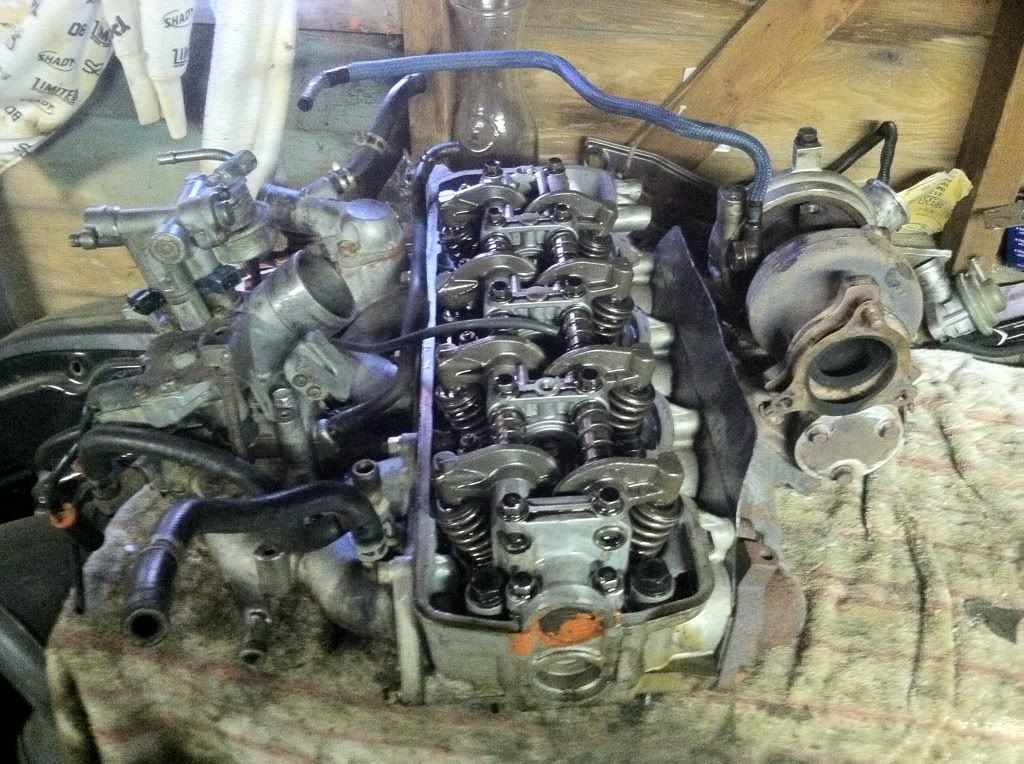

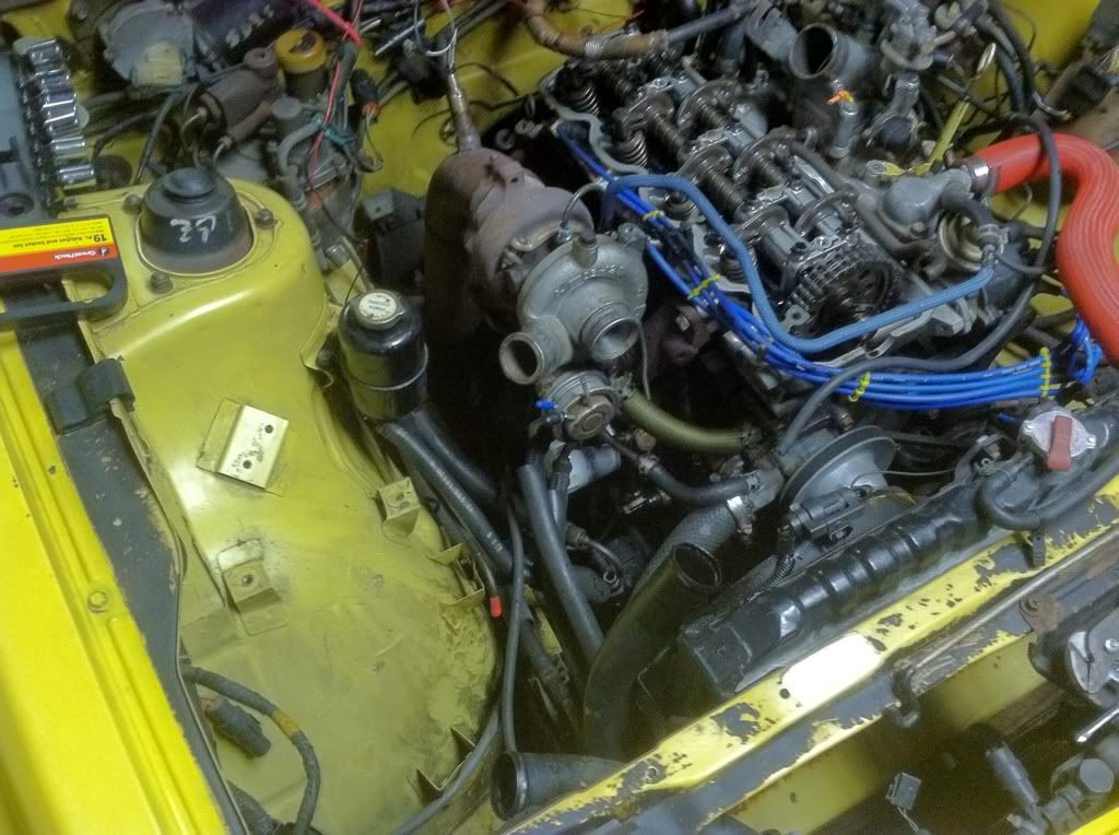

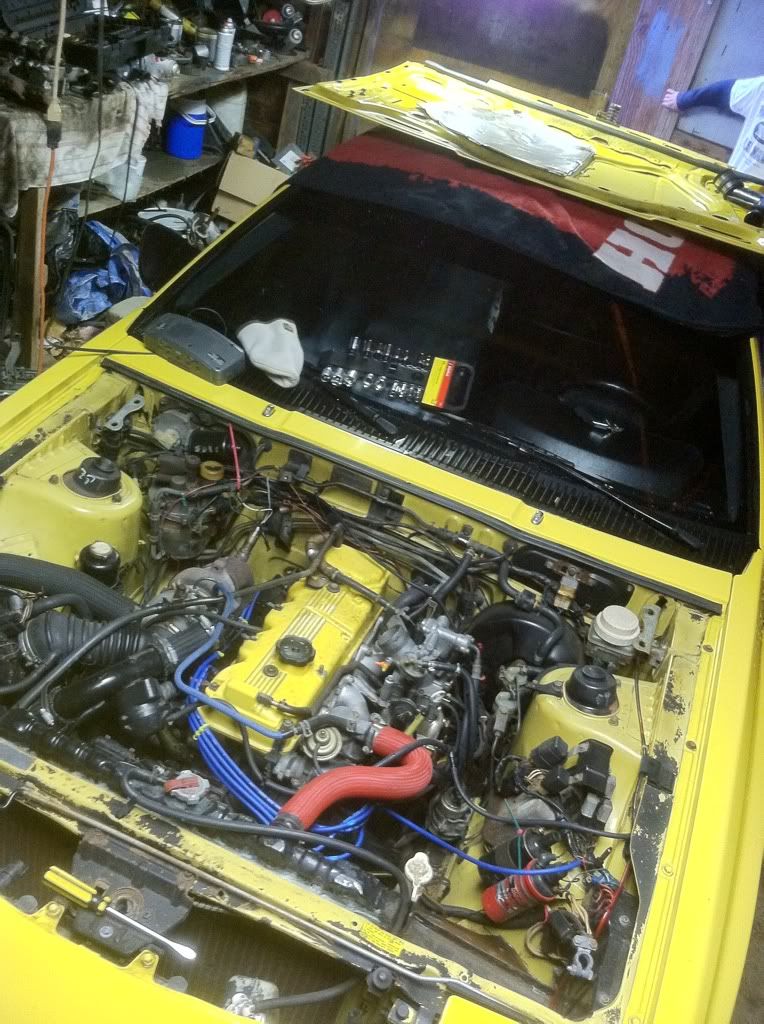

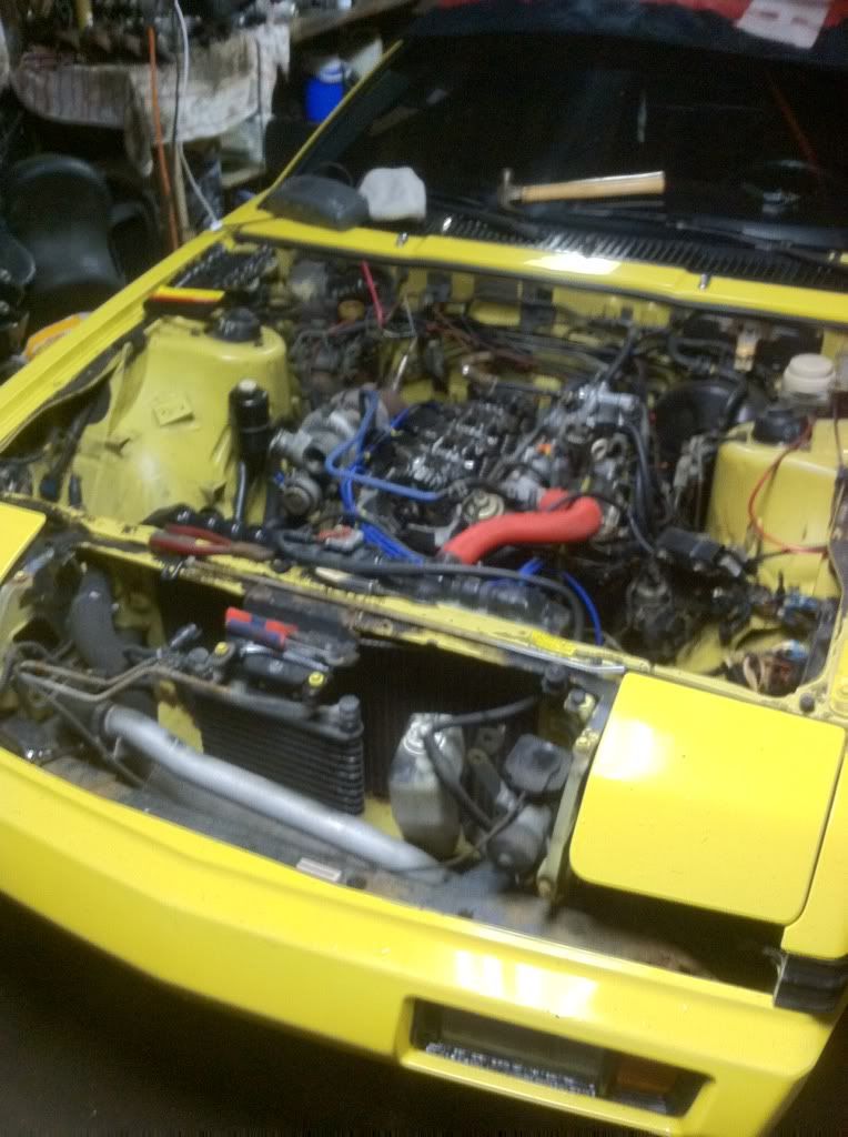

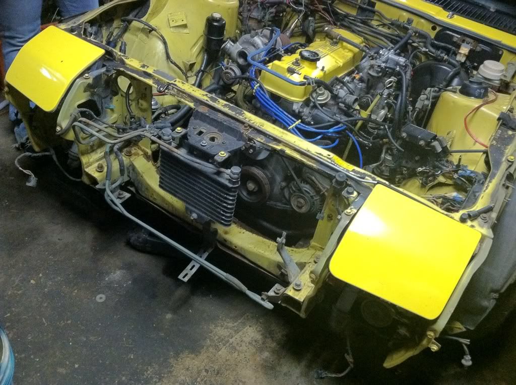

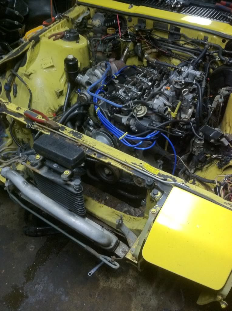

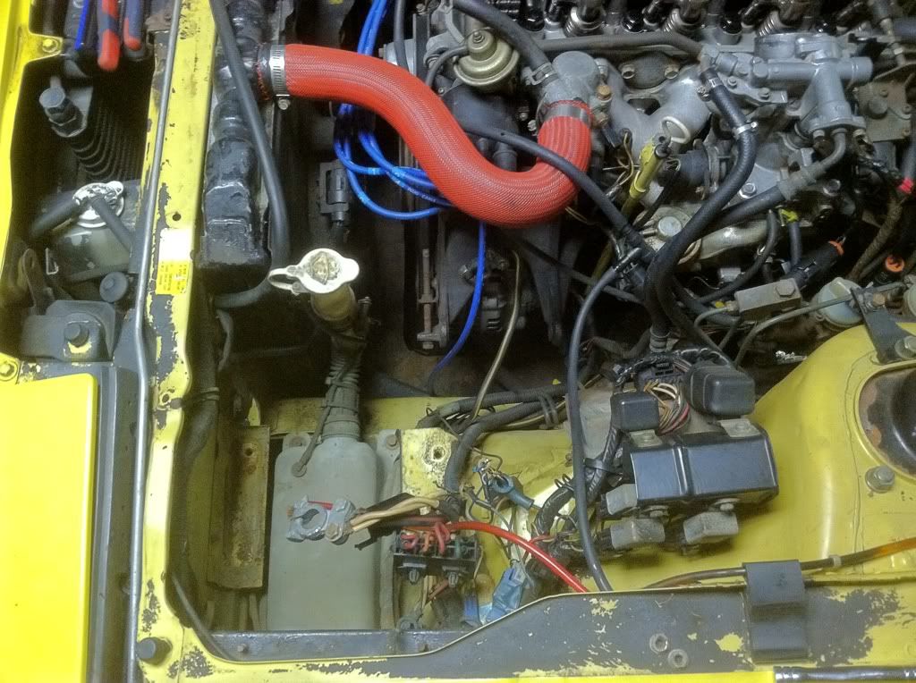

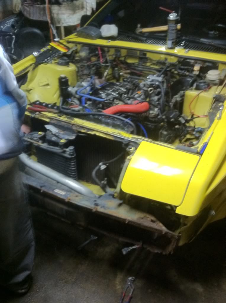

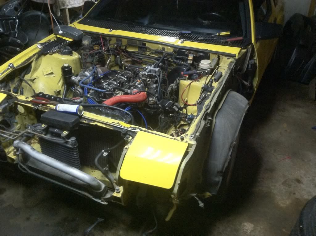

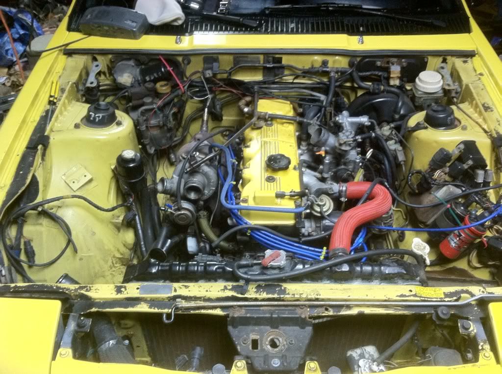

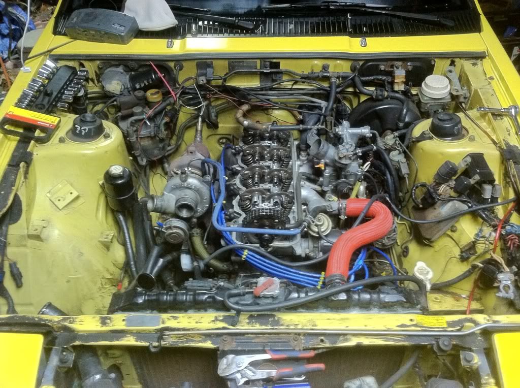

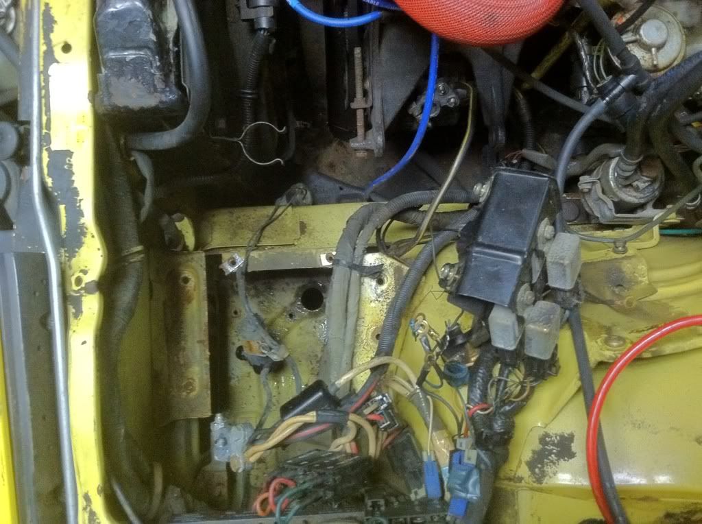

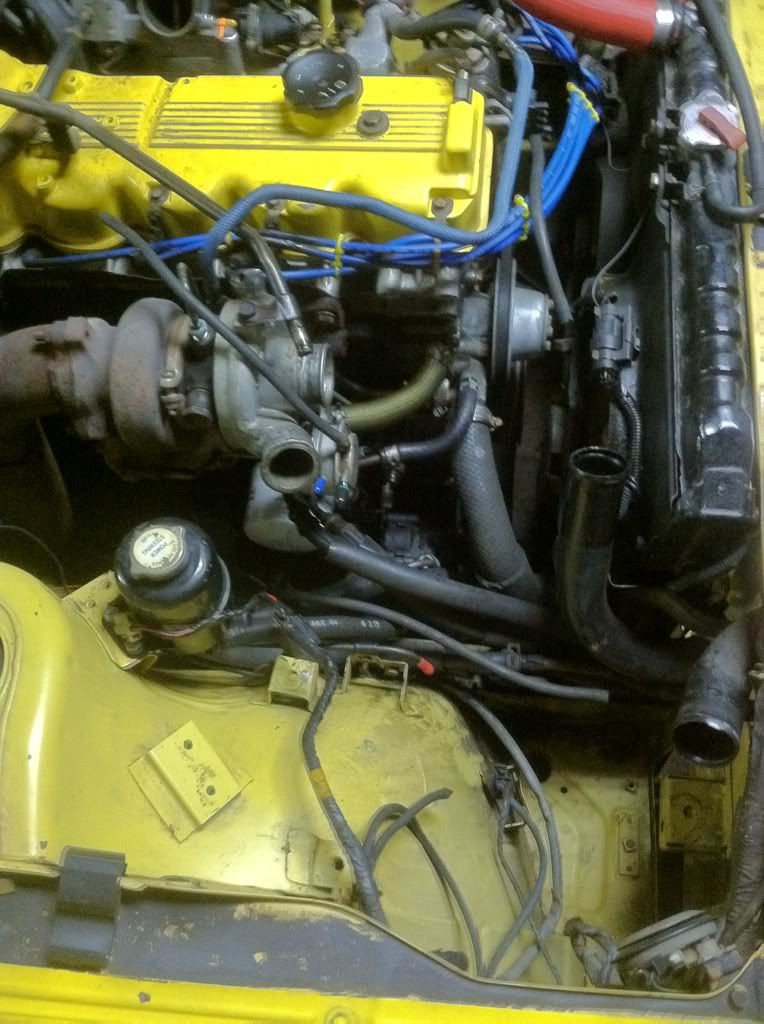

Ok,  not sure if this is the right place for this but its gonna be my build thread/restoration thread.  Im currently in the middle of pulling the engine and trans out of my banana.  Im going to be replacing the frame rails, swaping to a manual, head studs and new gaskets, wire tuck, and paint the engine bay.  Im also going to be swapping my dash out since the previous owner decided it would be cool to drill three holes in it to mount gauges.  Im getting a five speed parts car.  Im also going to swap the dash harness since the previous owner hacked it up when installing the gauges.  I have already taken the hood, fenders, header panel, radiator, intercooler, head, intake, turbo and manifold, and a few other things off of the car.   I plan to pull the block and auto trans out some time this week.  When i bought the car the kid told me it was mildly built engine.... I never really believed him tho,  because it ran like hell.  But i put new injector clips, 02 sensor, 3 inch turbo back straight pipe, cleaned the k&n filter, shift linkage bushings on the trans, new plugs wires and dizze vacume advance along with an msd coil and rebuilt the tb. And the car actually ran very well.  Once i fixxed all the lil stuff.  Well saturday after noon i decided to start getting the banana naked and ready.  Well i took a bunch of pics so i'll post them in here also

And this is what she looked like befor
Other then the wheels are no longer black they are working on getting polished slowly,lol

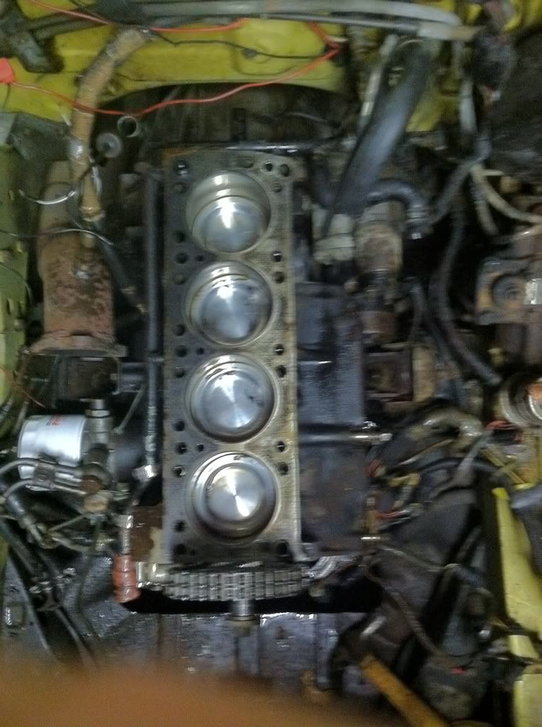

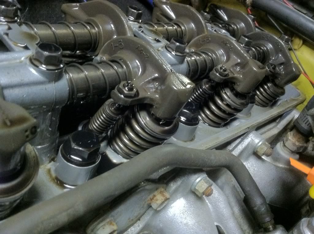

He wasn't totally lying to you about the mildly built motor ... those pistons should have markings on top of them if they are stock, and they don't, meaning you have aftermarket pistions.

Yea,  i have another thread posted also trying to see if anu one can identify them or tell me how to find out what they are.

Unfortunatley you'd probably have to take them out and look at markings on the sides.  If the car was running strong and you had good compression, like you said before you started this, I wouldn't pull them.  I'd just leave them alone.

if you pull the pan, you should be able to see what they are on the underside.  Thats where mine were stamped  (JE's)

Ok.  Thanx for the heads up.  I'll pull the pan and if i cant tell i guess i'll just leave it alone and just build the block that i'll be pullin from the parts car.

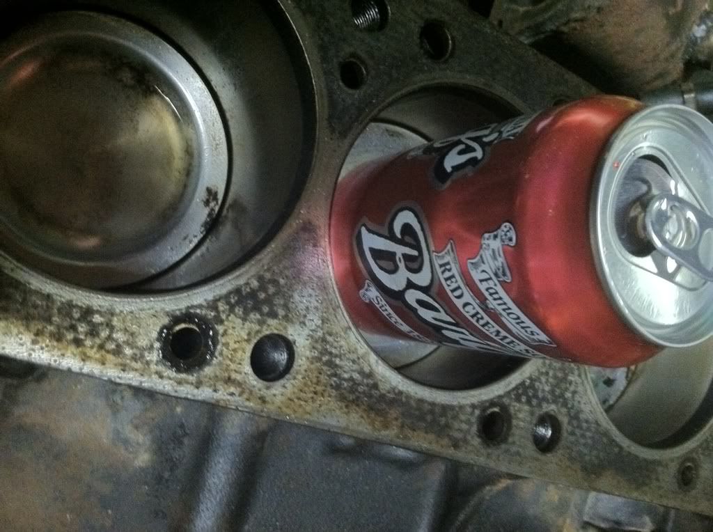

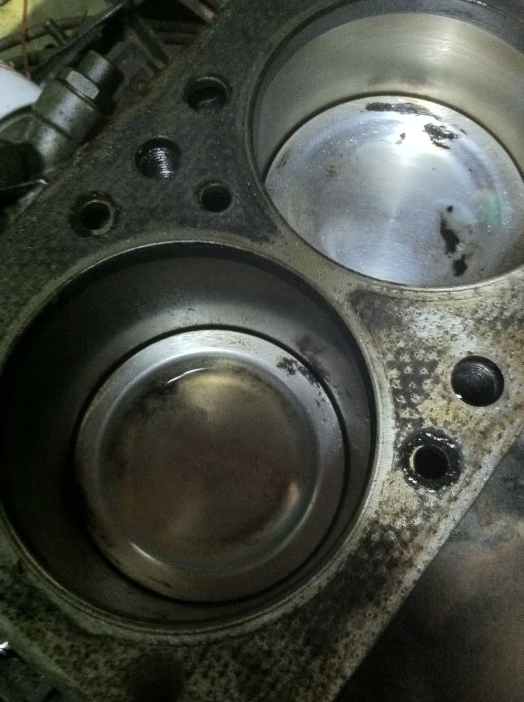

Ok guys so the cylinders are 90mm.  Any one know what the stock is?  Trying to figure out if and how much it was bored over.

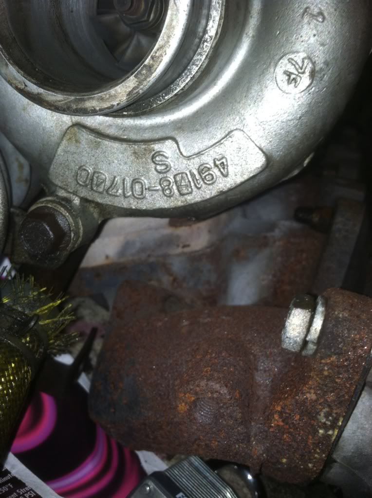

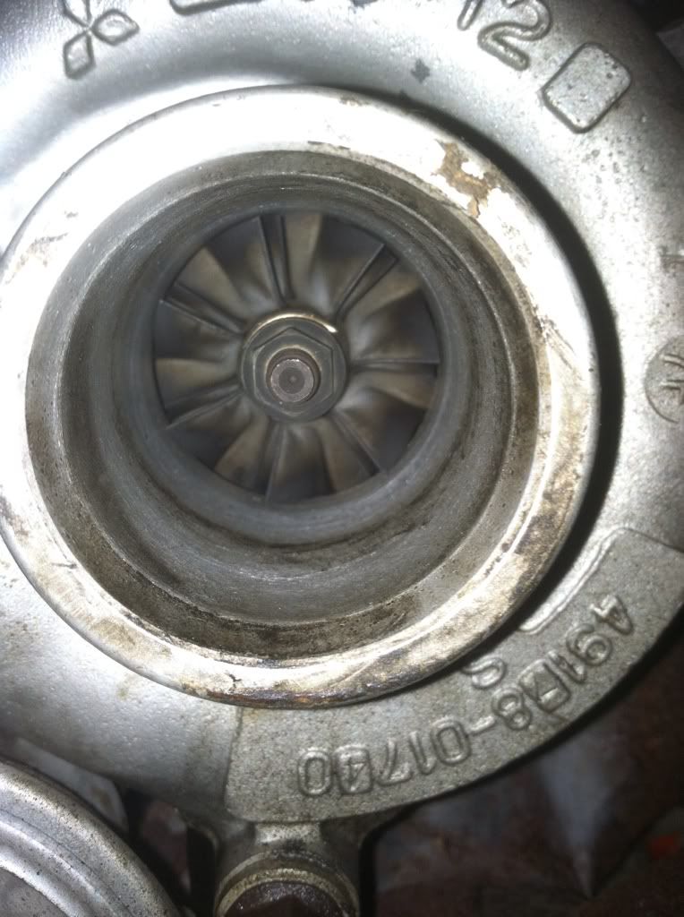

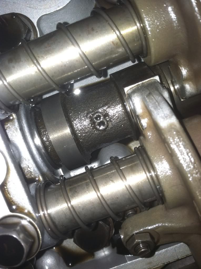

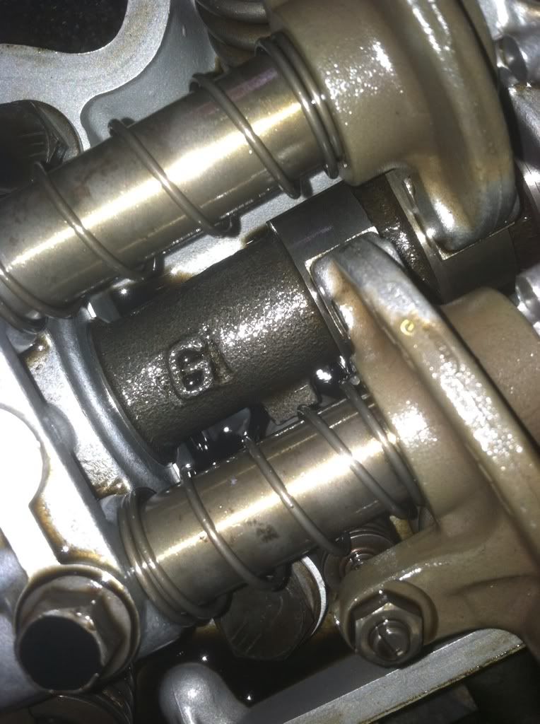

Ok guys got some more questions!  Cam and turbo this time.

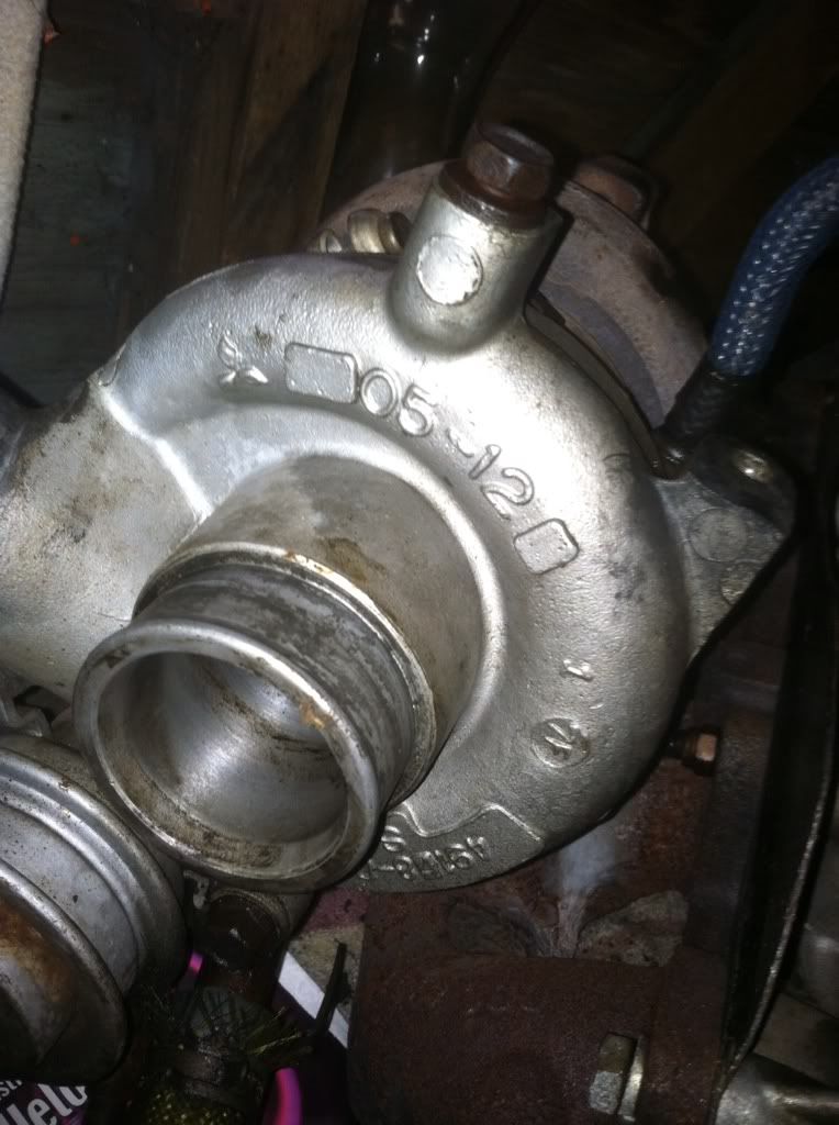

Turbo has 14 blades total.  7 longer ones and 7 shorter ones.
Also i'll be getting the parts car on saturday.  And an engine stand.  As long as the weather is nice enough on sunday i plan to pull my motor and trans and get the engine on the stand.  Does any one know where i can find the thread thats the how to for replacing/repairing the frame rails?
#15 leesfer
leesfer
    Jurassic Parts
  • 998 posts
  • Location:San Diego
  • Interests:Speed
Posted 15 February 2012 - 04:34 PM
Stock cam and stock turbo (housing is stock at least, could be different inside)
You still have jet valves, too

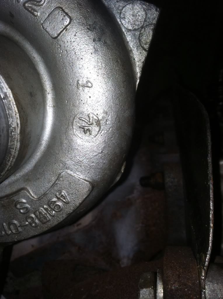

Newbie question: were the TD and A that are missing (on the turbo compressor housing) typically not cast in the housing?  I've never seen that before, and honestly it looks really strange.
Edited by riceboyler, 15 February 2012 - 04:56 PM.

#17 89BananaQuest
89BananaQuest
  • 625 posts
  • Location:Indianapolis IN
Posted 15 February 2012 - 05:19 PM

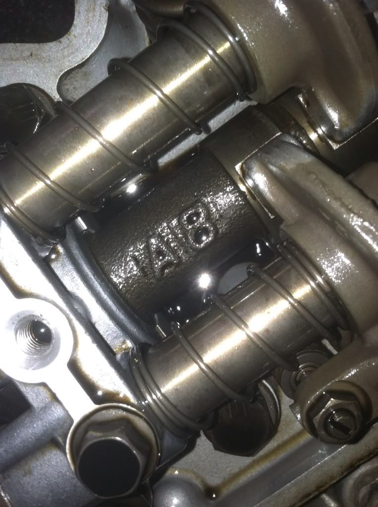

Yea,  that was my questioning on the turbo is the td and the a are missing.  And the cam i had read that the stock ones had a stamped letter on the front as to were mine is smooth?  Thats why i was a little confused about that.
#18 leesfer
leesfer
    Jurassic Parts
  • 998 posts
  • Interests:Speed
Posted 15 February 2012 - 08:53 PM
Just went out and checked the stock 12a I have sitting around and it is identical to yours
You'll have to wait for someone more experienced than I to comment further on the cam

#19 Indiana
Indiana
    Addicted Starquester
  • 14,736 posts
  • Location:Bloomington, IN
Posted 16 February 2012 - 01:42 AM
You're lucky it says 05-12 and some places if they enlarge it for a different wheel they will grind off the 2 and some won't not that it means anything.
No, that's stock that's all they ever had on them.
That cam is aftermarket, those numbers only mean something to the maker and nobody ever bothered to decode or compare those.  It could be a regrind too because they use old cams for that and as mentioned usually stamp or engrave on the back end.  The stock cam had an A or a 6 on it depending on if it was A for auto lasher adjuster (hydraulic) or 6 for mechanical
#20 89BananaQuest
89BananaQuest
  • 625 posts
Posted 16 February 2012 - 06:13 AM
Ok.  I thought they where stamped on the front end.  Any specail way to take the cam out then?  Or just take off the rocker arm assemblies or what?  I'll pull it out today and see what it says.
