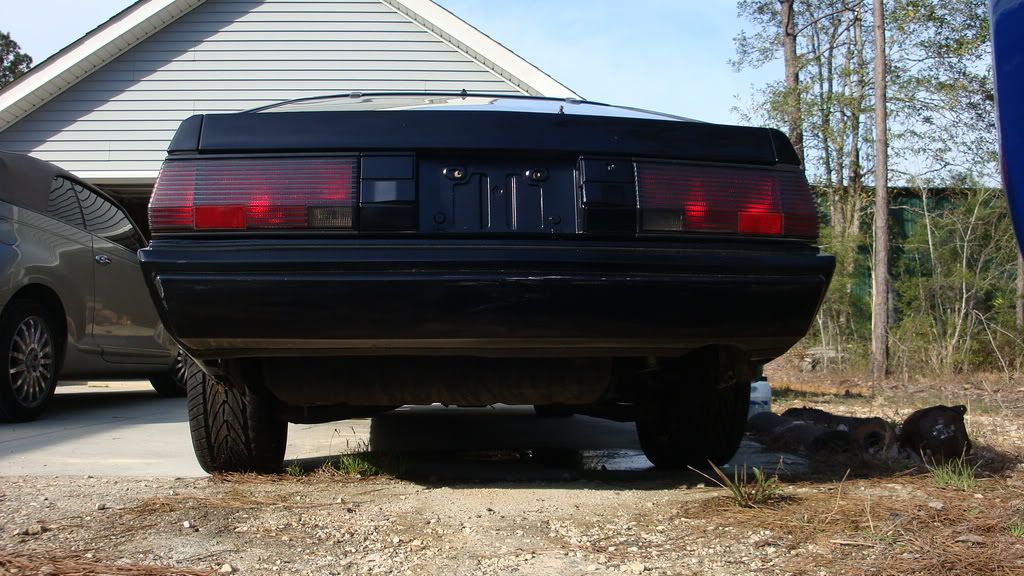

IntercooledFlatty Posted January 18, 2012 Report Share Posted January 18, 2012 kumho 225/50/15 AST , LOVE EM !http://i154.photobucket.com/albums/s263/aiche_photos/855%20Flatty/FlattyNats006.jpghttp://i154.photobucket.com/albums/s263/aiche_photos/855%20Flatty/lsdkjf104.jpg Link to comment Share on other sites More sharing options...

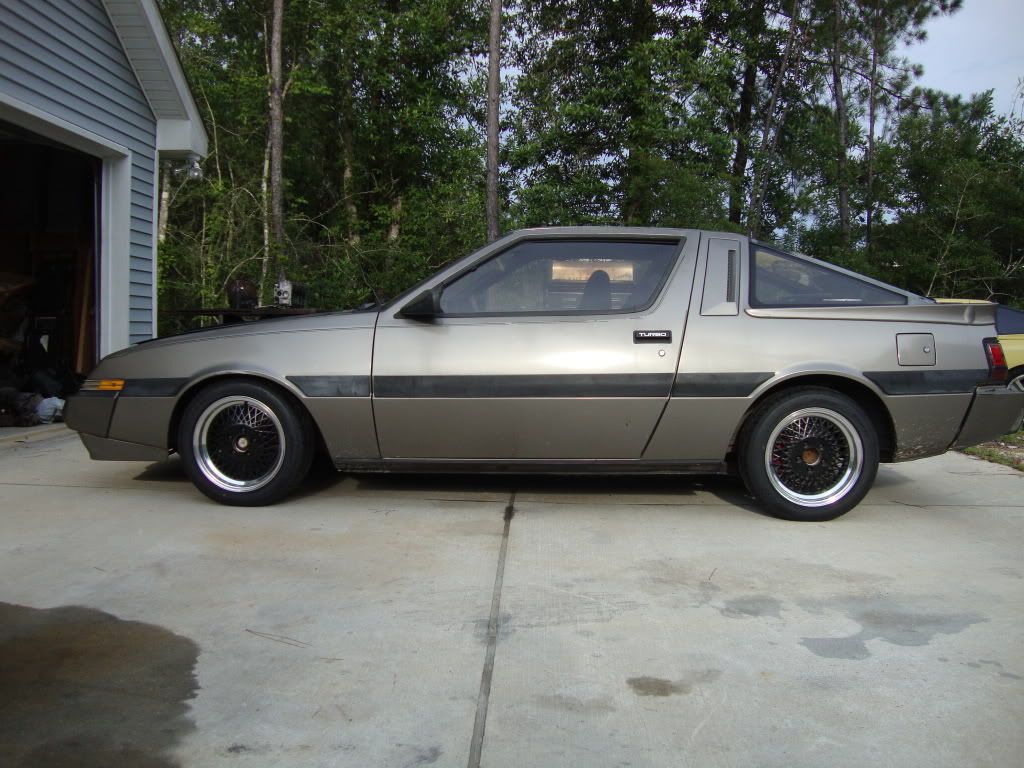

Side-Swipe Posted January 19, 2012 Report Share Posted January 19, 2012 I think I have like 175/70/15 on mine right now and its not too bad. Link to comment Share on other sites More sharing options...

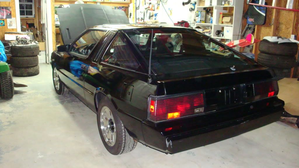

IntercooledFlatty Posted January 19, 2012 Report Share Posted January 19, 2012 all of these pics are on eibachs/KYBzhttp://i154.photobucket.com/albums/s263/aiche_photos/855%20Flatty/8-22-93.jpgand this one http://i154.photobucket.com/albums/s263/aiche_photos/855%20Flatty/CopyofNationalsInBranson005.jpgthese are nice too, Nitto 555 205/50/15 , it just came down off the jack so it hasn't setteled yethttp://i154.photobucket.com/albums/s263/aiche_photos/Olive/DSC01682.jpg Link to comment Share on other sites More sharing options...
jonboyb Posted January 19, 2012 Author Report Share Posted January 19, 2012 Thanks Harry......I like the way those Hooters.....err....tires look. The 23.9" height looks much better than 25.2" factory. Is the olive car lowered (looks like it expecially if it wasn't settled in that pic!!!) Link to comment Share on other sites More sharing options...
IntercooledFlatty Posted January 19, 2012 Report Share Posted January 19, 2012 yeah man a drive around the block and she squats. Olive rolls on eibachs, st sway bars and kybZ ANOTHER head, TH350, MS set up and MPI going in soon Link to comment Share on other sites More sharing options...
