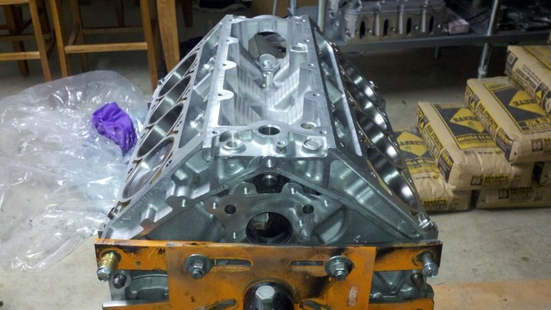

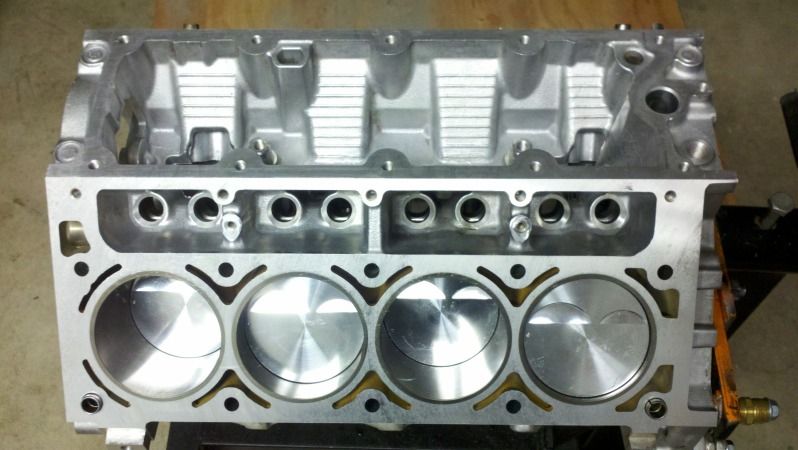

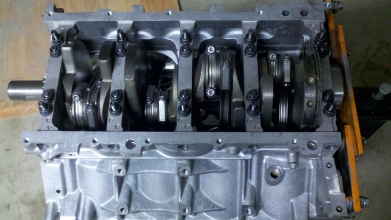

As promised
3.905" Diamond Racing piston, Eagle H Beam Rods, Arp Mains and Rods, LS2 chain tensioner, 853 cleaned with new seals and ls6 springs.
I am going to start putting the motor together, maybe buying a Crower custom grind cam 217/226 @ .050.  Still need to get head studs and push rods along with clutch/flywheel and transmission.

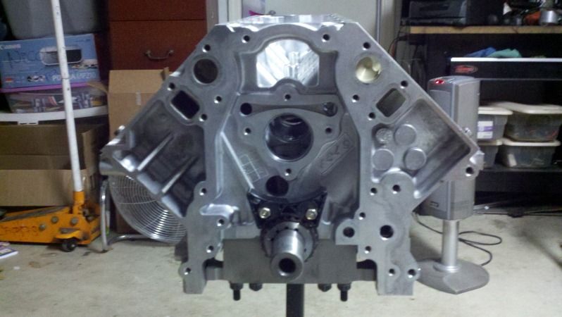

Well last night I got some things done.  I decided to install the stock cam because I was unsure on what cam to use <_<  too many to choose from :wacko: The timing chain, oil pump, timing cover, windage tray, and pickup tube are on.  Today I will be able to install the rear main seal and cover as well as the oil pan, valley pan and knock sensor.  The heads will have to wait until I get my head studs/chromoly pushrods /underdrive pulley from summit. :) :) :) :) :)

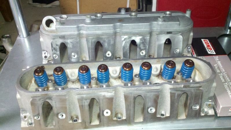

I picked up a set of 243 heads with what I believe are PAC springs, and a TFS 228/230 .588/.588 cam.   With an ported ls6 intake I should be almost 400hp at the wheels.
Waiting on arp head bolts and valley pan gasket and the long block will be done.

I got the cam and heads on, I will be installing the new roller bearings on the rockers and measuring the push rod length next.  Sorry for the slow updates. but this time of year is quite busy -_-
