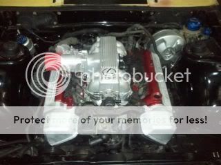

Ok guys like it says im putting a 1uz in my quest got a running motor out of sc400 for free couldn't pass that up I just need to get my hands on a r154 or w58 trans this is what I have done so far not much but a start.
Cleaned up and set in
Resto under way going MPI aswell

i used an 89 supra non turbo W58, steel center. and as for the website listed above, he will take care of you. My car was one of the test cars for that setup and the owner of the company is a friend i see weekly. he has everything on the shelf ready to ship. When you get a trans, get the front driveshaft off the supra aswell, you will need the yoke and about 6"s of the shaft, then have your starquest driveline mated to it via busing. i think it was 34" overall but its all about where you set your engine, i had mine a bit forward to keep the firewall in tact.

Try and pick up an R154, that way you can build power and not worry about it.  More expensive and bigger but you won't break it.  I don't know how much power you will end up with but if it's over 400 try and get the R154, guys are breaking the 58's.
