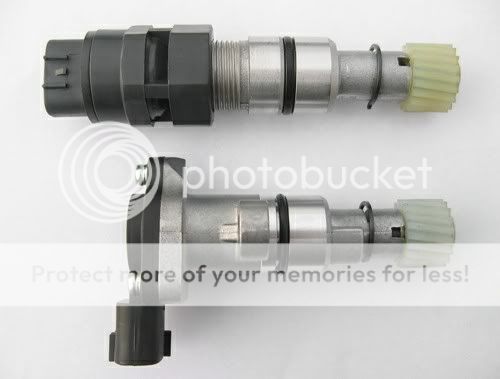

#4 BOHO
BOHO
    Sucks at life
  • 4,338 posts
  • Location:Warner Robins, GA
Posted 26 August 2011 - 12:44 AM
Mine is the one on the bottom. JDM YO! I need the one off the mk3 supra.
Mine has the electronic unit and I can't find the right hookup...

#8 jisleyjr
jisleyjr
  • 1,123 posts
  • Location:Fargo, ND
Posted 12 April 2012 - 09:22 PM
So it is simply just removing this sensor and then just plug in the stock speedo cable?

#9 BOHO
BOHO
    Sucks at life
  • 4,338 posts
Posted 13 April 2012 - 12:49 PM
No...You have the same unit I do. You need then entire mechanical unit like I showed in an earlier post.  I'm about to hook up my electronic speedo and see if it will read this sensor..I'm not sure yet though.
