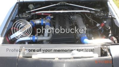

Do these look familiar? MadDax's drawings work perfect for the 1jz also... I also finished the intercooler bracket...but I have to cut on the support to get the bumper back on...

For informations sake. Most US spec cars use 3/4 16 thread pitch on their oil filers. Toyota used 20mm 1.5 which is very similar. I'm using an oil filter relocation kit. The 3/4 16 dye is more available and pretty cheap 11 bux at fastenal... So half is 20mm 1.5 and the other half is 3/4 16 but the adapter kit won't know the difference. This is the easiest solution I could come up with. The metric dye was more expensive and would have taken 2 weeks for me to get it.
All of the studs that I researched were too short...This seems like the only option...or my research skills are weak... : )

With this intercooler I didn't need to beat or cut the frame rails...But I did have to cut and hammer on the bumper support.

Did some work this morning. Swapped out to the External shifter...New trans mount...modded trans bracket...
I found this for a good price. Its a stand alone fan controller...very simple..very cheap. Turns fans on over 170...then back off..has override circuit etc. Basically same price for everything that I've found just 2 12" fans...65$...Just thought I would make things simpler.
Oil Filer relocation kit...I D***** up the f'n bolt...I've to come up with a plan B..My threads came out crooked.

You are correct..I wasn't thinking before I got it...I'm only going to be able to run one of them...It would fit in a perfect world but...this isn't...Even if I made them pushers the oil cooler and Intercooler are in the way...I should have gotten 10"....
I didn't get the trans apart..I gave up for a while at least....
I don't want to talk about it...but...I got this to work  :) Pipe adapter and a Chrysler oil filter stud...
