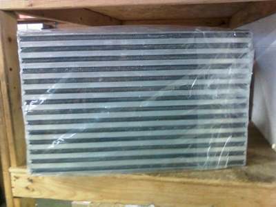

nasteboyii Posted March 25, 2010 Author Report Share Posted March 25, 2010 the intercooler core, i found a core that fit the dimensions i had to deal with. and the power goals i may have in the future. i built the end caps, the feet to mount and brace etc. basically everything you see on this thing will be built by me unless stated elsewhere (adapterplate was bought and bell housing of course) feel free any questions. and obviously i could build another one if needed dan looks good the intercooler is that special made??? looks nice. im still saving for my 2j and 6sp so I wont post till I get something substantial Link to comment Share on other sites More sharing options...

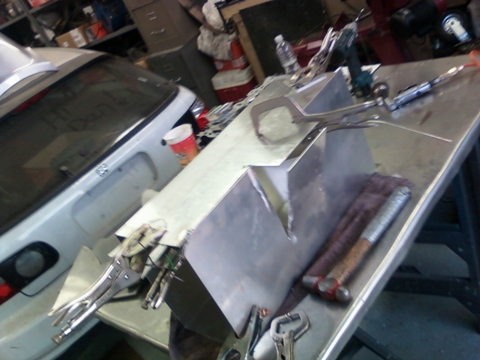

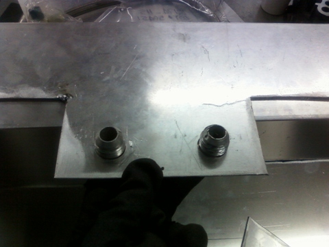

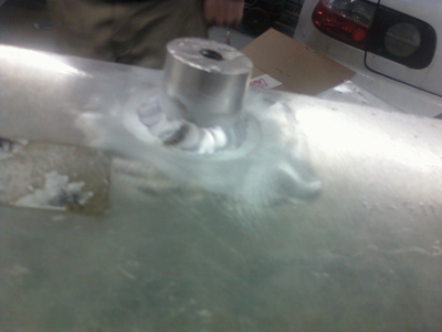

nasteboyii Posted April 17, 2010 Author Report Share Posted April 17, 2010 (edited) here is the first pic to the fuel cell that im making. 10 gallon aluminum still going in stock location and will still have factory fill point. 2 drains out of bottom back. Will have at least 1 10an feed line. has a second one but may use that just for a drain plug. also need to make a return fitting location. have not decided that yet. and figure out a vent system too also started building a catch can. ran out of gas for the tig. so got some of it tacked up. as you can see in the pic. will have 2 10s coming from valve cover. will have baffles inside. will have one 10an drain back. and 2 filters on top. going directly underneath the wiper motor between fire wall and shock tower. http://www.starquestclub.com/forum/uploads/1271100349/gallery_13048_626_67760.jpg Edited April 17, 2010 by nasteboyii Link to comment Share on other sites More sharing options...

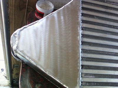

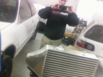

nasteboyii Posted April 17, 2010 Author Report Share Posted April 17, 2010 here is some thumbnails now that i figured out how to load from my computer first pic is of the intercooler core, second pic of the feet we welded on after i threaded them so i could bolt them down, third is me taking a pic of my welder (corey) taking a pic of the intercooler down (ahahah)fourth is one of the end caps Link to comment Share on other sites More sharing options...
