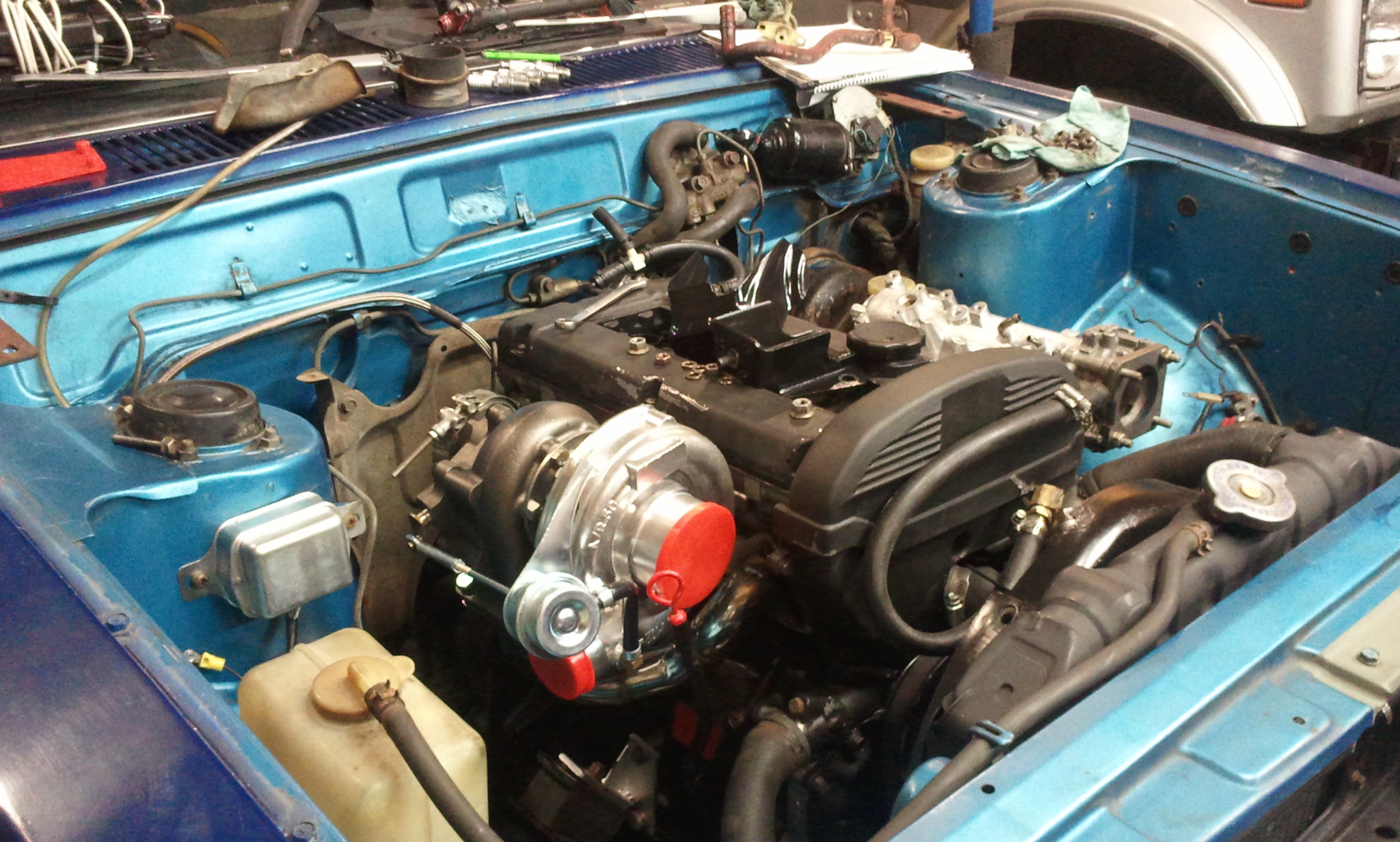

Posted 13 May 2012 - 10:24 PM
7psi. gettin there.
btw, the jettin is a standard primary jet, but no secondary jet. that puts me at a mid-11 afr under boost, and it drives like normal off boost.

The new pump doesn't have the GPH required for the thirsty little motor. I installed a quest pump and a fpr, and it will haul butt under boost with that, but won't idle. I think I need an FMU.. I hate saying that...
incase you don't know, a FMU is a rising rate fpr of sorts, it starts at 1:1 at low boost pressure, and goes up to 12:1 under higher boost pressure. It's normally a band-aid©®™ on a naturally aspirated to boosted application, that I do not enjoy dealing with from a tuning standpoint. I have not seen a predictable or reliable one yet.
So it has the diesel pump in it now and I can stay in boost for a few seconds before it literally runs out of fuel, I mean 11.5:1 afr to 22:1. Like the motor turned off, then it gets the fuel again, and I can do it again. It's not bad to show off for a second, but it won't "go fast", like I can't do a full pull, so it's fun to drive, but limited... I kind of like it, it keeps me out of trouble.

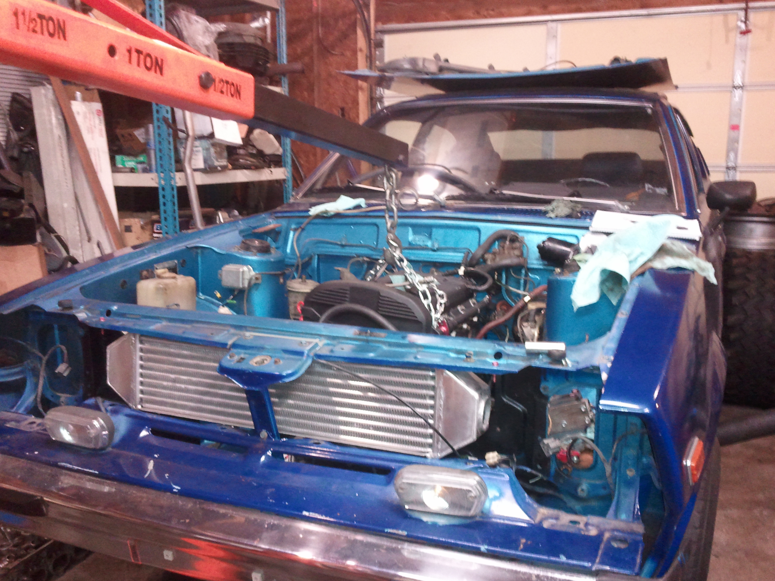

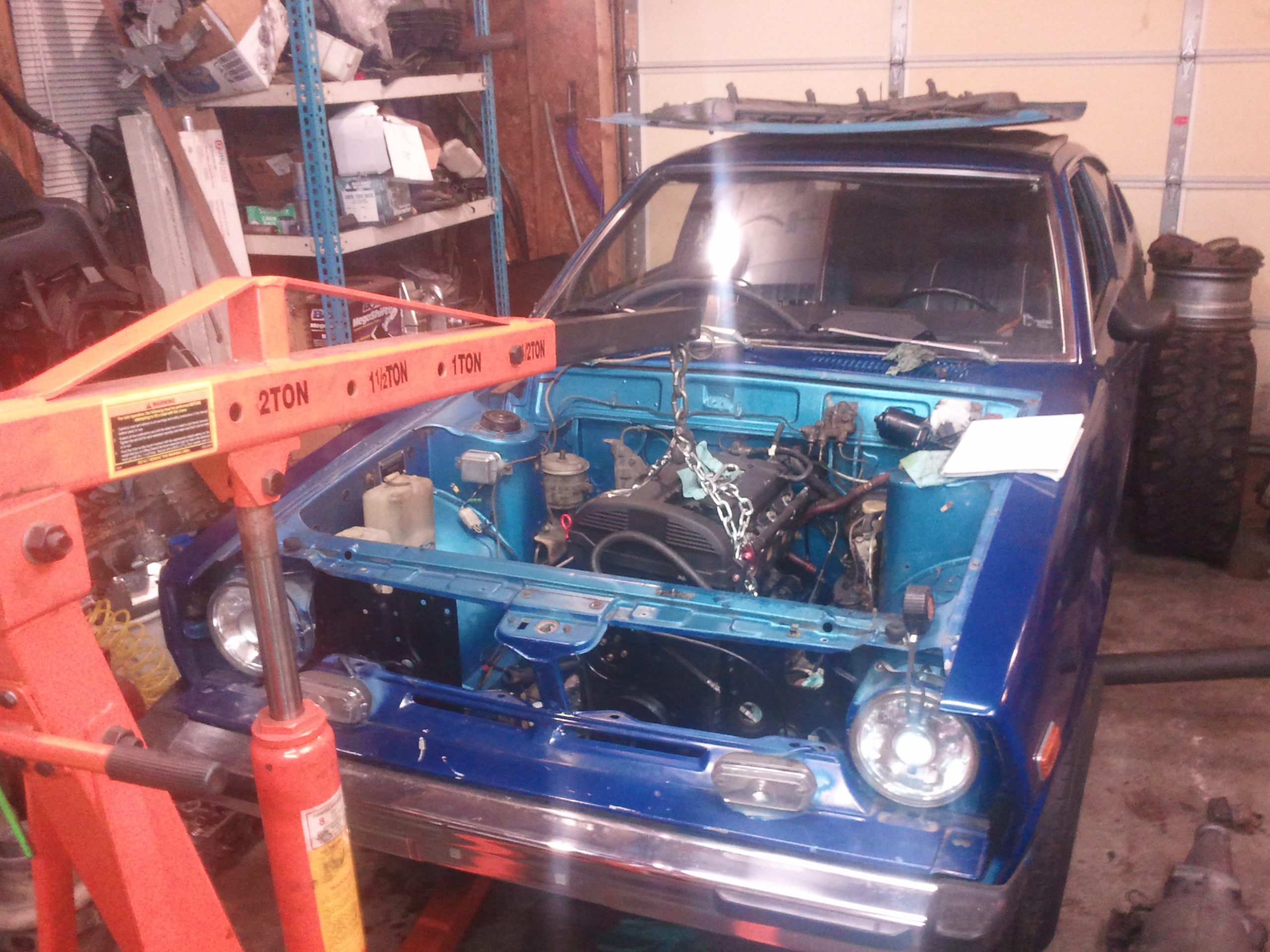

Posted 28 September 2012 - 09:41 AM
Theres no fabbing as far as the trans goes.... I know, it blew my mind as well.
I picked which IC to use. This should help reduce questions about my grill.

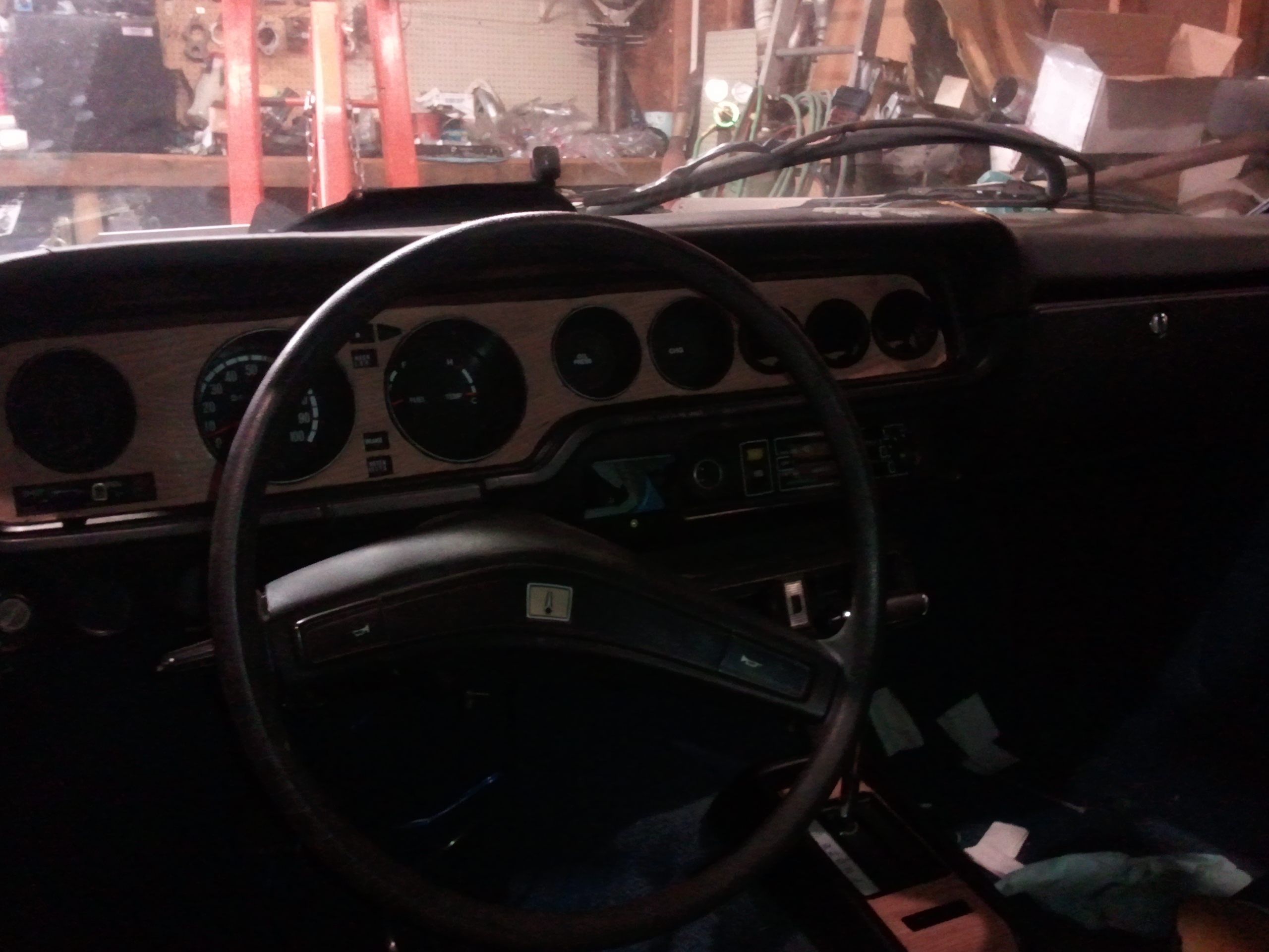

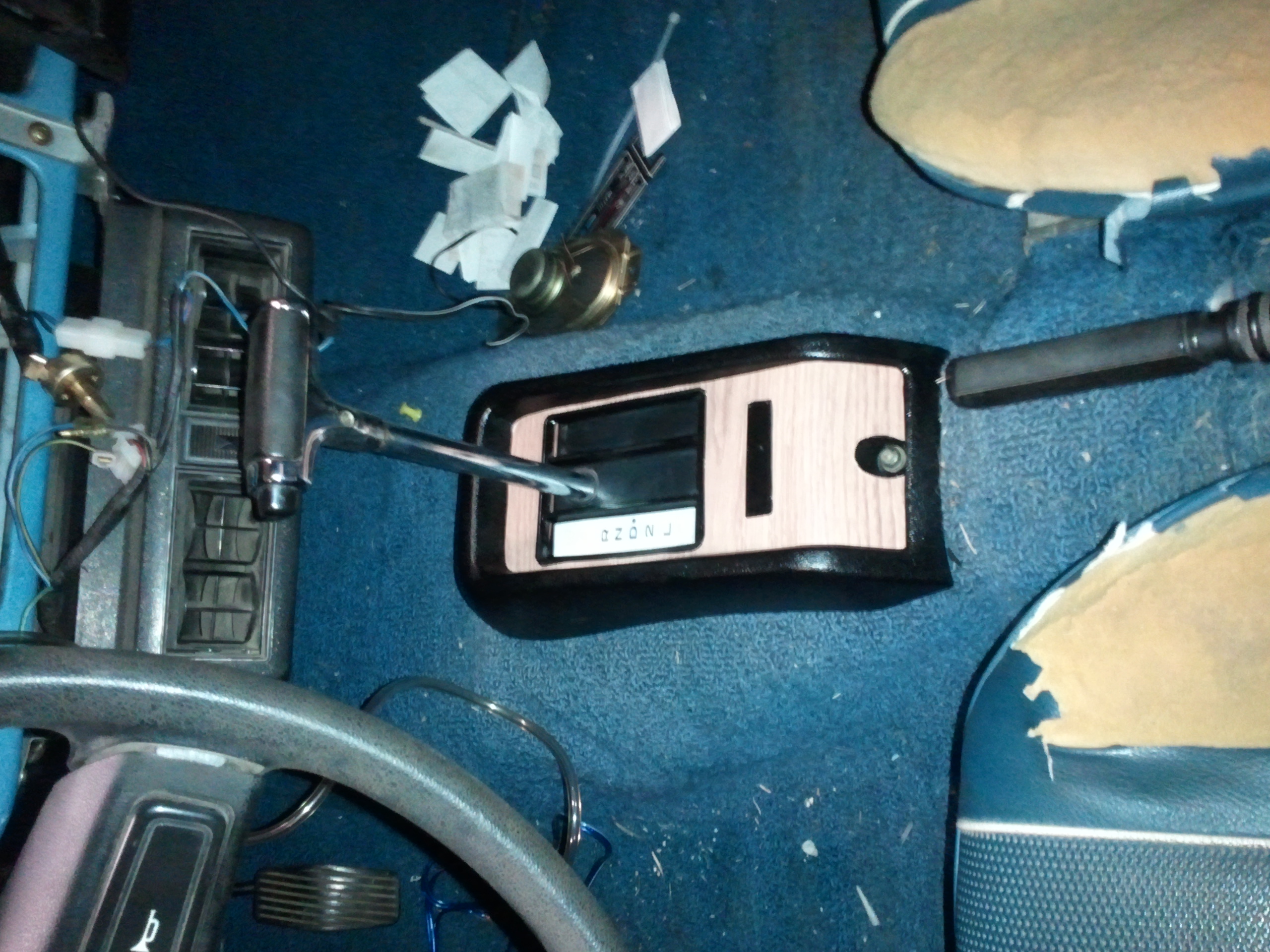

    2011 Honda CR-Z
Posted 02 October 2012 - 12:56 PM
deliciously new wood grain.
I will take care of the seats too.
Edited by button, 02 October 2012 - 12:57 PM.

Posted 04 October 2012 - 11:41 PM
Insane in the wood grain. gone insane, got wood grain.
it's just cabinet laminate.
And, TexasQuest, I do not plan to make a monster. I tried that, and I didn't enjoy it. This will be quite a bit less hp. I'm thinking less than 300 on under 15psi.

Posted 16 October 2012 - 10:00 PM
it's starting to look like an engine.

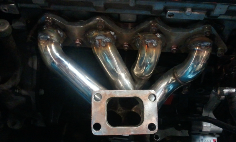

i should mention that I bought the cheapest ebay t3 footprint manifold I could find that didn't have a wastegate provision, so i could chop it and flip it. So far so good.
The intake manifold is an evo 8, it needs decently modified to work, but it will.
Edited by button, 16 October 2012 - 10:03 PM.

#39 button
button
  • 2,017 posts
  • Location:Niles, Mi
  • Interests:1978 Plymouth Arrow
    1974 Dodge Colt
    1990 F45 Tow Rig
    2011 Honda CR-Z
Posted 19 October 2012 - 06:20 PM
like that.
