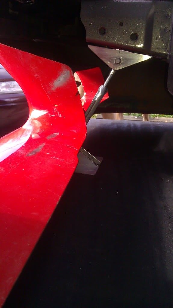

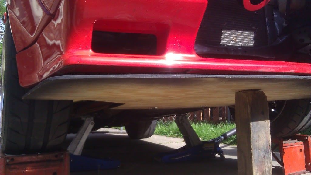

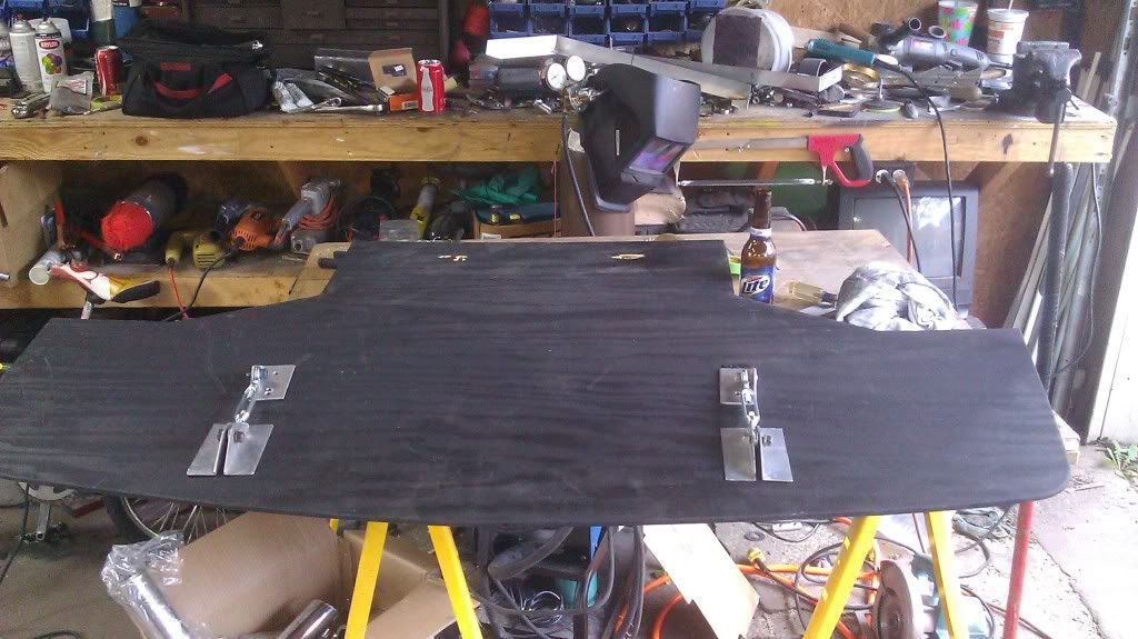

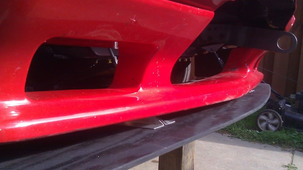

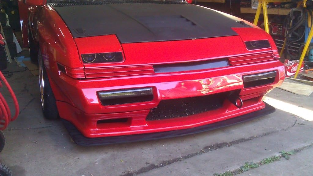

So with all this splitter stuff I finally got around to building mine.  Yes its ply wood, as it sits I have about $26 and about 4hrs.   Just need to finish painting and bolt it up.  I'm going to try a bunch of new aero enablers in the next few weeks.  I like going fast and I want to stick.
This is bolted to the front x member, and the frame rails with plent adjustment, also hidden behine the air damn.  I can also adjust it forward or back for more function.  Still to finish painting and bolt it up..

I can dig it, looks pretty well thought out, part splitter, part flat bottom. You might consider bracing the wood though, it's very likely to deform and possibly shatter at speed.

Undertray too! Dont worry about plywood it has been used before with good result. You plan on doing the whole underside? I would brace the front though like dymer said. Cheap and affective.

yeah I'm prolly going to do 2 more attach points for a little extra strenth out near the wheels, and some light weight bracing.  I do plan on flatting out the whole underside eventually.  I have to start working on the rear of the car... diffuser time.
