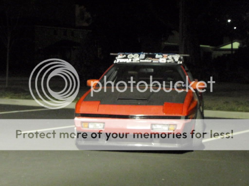

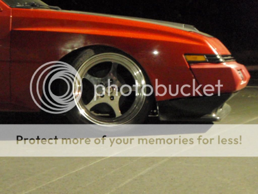

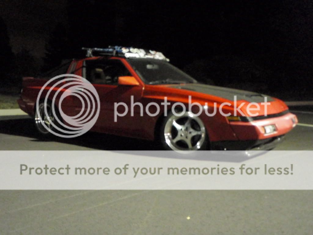

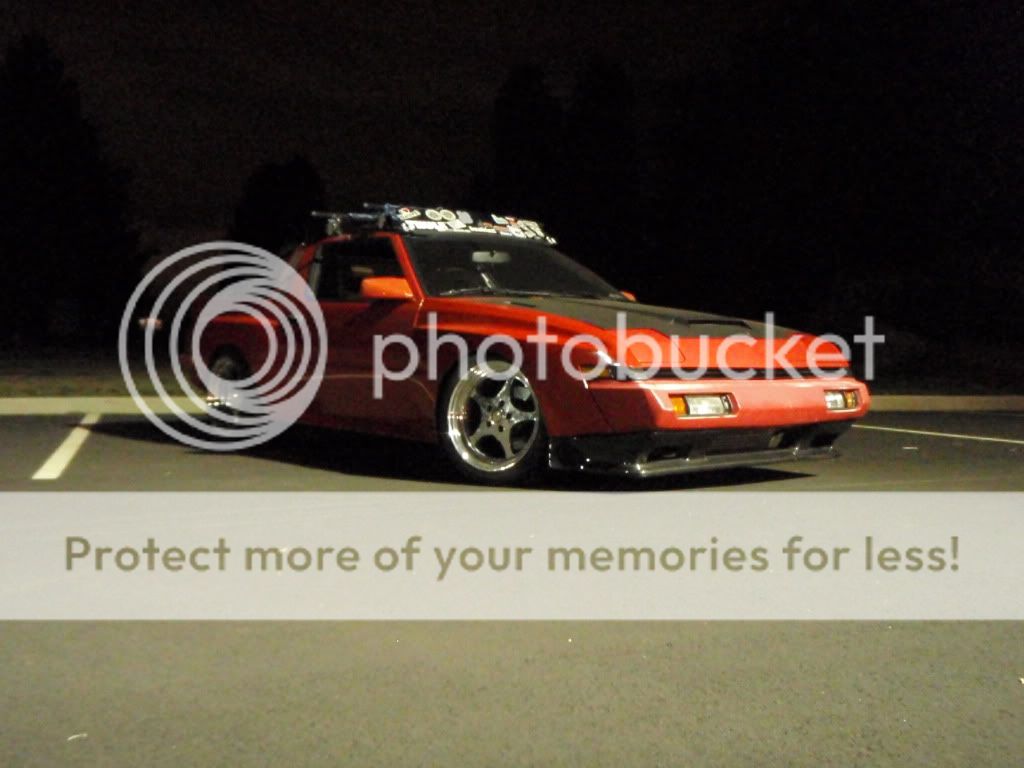

REARS are on. going to road test them. when sitting next to the kyb/st spring combo, i set the D2 about 3inches shorter. and i guess the st's had sag in them. now the car sits 3 inches higher then before. over all i set them to 20 1/2 inches, from top plate to lower 2 bolt plate

about a 1000x better they my ST/kyb set up. For have 11.5k front and 10k rear spring rate it rides better then most new cars i've been in. i have to lift the front up about a half an inch and then i'll put some miles on them.

that car looks hot!  quick question, is that as low as you can go with the rears?  Or can you go lower?  how about the fronts?
#18 starquestJOE
starquestJOE
  • 3,517 posts
  • Location:duryea pa
Posted 10 September 2010 - 02:33 AM
oh yeah about 2-3 inches lower. thats as low as i can go. fronts goin up half an inch. and the rear is goin down a half an inch
