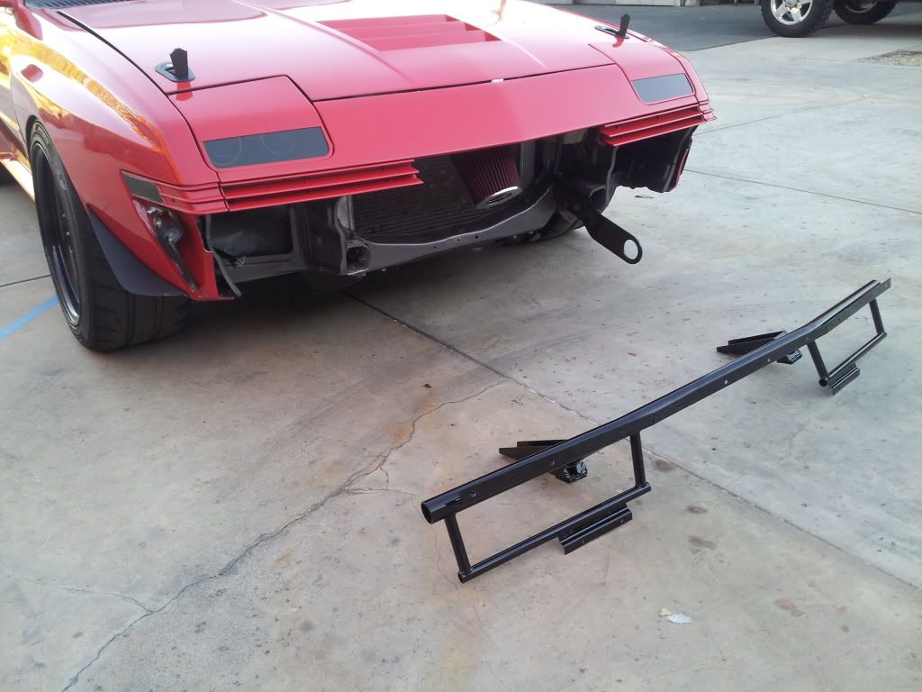

Looking really good man.  I really hope you have more plans for something that will provide protection in a crash. That tubing is way way too small.

Convette, I understand what your saying and to be honest I mentioned that to Derek a few days ago about how this thing would be no hindrance at all. This is my first time building anything like this let alone fabricating or welding to this degree. Any and all suggestions are more than welcome.
I finished a lot today including making hood pin plates, cutting the hood for the vent, finishing welding up the front assembly and putting it on the car with the radiator and intercooler, and also sanding etc. I will leave you with this picture and post more in the morning so you can see how far I got. Tomorrow night I very seriously hope to paint the car.... thats wishful thinking though I believe. I may take one more day off of work.
Anyways here is the completed assembly

I'm just saying something more substantial for tubing.  I use 1-1/4" DOM for mine, still prolly not EXCELLENT is a crash, but stronger than what I had none the less.   Obviously for your own safety, but also for the car.  I crashed a 240 a few years ago, super slow speed front hit, but it destroyed the car casue I had no bumper support..( bought it that way..was a turbo car at one point)  Posted Image
I know your pretty far into it now, and at this point might need to be something you come back to, but just as a heads up.   Very curious to see the hood work out ect.   Great work so far, most importantly your learning.

I appreciate the heads up mbruneax haha. And thanks for looking out converts. I hear what your saying and your right. I am super far and can't redo it and hope to finish but I'll definitely need to build another one. Besides my welds are ugly, structural but geez they are ugly lol. I'll have a huge update tonight.
