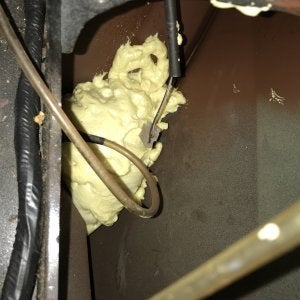

Clearing out the trunk area and looking in from the top revealed just a little bit of spray foam!   That definitely had to be removed, I'm not striking an arc with that in there...next to the fuel tank no-less.
Luckily, it came out pretty easy by simply reaching my hand down there and breaking off chunks of it.   Then I used acetone to clean up the residual.   Here is the outcome:
The other side didn't have as much foam but was so much harder to access.  Had to remove the power antenna and come in through that location. Notice how the drain hose for the antenna just went into the foam.
This side was much  more tedious but I got it pretty good.  I'll clean it up even more after I cut out the rusted sections
