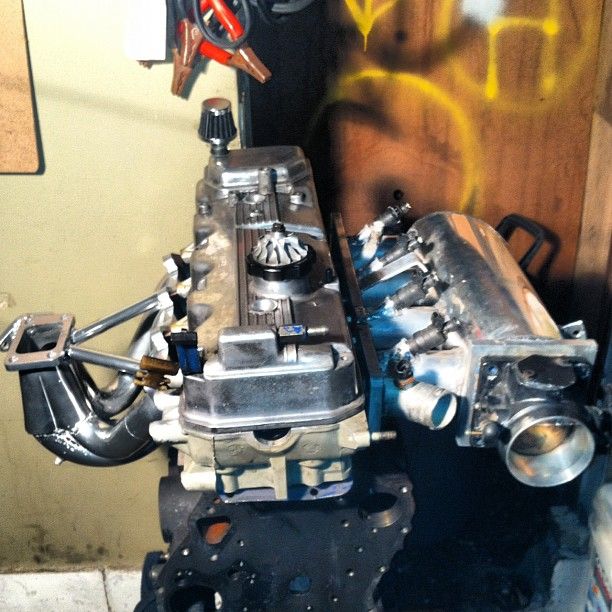

Posted 06 February 2013 - 04:38 AM
and Here it is hopefully will be on the car this weekend

Posted 06 February 2013 - 10:02 AM
If its got braces most likely you are going to have issues...just speaking from experience. None of our manifolds have braces and have not cracked. Hate to see you having to get it re welded over and over and over.

Posted 07 February 2013 - 03:50 PM
What would cause it to break?

Posted 07 February 2013 - 04:13 PM
From the picture it looks to be thin walled exhaust tubing. That if thats the case its not going to hold up. Also the welds dont look good at all. Do you know if it was even back purged? What info do you have on it?
Again not talking crap just trying to save you some headaches down the road

Posted 09 February 2013 - 07:40 PM
Well the metal is a pretty good thickness the welds and ok. So i may just reweld it at work. If i do have issues with it ill have to have  get a nicer one made for me

Posted 11 February 2013 - 01:51 PM
Should have went with 3" exhaust if your running that holset.. it needs to breathe

Posted 13 February 2013 - 11:40 PM
Dude, thats an SMB, and your gonna blow the wastegate flange off like all the others. The material he used for the collect is pure crap.

Posted 13 February 2013 - 11:42 PM
just run a stock manifold with a $30 adapter. Otherwise youll have to modify your downpipe in a few weeks
