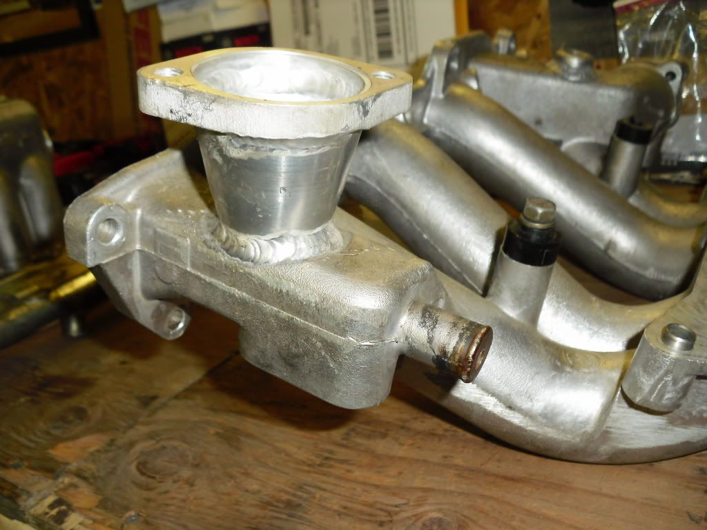

Thanks for the link!  I believe I will have enough clearance for the radiator hose off the thermostat because Chad did my intake and it appears to be like the one shown in the picture below.  I don't know who's car it is... some guy in Orlando.  I won't really know until I put the intake pipe on.
I know it's a long shot, but does anyone know what hose (part # or from what car) it is in the picture below?  It has a slight bend to it, but nothing as aggressive as our stock hose does.  The one in the pic below looks perfect.

You can use a thermostat neck from an 83-87 car, they are shorter and pointed more towards the radiator.  the 88-89 necks pictured are really long and poorly aimed for MPI.  you should be able to use a stock hose on it if your radiator is stock, or stock-dimension aftermarket.

So, the 83-87 thermostat covers do in-fact point more towards thee radiator, but they don't have the additional tube to send coolant to the turbo.  Strange.  I may not worry about it too much until I start the install.  Can't tell what will interfere since my intake pipe actually comes across the front of the block and connects into the stock intercooler.  Most people that go MPI completely redo their whole intercooler plumbing, but I will initially use an intake pipe made to minimize plumbing changes.  The downside is it adds interference issues near the thermostat housing further.  Here's two pics below of the difference between an 88-89 thermostat housing and the 84-87 housing.

Low and behold, searched further and found this pic in the link below.  Chad was right.  Now to find that thermostat housing on the left!
