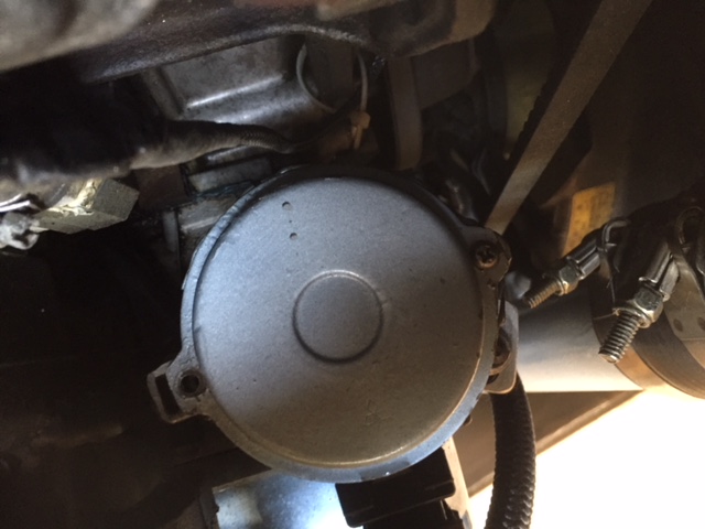

I  will be using magna distributor for mpi w/ sequential injection, but direct fire ignition coils so don,t need cap and rotor. Is there a blank cover made that will fit over the distributor?

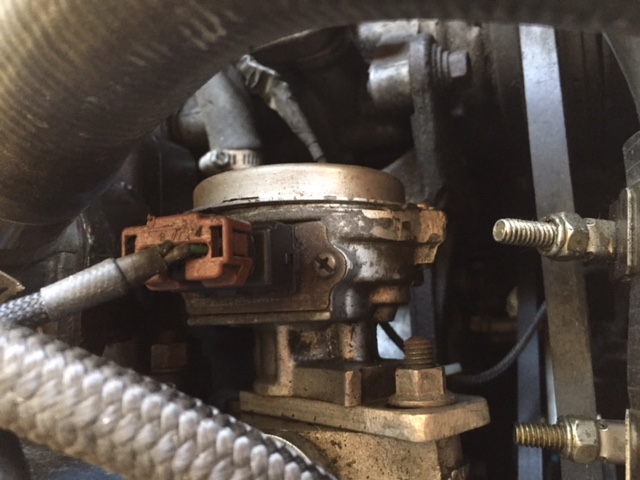

A CAS cover works, that's what I used.  You can remove the upper rotor and fit the cover.  I'll take a picture.

I think its a nice, clean look.  You can grab one out of a junkyard or buy a CAS on ebay.

very nice!!! Scott, thanks

Mookeh/MK1 sells the delete cover here:
