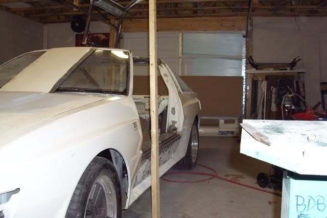

guys, gullwing doors don't open out... they open up.  if the hinges were on the edge where the headliner and door come together, then there would be clearance issues.  the doors open up.

IIRC the DeLorean only required 4" of space to open the door.  Don't think yours would be much different.

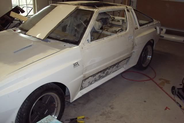

I cut them already if you look in the pictrues you can tell they have been sliced but not rebuilt yet, I removed about 8" that will be come a permanent sill. I am still doing some metal work I will try to get some new pictures up as soon as I get a little more done.

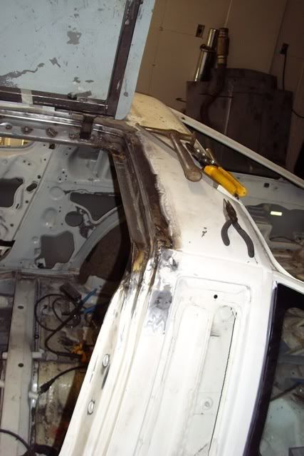

New pictures of some of the drip rail and sills, all still just roughed in but coming along good!

the pictures don't do any of the work justice, I was out there yesterday and those doors operate amazingly.

No new pictures yet but the roof is done and the sills are alsmost complete. I need to finish the doors, just been busy lately with work and kind of lazy on days when I could have been working on it. I am headed back to china for the next 3 weeks so it will be awhile before there is any more progress.

wow that took a lot of balls to cut into that roof!! lol. but its coming along nicely man!! incredible work =)
