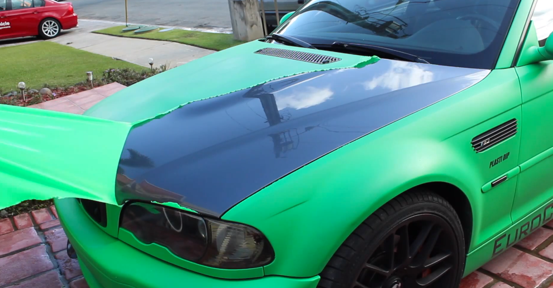

the plasti dip stuff works pretty good and if you did not sand it you can just peel it back off like the pic above. i think it would be the best bet because its a rubber coating and would flex more then paint even with the flex agent additive.
