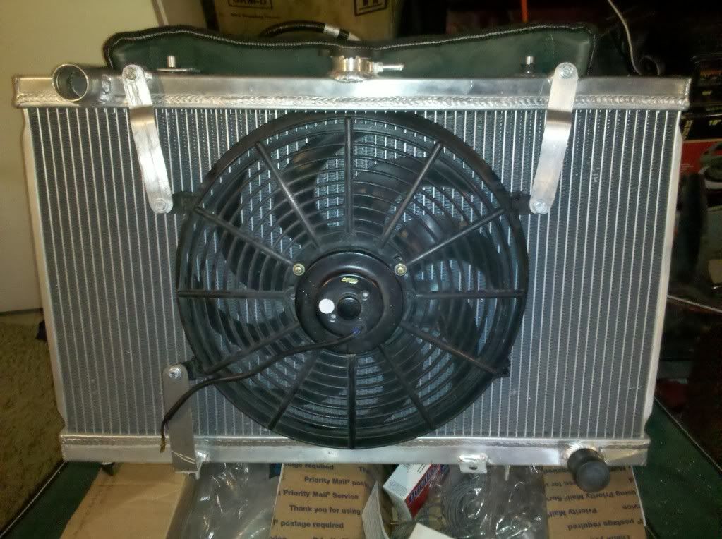

It came in today and looks good.  I threw it in for a quick test fit and to get basic measurements so I can modify the Jag fan assy tomorrow at work.

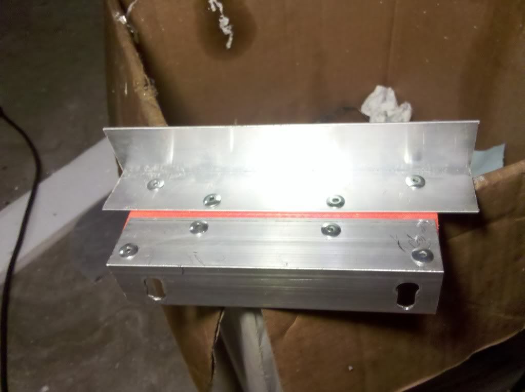

I have this 3 row radiator that I-W bought. He ended up not ever installing it so I purchased it from him. Can somebody show me the bracket you people are making to mount the radiator just so I can get an idea what I need to do to make this work? Thanks!

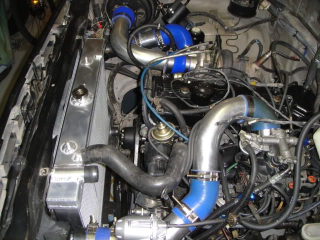

Heres how i did mine. I went to the junk yard and got the rubber for the bottom.
Hope this helps.

I test fitted my 3 row in my car today, and it won't fit with the stock clutch fan. It rubs the bottom end tank by a little bit.
Those of you with clutch fans, you will have to convert to electric fans if you plan to make this work.

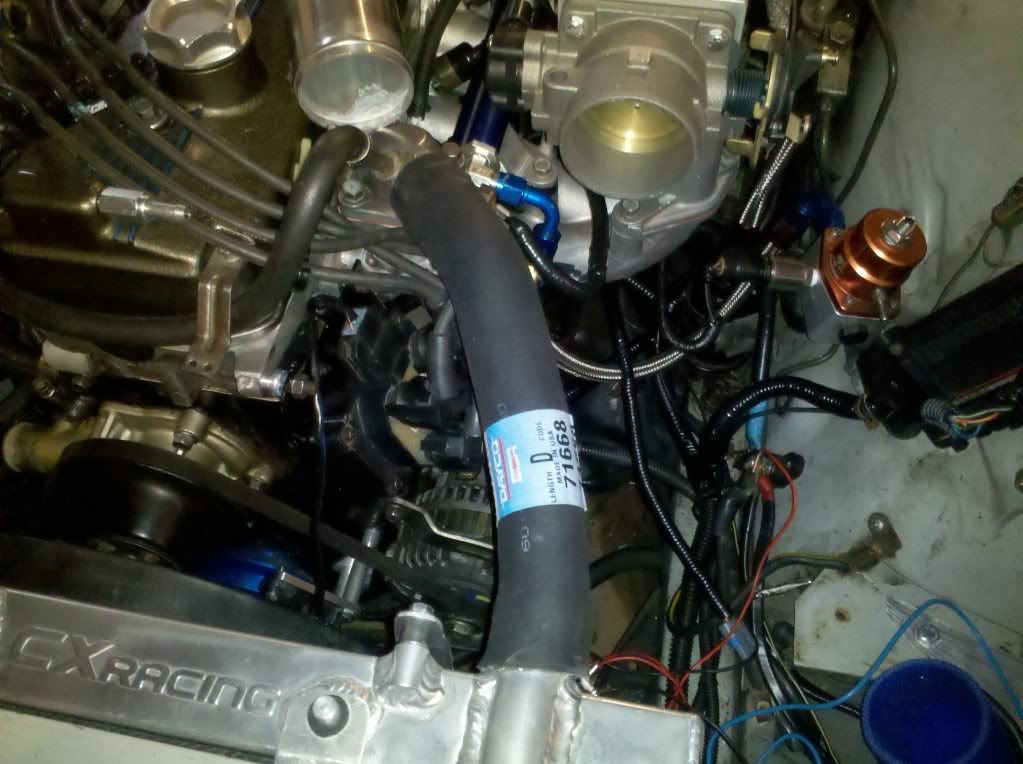

Here's some info on a better lower hose:
View PostSkullzaflare, on 23 February 2011 - 04:56 PM, said:
As I had issues finding a perfect lower hose, all my lower radiator hoses would rub the p/s pump
I wanted to say I found the perfect fit lower hose to use the ebay sr20 aluminum radiator
Its standard stock at your local advanceautoparts, part number "c71280" cost $12.99
Bends around ps pump and back over
No mods to radiator or water pump. Trimmed 1/4" off top of hose from where they run the plastic hanger

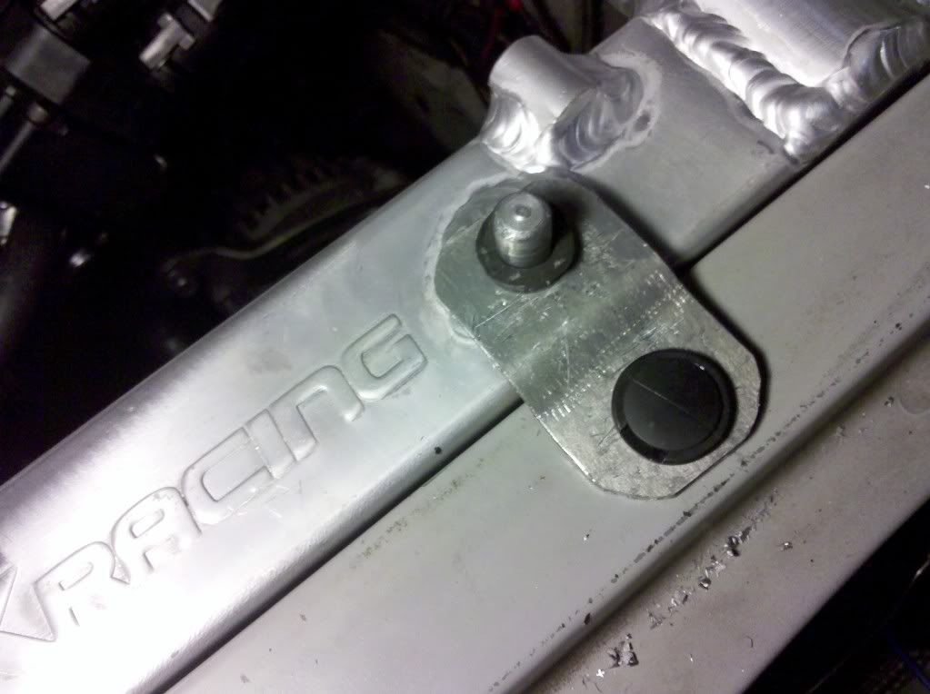

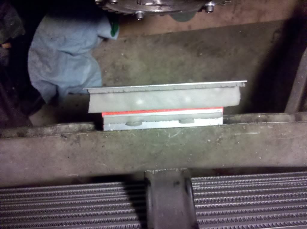

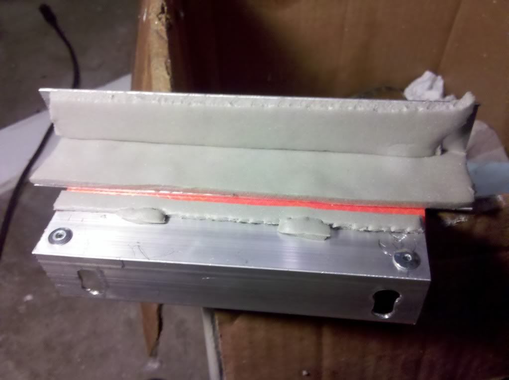

Posted 30 March 2012 - 02:02 PM
Im posting this stuff here now so people can look at one thread and see more options, this is how i done mine.
i also have a part number i used on an upper hose. i had to cut come of the hose off, but it worked for me. you may go a different route..
Here is my lower bracket, its getto but it works just fine
here is what i did for the uppers, yes that is a plastic push pin, and it works just great. drilled a hole and put a piece of hose for a rubber insert.
here is the upper hose, you can see the number here
