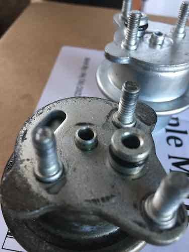

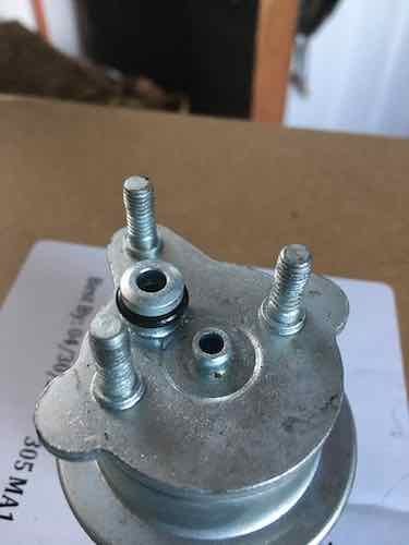

FBS Posted January 30, 2023 Author Report Share Posted January 30, 2023 (edited) Ok... so. I rented fuel pressure tester.. hooked up from top of fuel filter with special. adapter that replaces the banjo bolt and allows to check pressure while engine running. I had replaced the fuel pressure regulator... from one that I had from parts my dad had given me. Pressure came up to about 35 psi... but.... one problem. Big leak where the pressure regulator attaches.. Ok so I thought maybe not tight enough..... tighten a little bit more.... Still leaking... engine tried to run.. but no go... I took off the pressure regulator... examine.. hmmm I then put back on original pressure regulator... An run same test again.... This time no leak but no pressure..... I mean 0. I took a closer look at the two regulators and compared them... little nipple with the o ring that fits inside the housing on the new one is a different height...shorter.... It did not seal correctly and that why the leak. So my conclusion is this..... Since I had pressure with the new regulator at 35 psi... and 0 with the old one my guess is that the valve on the old one is stuck open that is supposed to regulate the pressure and that is why it reads 0. Fuel is just cycling back to the tank. New regulator is bad.. does not fit correctly. To bad I cannot take them apart and switch the valves out.... Curious if what anyone else has to say on this Below Two photos... On the left old regulator... Right the new one... there is this depression on the top where the bypass port is.... It looks like a factory defect... From stamping or something . Has anyone else seen this. I have the o ring... but I think its not sealing due to the depression...o ring not thick enough... depression is .015 deep... I can make a thicker o-ring.... with my 3D printer... Any Thoughts ? Edited January 30, 2023 by FBS Add Photos Quote Link to comment Share on other sites More sharing options...
