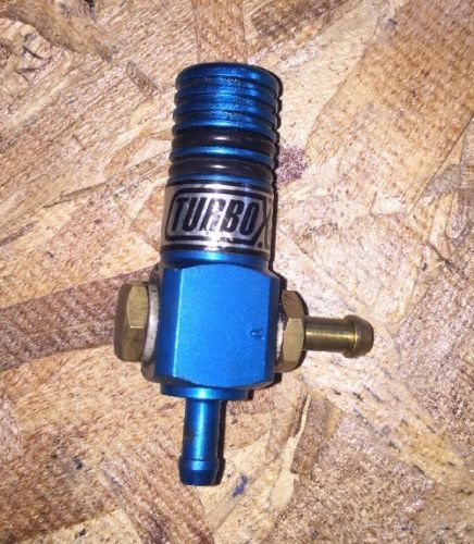

one thing you should know is the factory boost gauge is not accurate, its more of a educated guess from the ecu. pick up a aftermarker boost gauge so you can get a true reading of your boost pressure.
to increase  your boost you will need to buy a MBC (manual boost controller) and you can adjust your boost however you like.

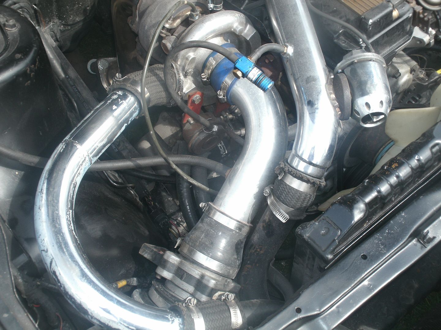

it is installed between the OVCP (over valve cover pipe) and the wasgate actuator under the turbo. here is the above MBC installed on my car.

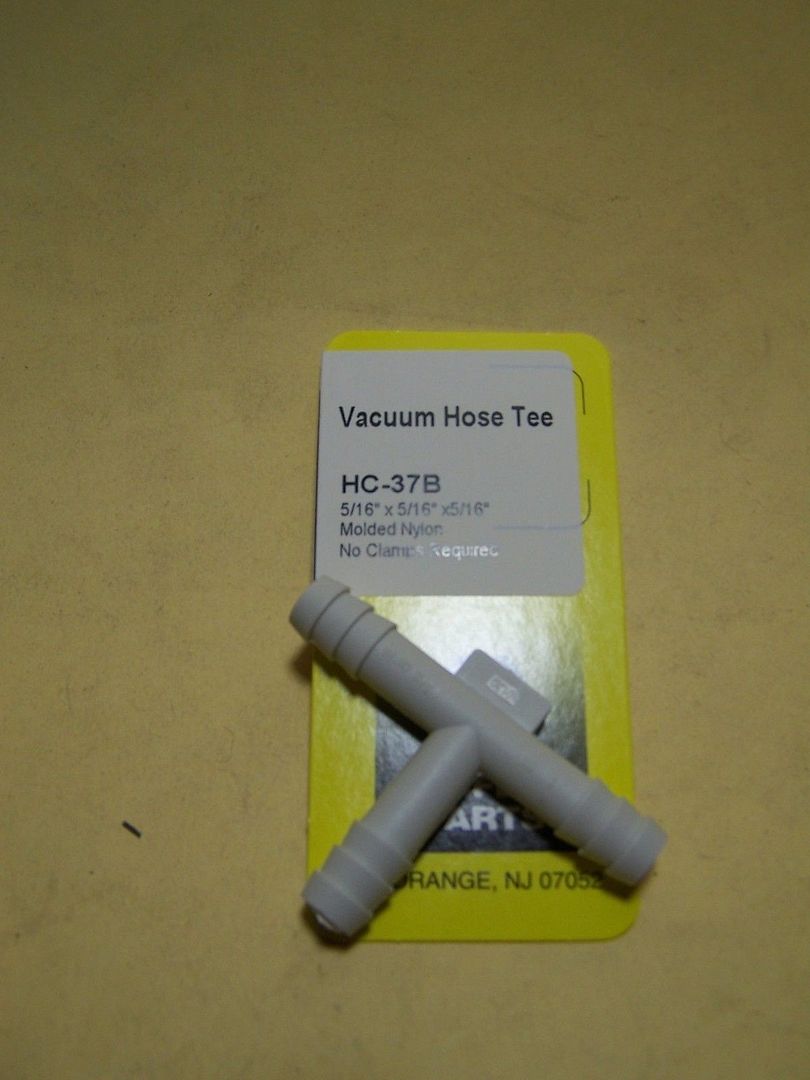

until you get a decent boost gauge and the manual boost controller you can up boost from 7psi to 10psi with a simple little trick we used back in the day. just install a vacuum line T fitting in the same place you would install the MBC, it will bump you up a couple psi and give the car a little more kick. just install the vacuum line coming from the OVCP and run to one end of the T and install the line coming from the actuator on the other end of the T and leave the top unplugged to allow it to leak off air. the air it leaks off will delay the opening of the wastegate and will allow the turbo to spool up a little more. its the same thing a MBC does but the MBC controller has a one way valve and a screw to adjust how much air to leak off.
as far as airflow improvements you can get a K&N filter for the stock air can that will allow a little more flow. a lot of us have converted to a MAFT (mass air flow translator) for a 1st gen eclipse which is what i am running in the pic above of my engine.

Thanks man! I already got a MBC and I was looking for a good boost gauge but I might 'borrow' the gauge of a friend for a while. Now I'm sure where to put the MBC! I'm going to PM you about the MAFT, I think my dad has one like that laying around in his garage. Again thanks for the superb info!

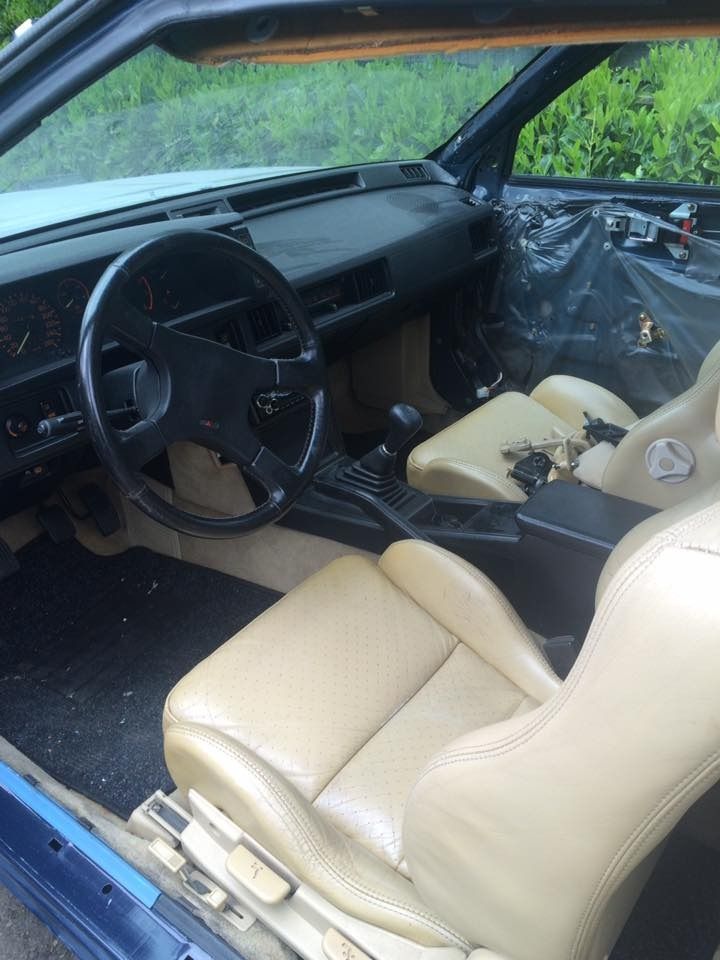

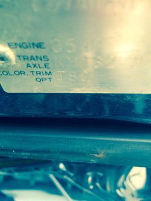

So I couldn't help myself buying a second Starion, certainly with the specs it has...
It's a 89 2.6 widebody, SHP wheels, light beige with black interior, T80 blue color, only 74.000km (46.000miles). The interior, wheels and engine are in great condition! It's a very solid body, it only needs a respray and be assembled. It's a bit of a project but it looks so cool already!
The plans:
- respray it in T80 blue
- lower it with Eibach springs
- gut the cat in the downpipe add an exhaust valve before the second cat
- install A/F gauge, turbo pressure gauge and maybe a fuel pressure gauge
The pictures:
