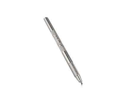

Good video.    I bought a set of punches from harbor freight for this exact purpose.   Had zero luck with an exacto knife on cutting holes for bolts.   The punches work great and they were only a few bucks.    Typically just use scissors for the perimeter, etc and exacto for anything precision.   But it is so easy to over cut with the exacto if not careful

For circles like intake ports I use a nylon cutting board and an xacto swiveling blade.  It's a small blade that swivels 360 degrees so you can cut circles as easy as drawing them with a pen.  For bolt holes I used a punch.
