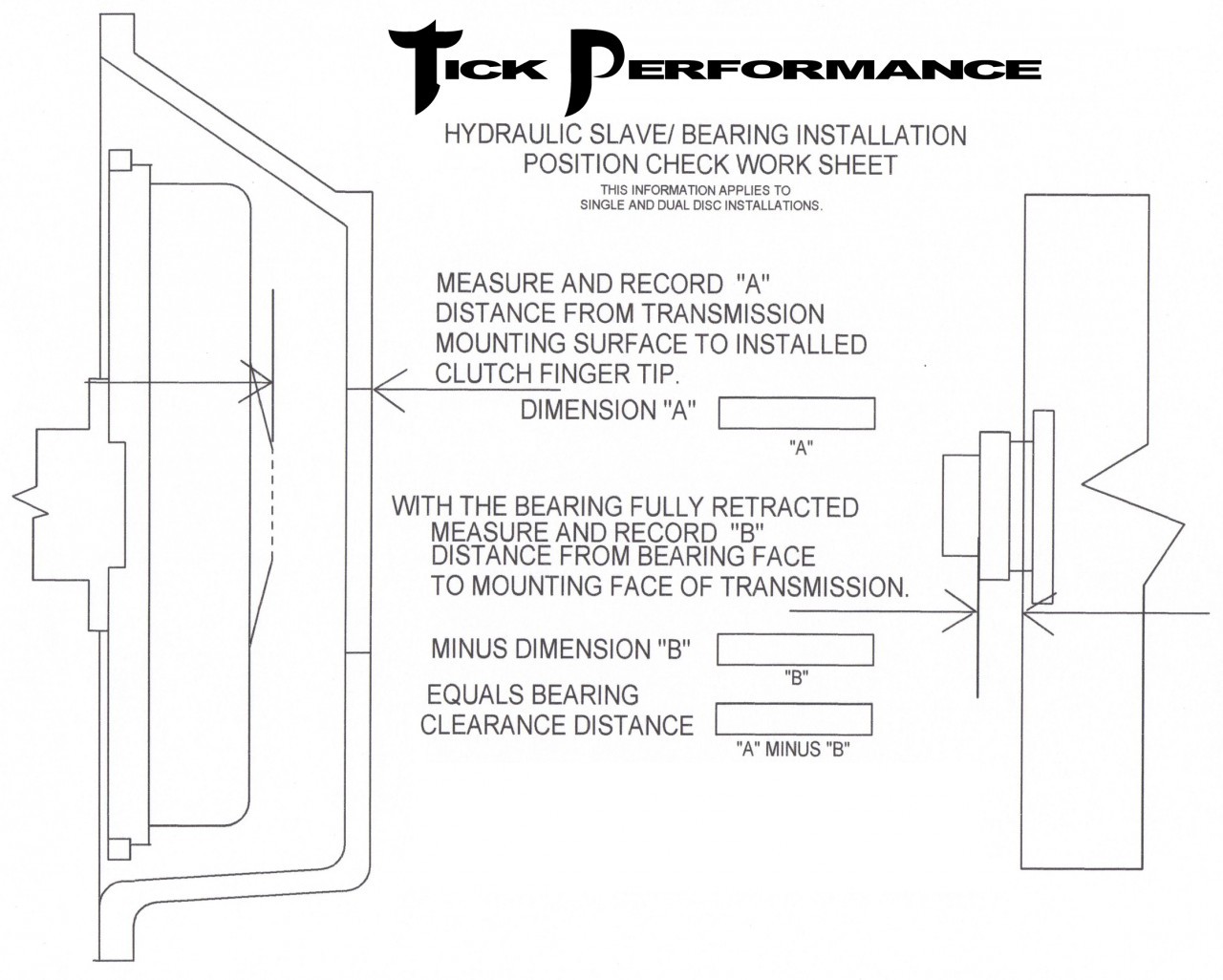

Im little late, but this may help others down the road.  Some slave cylinders may require shimming.  Just another piece to the puzzle....
https://ls1tech.com/...-need-shim.html
