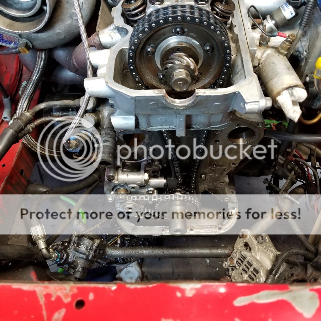

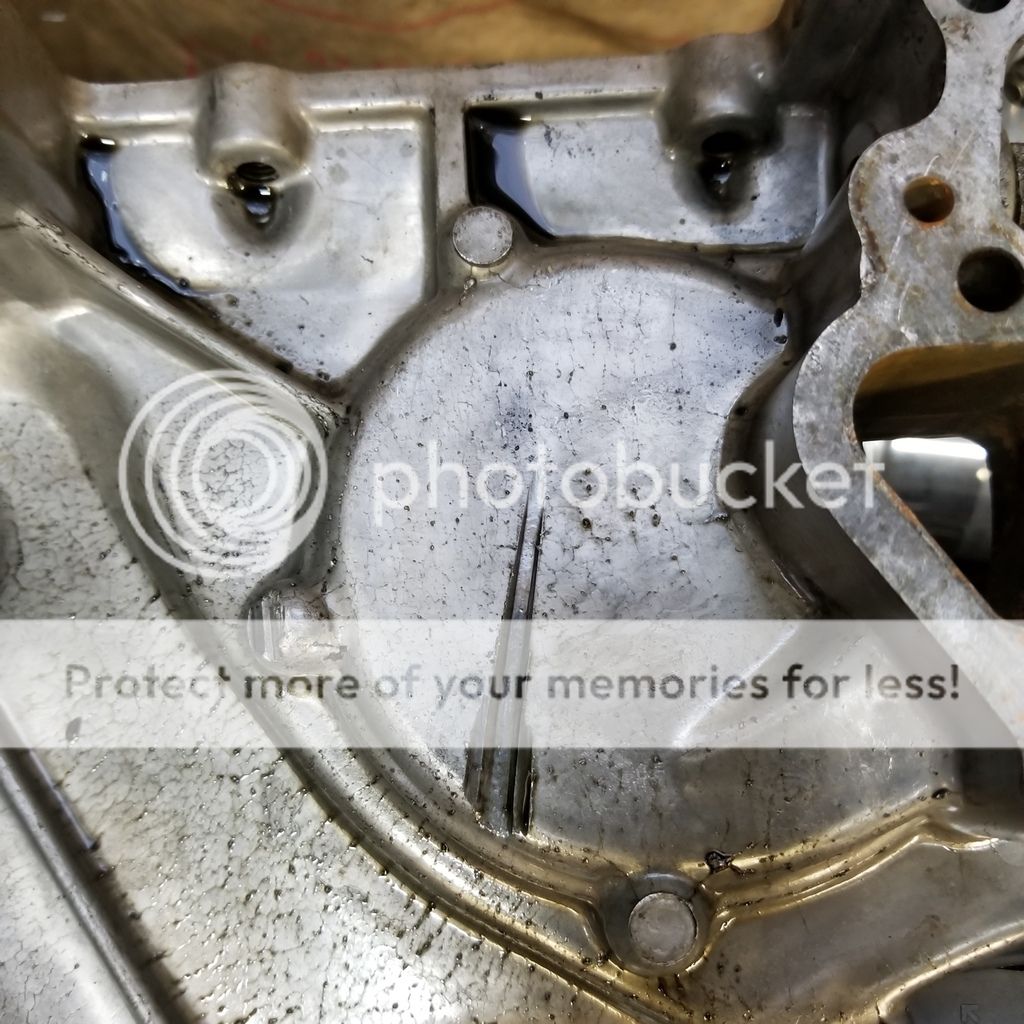

Posted 04 May 2018 - 04:47 PM
Well some much for having it running...lol.  when i had the valve cover off i was looking at the cam gear and had noticed the timming chain rubbing the timing cover. Not good. Went to the manual and found that when i built it 6yrs ago i put the timing chain gear on the crank backwards. Also put the oil pump gear on backwards. Had the pull the timing cover

Posted 04 May 2018 - 06:12 PM
All fixed. But i cant find where the oil pump sprocket bilt went to. I may have never put one on. Pulled the pan down qnd its not in rhere. Oh well. I hoping now to have it runnning sunday

#306 BuGG
BuGG
  • 1,963 posts
  • Location:Pennsylvania
Posted 05 May 2018 - 12:58 AM
I bought a car that the previous owner put the cam sprocket on backwards and it chewed up the aluminium in the head/valvecover.  Gotta wonder where all that metal went.  The oil cooler or the main bearings.
#307 starquestJOE
starquestJOE
  • 3,560 posts
  • Location:duryea pa
Posted 05 May 2018 - 01:05 AM
I was wondering the same thing. But since building it i have not put over 1000 miles on in between oil changes. I change it year just because. Doesnt matter if i drove it 1000 miles or 10. I still change it every spring. Car made 500hp to the wheels with it that way

#308 BuGG
BuGG
  • 1,963 posts
Posted 05 May 2018 - 10:13 AM
I just remembered.  When I took the pan off, the oil pickup screen was full of small aluminium shavings.
