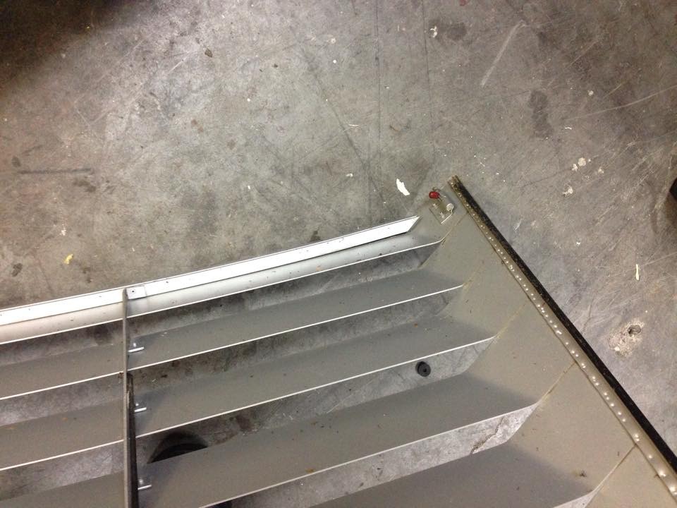

Need Help with LOUVER INSTALL
shadow89
No you are missing parts. There is a piece of sheet metal formed to kind of a u shape that clips to the hatch glass. Tack welded to the sheet metal is another small strip if metal formed into another u shape that accepts the spring loaded rod in the louvers shown in your photo
  • Like 1
Link to comment
Share on other sites
There was a post from a member a few years back who made some sketches of both upper and lower brackets. But I cannot locate it.
I believe there were two types of brackets over the years too. The spring loaded plunger is the earlier model type and is the only type I'm familiar with.
Kevin
