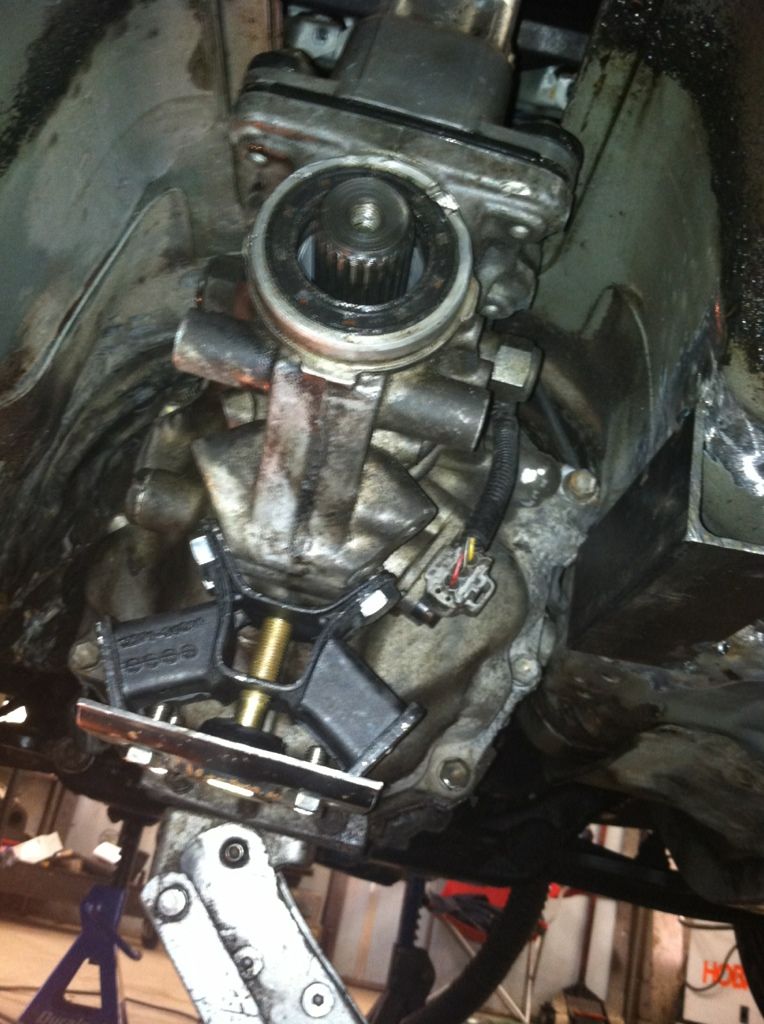

lets see some pictures of what you all are doing, trying to get ideas for how im going to make my transmission mount.

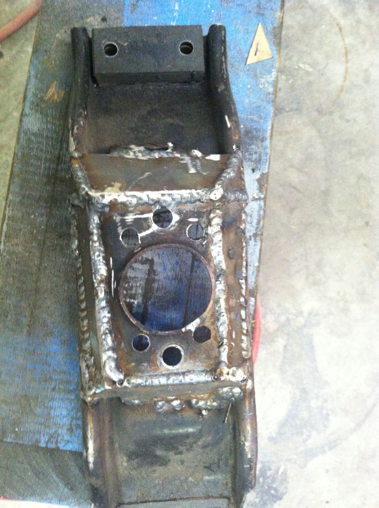

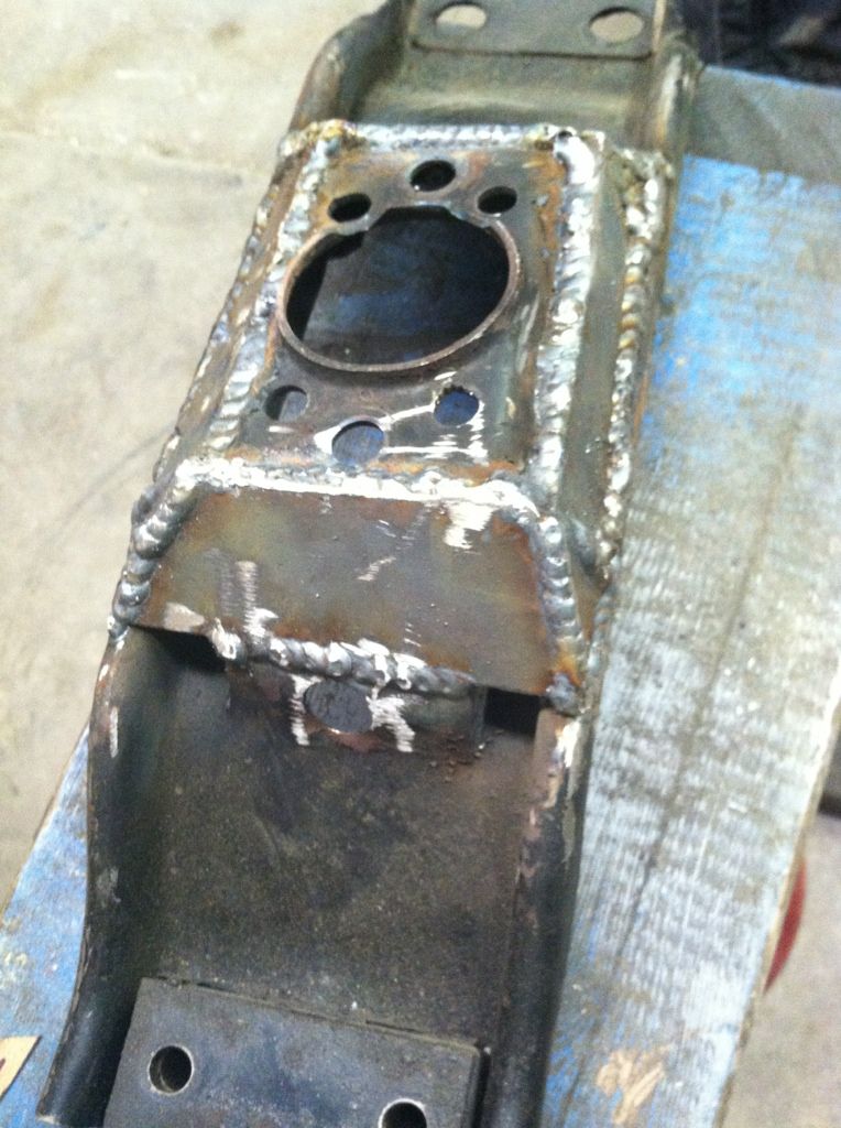

    get it? cars...
Posted 24 January 2013 - 02:02 PM
Posted Image  im working on producing these or similar product, if there is demand

I like the idea, i may use something similar when i go to make mine. im not exactly sure how i want to do it yet until i get under there and look.. your is a solid mount correct?

yes its solid.  in about a week, ill be able to drive the car and give a detailed review on them.

the only thing im concerned about is how far back the actual mount is from the bolt holes.. its all hanging at the back and those are small bolts.. i like the idea for sure though

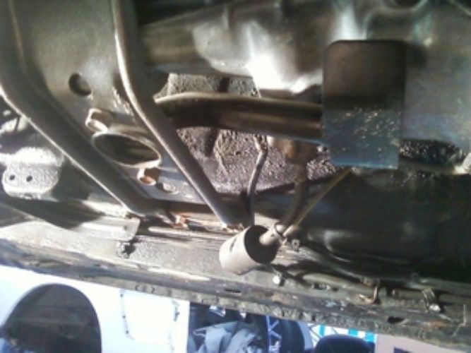

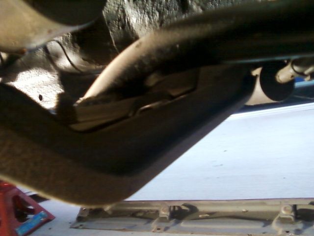

Its not a JZ swap, but an auto to manual swap in my fiji, It may give you ideas or a direction anyway. Its a torsion mount I fabbed up myself to use the oem holes and oem mount just replaced the rubber with a 7/8" torsion tube. It has held up fine so far.

I like that BC, but i dont think that will work using the R154, because the transmission is in the way of the stock mount where it is so much bigger that the stock tranny.

I wouldnt do solid motor and solid Trans  mount. You need some give somewhere so you don't crack things when the motor torques.

yup, solid trans mount, is a no no

hey vettekiller, do you have any pics of yours? or an easy description of how yours are?

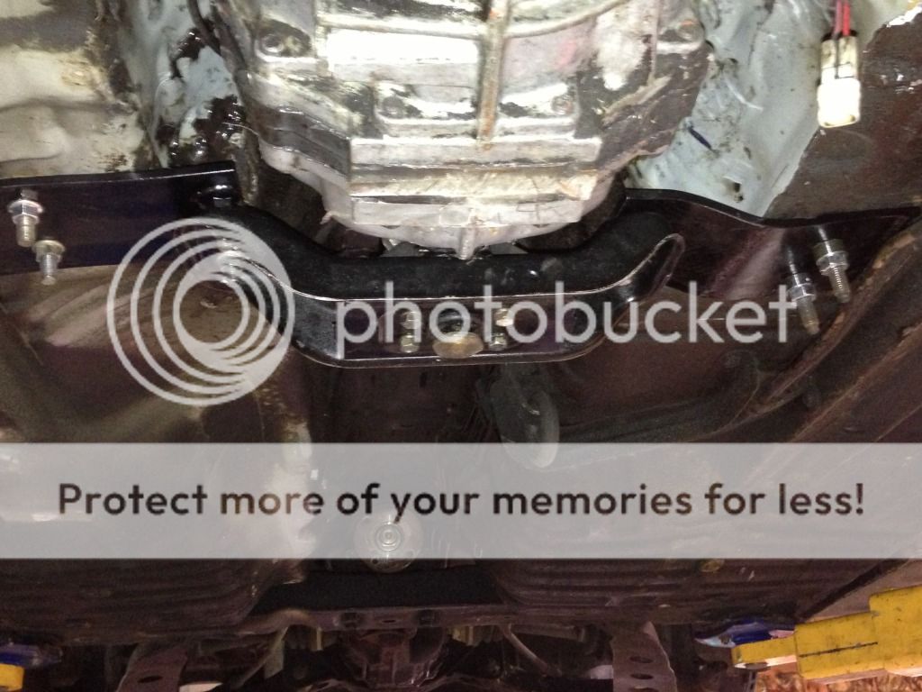

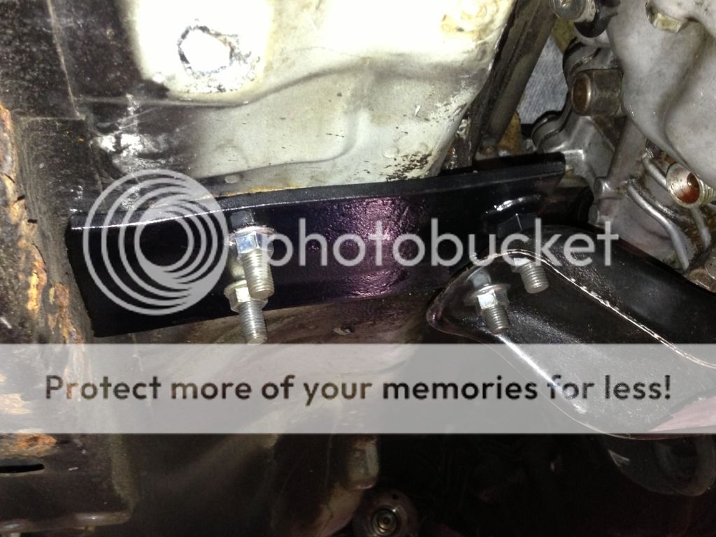

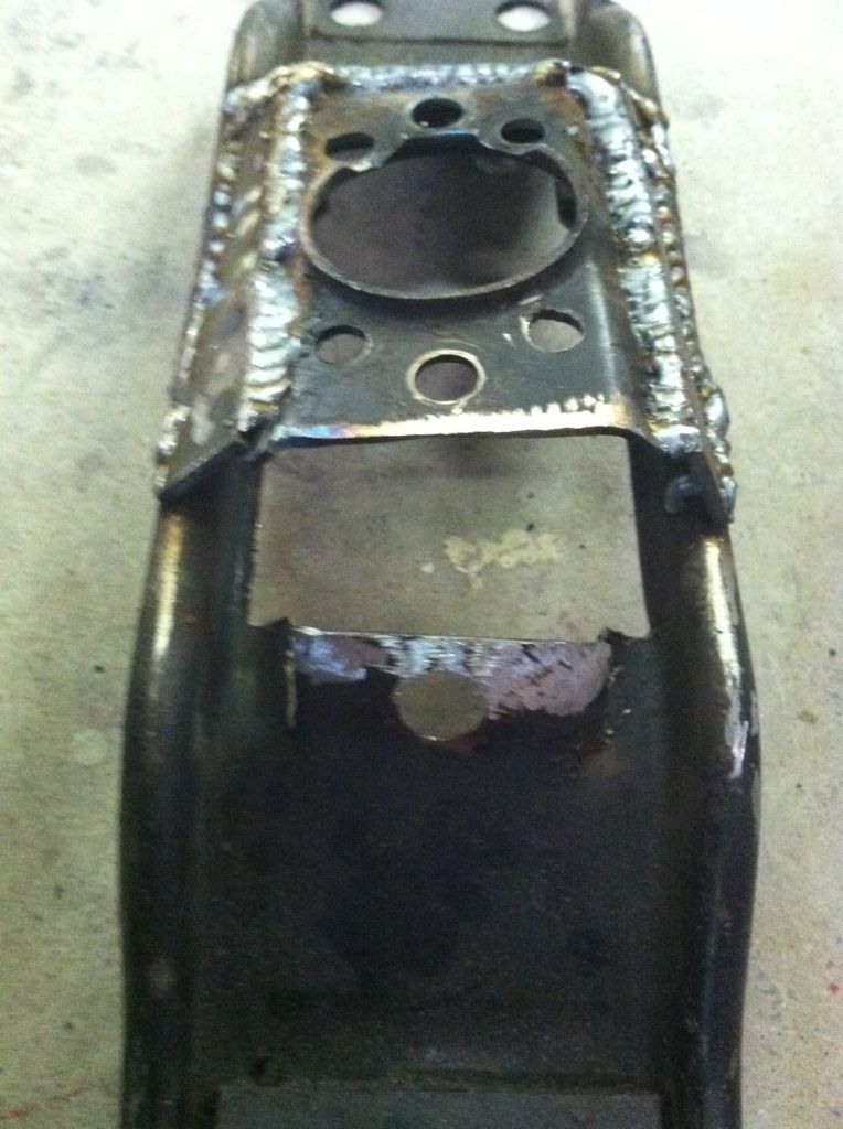

Here are some pics of a swap I'm doing now.
Mine are a little different on my car.

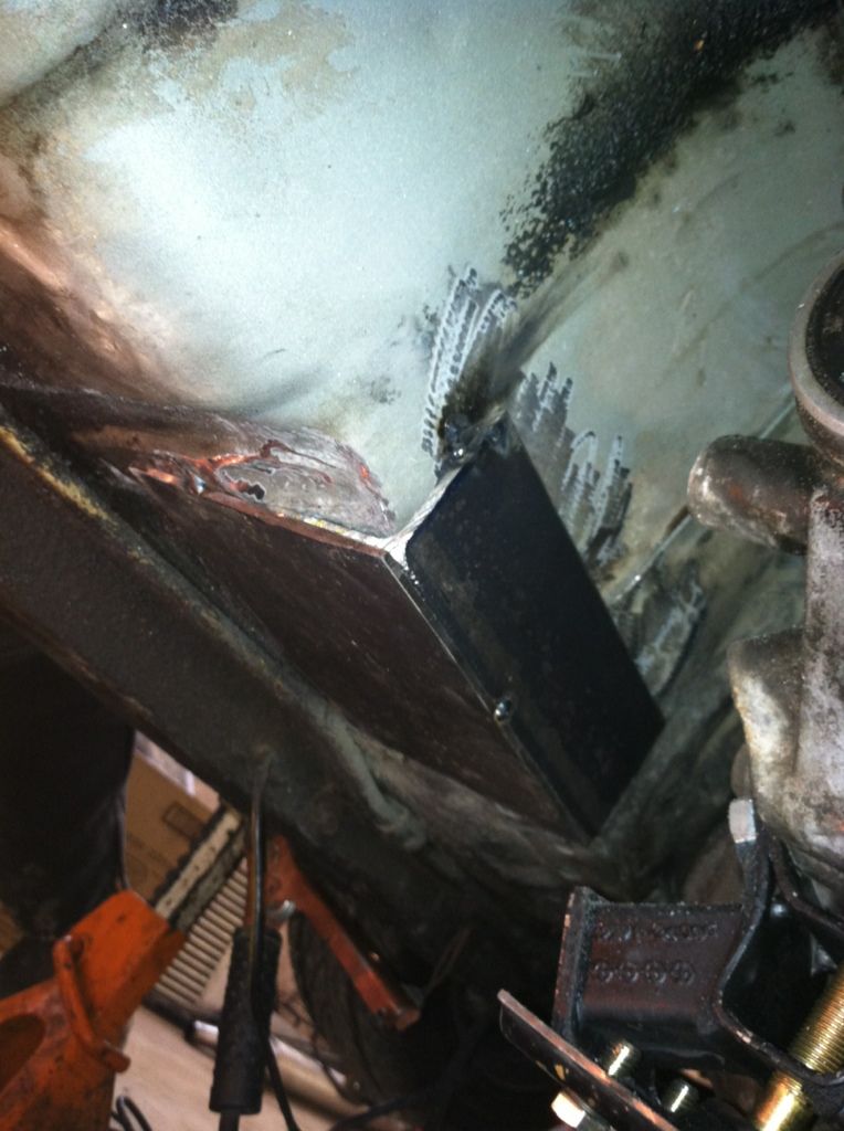

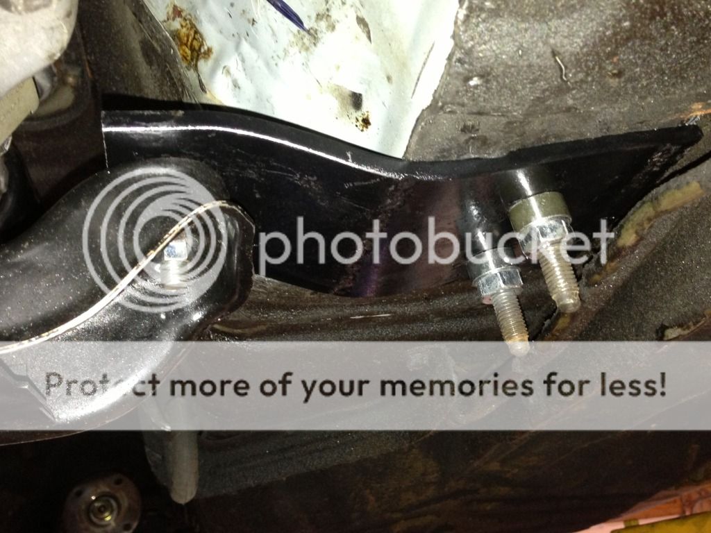

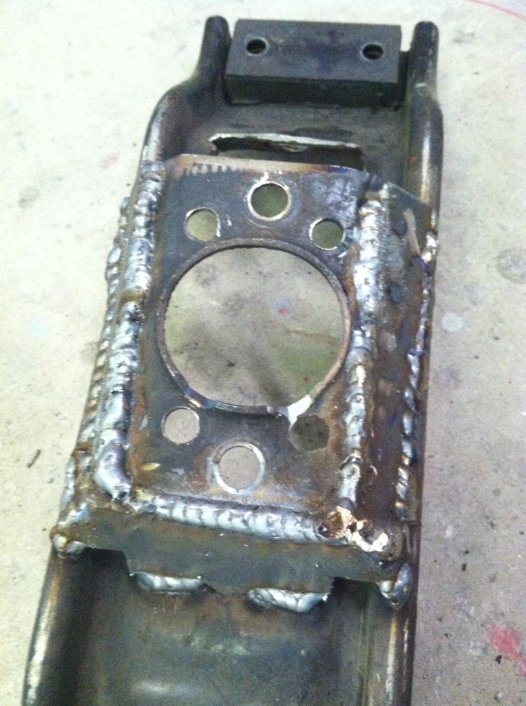

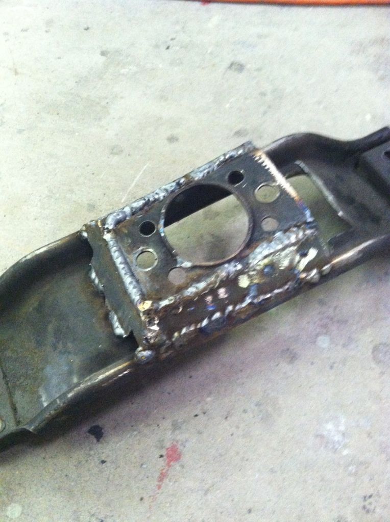

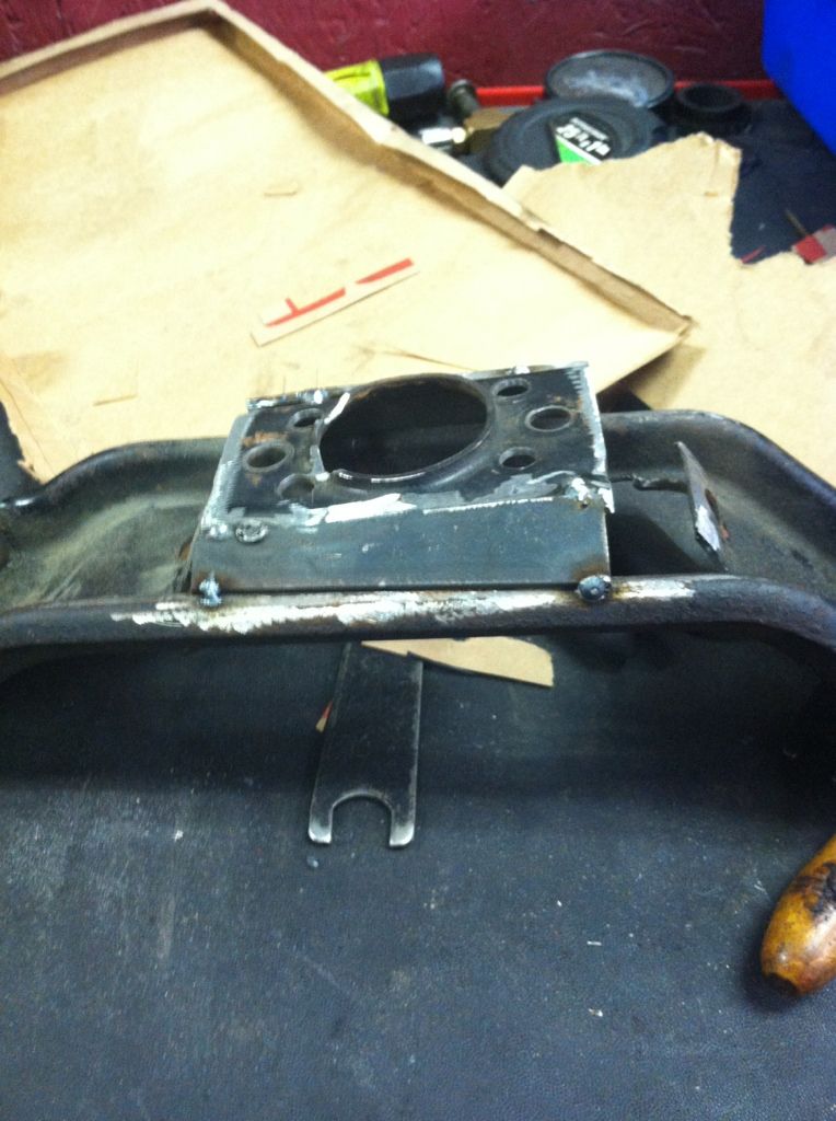

well i guess since i started this, ill contribute..
this is what i came up with.. i dont have a final picture of angle welded to the car. but i boxed in the ends, and welded nuts to the back side so i can just bolt the mount to it like factory
then i cut the center out of a factory starion mount, drilled 4 holes to bolt to the factroy R154 mount and bolted it to it..
I then bolted the rest of the factory starion mount to the welded angle on the car, and used some thin wire to mock out my mount
then just cut some flat plate and filled in the gaps, you can see i had to bend the ends up slightly to clear the R154 mount, but it worked out great
 Convette, on 21 February 2016 - 11:51 AM, said:
How is this holding up?
