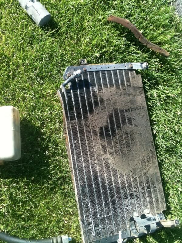

this is what i used between my radiator fan shroud and radiator. but it looks similar to what was originally between my ac condenser and radiator core support.
the foam sealer was so old it was crumbling when i removed my condenser.
this comes in many different thickness and widths. home depot or lowes sells it.

found my old pic. you can see some of the foam sealer in the pic below.
upper right corner in the grass. fell apart when i took out the condenser.
