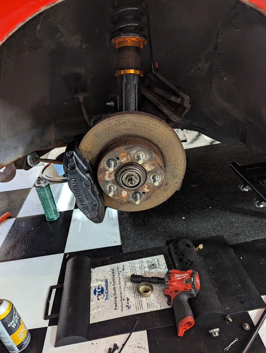

https://photos.app.goo.gl/1wc79U1oNCPjLCaw5
Some pics and size comparisons between 3kgt vr4 calipers and the LS430.
The vr4 are way smaller.
Held both in place with zip ties and it's apparent a standard rim will not fit without a wheel spacer or finding a rotor that offsets further to the back or a combination of both. The face of the caliper has interference with the back of the rim spokes. It looks like i need about 25mm of clearance.
I measure 23mm from the back face of the rotor to the back face of the OEM mounting lug. I'm going to need probably 6-8mm of that for a bracket
Could use 10-15mm wheel spacer and a rotor offset back another 15mm and longer wheel studs could help here. But it I'm not sure how the wheels would look sticking that far out

Please ignore the crappy coilovers, they will be removed before I drive this other car again.
AMWts8DtAXUWY8s0XRcNvwDmn296tedtWxh8cuvA
VR4 Caliper
AMWts8AedpZFNU7iYldvPnqMIvbP_Gn6hLODtQ1B
Needs a spacer but VR4 behind rim
AMWts8AFtEIrTSFaAT9mnSTKdJGqwHGmfI-yaXEK
LS430 Caliper
AMWts8CYBnCUi4uSWogXm08Ab4M41XxofQI9TT7f
LS430 Caliper behind wheel.
The LS430 caliper would be easier to adapter, since it is radial mount, but it might require a slightly larger rotor to accommodate
Edited by tux

Well, I tried 2 wheel spacers - 15mm and 10mm.  15mm has plenty of clearance but sticks out too far for my liking (unless I add more camber), and 10mm looks good, but doesn't clear (barely brushes both calipers.  I need something in between.
Rather than buying another set of spacers that I'm not going to use, I'm going to print out a 12mm spacer and see what that gives me in terms of clearance.
