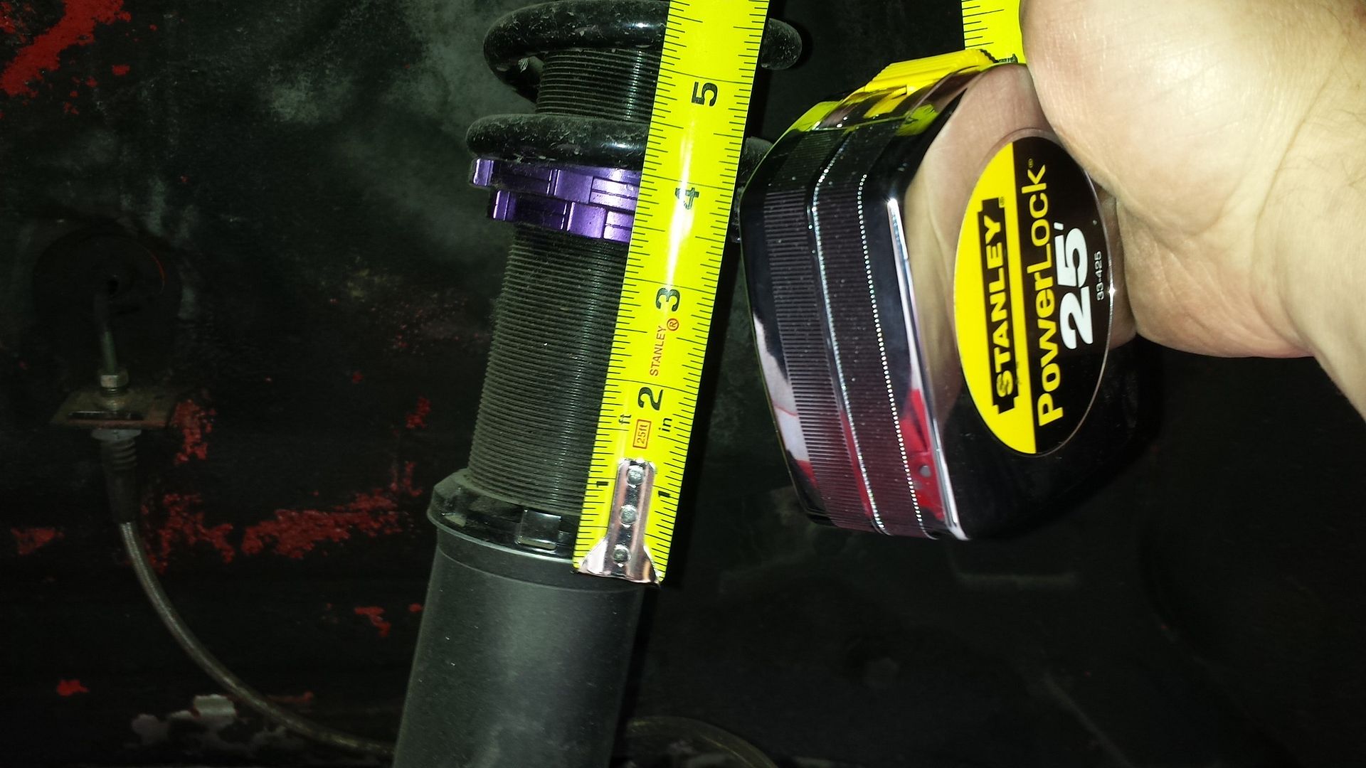

How much of the original spindle casting tube are you guys leaving when you cut them?
The thread by fuze says 2-3 inches. I've also read people only leaving 1 inch.
3 seems like too much, but 1 not enough. So I'm strongly considering 2 inches.
I was thinking there may be potential problem if you leave too much of the original spindle tube, as D2 shock itself would bottom out on it. but it looks like you would have to get the car adjusted reallllllllly low for that to be problem?  From reading threads, it looks like people have about 4 inches from the top of the D2 tube to the bottom of the spring.  I set mine like that, measured inside the tube (since its not welded yet of course) and there was 4 inches between the bottom of the shock and the bottom of the D2 tube.
So long story short, if i left 3 inches of the original tube, when adjusted like everyone else, there would only be 1 inch between the top of the original tube casting, and the bottom of the D2 shock. Which seems like its too close.
This picture is from a thread. I don't know how low his car is though...
