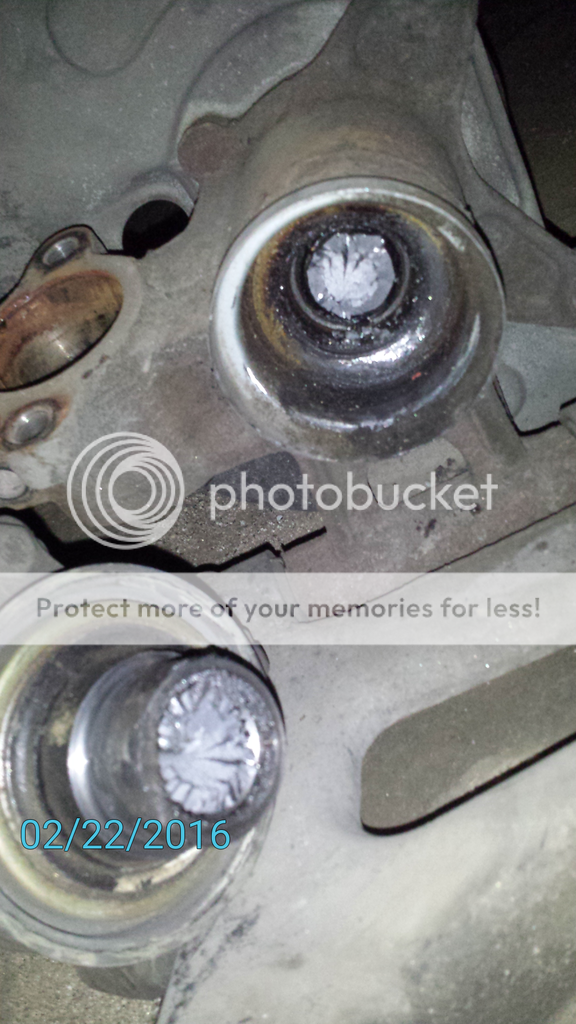

So I lined up for my second run light when green and my car hooked great got about 10 feet and BAAAAMMMMMM!!!! car wasn't moving anymore. Got toed off the track so disappointed. Checked out what happened I broke the hub and the driver side. Was thinking it was the axle.
I'll post up some pics and a video when I get towed home. I have a question tho why won't the car move with just 1 broken hub? It a lsd different so shouldn't the other axle move the car.

did you get wheel hop?
4 bolt or 6 bolt ?

4 bolt axles and no I didn't get wheel hop. The first run I got some wheel hop like 3 4 hops then smooth burn out threw the rest of 1 gear then slammed second.
My buddy told me lower the tire pressure a Lil and the hop will go away. Put the pressure to 18psi. The hop did sure go away and it hooked way too hard and boom lol

http://s924.photobuc...kvhjhr.png.html
Here's a pic of the damage. But it's all good. I pulled the whole lower control arm and spindle as an assembly and swapped out the whole piece. Didn't want to mess with those giant bolts that don't come out of the spindle. My car is up and running again. I'll be at the track again soon to see if I can pull of a 12.8. That's the goal.

i snapped a 87 4 bolt axle in almost the same way, only mine snapped inside the rear end. came off the line very hard hit second and like you say BAM. i got lucky and was moving enough i could cost to the 1/8 mile turn off.
i did however also shatter both ujoints on a 2 step launch and didnt move 2 inches off the start line....lol. i actually have a video of that one happening.

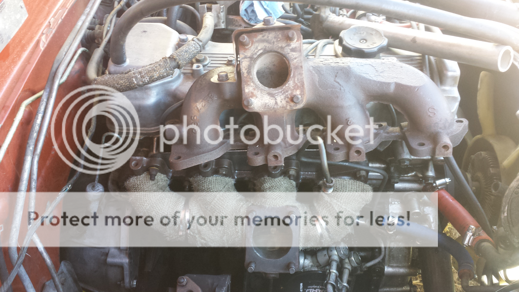

No its not the intake wheel. Are you running the 16g inside the stock turbine housing? And did you port the outlet on the exhaust manifold? If so it's holding back a lot of power.
I had a 16g 05h inside the stock turbine housing with a Lil porting and I still wasn't happy spooled fast full boost at 2800rpm but top end no power.
I got a 17c td06 from a gmc scyclone after and it was a beast. I opened up the exhaust manifold hole from 2in to like 2.5in. Put a t3 adapter plate on to fit the t3 housing. My car boost up slower have to wait till 32 3300rpm now but it had power up top now. But it didnt have the kick the G wheel had.So I took the next step and put a 18g wheel in there and it made my car even more beast.
So if u want to make power ditch the stock turbine housing and get a t3 t4 something like that. And port the hell out of the manifold will make a huge difference.

http://s924.photobuc...html?sort=3&o=2
Here's a pic of what I do to the manifold. I even get in all 4 runners and smooth everything out as much as possible. Made a huge difference even on a 12a. Port Match everything the best u can.
