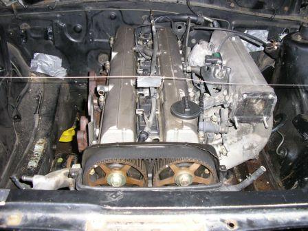

Laodicea Posted December 18, 2009 Report Share Posted December 18, 2009 1989 Chrysler Conquest TSI 2.6L 8v OHC to 3.0L 2JZ-GE 24v DOHC Turbo. This build will be directing any kind or references of modifications towards the Conquest/Starion. Engine references are 2J of course unless noted otherwise. Kudos to Highly Boosted and serpentkilla for their successful 2jz swap threads. So back in June of 09 I popped a head gasket on the 2.6 for the last time (in my mind) and put my car in the drive and pondered. I almost wanted to get rid of the ol’ Quest again like I had done 10 years ago thinking…never again will I touch these cars. Instead I got an idea and I went to the local pick n’ pull to look for a 4G64 engine. Found it …got it…took it home…went back to look for more things like a DOHC head off the Mitsubishi. But as I was walking I came across this http://i156.photobucket.com/albums/t18/gr8white1/2JZ%20Project/DSC00897.jpg http://i156.photobucket.com/albums/t18/gr8white1/2JZ%20Project/DSC00898.jpg 1993 Lexus GS300…So I said $200 …ok… so what if it is a non-turbo…I am MAD-DAX, ……I can MOD! ….well anywayz. What I thought was going to take a few weeks…turned into months upon months of having to mod this and having to make that. I did all the work to this thing and had to learn a lot in the process being that it is an engine from a different car that is not supposed to go into this car….Arrr!! http://i156.photobucket.com/albums/t18/gr8white1/DSC00640.jpg The old 2.6….Yank it!!!http://i156.photobucket.com/albums/t18/gr8white1/09-03-09_1912.jpg http://i156.photobucket.com/albums/t18/gr8white1/09-03-09_1913.jpg http://i156.photobucket.com/albums/t18/gr8white1/2JZ%20Project/DSC01082.jpg http://i156.photobucket.com/albums/t18/gr8white1/2JZ%20Project/DSC01084.jpg http://i156.photobucket.com/albums/t18/gr8white1/2JZ%20Project/DSC01083.jpg http://i156.photobucket.com/albums/t18/gr8white1/2JZ%20Project/DSC00969.jpg This radiator is a Autopwr aluminum radiator TOYOTA SUPRA/SOARER 1986-1992 This is what fit best for my build…there are several sized 2jz radiators or even universal type that are out there but you need one with the width below to make it easier.Core size: 375*632*52mm or 14.7x24.8x2”Overall size 465*660*61mm or 18.3x26x2.4”Row: 2If you get a larger than 26” wide like the Supra 93-98 it will not fit between the rails. You still have to cut the bumper brackets (later topic needs pics of that mess). http://i156.photobucket.com/albums/t18/gr8white1/2JZ%20Project/DSC01085.jpg http://i156.photobucket.com/albums/t18/gr8white1/2JZ%20Project/DSC01086.jpg http://i156.photobucket.com/albums/t18/gr8white1/2JZ%20Project/DSC01087.jpg http://i156.photobucket.com/albums/t18/gr8white1/2JZ%20Project/DSC01088.jpg http://i156.photobucket.com/albums/t18/gr8white1/2JZ%20Project/DSC01089.jpg For the A/C compressor pulley to fit. http://i156.photobucket.com/albums/t18/gr8white1/2JZ%20Project/DSC01090.jpg Link to comment Share on other sites More sharing options...

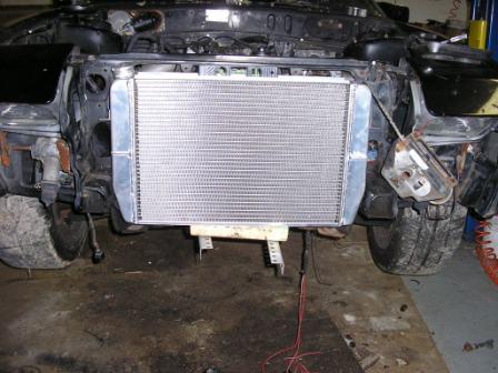

OBSESSIVE_ENT. Posted December 19, 2009 Report Share Posted December 19, 2009 I will start with the "can still turn back parts" lol rad and fan.... what do you think about this Lao, its a little off but.cx racingRadiator: ▪ Overall Size: 26"x18.25"x3" ▪ Core Size: 25"x15"x2.25" ▪ 1.38" Inlet & Outlet ▪ Rows: 2 for $195 shipped. off an ebay murchant and a twin fan set up to be placed between the rad and condensor. I think you say we only have an inch of play between them and the best i found was a 2x12 set up. for 50 bucks Link to comment Share on other sites More sharing options...
Laodicea Posted December 20, 2009 Author Report Share Posted December 20, 2009 I will start with the "can still turn back parts" lol rad and fan.... what do you think about this Lao, its a little off but.cx racingRadiator: ▪ Overall Size: 26"x18.25"x3" ▪ Core Size: 25"x15"x2.25" ▪ 1.38" Inlet & Outlet ▪ Rows: 2 for $195 shipped. off an ebay murchant and a twin fan set up to be placed between the rad and condensor. I think you say we only have an inch of play between them and the best i found was a 2x12 set up. for 50 bucks Yes taht will work...I paid $175 shipped...put the fans on the engine side of radiator...I'll post those pic later..tonight I am sorting through them and writing the info....but my next post will be the fuel rail and intake... Link to comment Share on other sites More sharing options...
