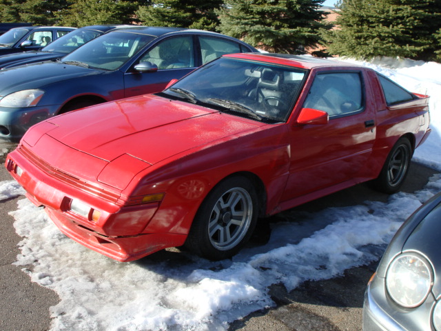

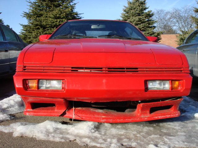

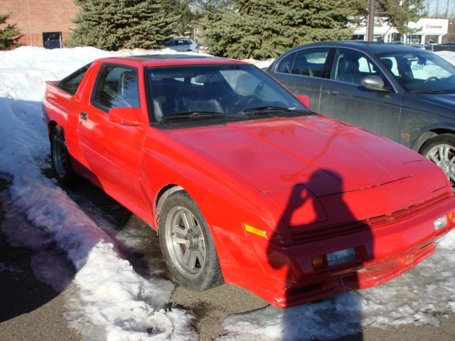

nekkidlad Posted March 9, 2011 Report Share Posted March 9, 2011 I have a '88 chrysler conquest tsi my dad got for free from one of his cousins...I was wondering if anyone can help me out a bit. A little back story on the car..: It has about 150,000mi, it was originally my dad's cousin's wife's DD, then it was their summer toy, then about 7 years ago they stored it untill about 2 years ago. In that time they took it out as a toy again, and they went to some quick lube and they didnt tighten the drain plug so the engine seized up(the shop payed for a new motor), after that it was stored again(with about 300-500mi on the new motor). They say it ran fine after it got the new motor. About 7 months ago one of their neighbors was house sitting, while they went on vacation, and he took the car out for a drive and ended up having it towed back to the house because it was stumbling and rolling the idle and such like im having, and untill about a month ago where we got this car, its been stored since that time. The issue: It cold starts fine but when it starts to heat up a bit the idle starts to roll, from about 1100-2500rpm (im assuming once it gets to closed loop, then something makes it roll). In park or neutral, you can free rev it to redline no problems, till it starts to surge (like mentioned above), you can hold the throttle at any position and it'll still roll but only go up to about 4000rpm and then go back down and roll again back and forth. If you stab the gas, wether in gear or park/neutral, it stumbles and if u leave the throttle open it stumbles and dies If the car's in reverse or neutral, if u stab the gas it stumbles, if you feather the gas it revs up just enough where the boost gauge(OE) to read about 1-2 lbs of boost and then it stumbles and eventually dies if u hold it, (i havent looked at the rpms when in gear..and i've only brake torqued it). What ive done so far: I've checked vacuum(even tho there's a boost gauge), drained the old fuel and installed a new fuel filter(in the engine bay), and put new fuel in it and a bottle of injector cleaner(that stuff you just dump in the fuel tank...figured it wouldnt hurt any and maybe it'd help a bit), cleaned and re-gapped spark plugs, changed the oil, inspected that every connector is plugged in and all vacuum hoses connected, sprayed brake cleaner all over the engine compartment, intercooler and all intake piping looking for possible vacuum leaks. I did find the MAF was disconnected when I originally got the car so I plugged it back in, I also found the blow-off valve/wastegate was seized and not moving (I did free it up but theres no movement on it anyway with or without vacuum and I cant see with boost/pressure since it wont go into it), also I tried disconnecting the upstream 02 sensor and nothing different happened, I did get it to smooth out the idle to normal if I disconnect the MAF sensor but if I touch the gas it just stumbles, and theres another connector by the fuel mixer/TB that when disconnected smooths out the idle some, it makes it roll about 2/3 less. Im not sure exactly what the connector is for, I THINK its for the idle air motor/controller (its one of the round connectors at the mixer/TB, if I remember correctly it has 2 black wires, I think one has a white tracer on it)... (Ive only spent about 3 hours "working" on it because I live at an apartment where auto repair is prohidited, I work at a car dealer as a mechanic, I rarely have time to work on it exept at the end of the day possibly 2 days a week IF we have no other cars to work on...AND if I dont need to get home to do other things right after work..AND if there's somebody else there(with more experience) I can use to help me bounce off ideas as to what we could check next to see if it may fix anything...). Recently I found an online service manual and a vacuum routing diagram...and a couple of conquest/starion forums like this one) I also thought about checking the fuel pressure but, I dont know anybody with a banjo fitting that I can use(to check it at the fuel filter where it's the only location I can see to check the pressure)..my THOUGHT is that there's something wrong with the turbo or the blow-off valve/wastegate(stuck open). Any other thoughts of what I could check, and how would be appreciated. My manager used to be a manager at a mitsubishi dealer when the satrions and conquests were still fairly common on the streets(at least here in michigan), and he said it could possibly be the idle air motor/controller that has gone bad. He said it was soemwhat common for them to go bad and do the same thing. Attached are some pictures of the car...Not that they help with diagnosis but at least you can see the car.. Link to comment Share on other sites More sharing options...
