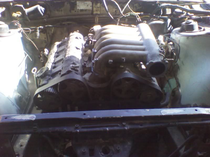

Posted 18 November 2011 - 04:49 PM
Pics!!!!!

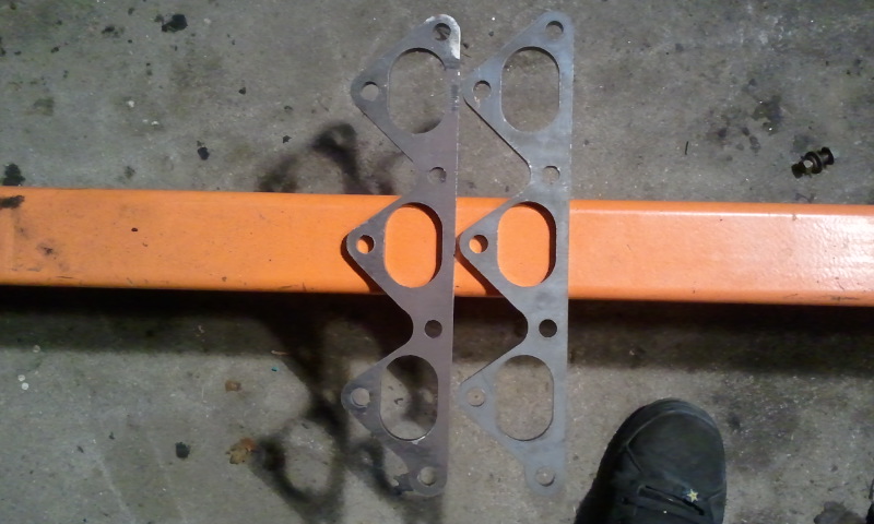

if you need exhaust header flanges, I have a set I will sell cheap.
-Jay

Posted 18 November 2011 - 07:19 PM
just the flanges so you can custom make a manifold. they are for the dohc motors.
I think you would use 1.75" piping. I made a set of headers for a local guys neon with a 6g72 swap. (dumbest swap ever)
And If I were you, I would move the motor farther forward than in the picture. Consider if you have to undo the trans/motor bolts or cas bolts or just reach behind it at all.

Posted 19 November 2011 - 09:11 AM
The intake is off a 2002 diamante so it faces forward, It interferes with the booster by an 1/8th in but it will work when its trimmed.  Only issue I have is the brake booster is touching the corner of the valve cover.  The motor in the pic looks like it is really far back but the bellhousing is protruding in to the engine bay much farther than the conquests was.  I can easily undo the top bolts from over the valve covers and I could mount the starter too..  I would consider moving it a little farther forward but the intake is Really close to the hoodline now and the steering is in a good location in relation to where the trans bolts up.  Ill look at it today.  The block was easy to mod to fit the montero mounts, I had to remove a 1/4 inch off a casting nub and they bolted right on.. They have a really strange metric pitch thread though.  I had to get them at napa.  They are 1.75 pitch, so are the bellhousing bolts.  I have the tranny in there too, its a tundra 2wd with a mitsubishi montero bell.  Bolted right up and fits great..
Edited by steppesquest, 19 November 2011 - 09:12 AM.
#11 steppesquest
steppesquest
  • 37 posts
  • Location:florida
Posted 19 November 2011 - 09:16 AM
The pan looks like it will fit no problem but i cant say for sure because they sent me the wrong one.. I need a 4 bolt main pan and i received the older 2  bolt style with a narrow opening.  And... after trial and error, no other pan off a montero or anything else will work.  The 4 bolt girdle is so large.
