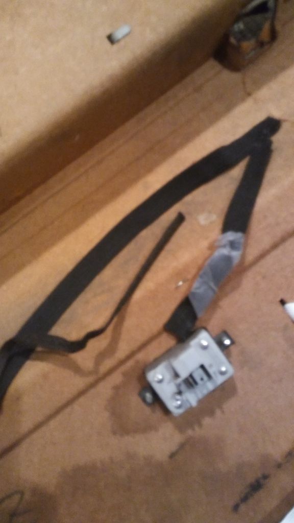

this is what we started with

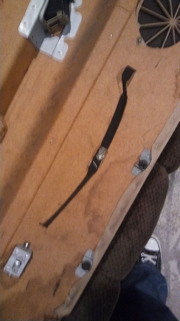

the worn out factory elastic that has been there for the last 27 years
first step was to cut it

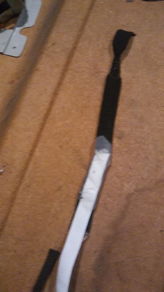

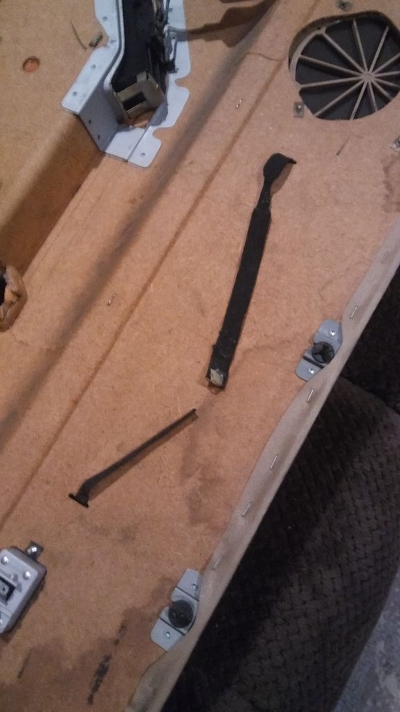

taped new elastic to it.

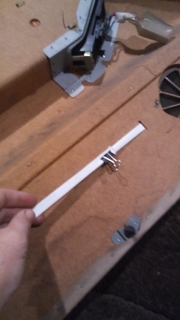

i found that 3/4" is too big and walmart didnt have 1/2" in black

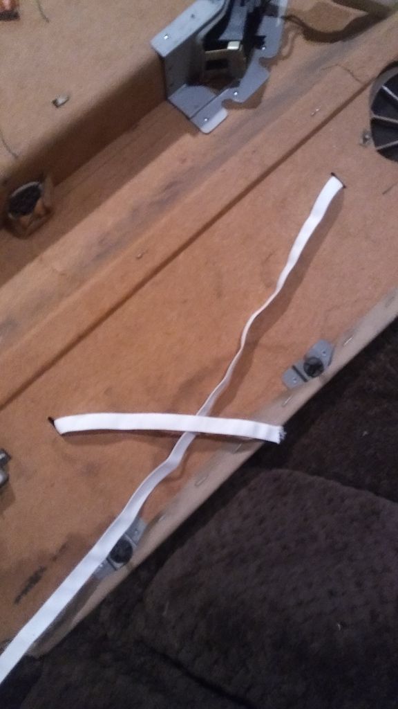

used the old elastic to pull the new elastic into place
here is the old elastic after i pulled it out

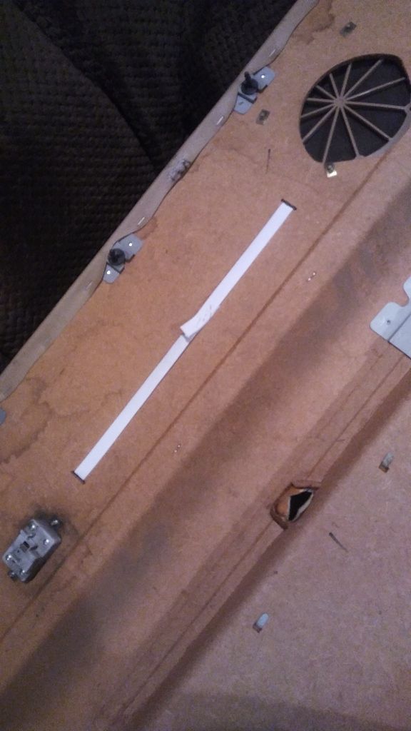

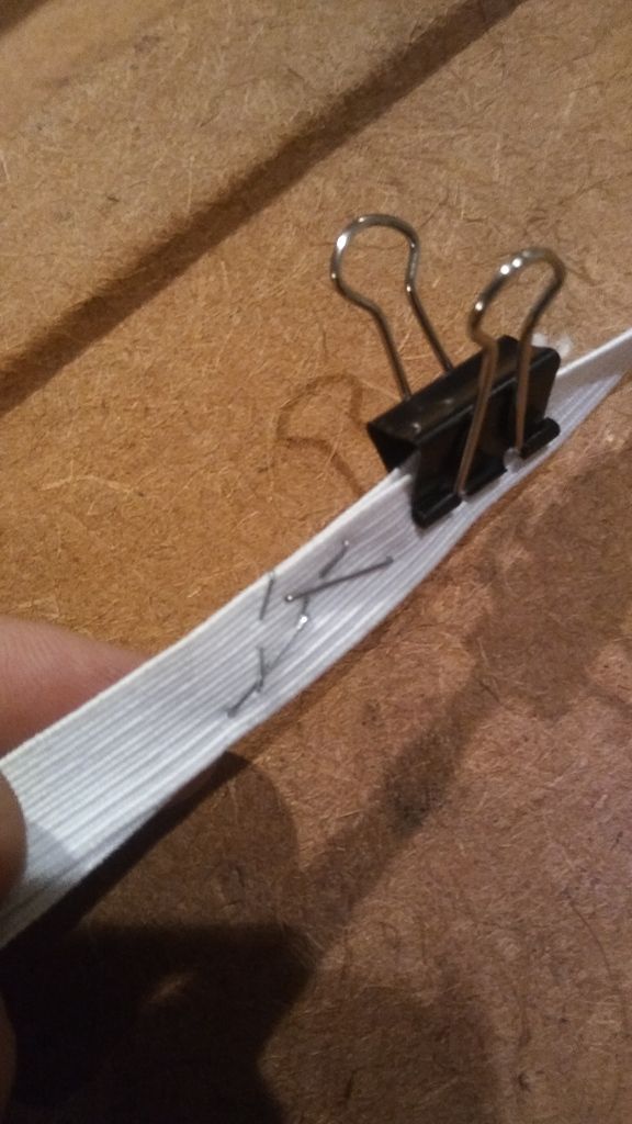

i used a small binder clip just to hold the 2 ends together for the next step
stapled it 4 times.... i crossed my staples from opposite sides even though the factory only used 3 staples from the same side
here is the result, i pulled the binder clip off

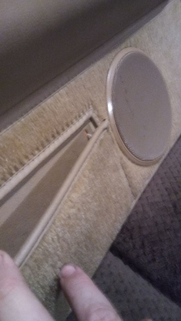

i pulled it open and you can barely see the white elastic in there, the black was much more noticeable

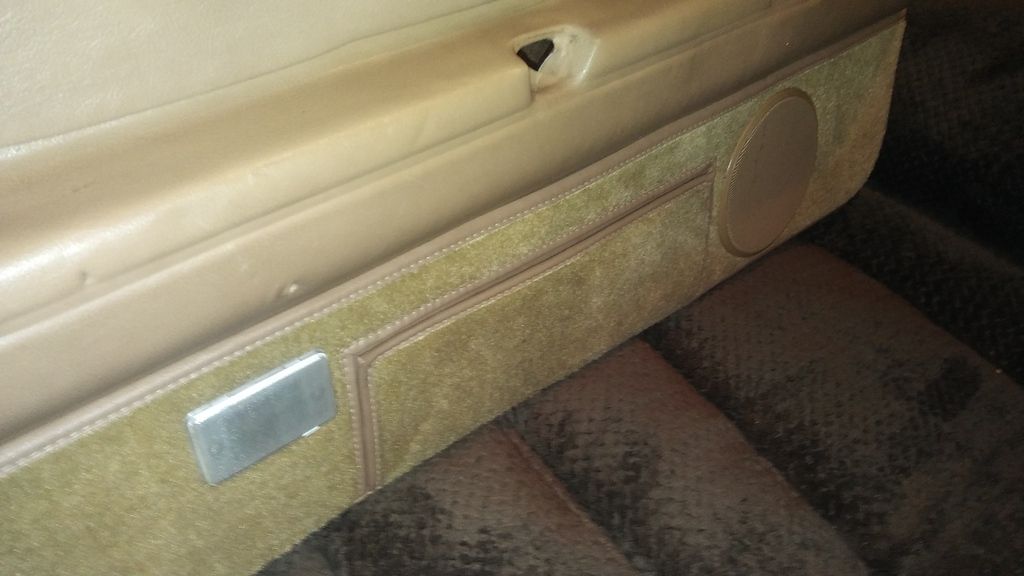

here is the tan one all finished up

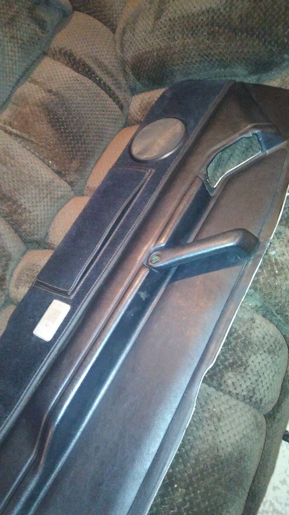

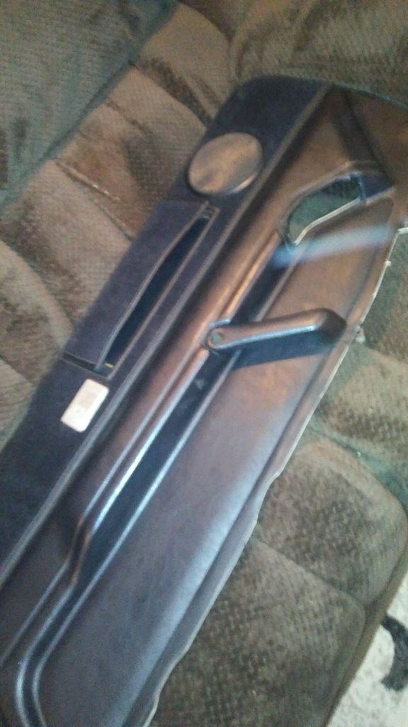

the result on the black one i used for practice ( first pic for comparison)
