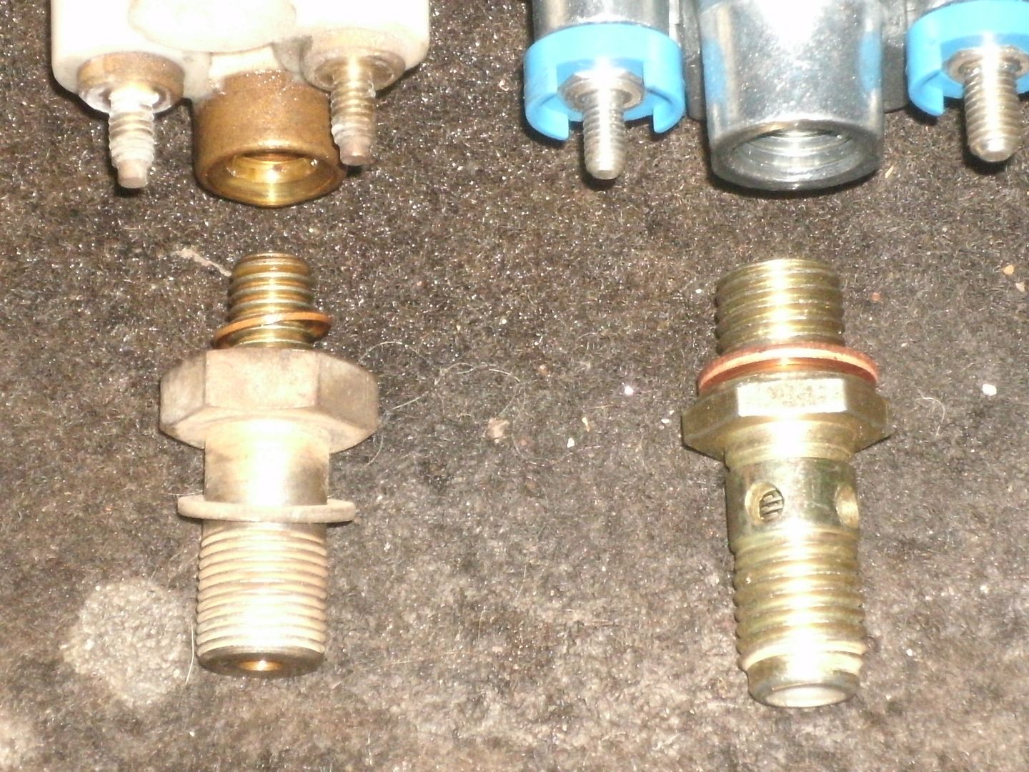

looking at that bottom pic i think i am going to run to the autoparts store and see if i can find a adapter to fit the old piece into the new pump.

i wasnt able to find an adapter to make the pump work but once i pulled the intank filter i knew there were more problems then just the pump. the tank is pretty rusty and i ended up pulling the tank and pump from my 87 so its down right now until i find a donor tank. it is a little hard to tell if its rust or just old gas caked to the inside but i had to swap the filler necks also because the 84 filler neck was very rusty. if i would have put gas in that filler neck it would have flushed all kinds of rust down into the tank.
once i got the tank installed i hooked direct power to the pump and remove the line running to the TB and let it pump gas until the gas turned clear and i did this with the old fuel filter still installed. once i saw it was clear i changed out the fuel filter and started it up and the car purrs like a kitten.

well i did not return the ebay  pump because i picked up a tank from larry and it had a pump on it but when i hooked up power to it nothing happened. so with some backyard mechanics, a drill, pieces of hose, about 4 hose clamps and a couple other pieces i got the pump to adapt to the 87.
it kinda sucks that its not a direct bolt on pump because the old pump was showing about 34psi at idle and this ebay pump is showing about 38psi. its a tad noisy to hear it running by itself but you cant hear it once the car is running. either way they are both running again.
