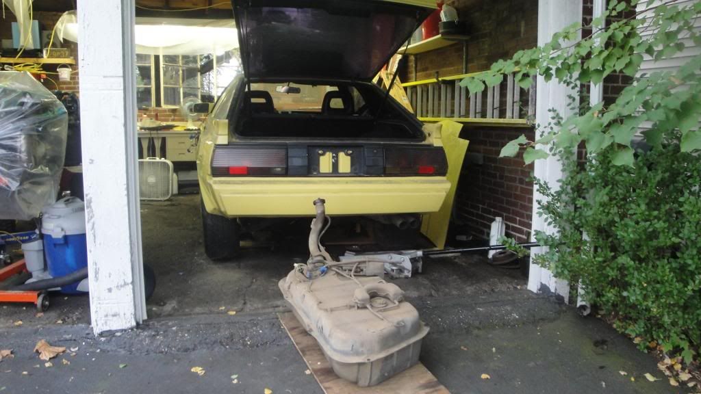

I think that took me about an hour without a lift. Just a jack, jack stands, and a piece of plywood.
