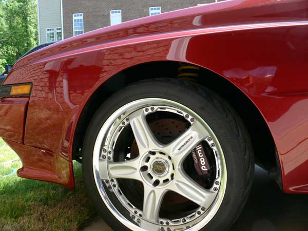

I seem to remember someone using vr4 brakes, a custom bracket, and crown vic rotors
but i know they didnt clear stock wheels (not that you care about that)
other than that the only other successful do it yourself seems to have been maxzillian with his wilwood setup
