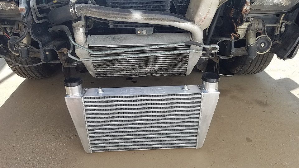

I do plan on running a larger intercooler.
I like that IC.  Who makes that one?  I just upgraded to the CXRacing ... but that one looks bigger.

techboy, its just an off brand on fleabay. Its 23x13x3 with 2 1/2 pipe. I got it since it fits where the factory one is and wont take to much to install.
It was $95.
Jonathan

UCW is that an Isuzu NPR intercooler?
Yes and it barely fits between the frame rails.

That is a monster!
