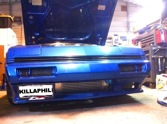

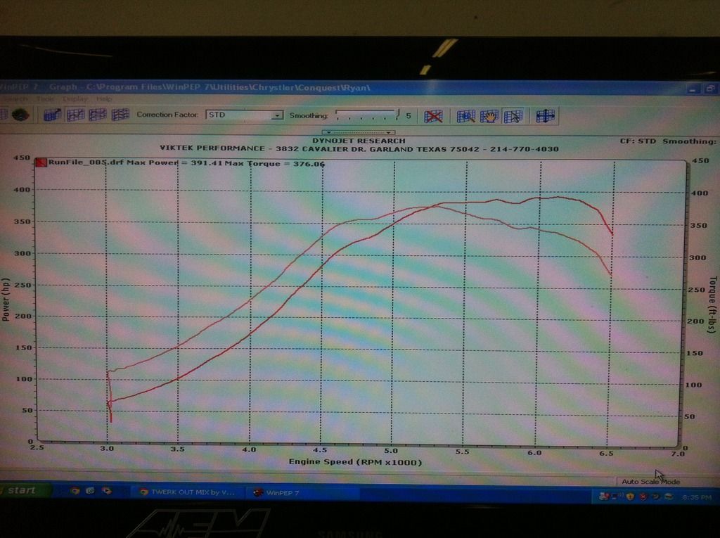

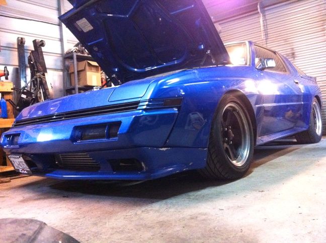

This is how a power curve should look!
Built & Toond by FunkyPhil
Wiseco 8:1 Block
Magna MPI
M28 Head
Funk Lab Cam
HX35 @ 24psi
Stock Exhaust manifold
AEM Water/Meth Inj
MS1X

Nice Ryan!!!! Good Job on it. power stays on up top very nice.

Im very pleased with the results. Definitely surpassed my expectations.
I have to thank Ryan for the trust and freedom he gave me with the build. When it all started, we were shooting for an awesome street car. So much so, we stuck a stock cam in it and with some degree changes, it made pretty good power that pulled to 6k. When we put in the custom FunkLab Camshaft, EVERYTHING changed. It was like the car chugged an energy drink. 6500rpm arrives in a hurry! Not what most would expect from such a simple build or a G54B at that!

that is a sweet number on the dyno great build.

Can we see the stock cam dyno chart?

There isnt a stock cam dyno chart.
Tye/wrngwae has a stock cam in his hx35 car

Good Job!
The dyno graph looks similar to mine on a 60-1 @18-19 psi

Ryan and I have very similar builds. Only I have. Stock cam. It is retarded 3deg.
