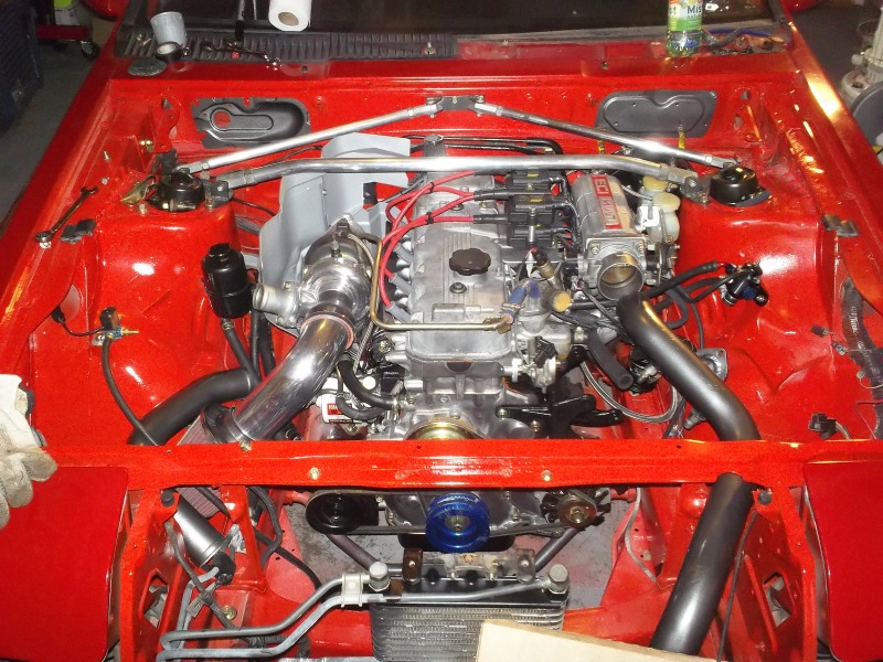

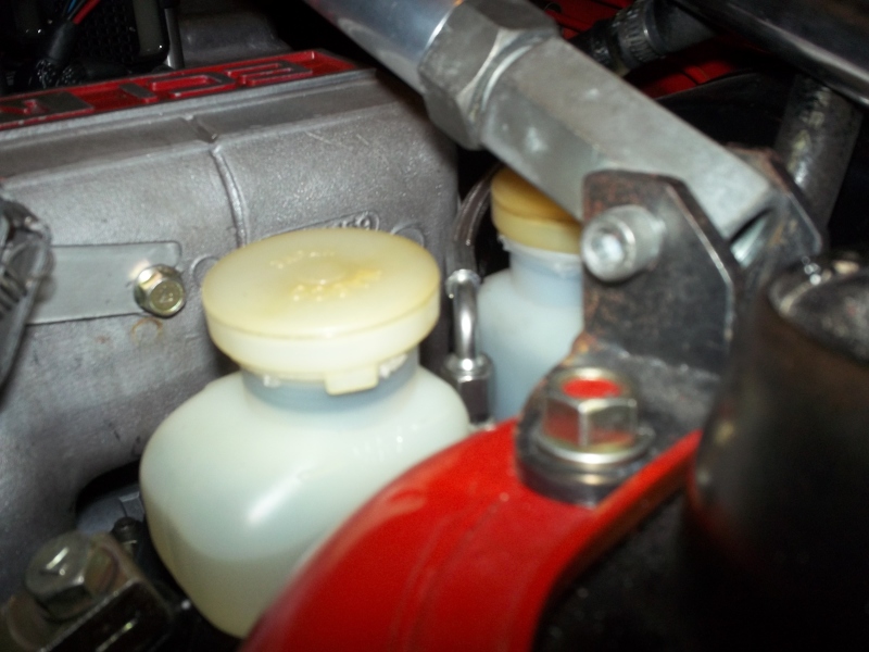

Nice build on the car and the upgrade on the lighting everything looks nice and clean
and well thought out. On a side note your missing a bolt from the water pump pulley,
and how did you do the datsun z brake mod?
Link to comment
Share on other sites
All the bolts are there, pic was taken while installing the pulley. At the time I was reinstalling everything from repainting the engine bay. Datsun Z Brake Reservoirs are a direct bolt on to our master. You have to use a abs delete line as the stock line wont clear the containers.
Edited by Turboat
Link to comment
Nice parts list. What kind of power are you making?
Needs a retune as there is question if the Centerforce was slipping on the dyno, currently 300/330. Centerforce DF was missing 3 sections when it was pulled out and replaced with a Sprung CC-Stg 4. Also the DF was a 225 while the new CC is the 240mm.

The DSM Clutch Master Reservoir is also a Direct Bolt on to our clutch and brake masters if you prefer this style.
http://www.lancerproject.ca/images/NewClutchMasterCyl.gif
Friend also followed and used the Datsun Z Containers on his car
Link to comment
What year z for the resivoir.
The ones I have "not sure if they come with the caps, you would have to ask them"
http://www.zcarsource.com/brake-fluid-reservoir-front-brake-large-240z-260z-280z-72-76-new_8_55957_49724.html
There are different style ones like these below, these havent been tested for so I dont know if they would work cause of the lip that goes around the outer edge.
