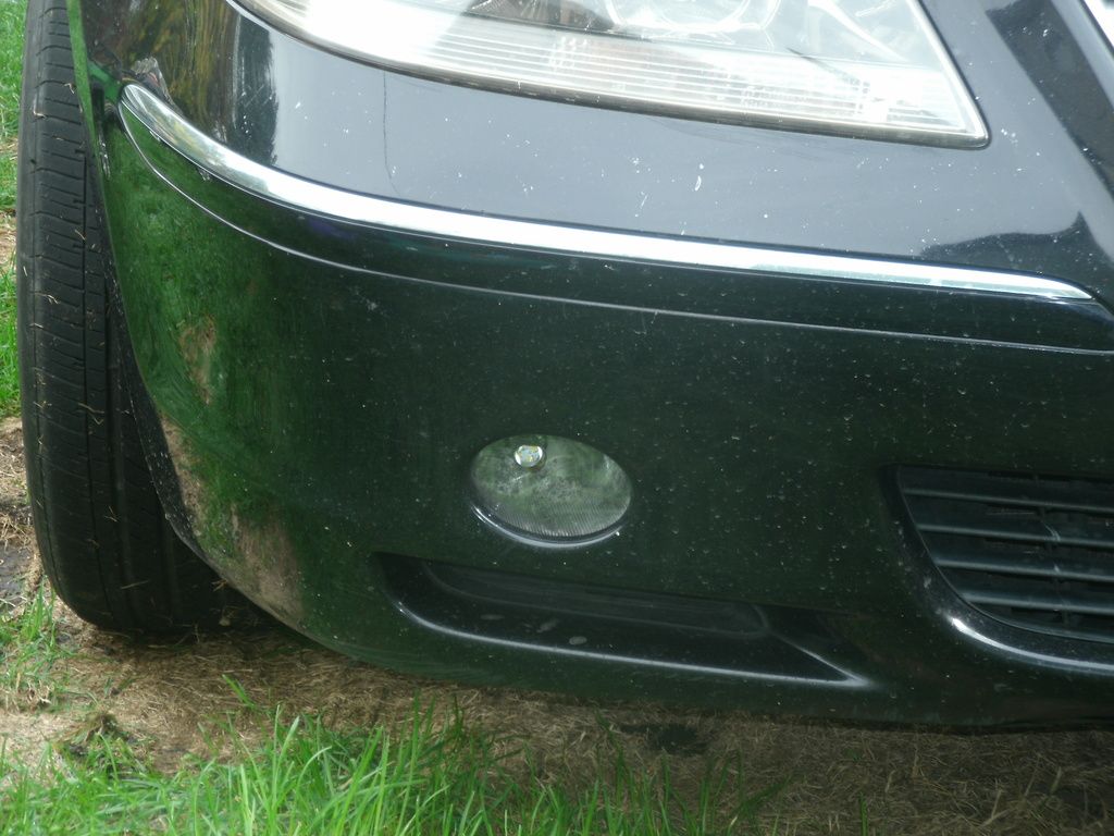

here is a pic of the repaired fog light, only harry really knows what it looked like before but the glass was cracked and had a small hole in it. removed the glass and cut a piece of lexan for it and now its good as new. :) you can kind of see in the headlight pics how the passenger side was discolored.

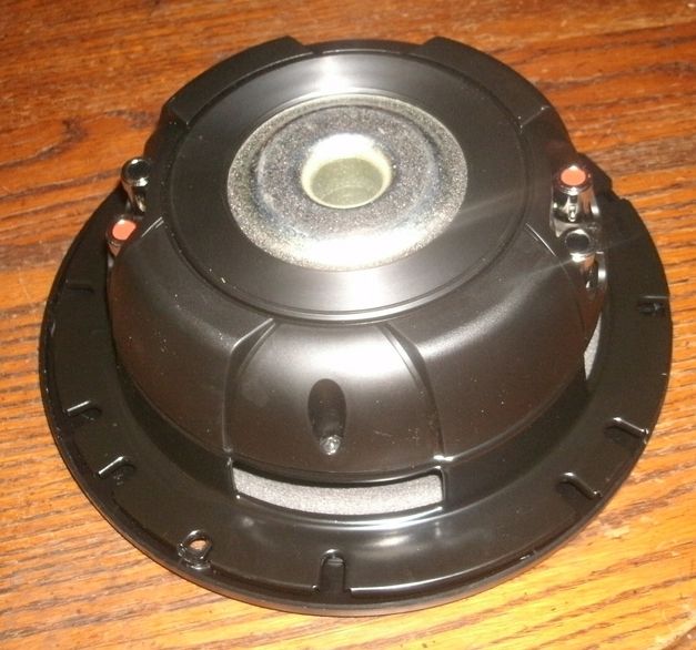

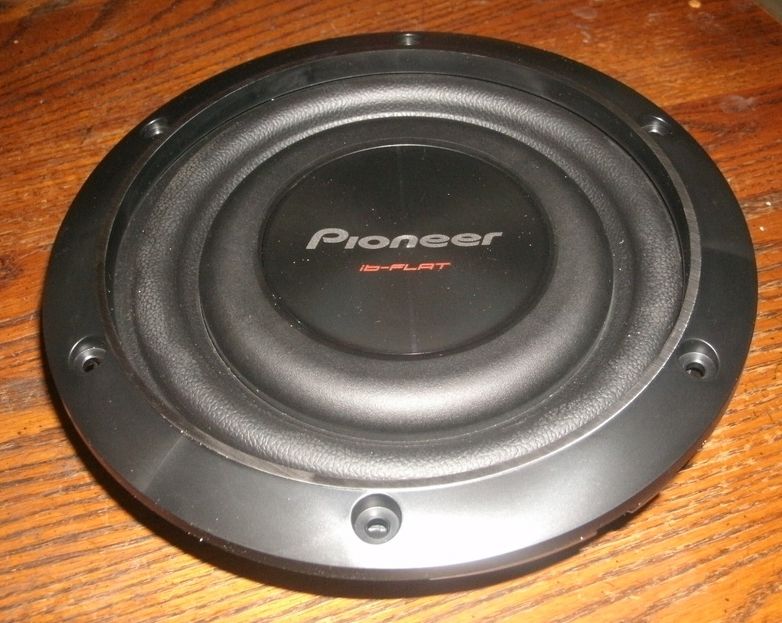

Pioneer shallow mount 8" subwoofer to replace the factory 8" sub, it will be run by a small Pioneer amp i have. the factory sub is in the rear deck and the new sub will mount right where the factory one does so it will be completely stealth and you wont even see it....you will just hear it. :)
i am waiting on the amp install kit to get here and i need to order some sound deadening material because i want to cover the whole rear deck with it because this sub will have a lot more punch then the factory sub so i want to make sure i dont get any rattling from the rear deck.
stay tuned for install pics :)

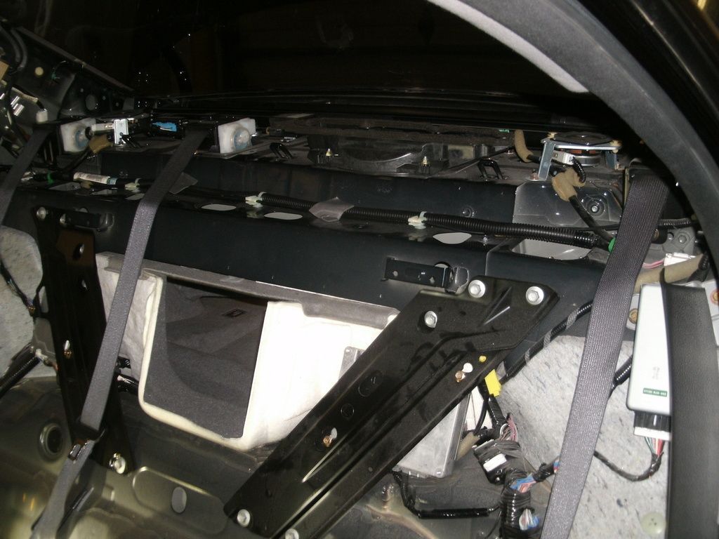

i had to remove the entire rear seat and rear shelf just to be able to see the factory subwoofer, with all the bolts and clips and panels that i had to remove this took about two hours.

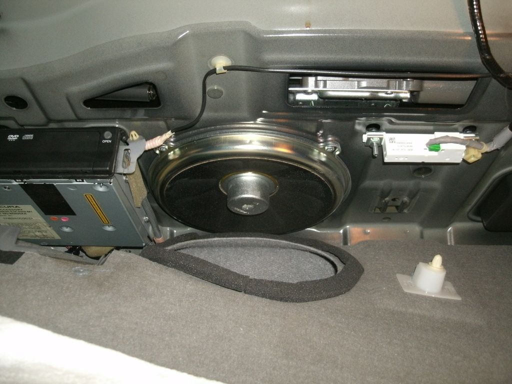

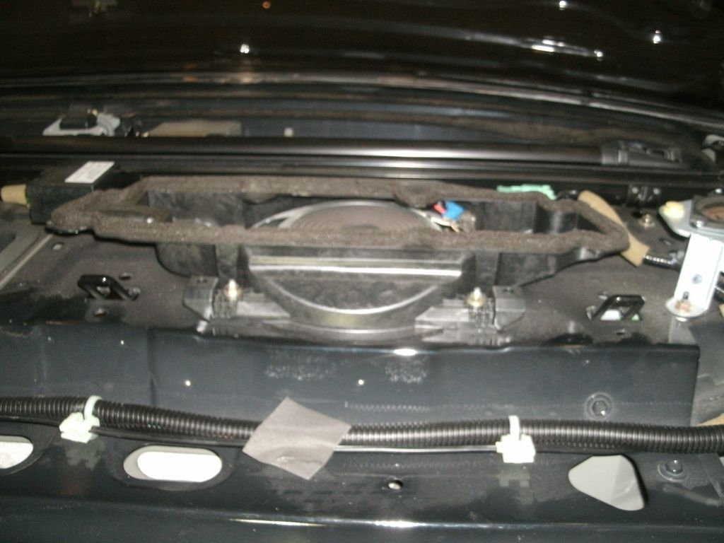

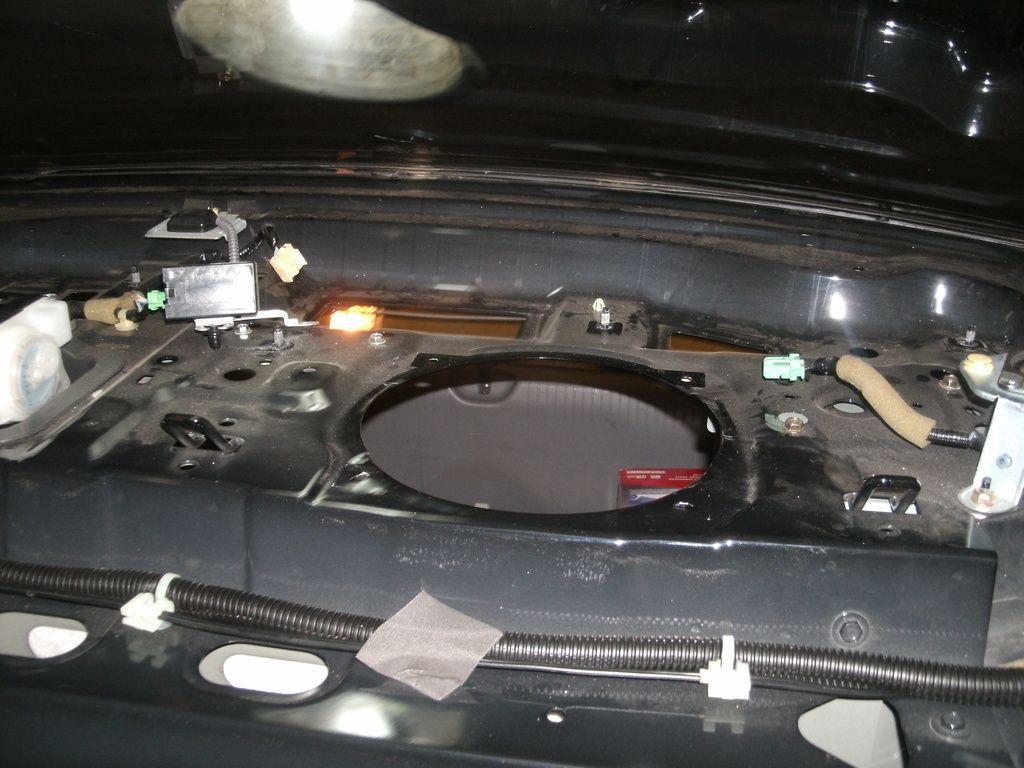

hiding under all that and under yet another little trim peice you can finally see the factory subwoofer just peeking through.
here is what it looks like from the under neath side of the rear shelf inside the trunk.

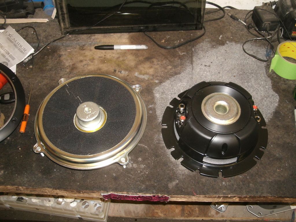

factory sub removed.

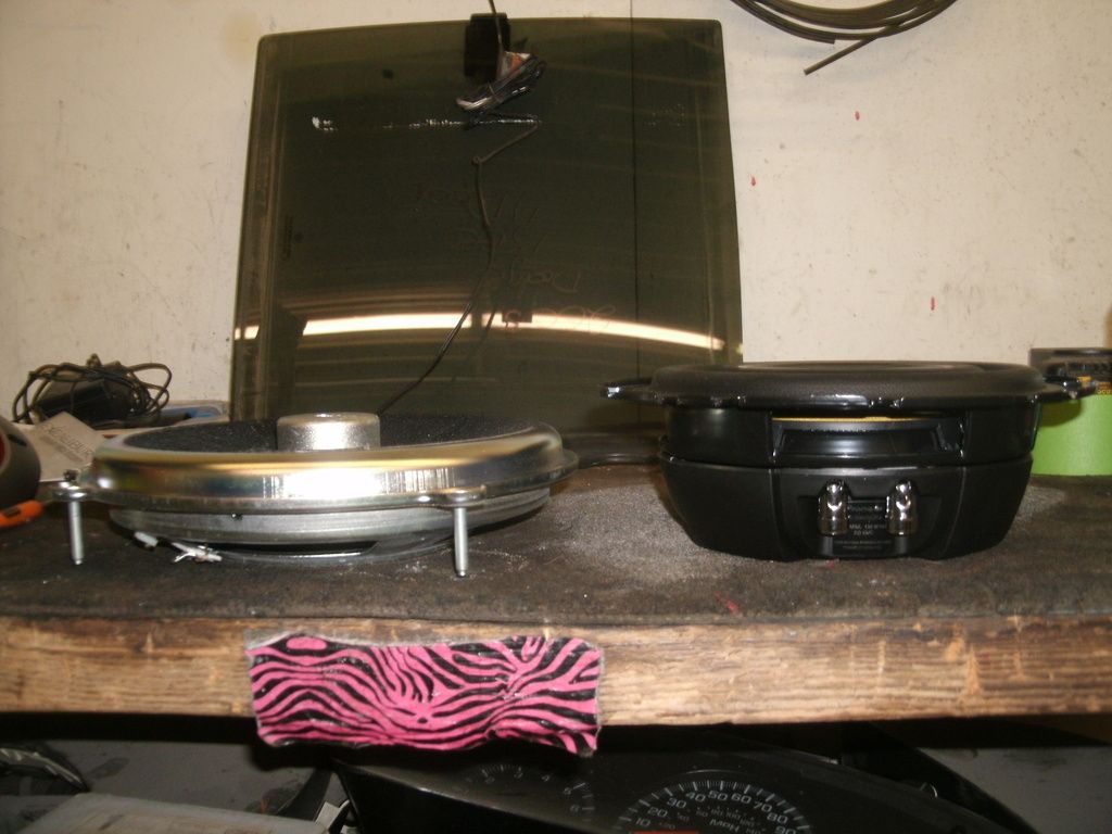

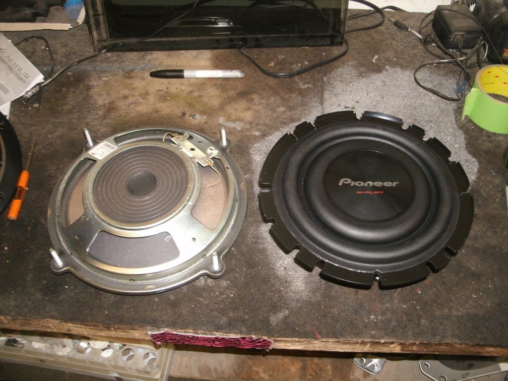

factory sub next to the new Pioneer shallow mount sub going in its place.

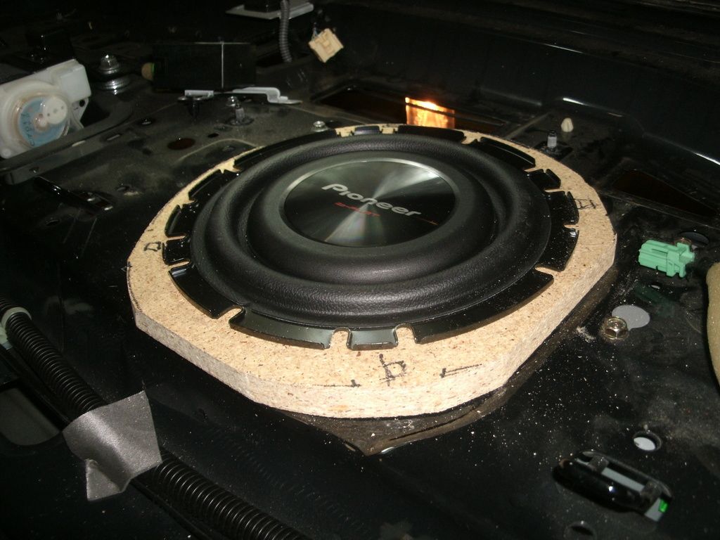

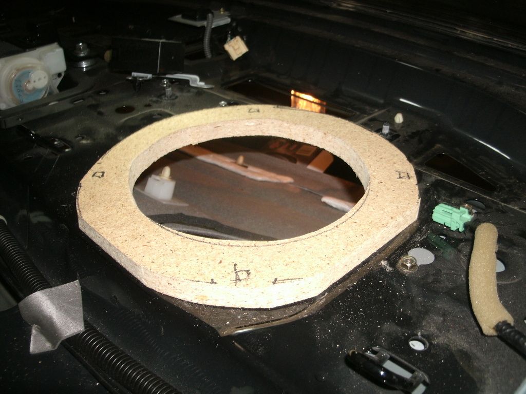

the new sub is a little smaller then the opening for the factory sub so i had to make a small adapter piece from a 5/8 piece of plywood.
now the wood will mount with screws from the bottom to the metal and the sub will mount to the piece of wood. and there is still plenty of clearance room between it and the rear shelf trim piece.

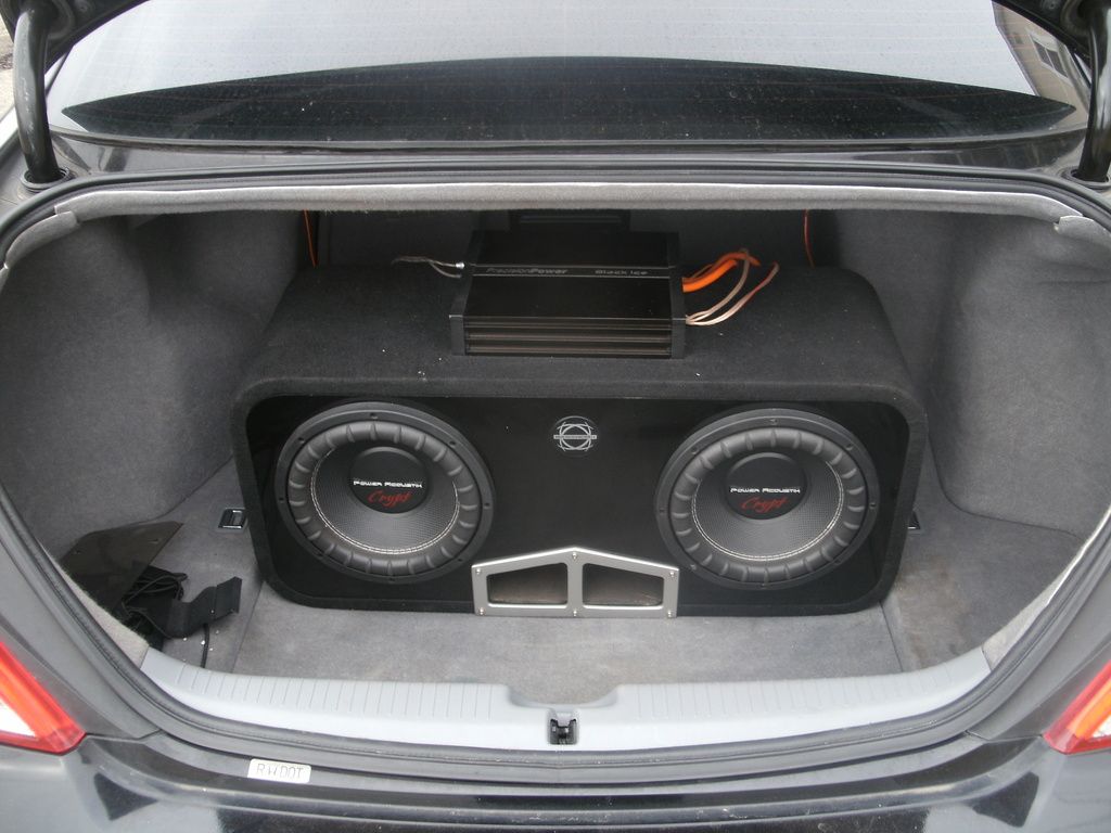

so i ended up dumping the single 8" for a pair of 10" and went from a 300w amp to a 600w amp :) shes got some boom boom now.
