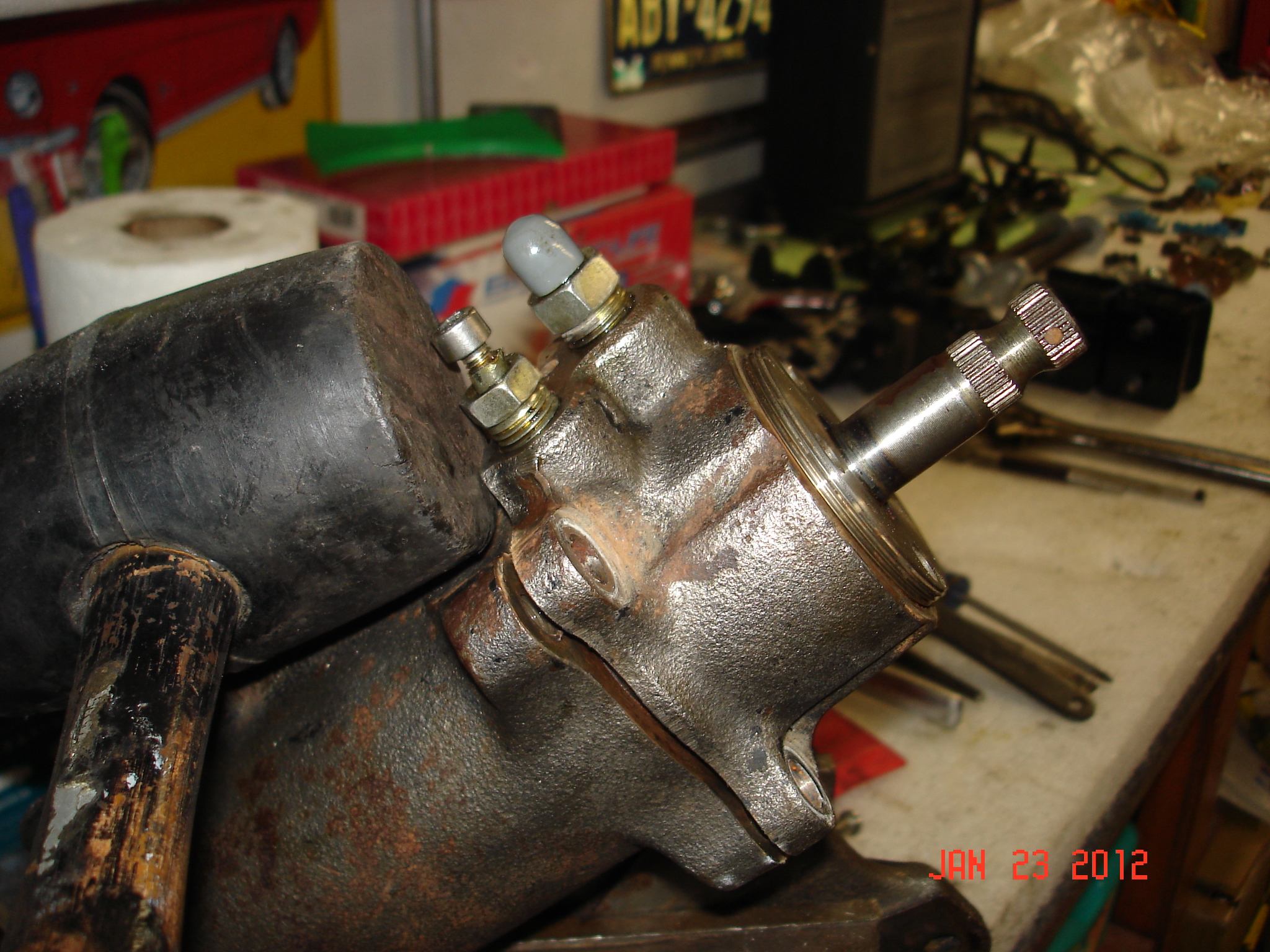

I noticed that the pictures no longer appear on the power steering box rebuild thread over in the S.O.S. forums.   So while I was rebuilding my power steering box last week, I had my camera handy and snapped some photos during the process.
Please note:  I am not a mechanic who works on cars day in and day out!  I don't have an unlimited supply of specially tooling!   I am an auto enthusiest/backyard mechanic like the majority of us on this site.  I've done my best to document how I performed this particular rebuild using standard hand tools and the factory service manuals as my guideline.  If you see something in error, please respond to the thread.   If you see something that may be performed in a simpler fashion, again please respond.

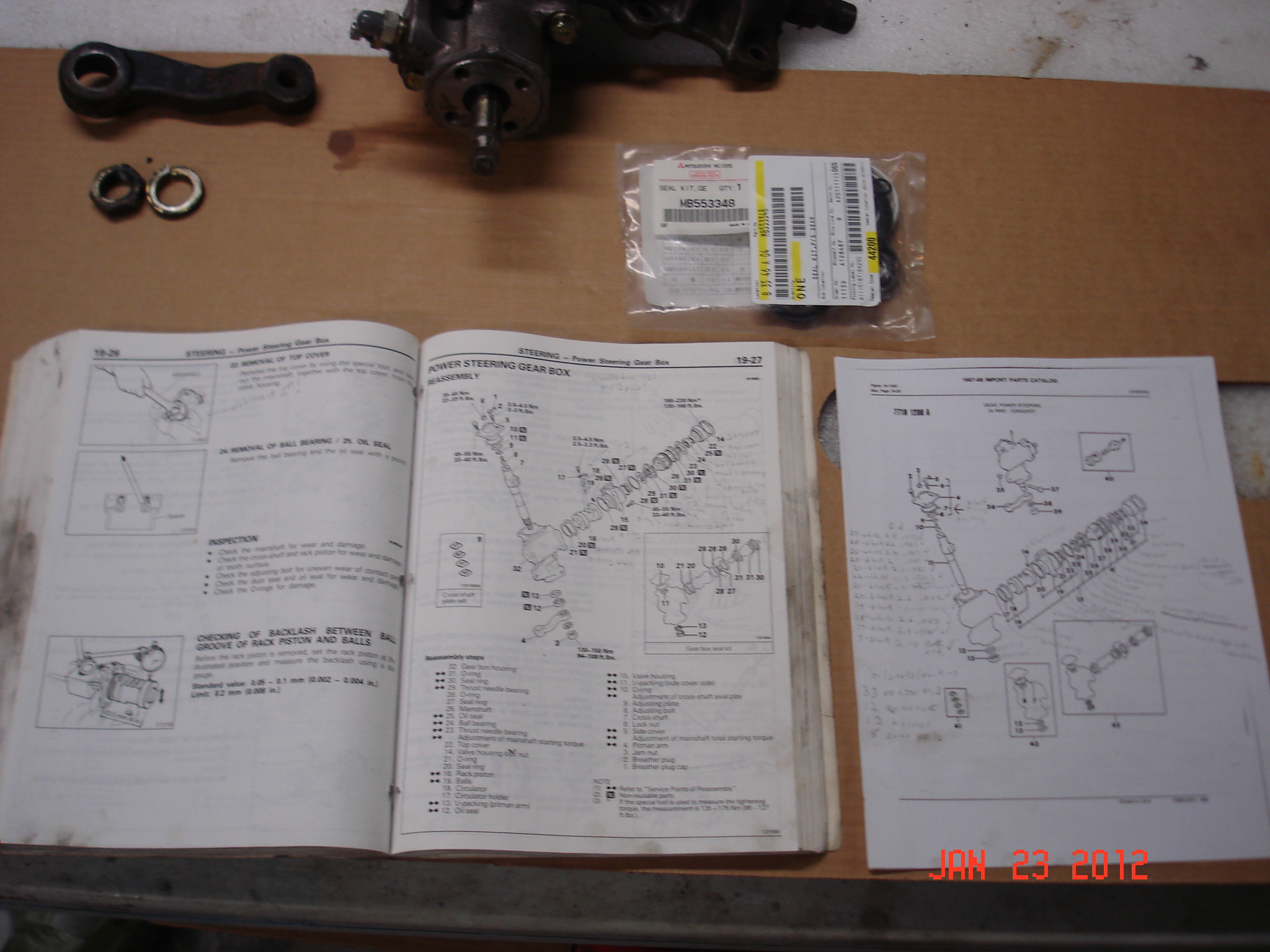

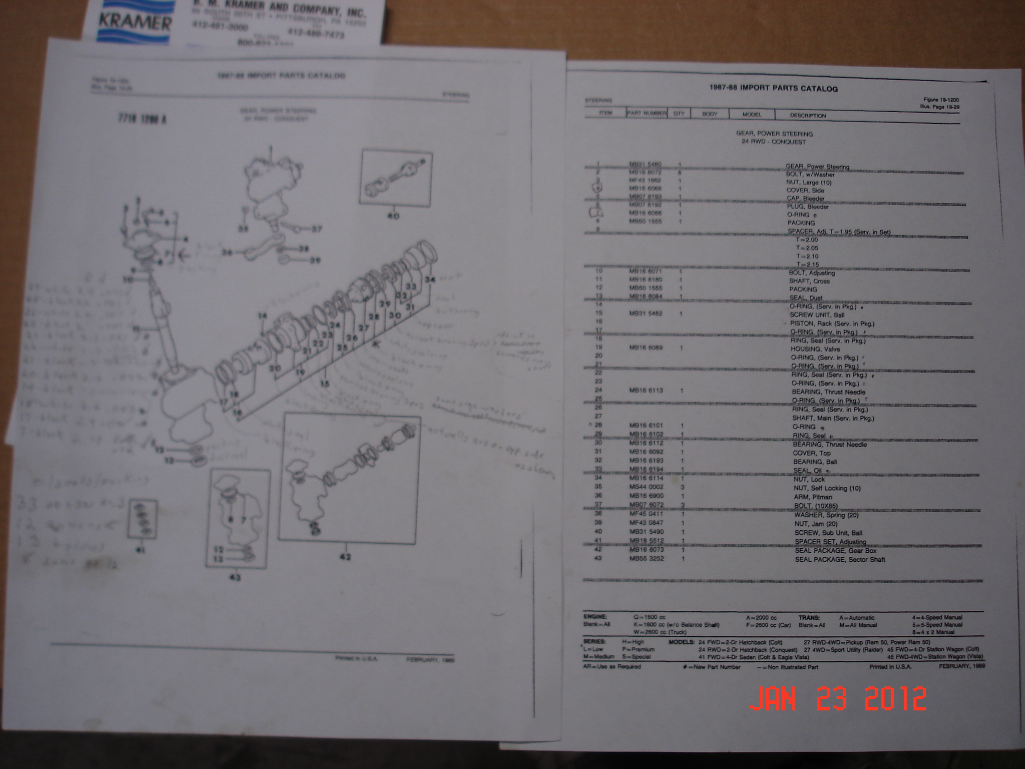

First and foremost:  YOU NEED THE FACTORY MANUALS!  If you do not have the factory manuals, get them.  They are downloadable on several starquest sites and are also on ebay constantly for a very low price.  Also, the parts manual was of help on this rebuild.  I found it easier to read and follow in regards to all of the o-rings and seal rings in the box.   Download the 'STEERING' parts manual and print out the two sheets (one cartoon, and one parts list) for the steering box.   Mark up this sheet during your dissassembly to aide reassembly.
Parts required: Mitsubishi Seal Kit, MB553348.....This use to be under $50....I paid over $120 for it last month!!! Not sure why the price ramped up...hopefully because there is a demand for it.   That would actually be a good thing because it keeps it available.  The worst thing is that Mitsu would list it as NLA and we would be screwed   (such as the steering coupler, coupler boot, and so many other specific parts for our vehicle).

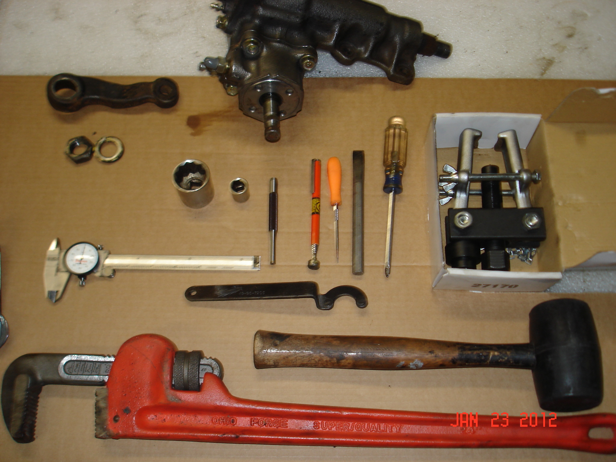

Tooling Req'd:   This rebuild was performed with just basic hand tools.  See the photo below.   In going thru my photos I think I missed a couple simple tools in this particular image: torque wrench for 10 ft-lbs, flathead screwdriver, 17mm wrench or crescent wrench, bearing/seal driver (or some properly sized sockets to install a ball bearing and oil seals).
From the picture below:  the following 'specialty tools' are required:  A wrench big enough to open to 2.75"...I used a 24" pipe wrench (it only loosens tightens a jam nut).  A spanner wrench to fit in the holes of the top cover (I used the spanner wrench from my angle grinder...it was a sloppy fit but there is hardly any load on the top cover during removal/install).  A pitman arm puller...the hardest part of this job was pulling the pitman arm.
The number one set of tools required for this rebuild:

OK.  We have our manuals, our tools and our parts.   Now to start disassembly.
IMPORTANT NOTE:  These rebuild instructions are based off of a virgin steering box that has never been altered from day one!  If someone has tampered with your specific box...ie loosened the jam nuts on either the side or the top cover and messed with the factory adjustments...then please stop now!  Don't read any further.  Consult the service manuals and rebuild the box using a in-lbs torque wrench capable of measuring as low as 2 in-lbs.    I don't have an in-lbs torque wrench that goes this low.   My method comprises simply of documenting the location of the factor adjustments and setting the rebuilt box back to this same location.

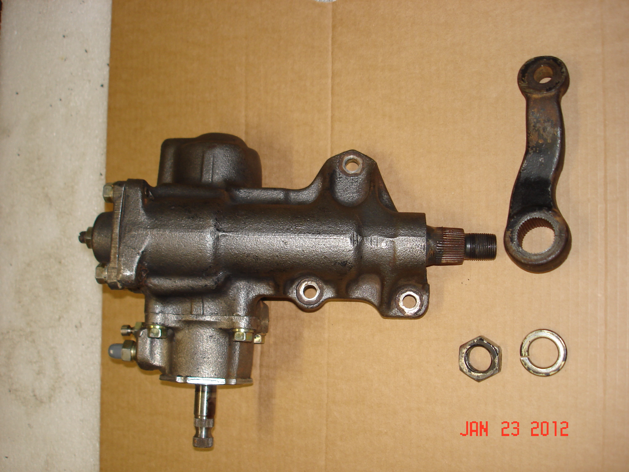

Ok, lets start the disassembly:

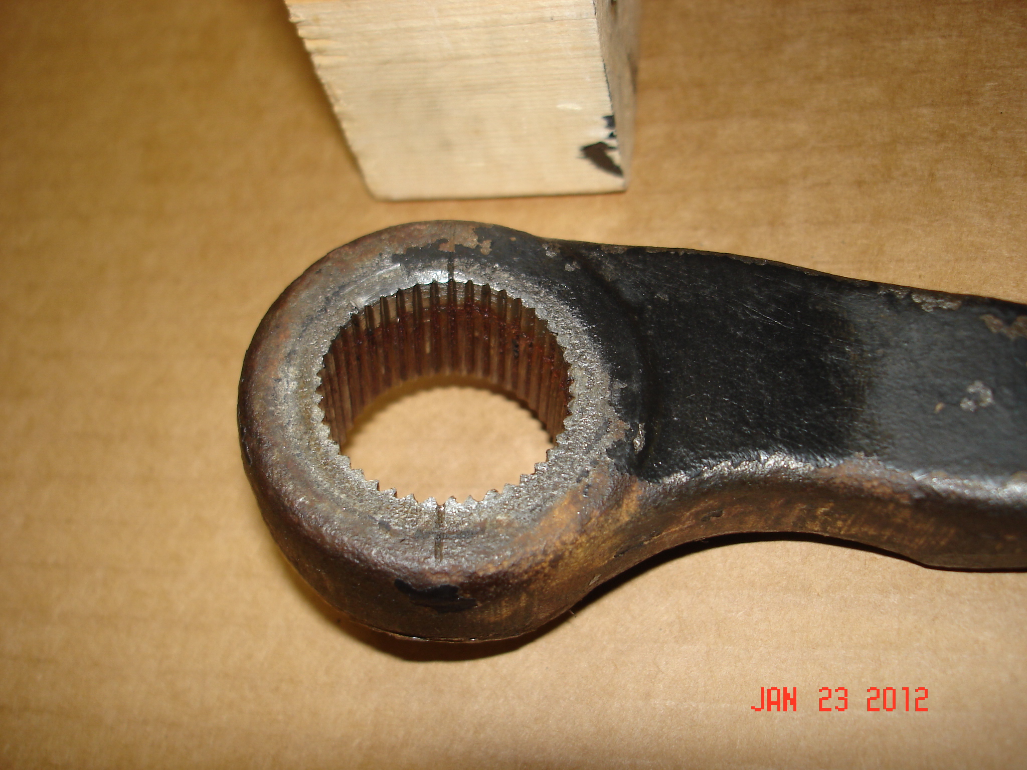

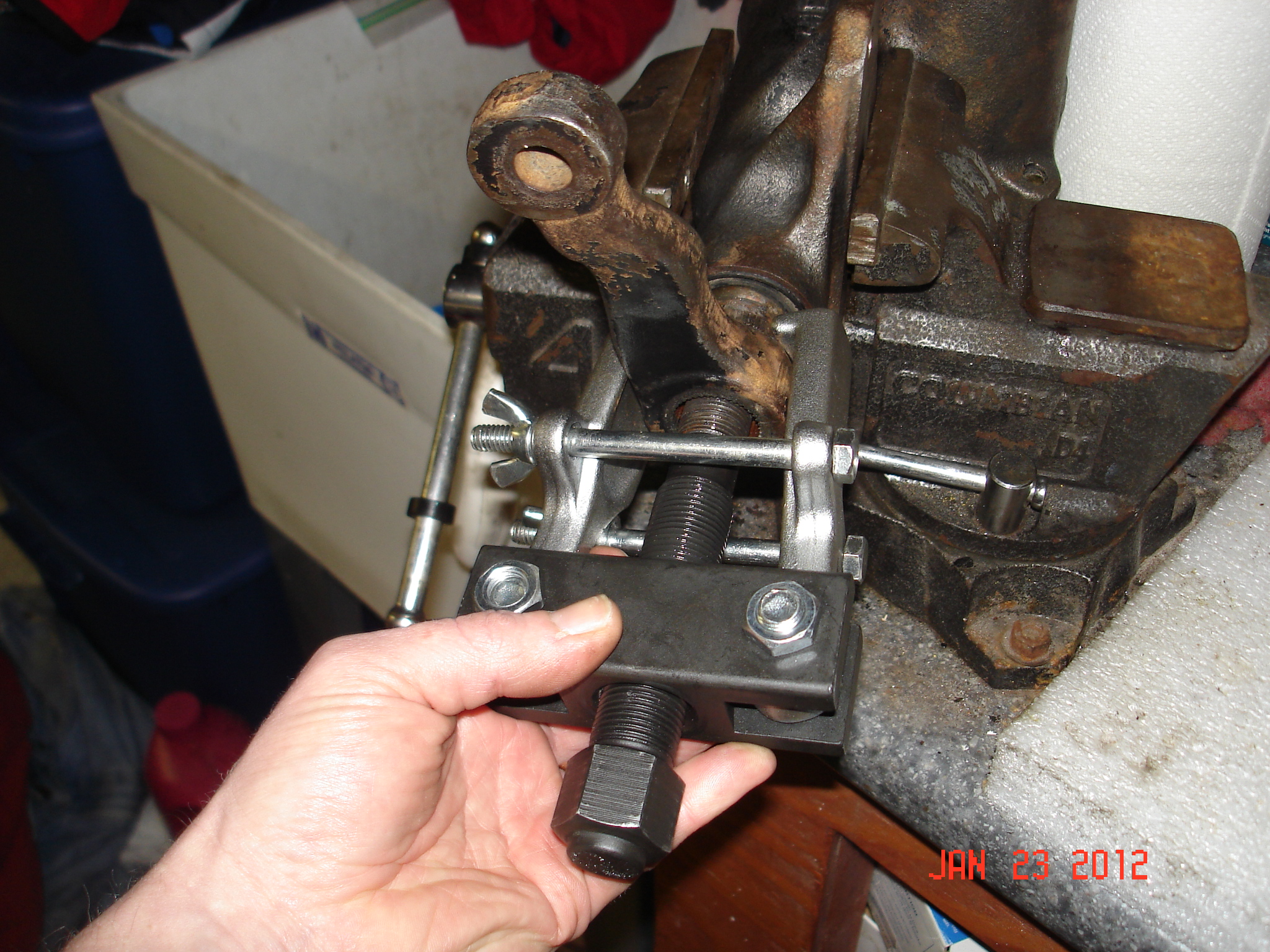

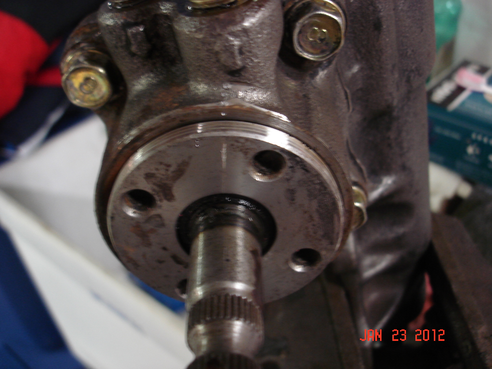

Remove the 30mm nut and lockwasher holding the pitman arm and remove the pitman arm using the proper puller (NOTE:  this is the hardest part of the rebuild.  These pitman arms are on tight...tighter than even the one on my ford full size pickup!   I broke my $15 standard two jaw pitman arm puller trying to remove this particular arm.  I ended up renting this 'professional' one at Pep-Boys)
Note the factory markings on the shaft and pitman arm (no need to remake markings unless yours are worn off for some reason):
Jam Nut size on top cover (Note the 'top cover' is the term used in the owners manuals.  It is not the cover on 'top' of the box...that is called the 'side cover' per the manuals...lol)   The top cover is the cover for the input shaft.

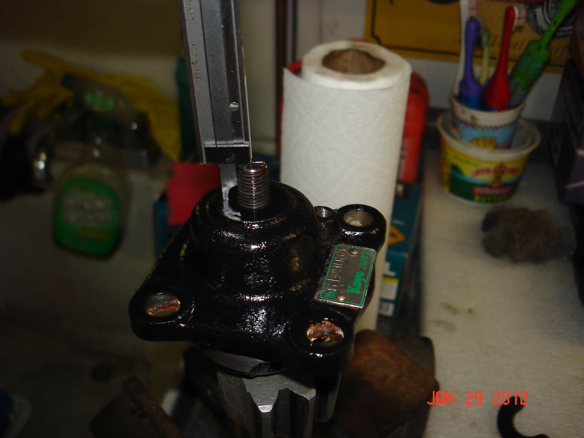

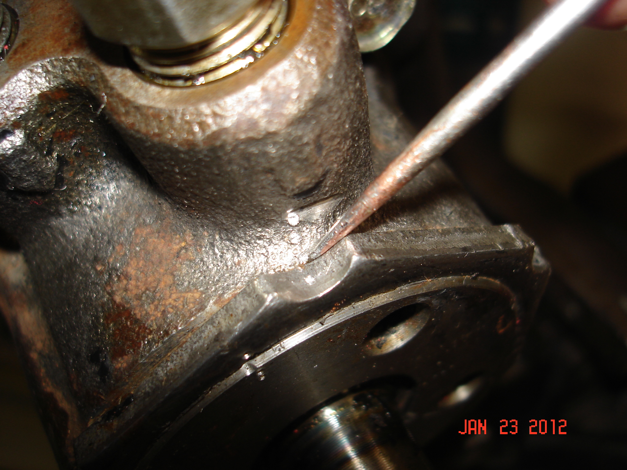

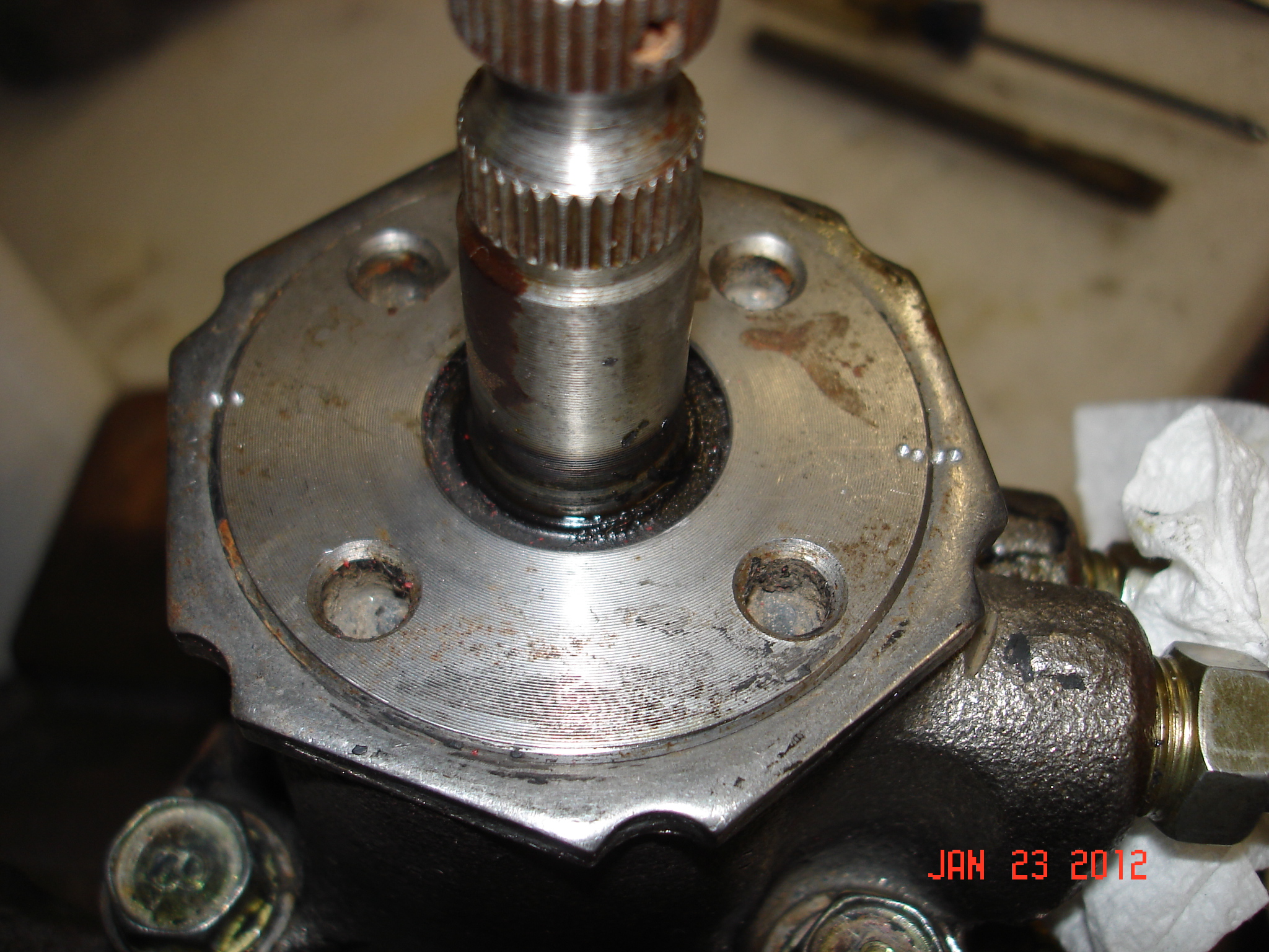

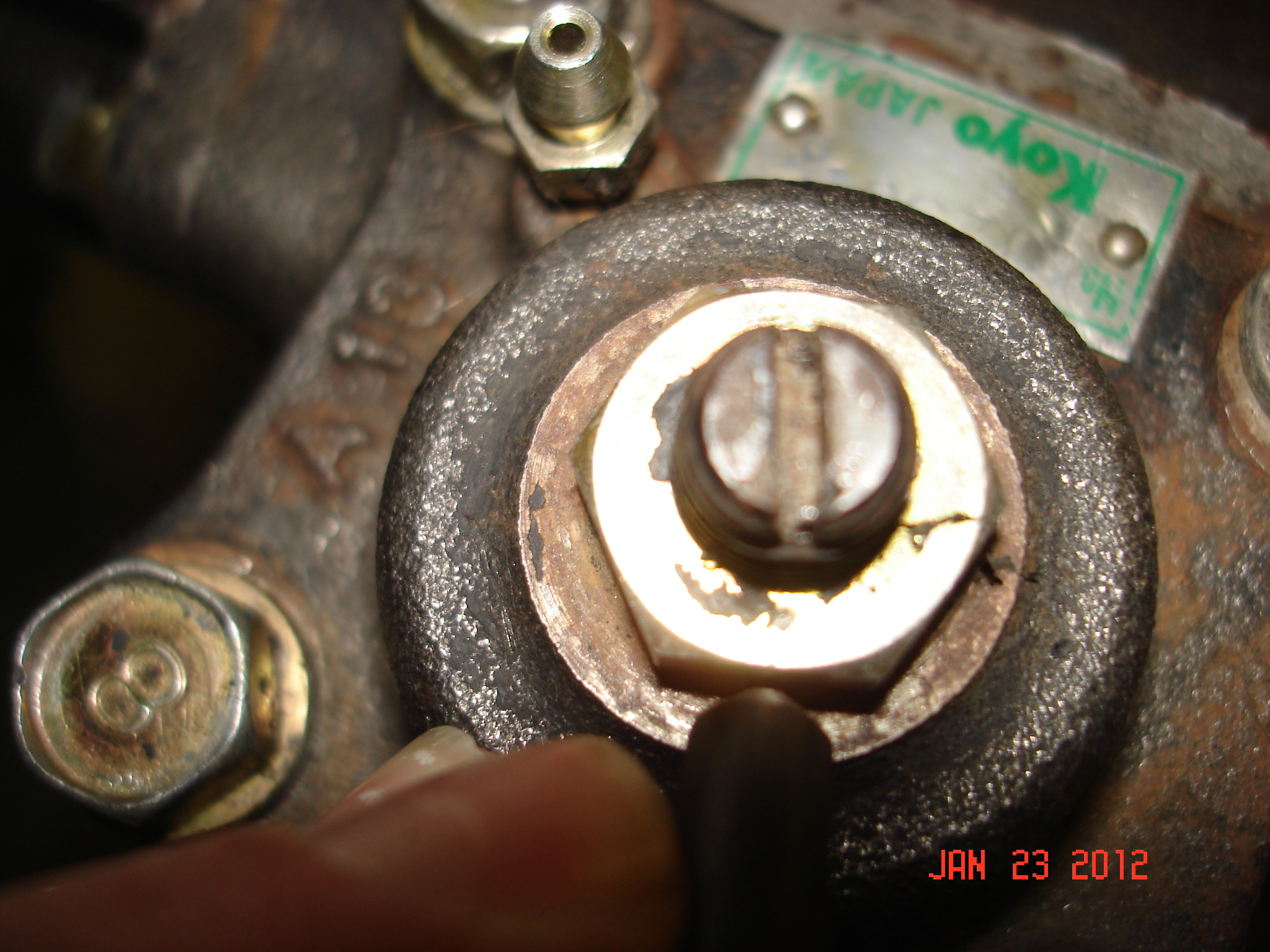

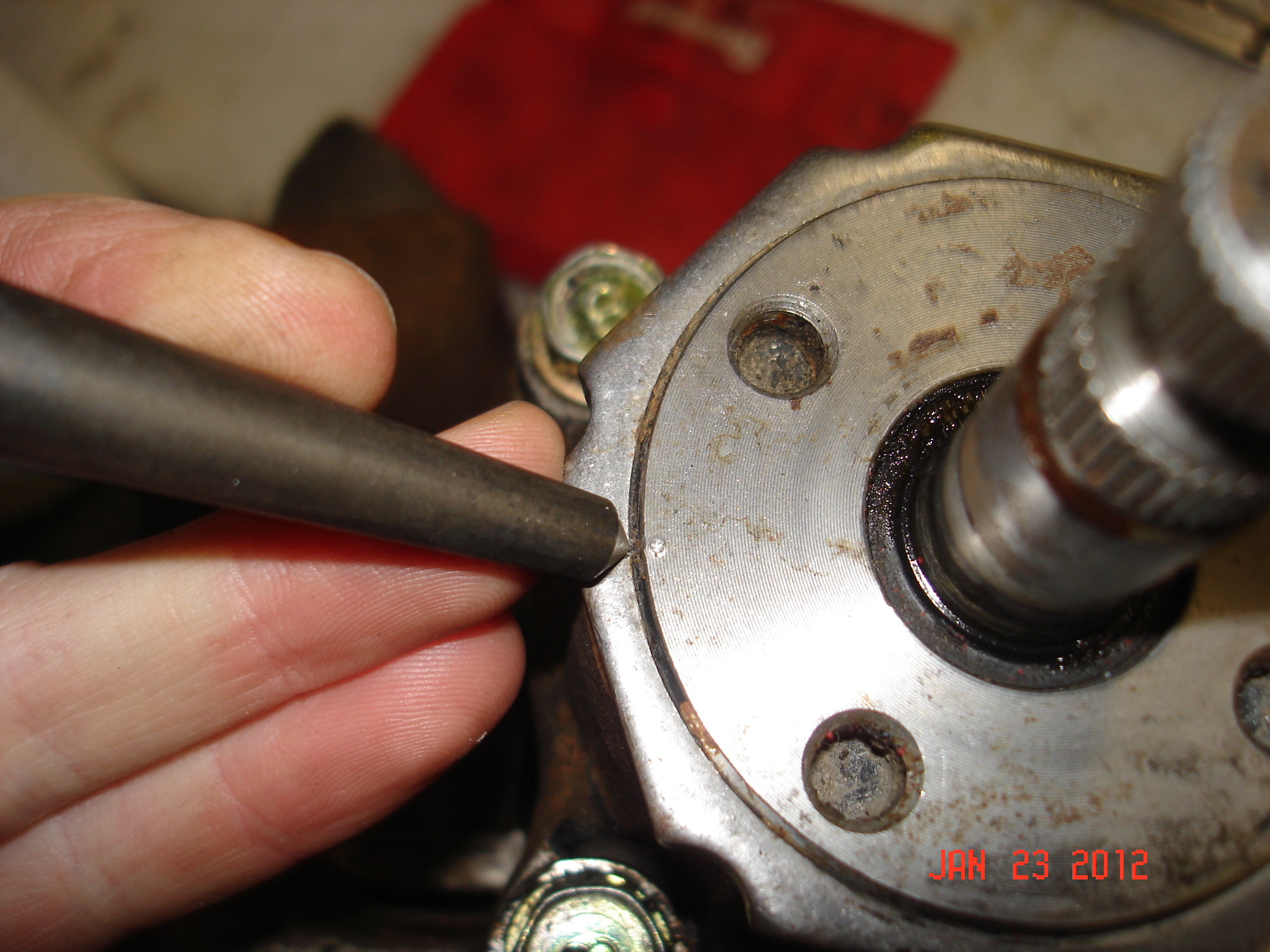

Use a center punch to make a mark on the jam nut and top cover.  I did two markings about 180 degrees apart.  The one was a single punch and the other was a double (two marks)  Put your marks in a better location than I did (at a place where you can also mark the valve body....read down further and I'll explain why).

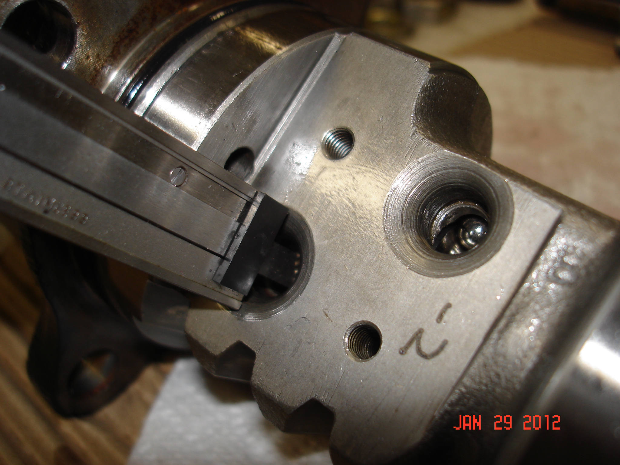

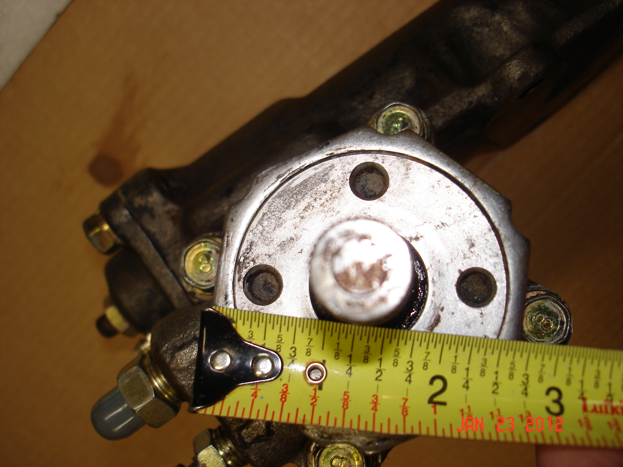

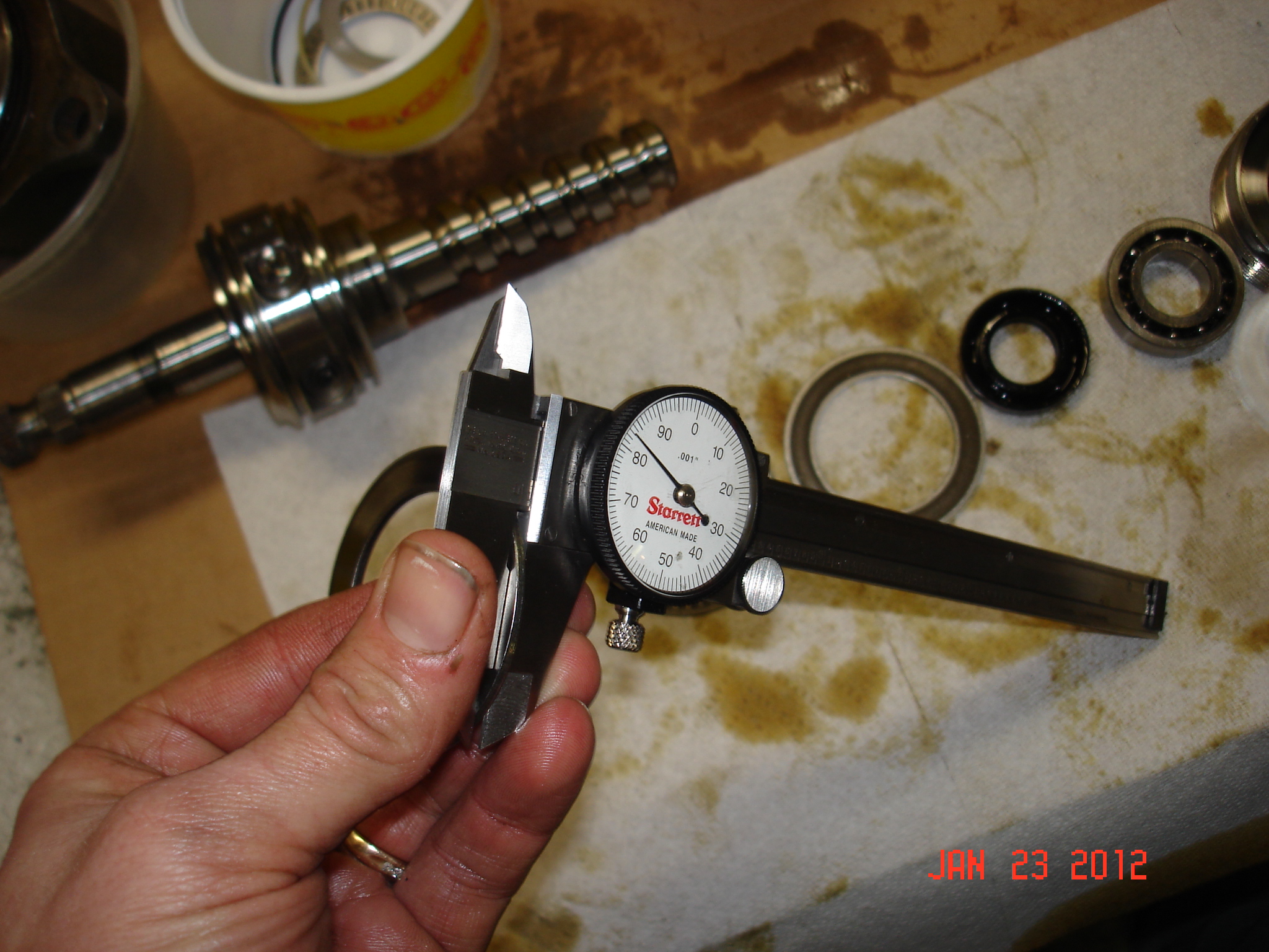

Now, use a vernier caliper and make a measurement between the top cover and jam nut at both locations and record:

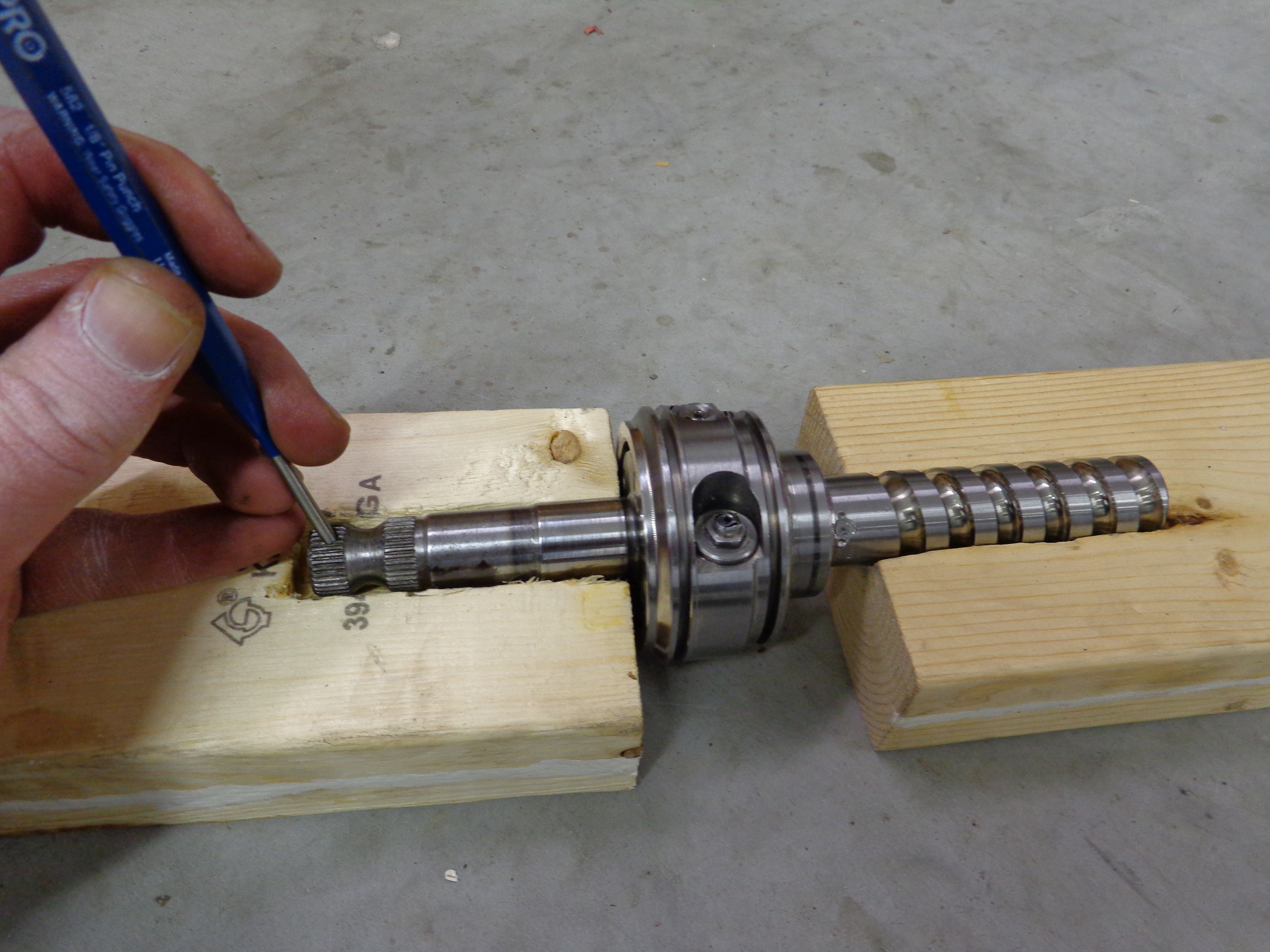

Now use a center punch on the jam nut of the top cover in line with the slot on the threaded stud.  Make another punch in line on the base of the top cover and biased on the side of the stud.   Do anything you need to do to convince yourself that you have the appropriate markings for reassembly.  Jot everything you do down on a pad of paper...its amazing how quickly you forget  (sorry for the poor picture, I didn't notice the lack of clarity when it was taken).
Use your vernier caliper to make a measurement from the top of the stud to the jam nut at your punch location....record it!
Then holding the stud, remove the jam nut:
Now measure between the stud and the top cover at the same location as your punch mark....RECORD IT.   THIS IS THE MOST CRITICAL MEASUREMENT

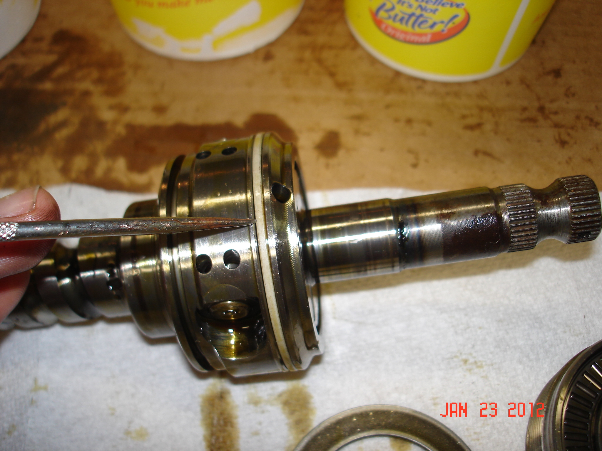

Back to the top cover.   Make a mark between the valve housing, jam nut, and top cover....Note I was a little redundant here.  If you planned your initial marks better you could have combined these into one set of marks.

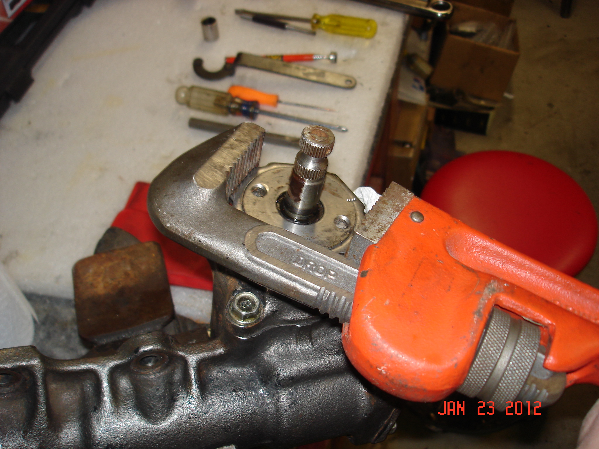

Now using your 2.75" wrench (pipe wrench in my case), remove the jam nut on the top cover (note the top cover will probably spin during removal of the jam nut...note how much it spins and return it to your marks after the jam nut is removed):
Better shot of all your markings now that the jam nut is gone.  The scribed line is my primary marking.  The punch marks were for the jam nut alignment (again plan your marks better than I did and combine the two!)
Take your measurement at your primary mark:
OK DONE WITH MEASUREMENTS!!!   You should have both jam nuts off and your logic map with measurements written:

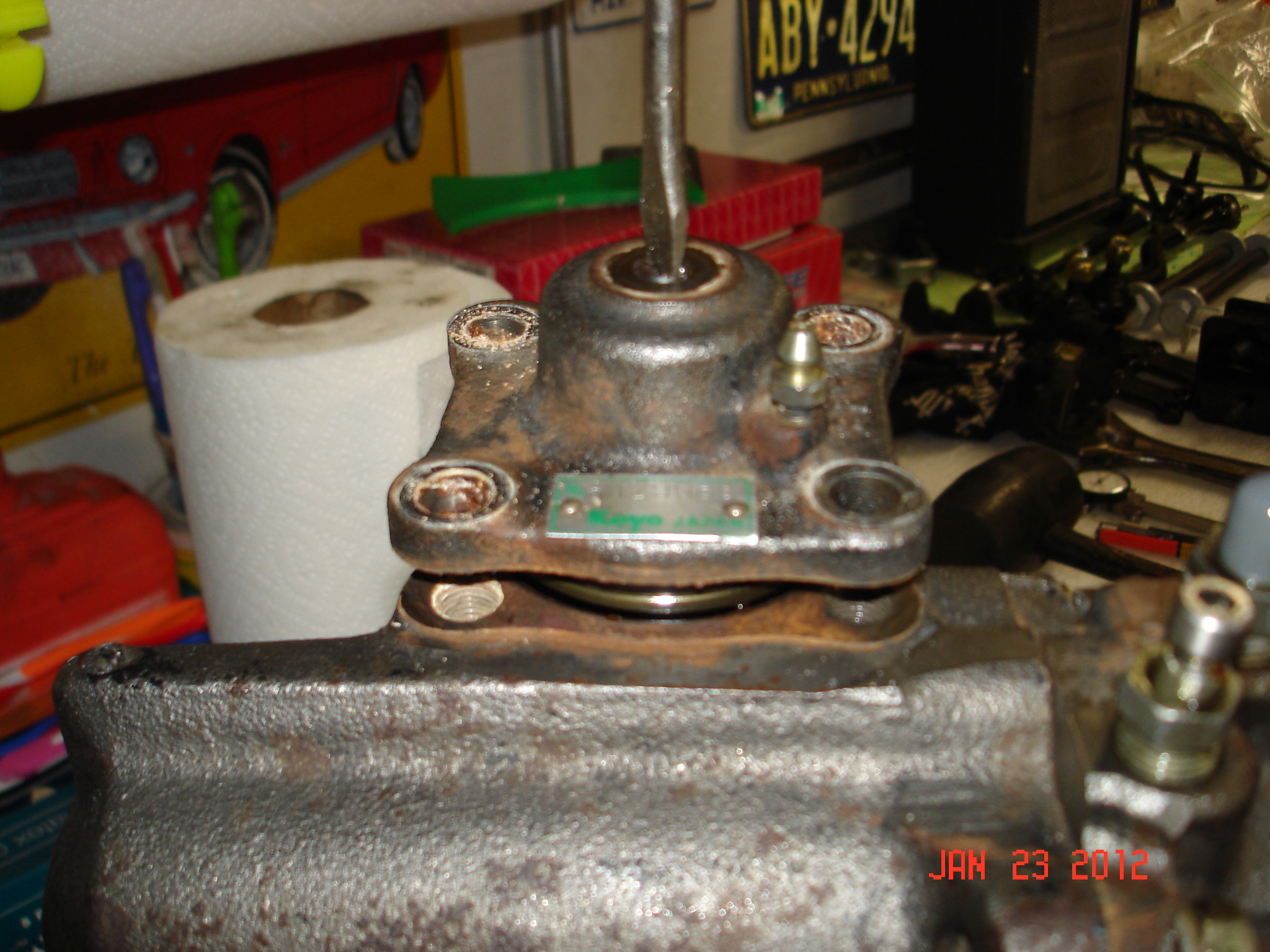

Using a flathead screwdriver, tighten the stud on the side cover to raise the cover off of the body of the box.   Don't worry, you recorded your measurement....you'll get it back to where it needs to go later.
Now tap out the shaft from below with a dead blow....lightly!  Only thing on this rebuild that takes force is removing the pitman arm
Here is the shaft removed with the 'side cover' still on it.   Go ahead and continue unthreading the stud from the side cover to remove the side cover.

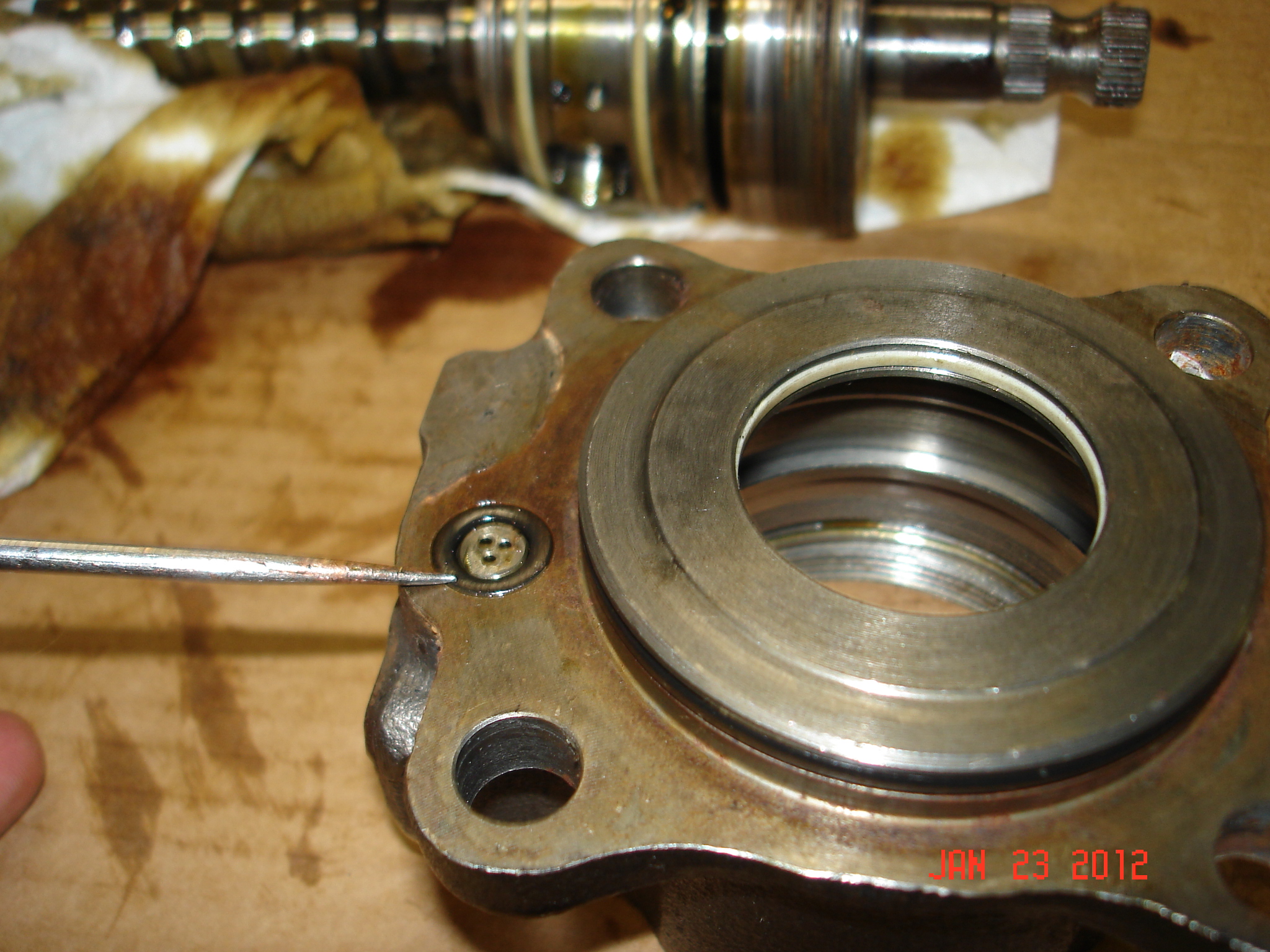

Here is what you will see:

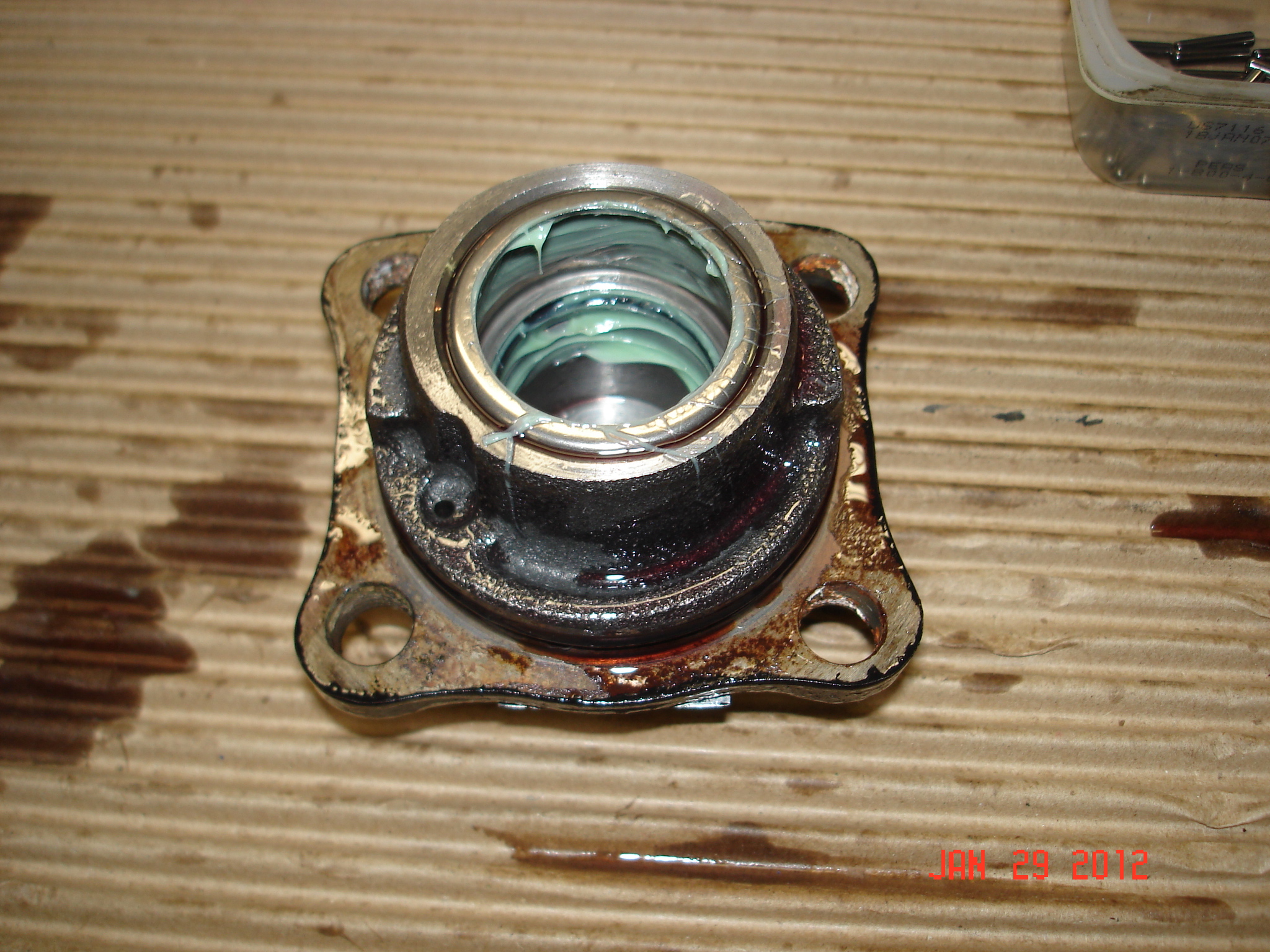

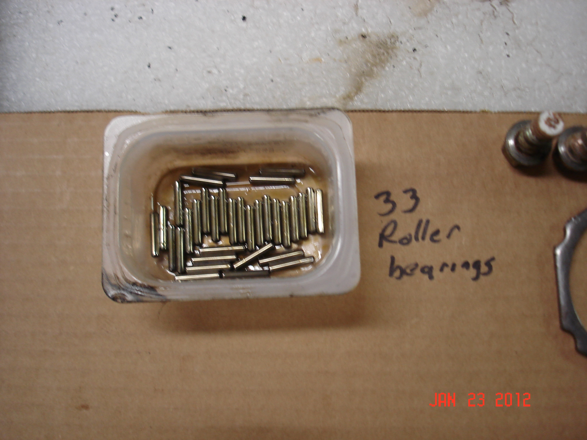

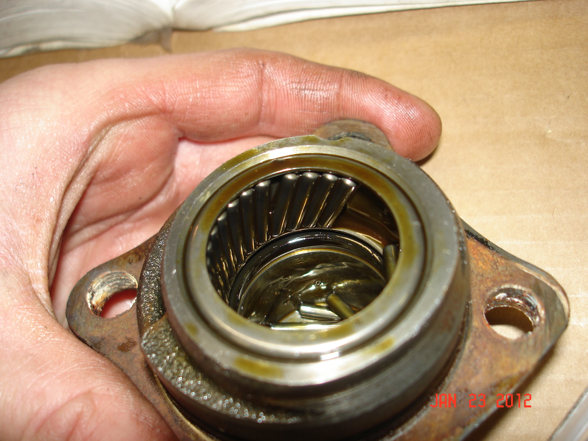

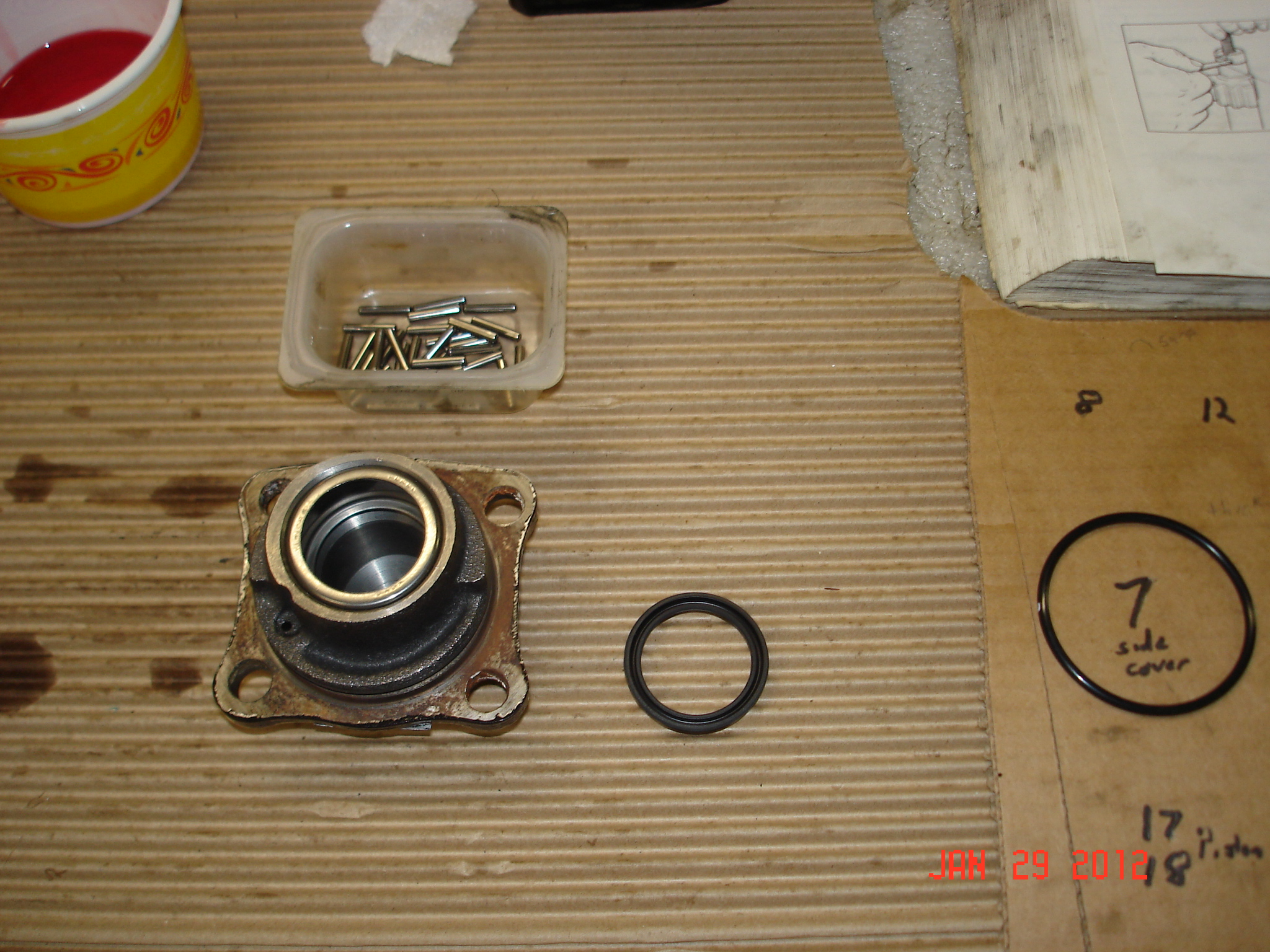

Remove the bearings (a magnet works great), count them, record your number, and store appropriately:

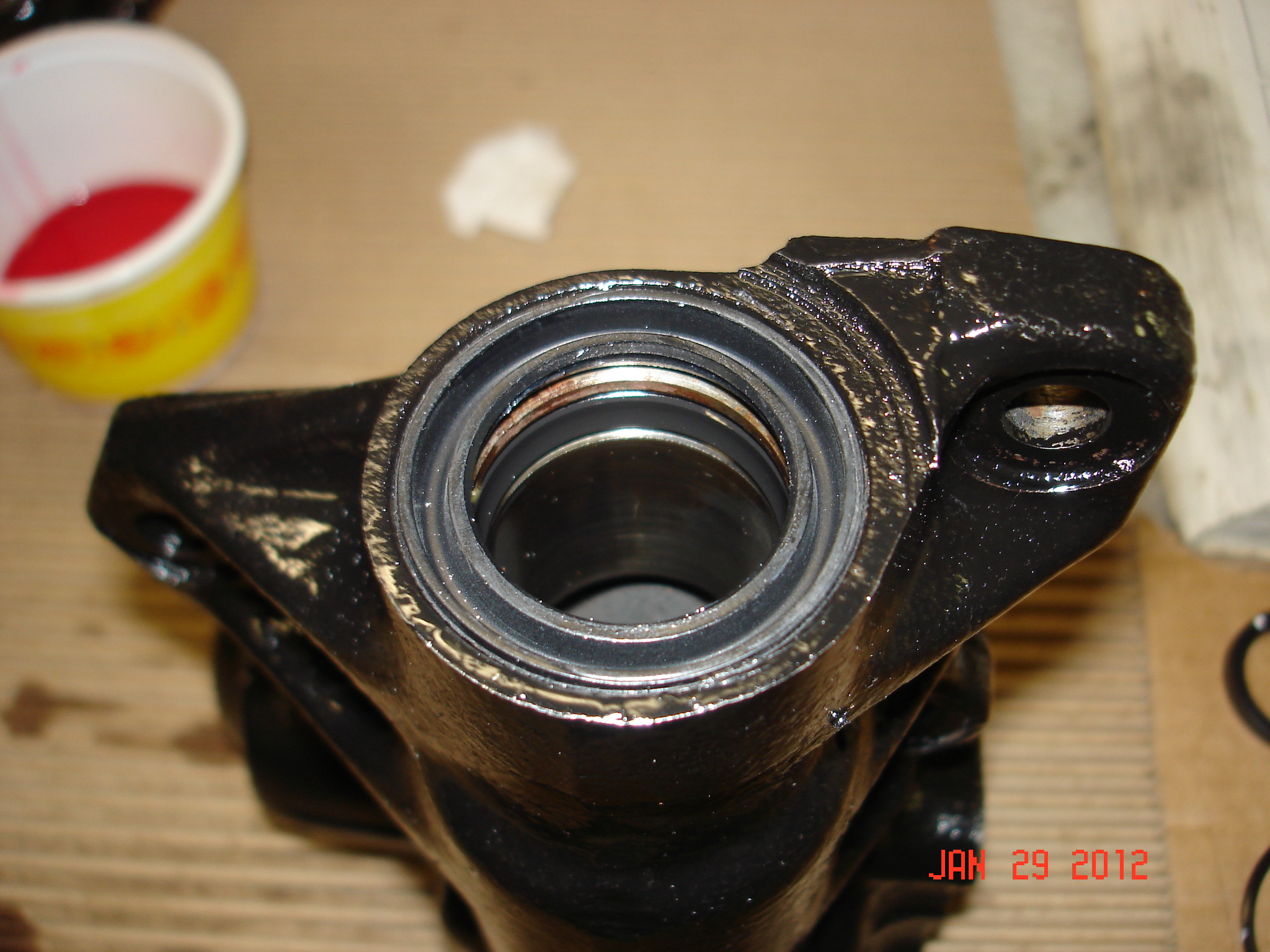

Now look down into the side cover past the bearing race and you'll see the uppermost seal ring.   Remove it and note its position...record which direction it was installed in (or snap a picture like I did to remind yourself)
Remove O-ring on OD of side cover (Keep track of every o-ring, seal ring, etc you remove, you will need to know what went where in order to make sense of your o-ring kit)

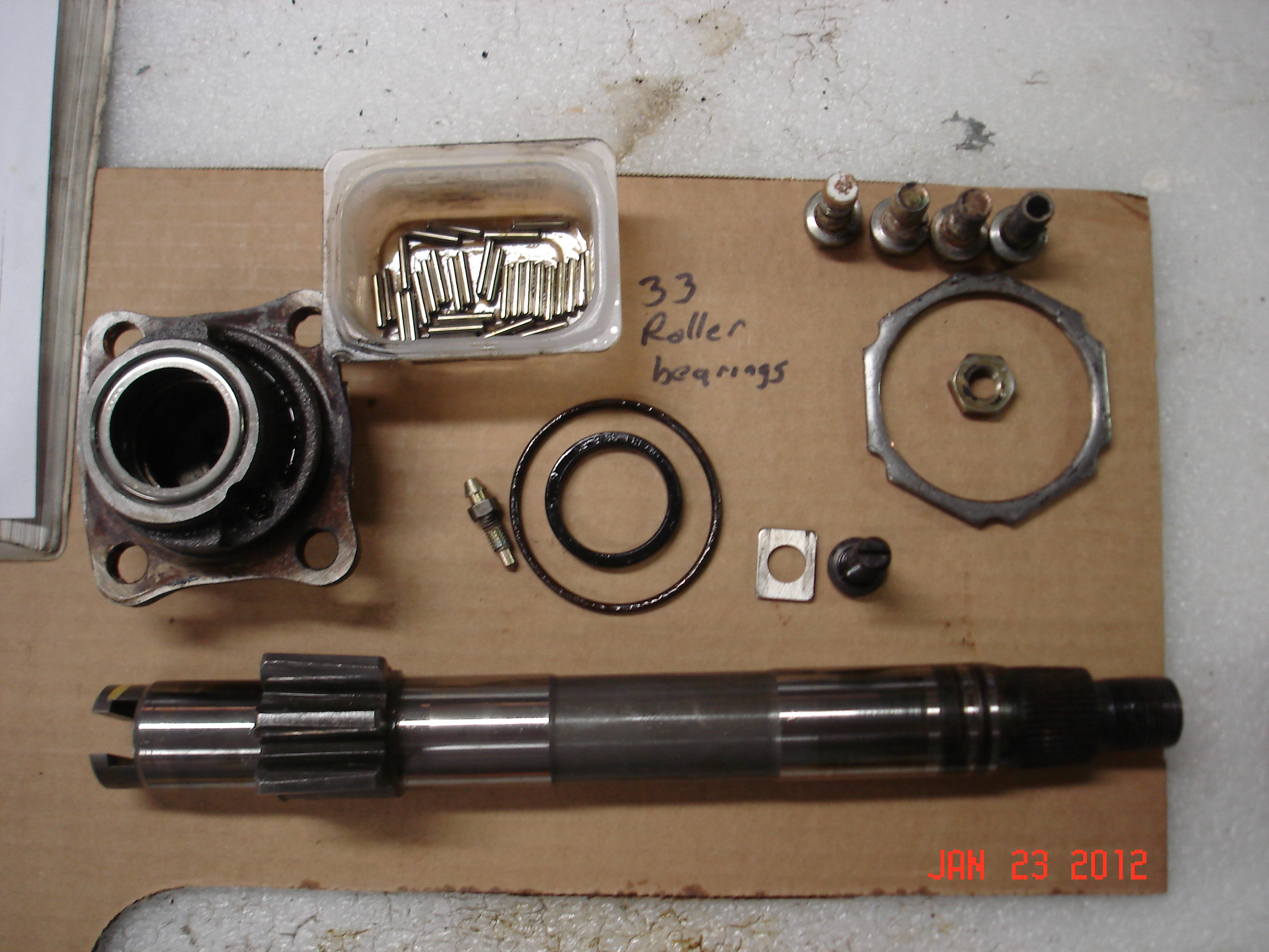

Ok, the primary shaft is apart
Here is what you should have on your bench....keep your bench tidy and everything organized.

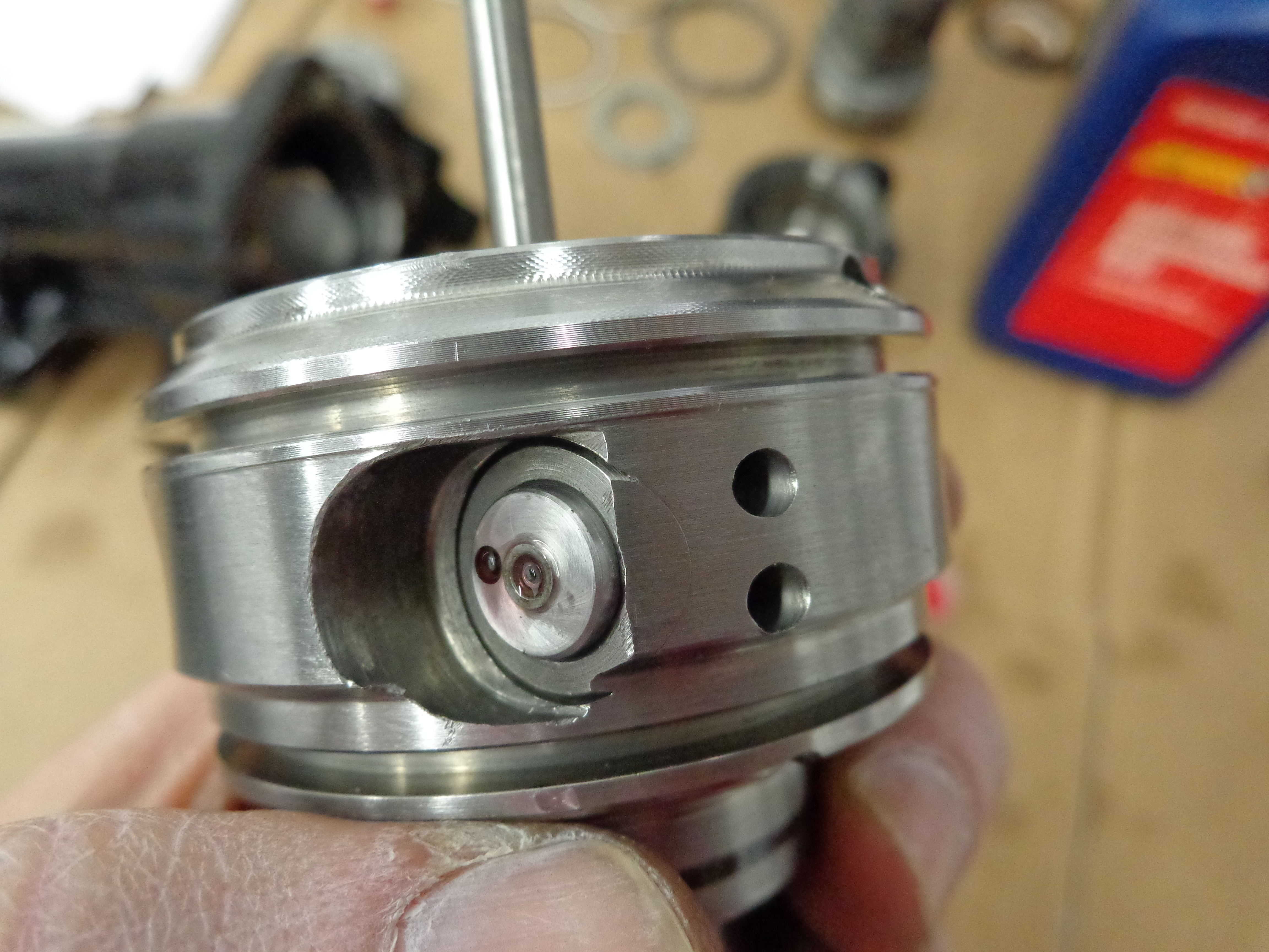

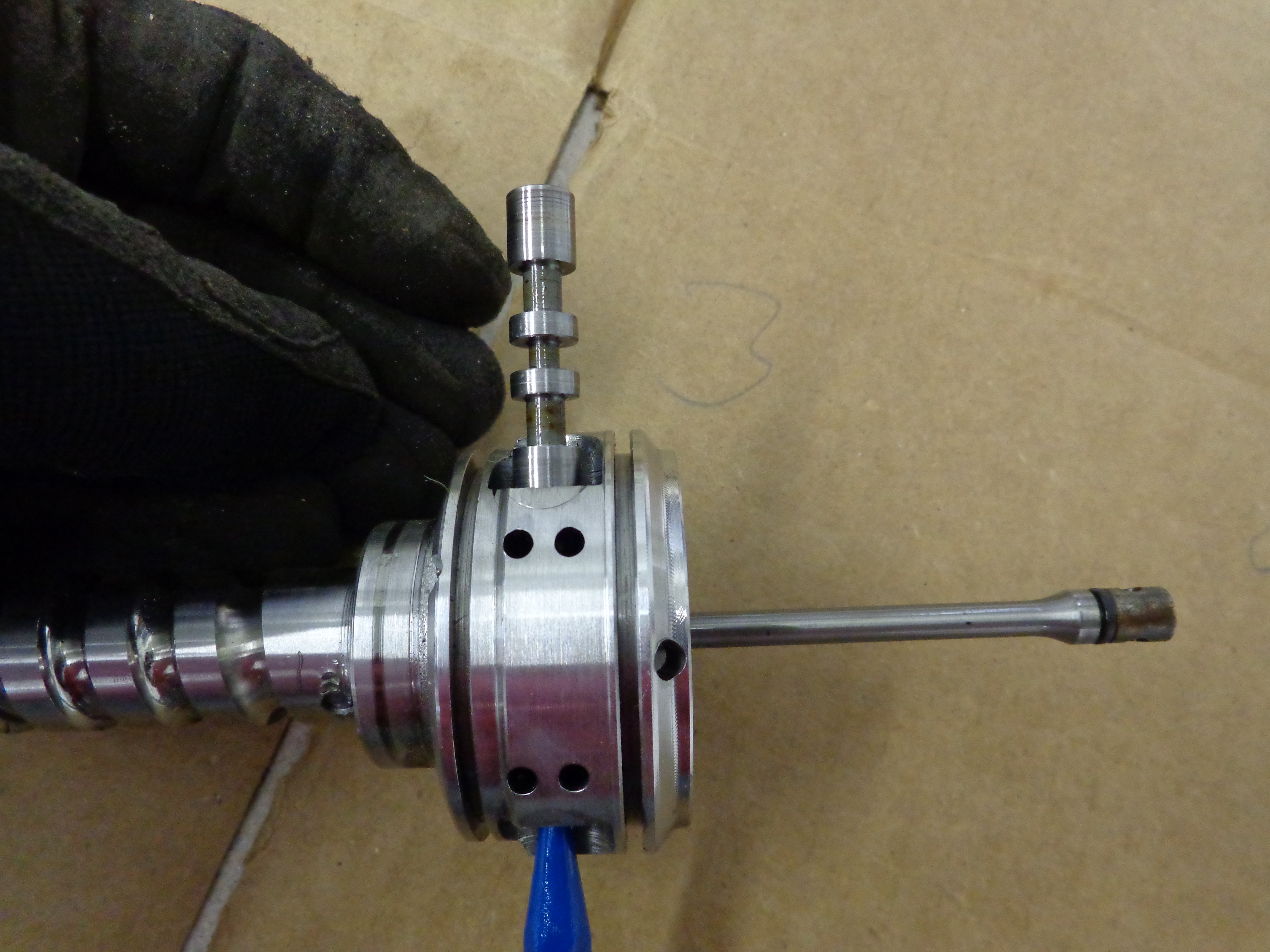

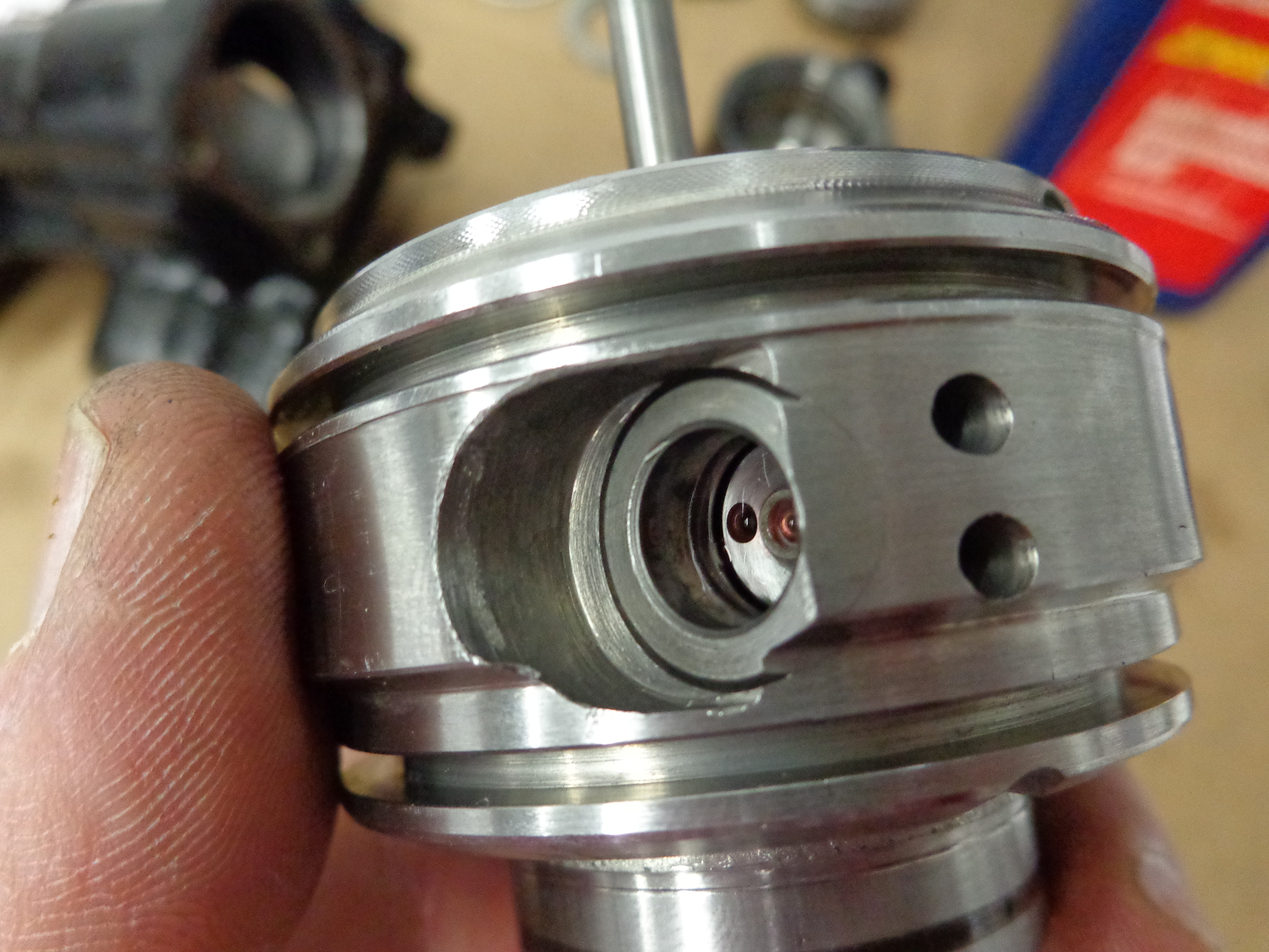

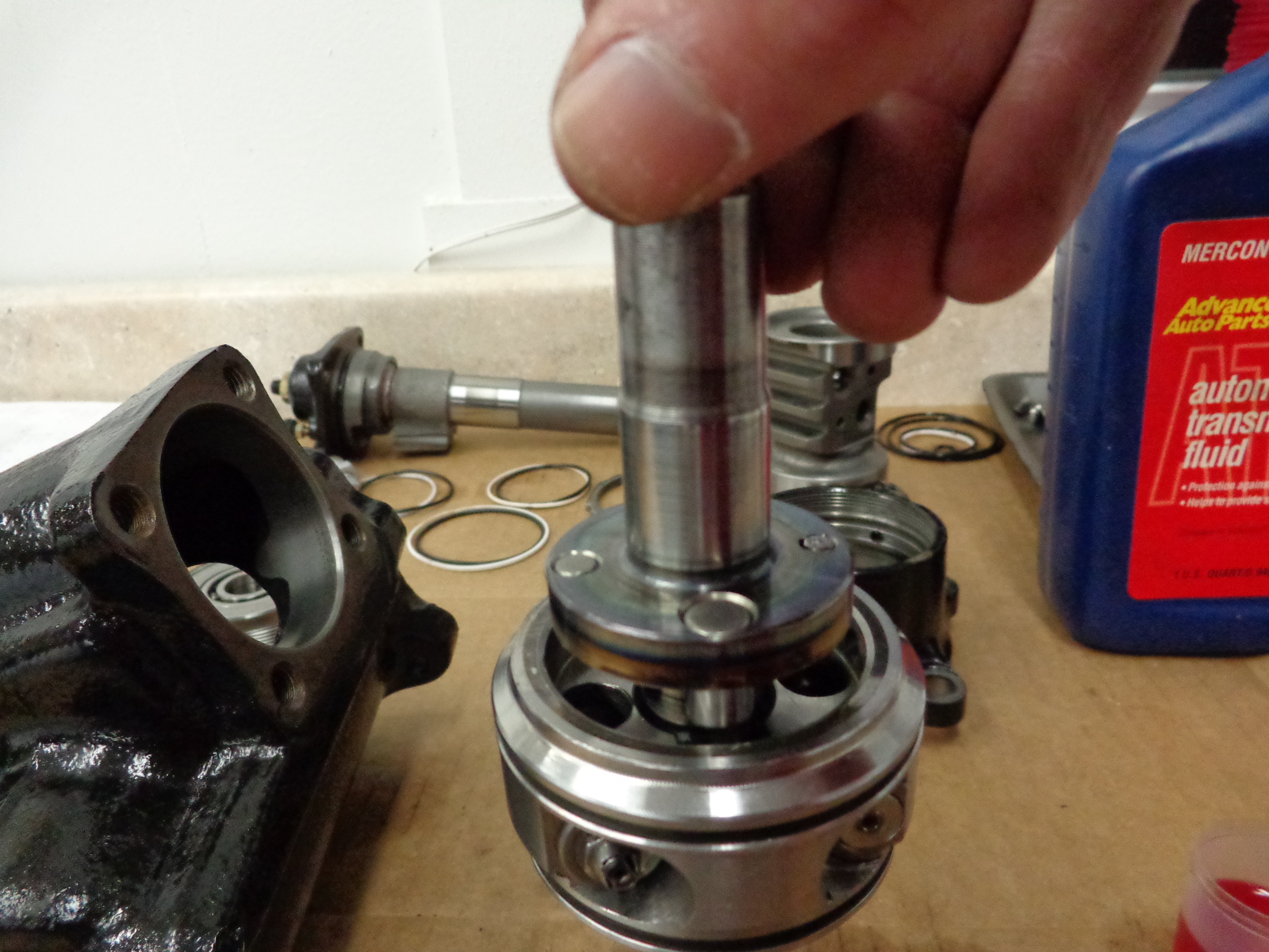

Onto the valve assembly:

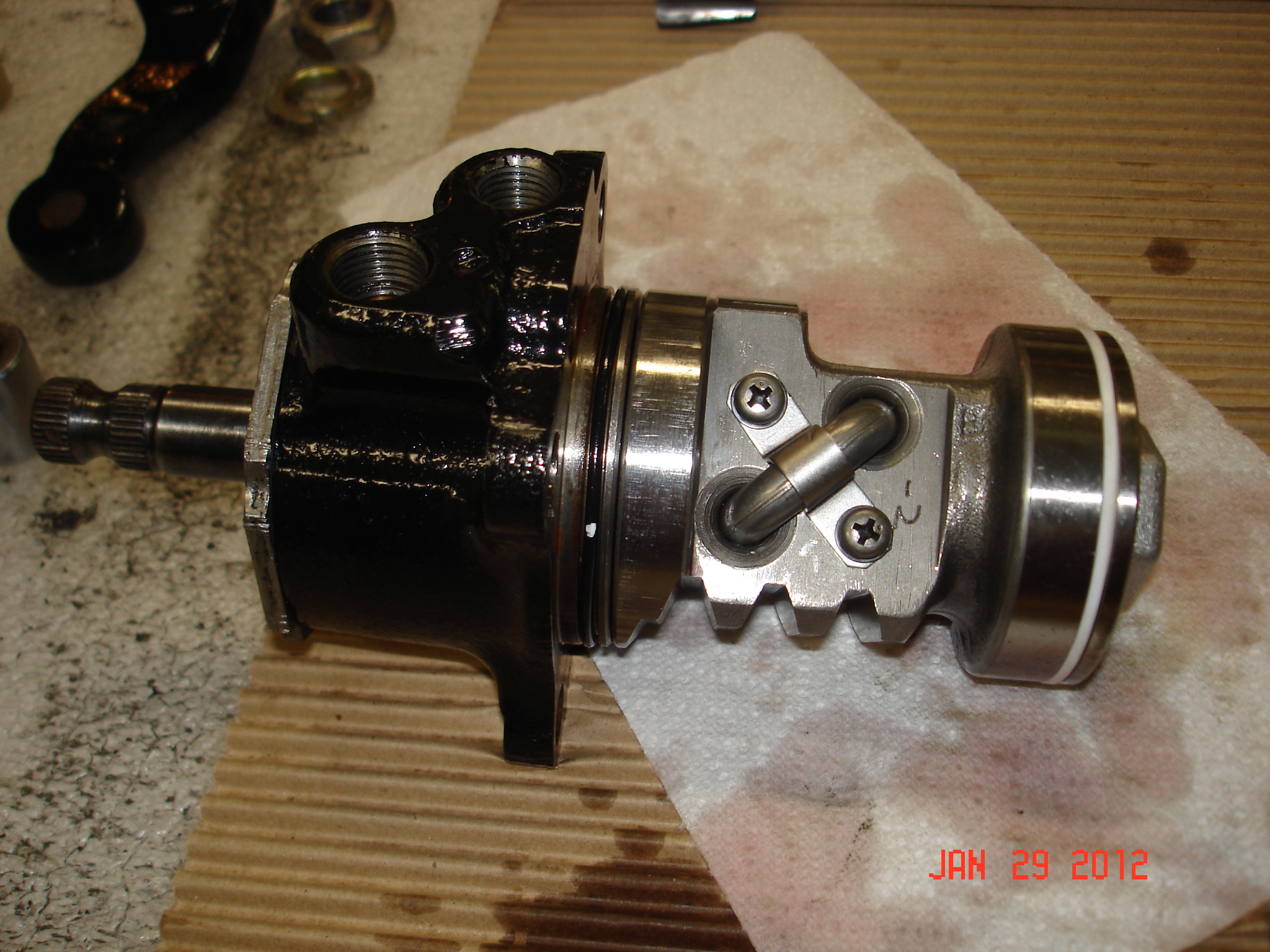

Tap the valve/piston assembly out of the box with your mallet (lightly!)

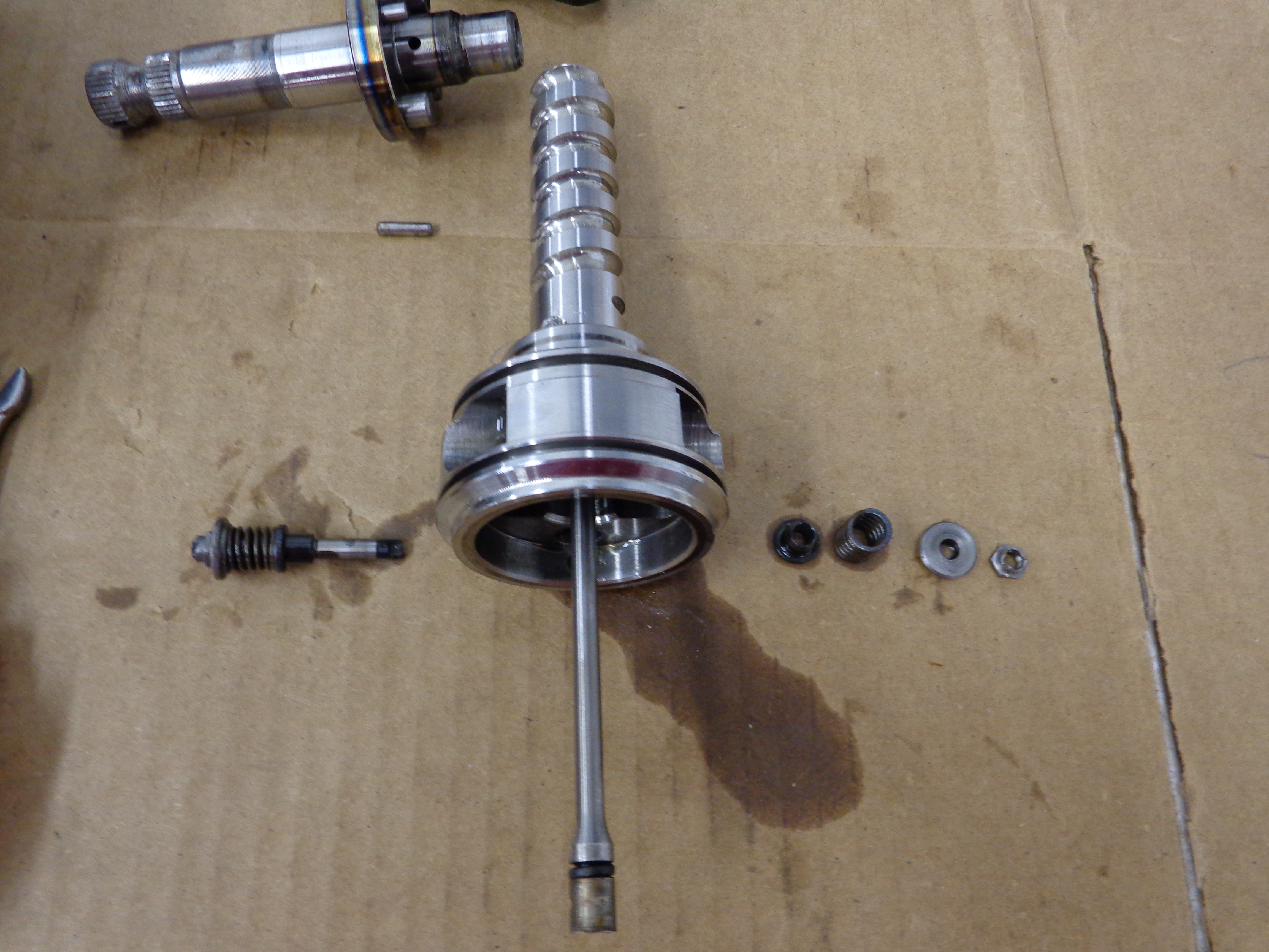

Take the valve/piston assembly out and put it on your bench.  Use a rag or papertowel to capture 26 tiny ball bearings that are going to come out of the piston.

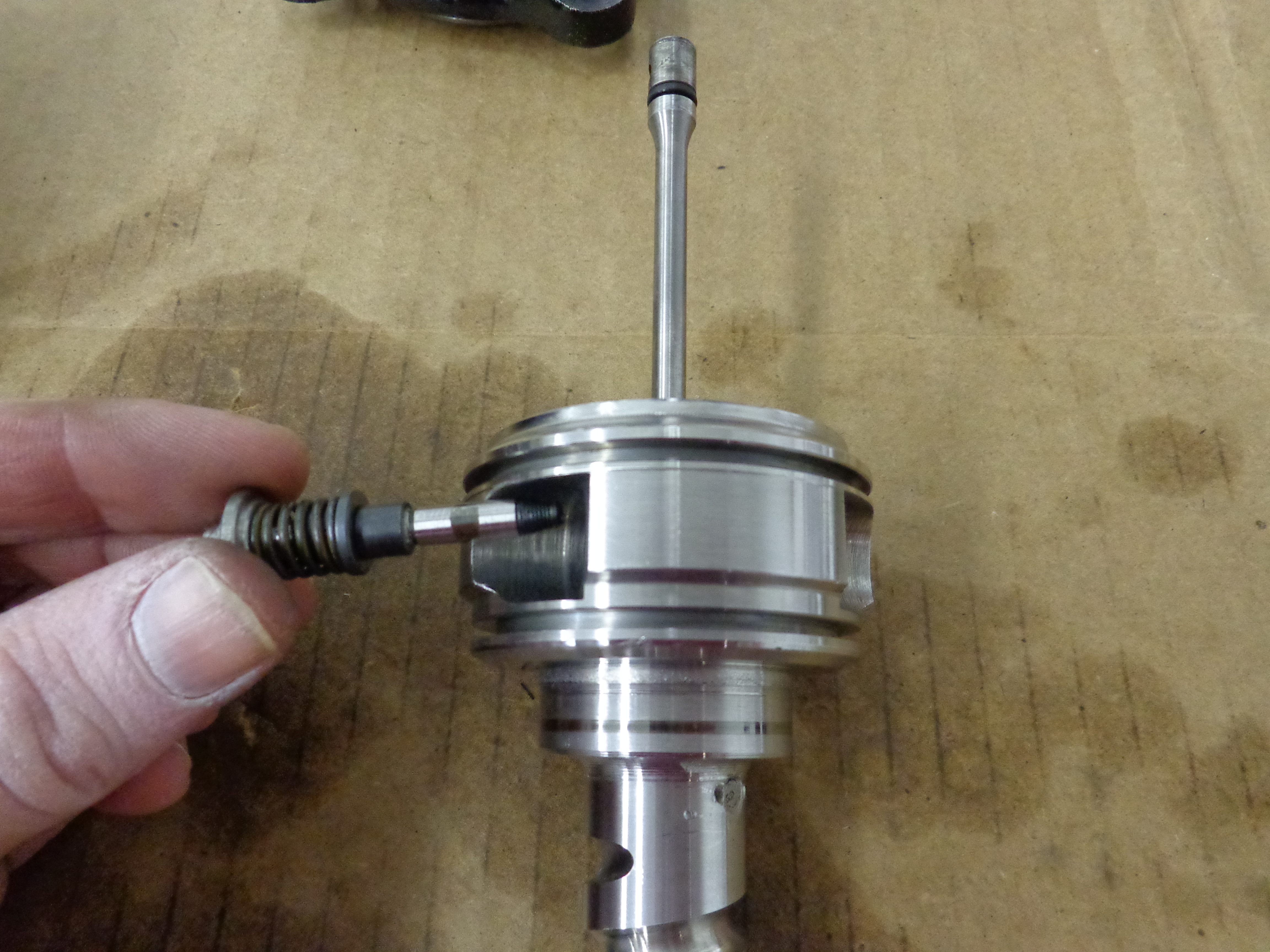

Rotate piston assembly (counterclockwise) to thread it off of the main shaft assembly.   Capture those bearings!

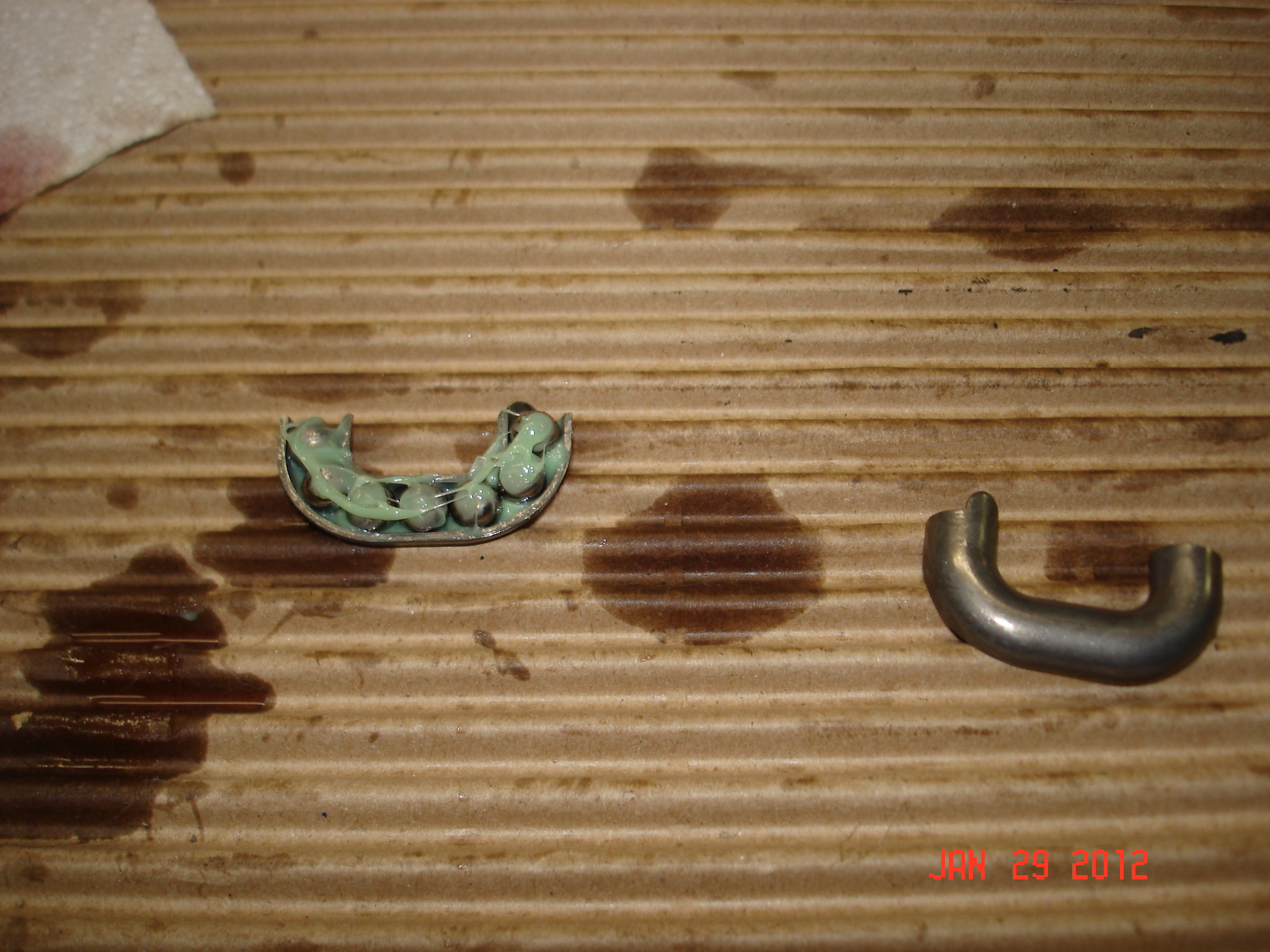

Remove the two phillips head screws:
And remove the U-pipe.

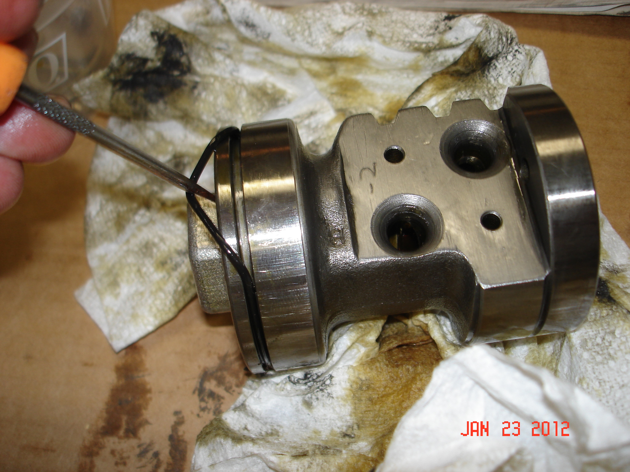

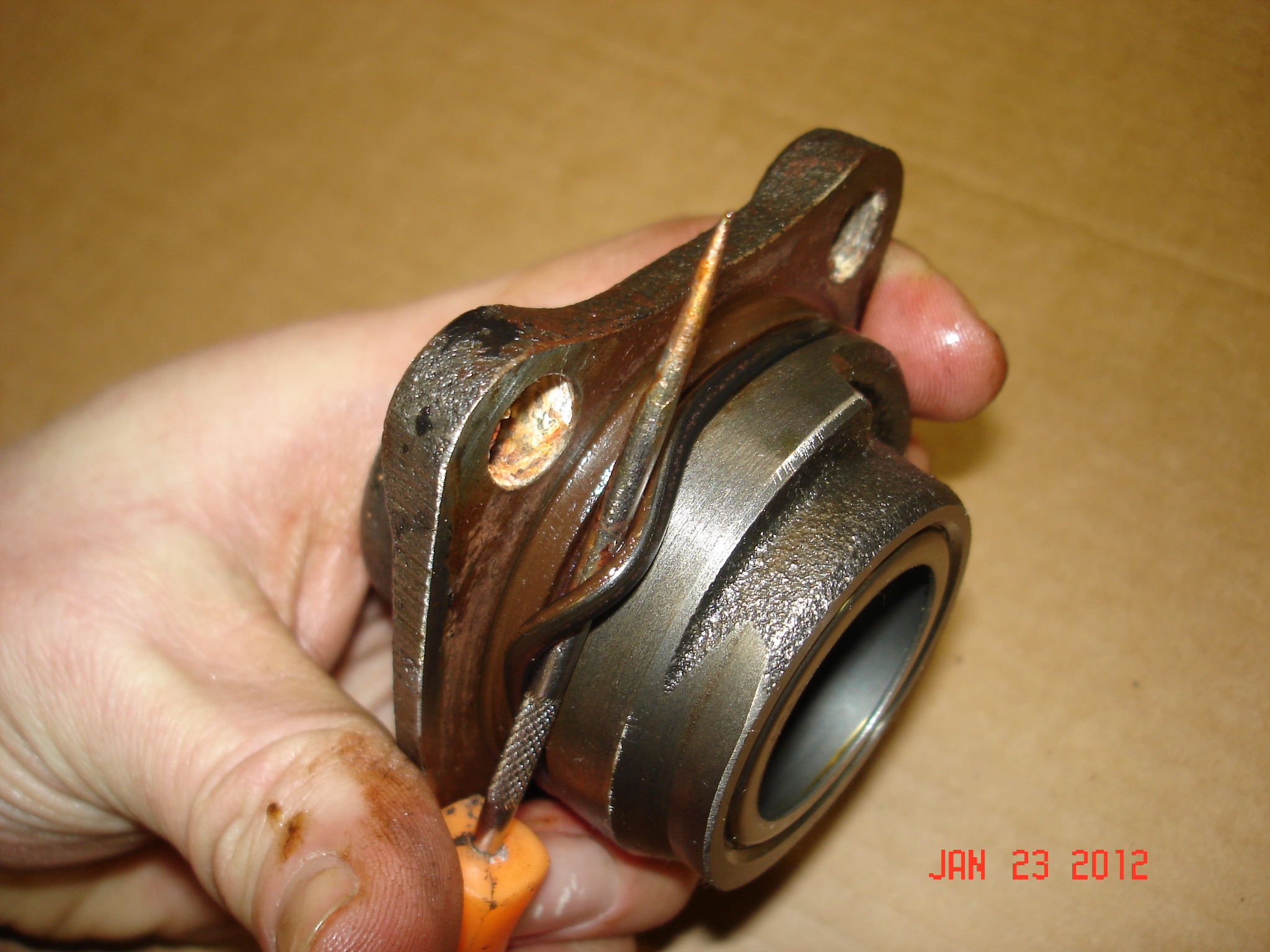

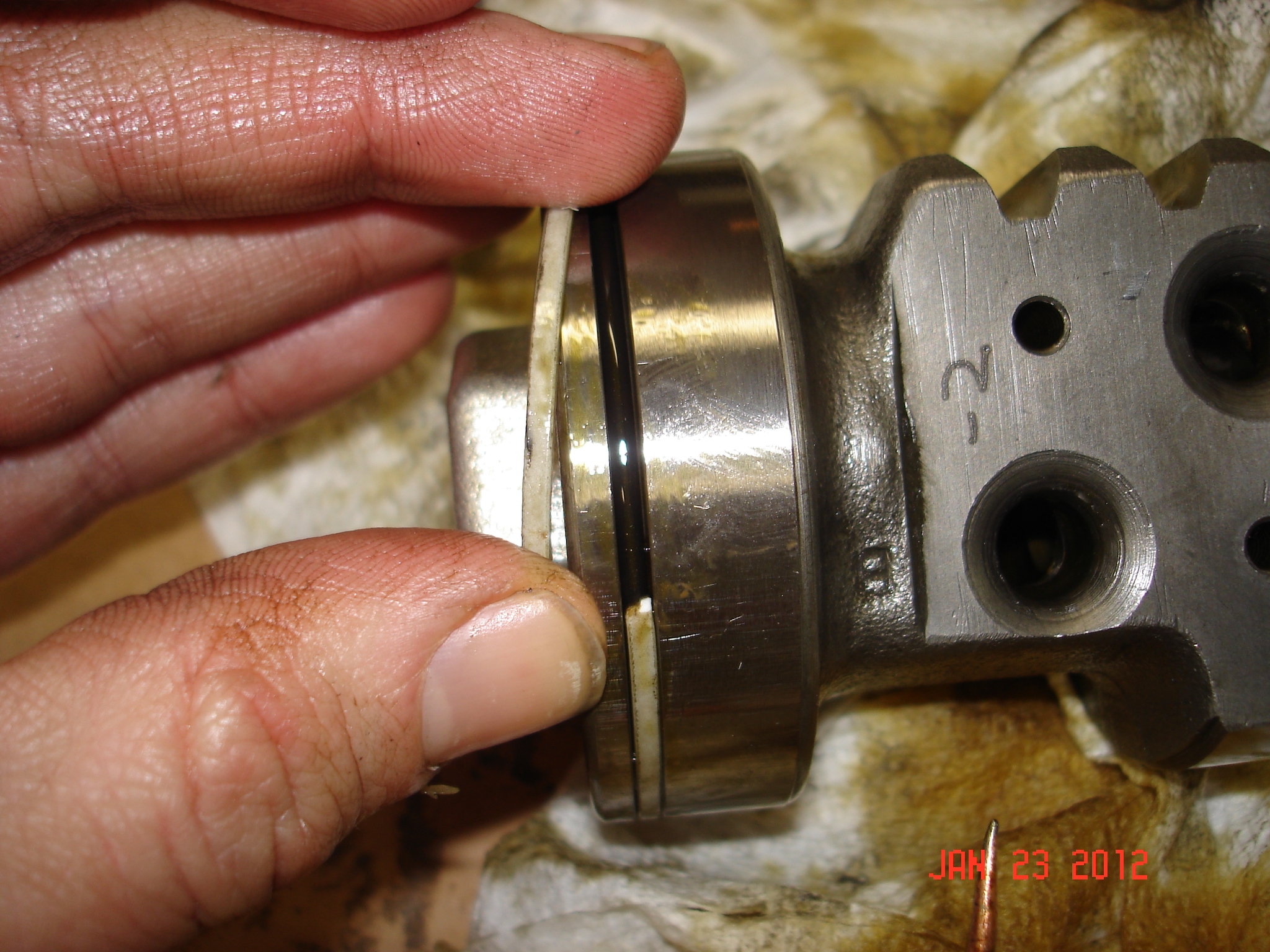

Remove the seal ring and o-ring from the piston.   Keep track of it, you'll need to pick the right one from you seal kit to reinstall later.
The o-ring is under the seal ring.
OK, the piston is fully disassembled.

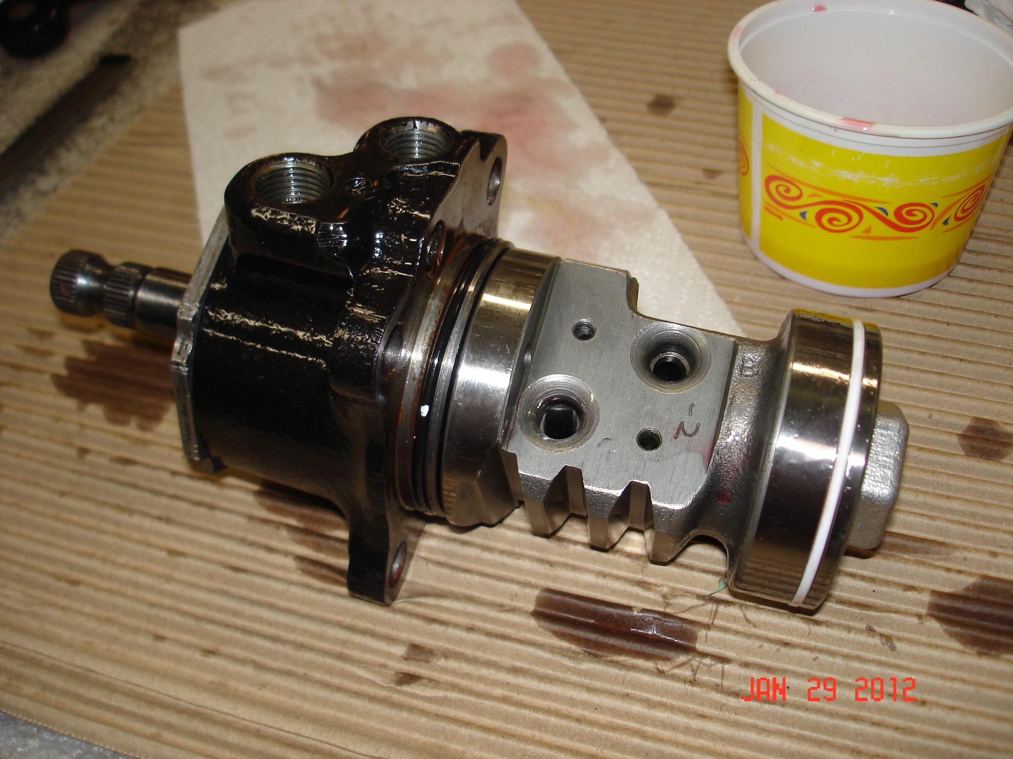

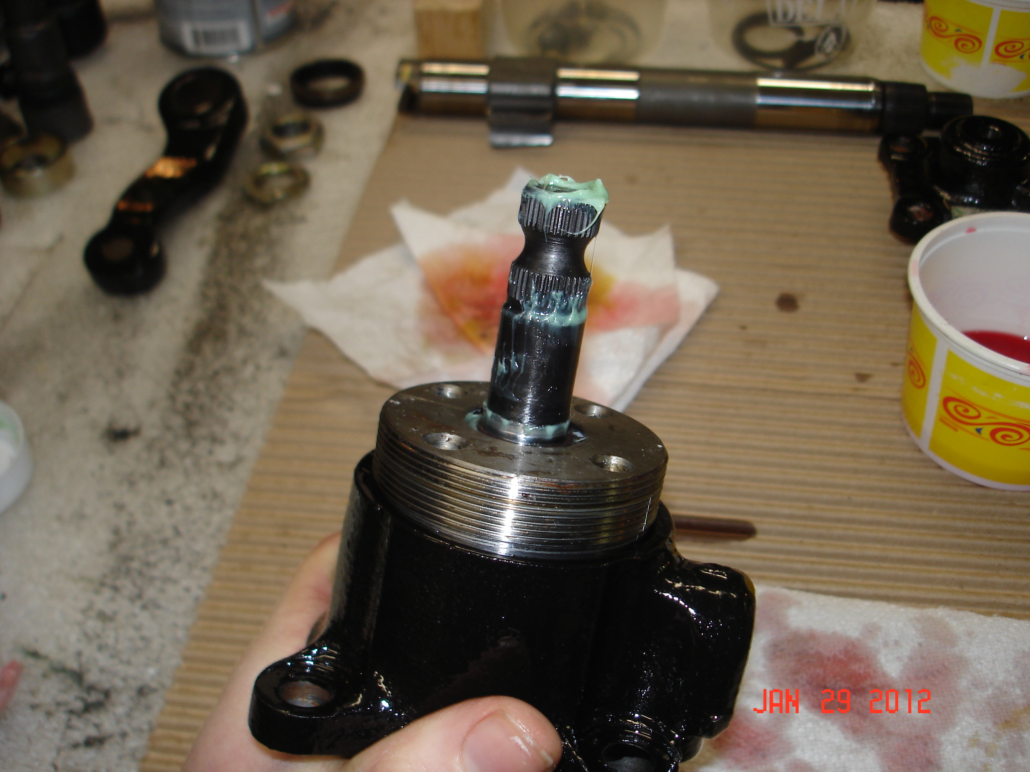

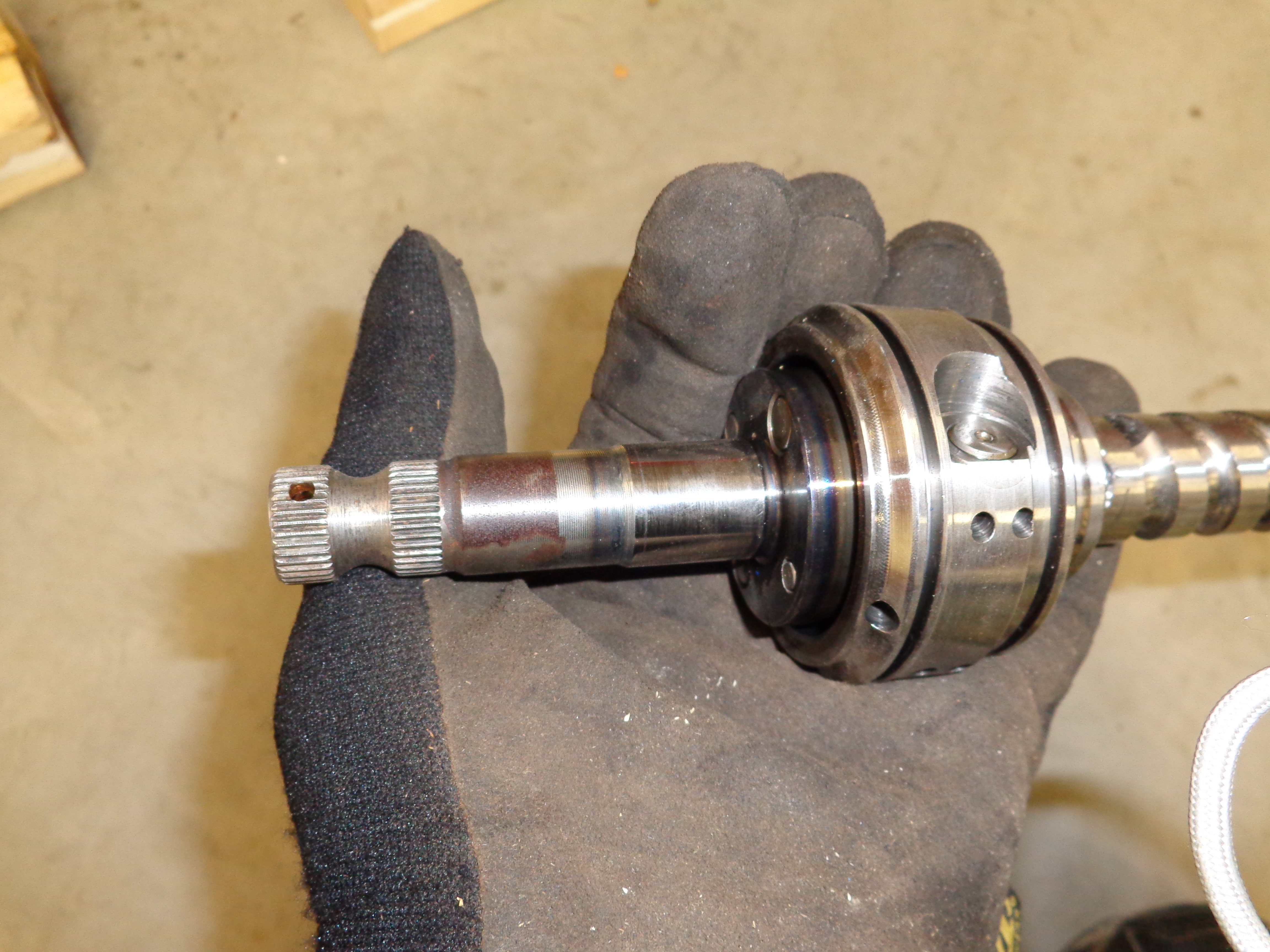

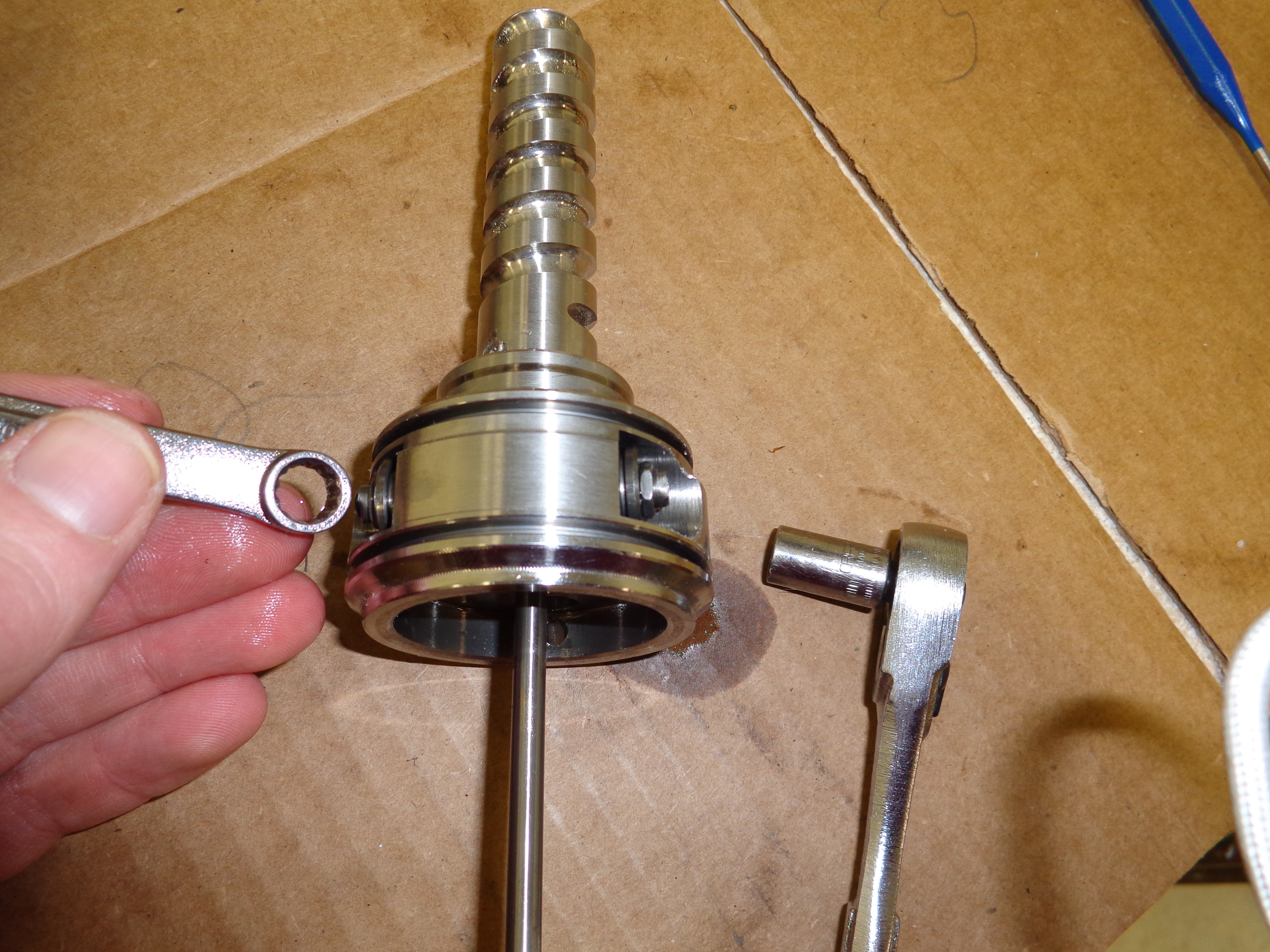

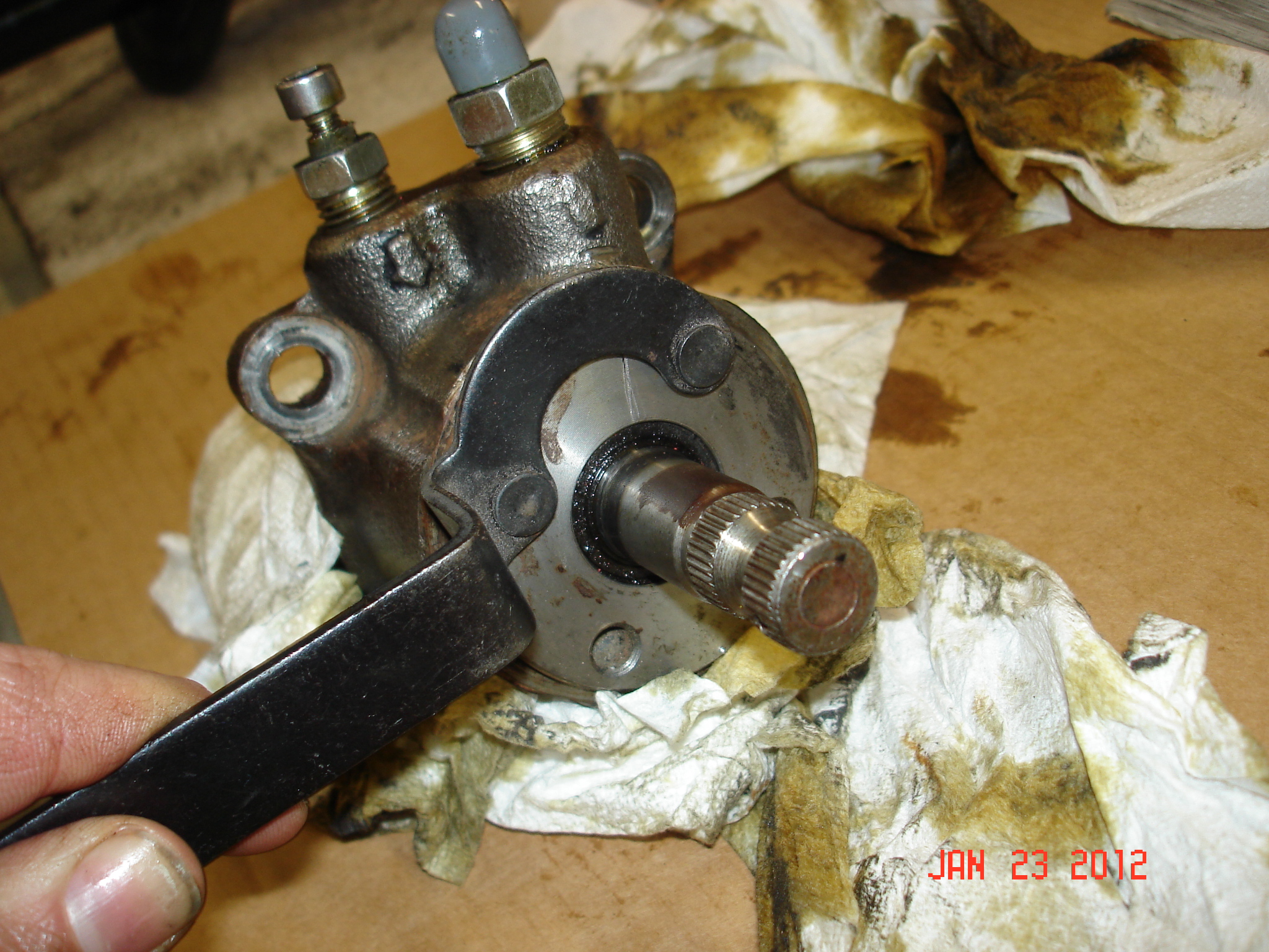

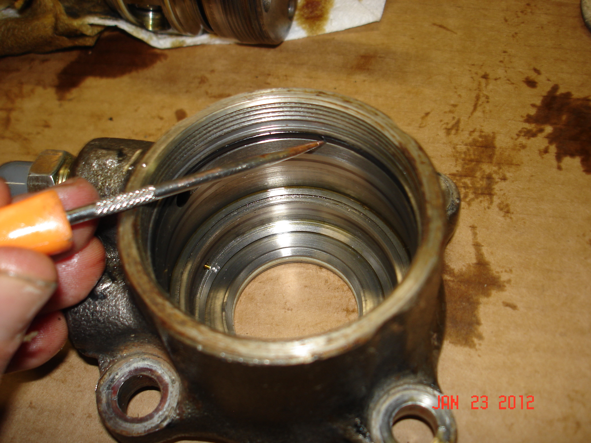

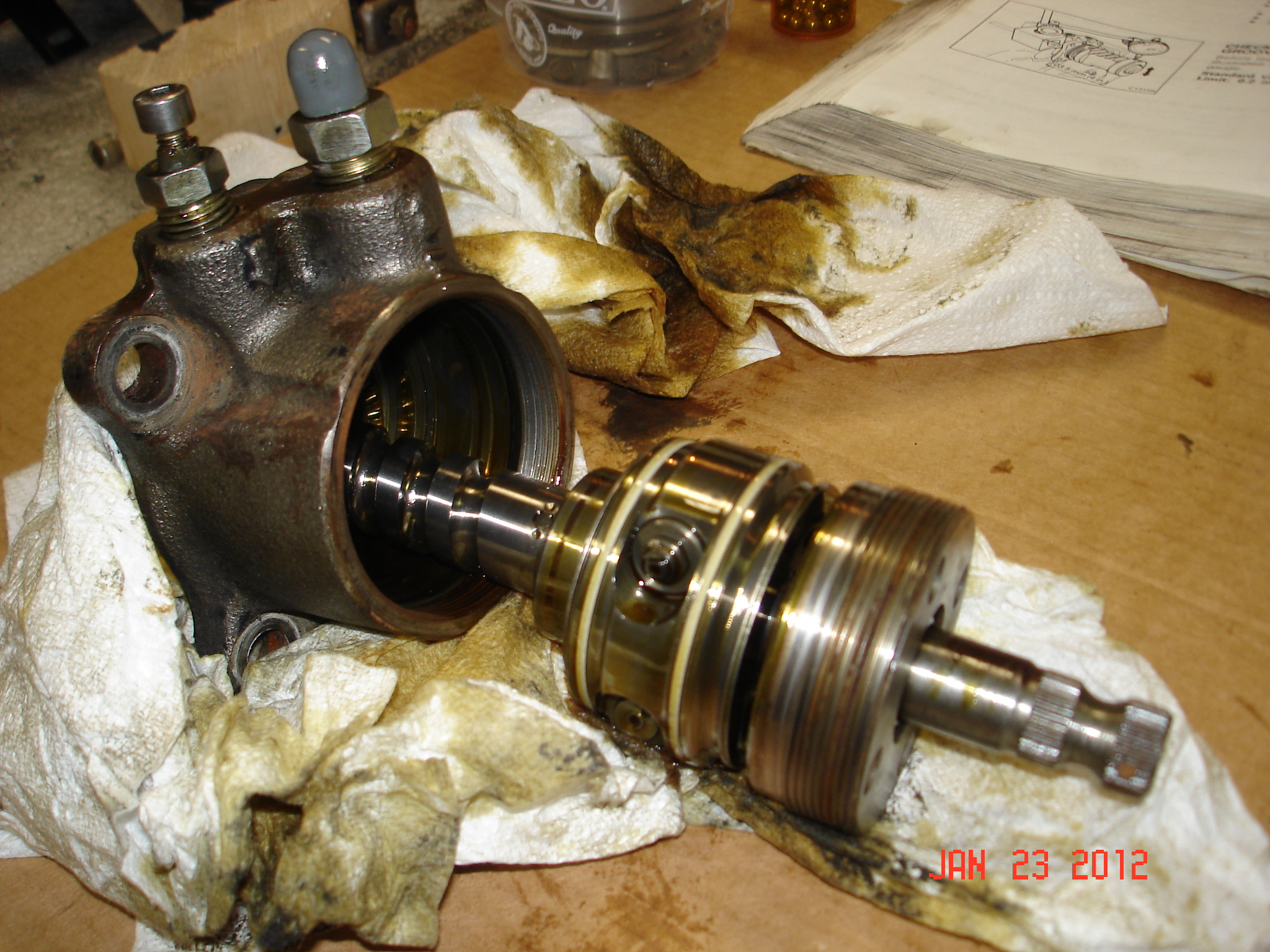

Use your spanner wrench to remove the top cover from the valve housing (If you don't have a spanner wrench, I have used needle nose pliers in the past...there is hardly any load on the threads)
Pull top cover and main shaft out of the valve assembly:
Remove O-ring on ID of valve assembly
Remove seal ring and o-ring:
Remove small o-ring on valve housing (may be stuck to body of box).  And also o-ring on OD of valve body
That it for the valve assembly.

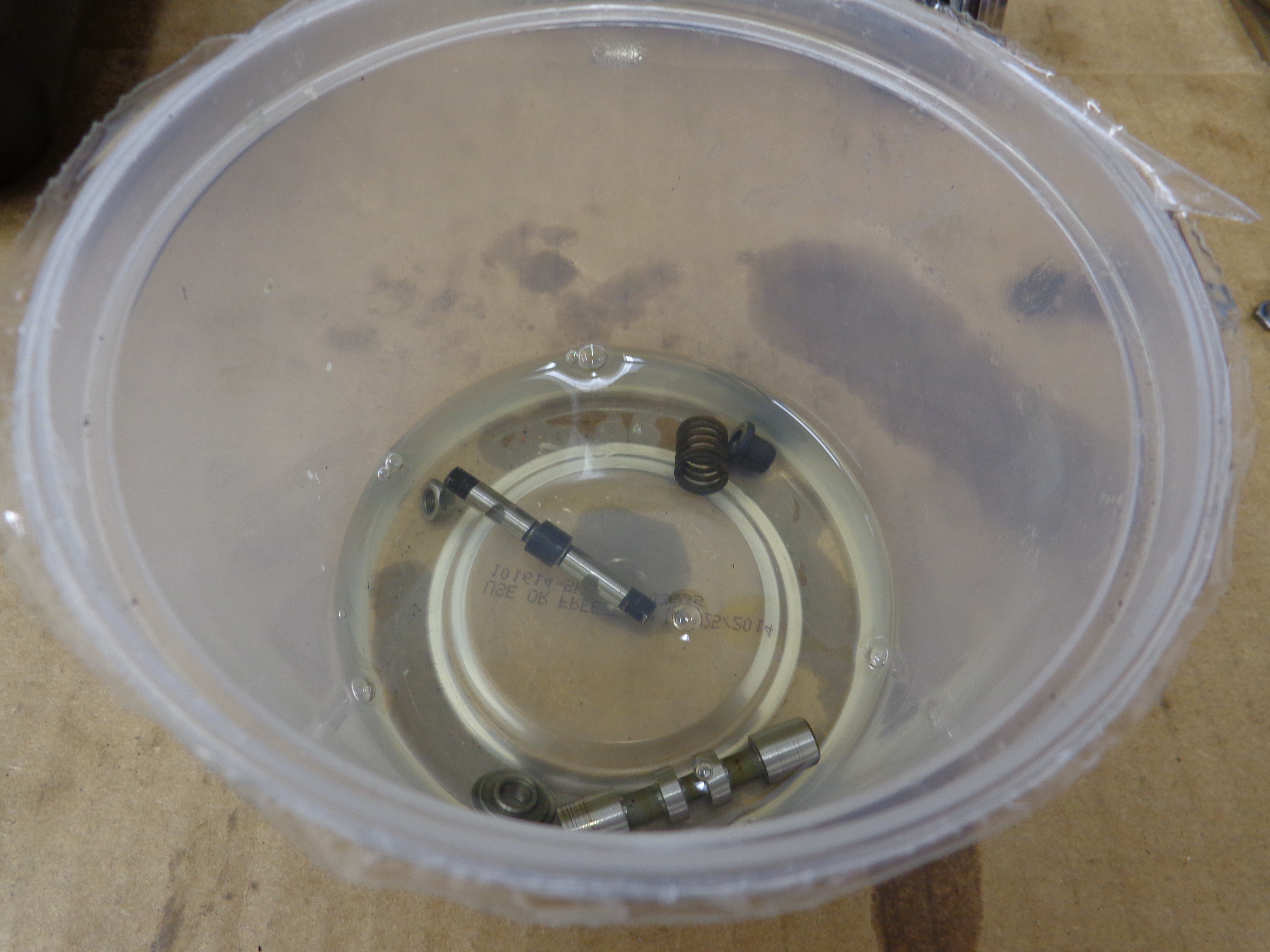

RECORD WHERE EVERY SEAL RING AND O RING WENT.... OR ORGANIZE THEM IN CUPS AS I DID

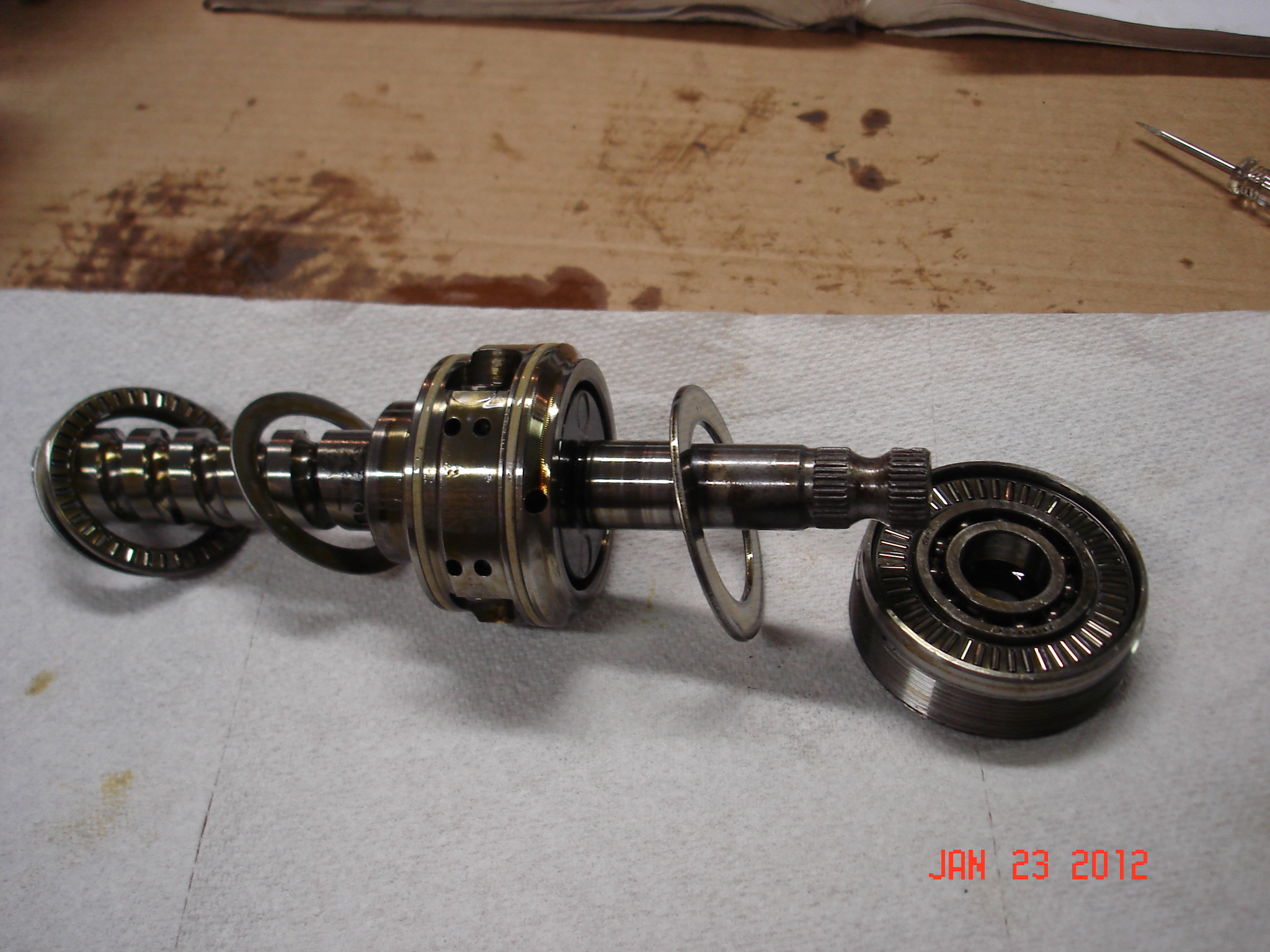

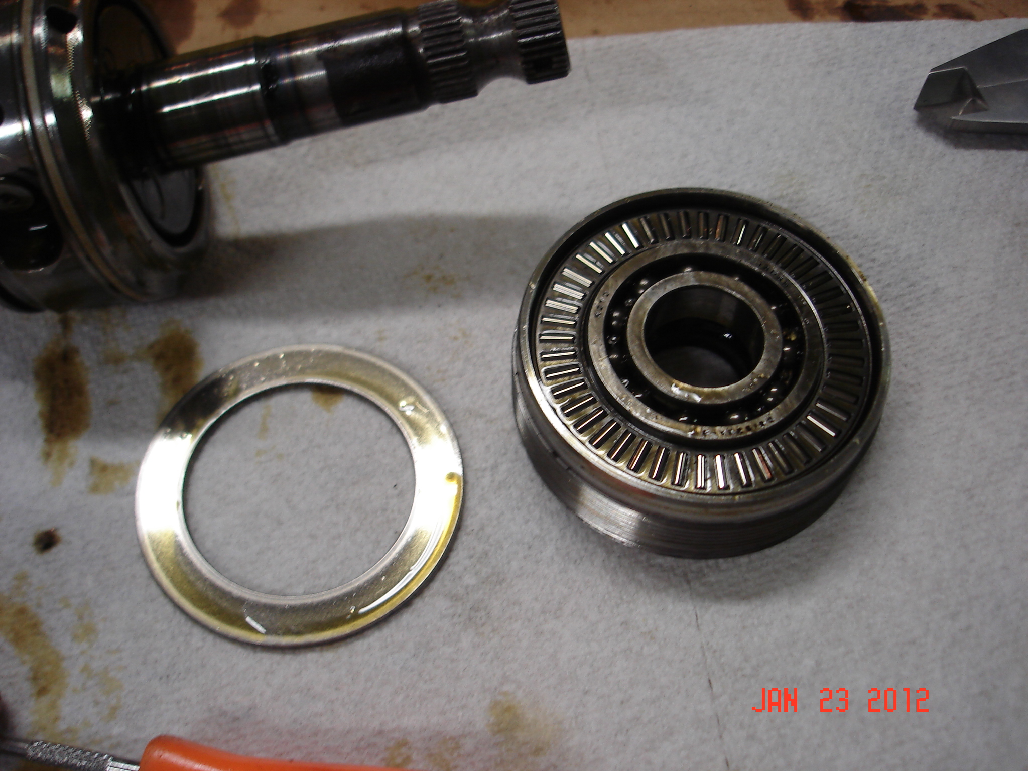

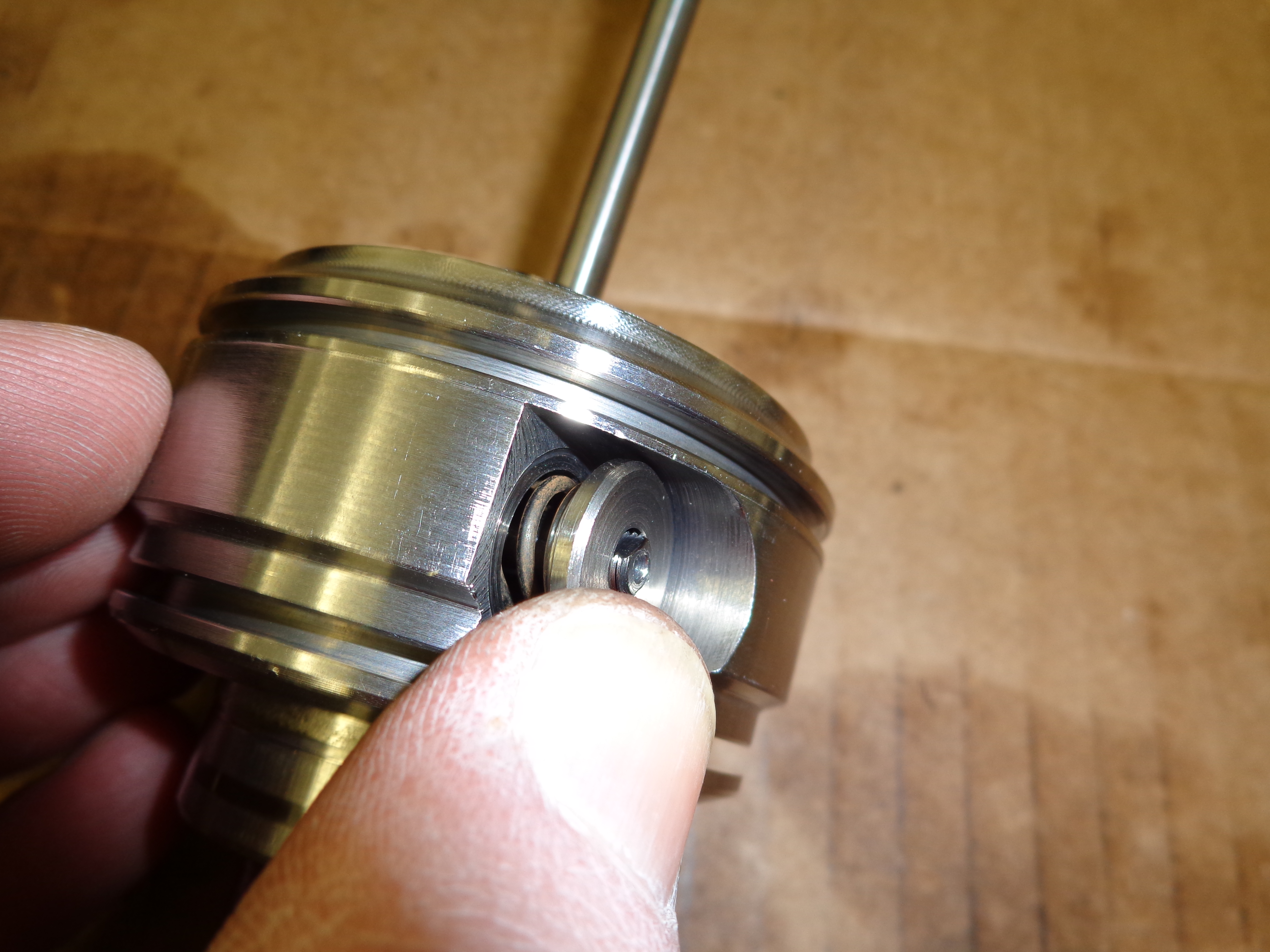

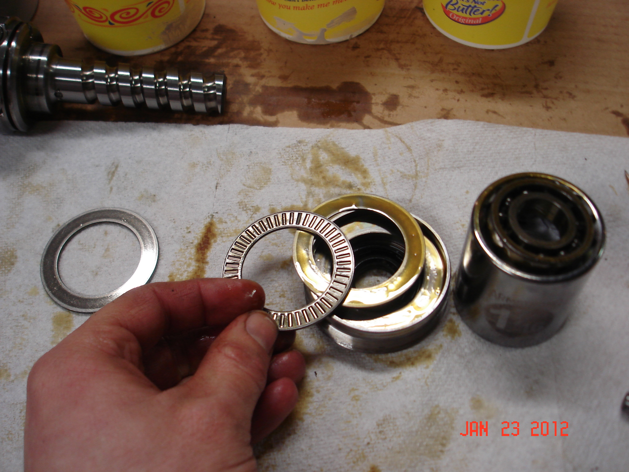

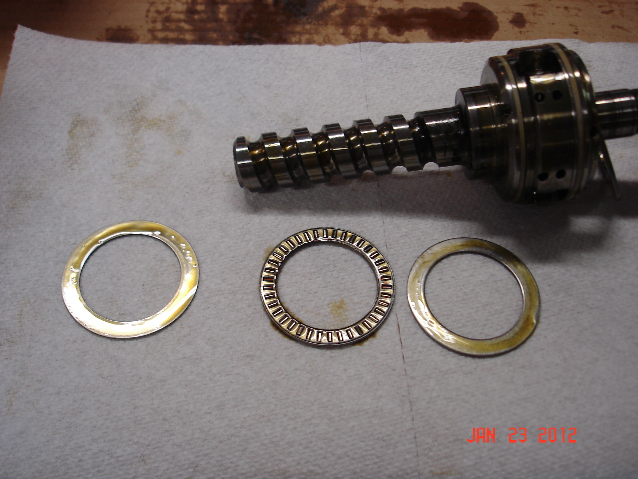

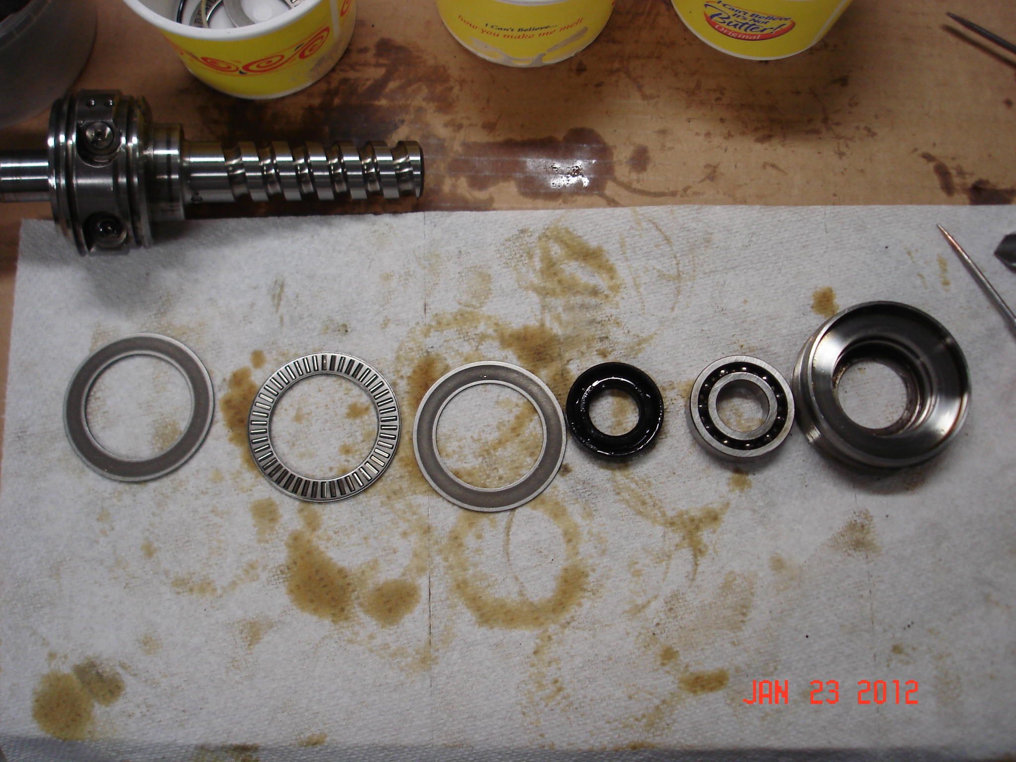

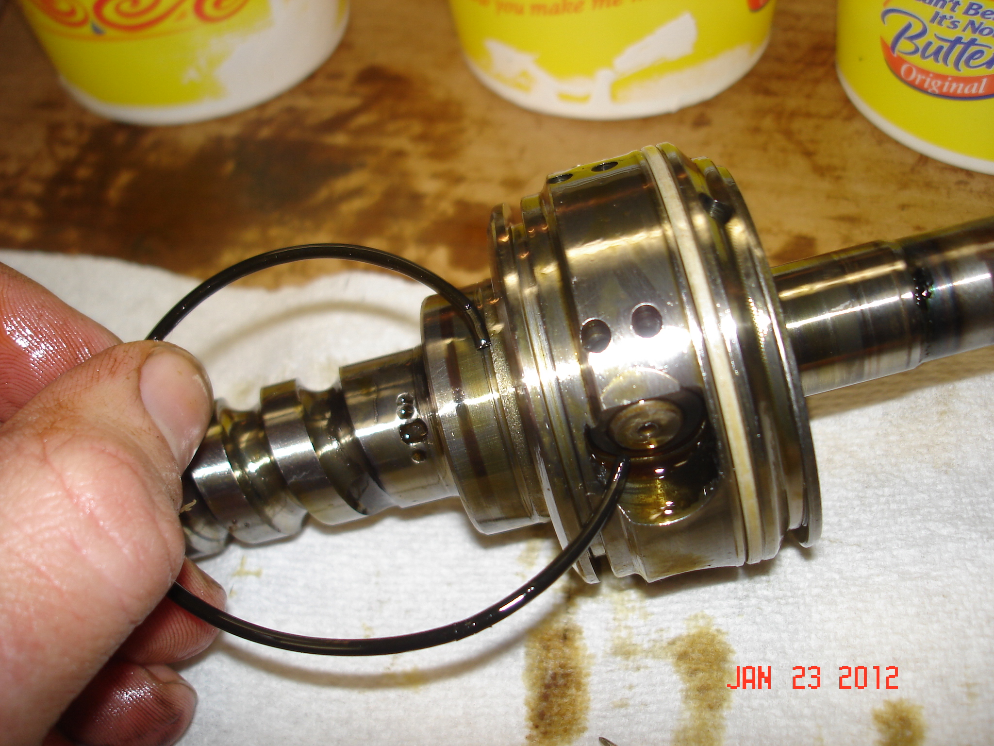

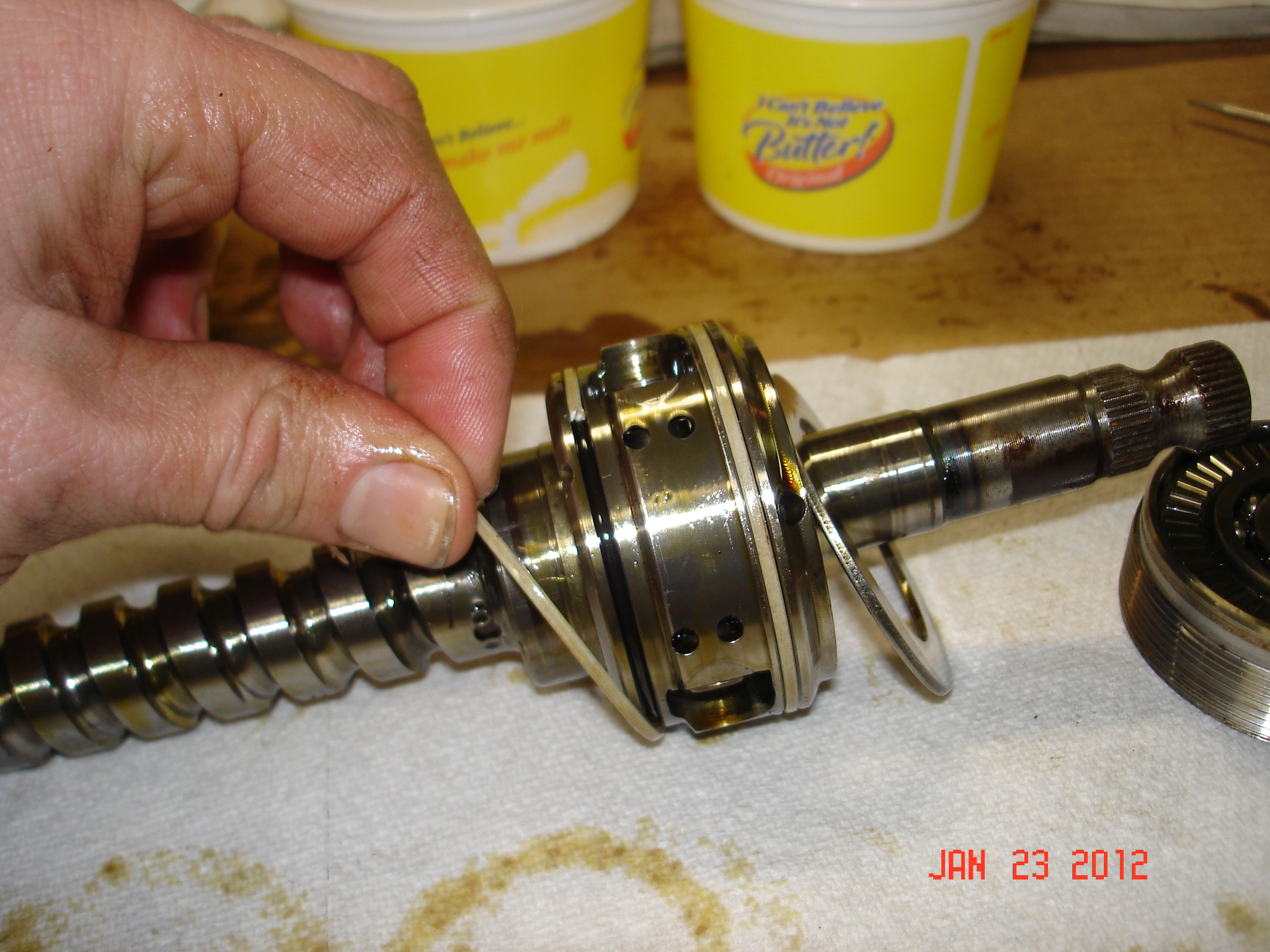

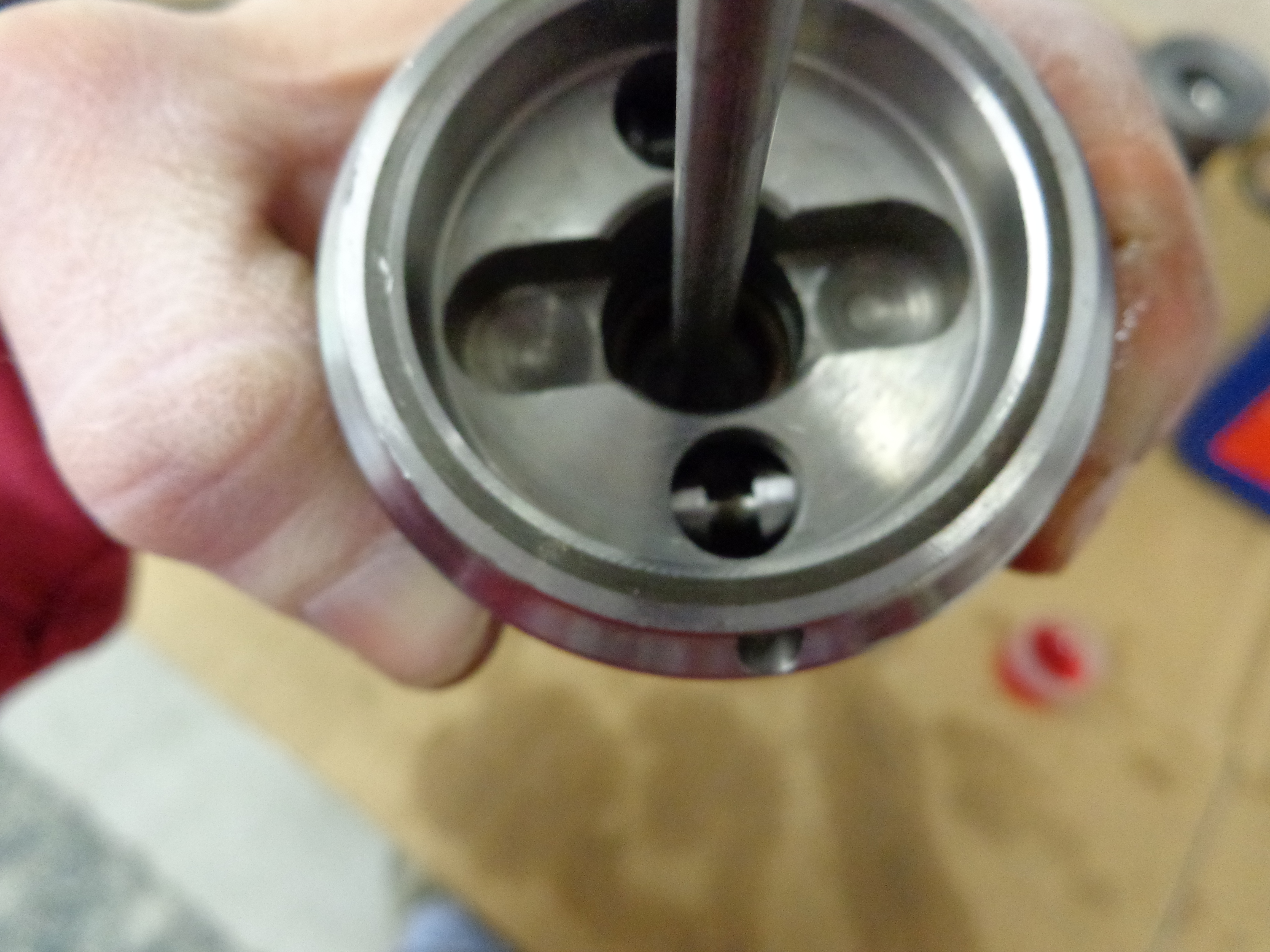

Back to the main shaft.   Be carefull here.  Take your time with these thrust bearings.  Note: the thrust bearings comprise of three parts, two hardened washers of different thicknesses and the bearing itself.  The parts list only calls this 'three part assembly' a single bearing...so it's confusing.
Start with the piston side.  Remove each part of the bearing in order and lay on your bench.  Record thickness of each hardened washer.  Note the manuals say that one of the washers is thicker....I've rebuilt three of these pumps over the years and the two washers were the same thickness on this particular bearing (it is not the case on the bearing on the top cover side!!!!).   But always make your measurements and record.
Remove the seal ring and o ring on the same side of the main shaft as you removed the thrust bearing.  Store together for aide in reassembly:
Ok, on the the other side of the main shaft.   Note that two of my three piece bearing remains in the top cover...hyraulically stuck with the ATF.  Don't worry about trying to get them out yet.  Go for the ball bearing in the center.

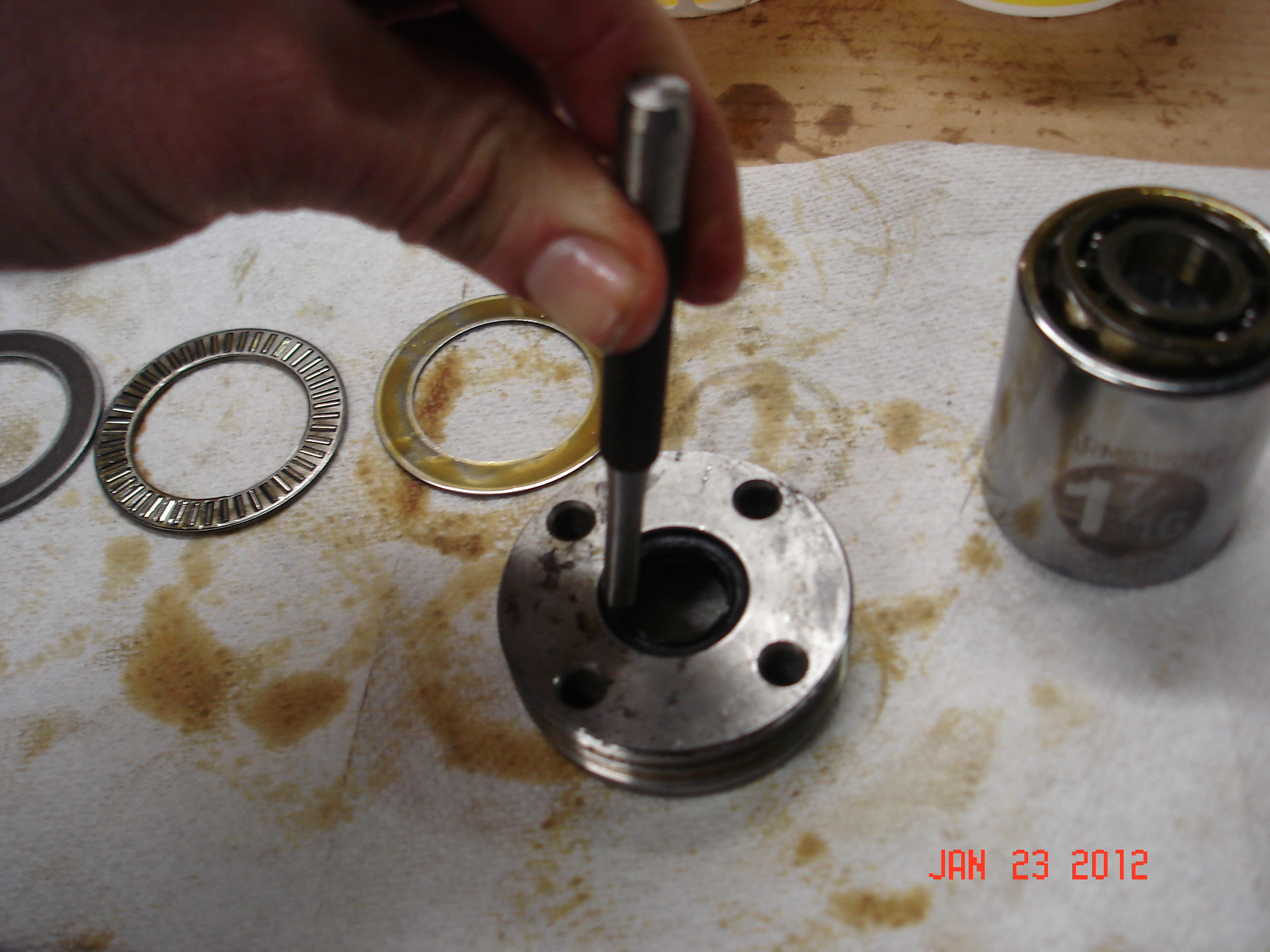

The center ball bearing is loosely pressed in the top cover.  One nice hit with a mallet and a punch, as shown, knocks it out.   Don't go overboard, just tap her with the mallet.   Then the rest of your thrust bearing can be removed with ease.
Keep track of that three piece thrust bearing...Note which washer goes where (they are different thicknesses on this joint!!!!)
Knock out the oil seal with your punch:

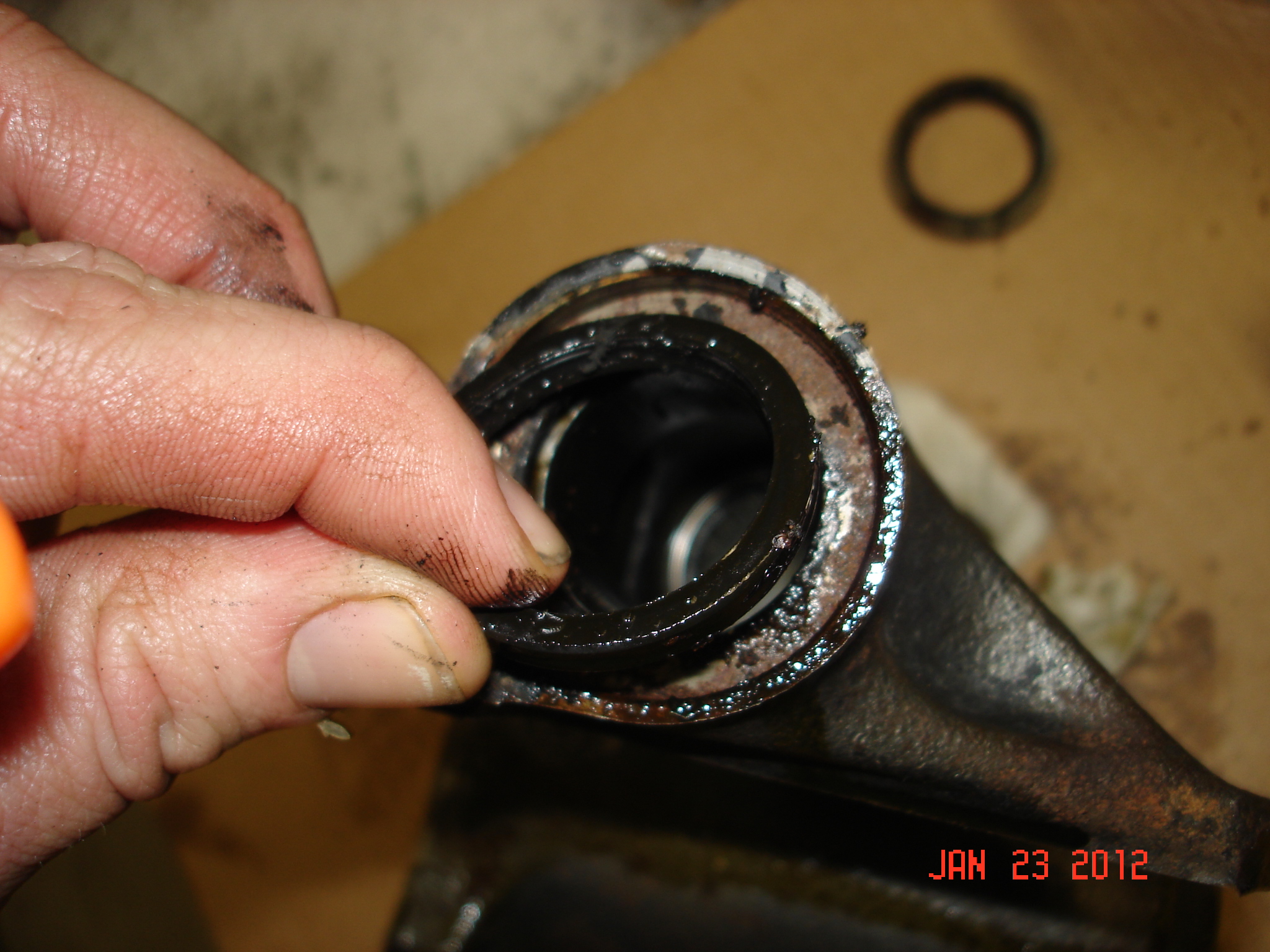

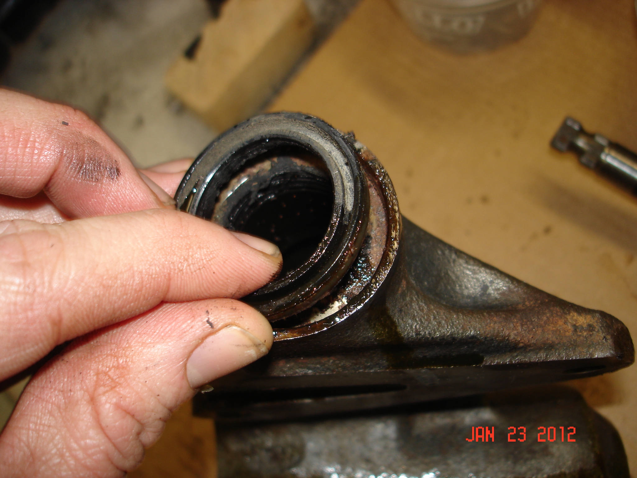

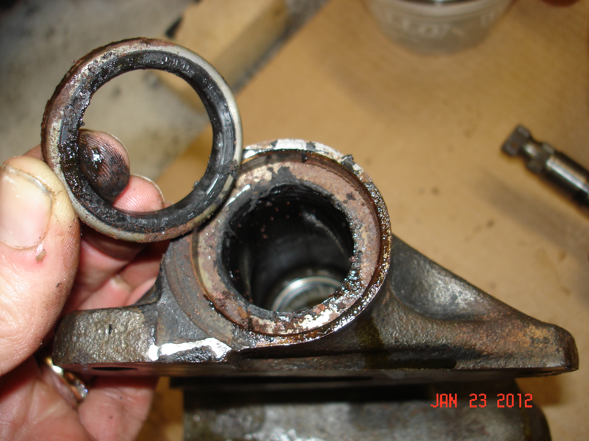

Remove the dust seal on the bottom of the box:
Note the direction the seal was installed:
Under the dust seal, you will see the oil seal.  Remove it as well, taking note of how it is installed.  Record or snap a picture to remind you on reassembly.  (the manuals also show the direction on reassembly).

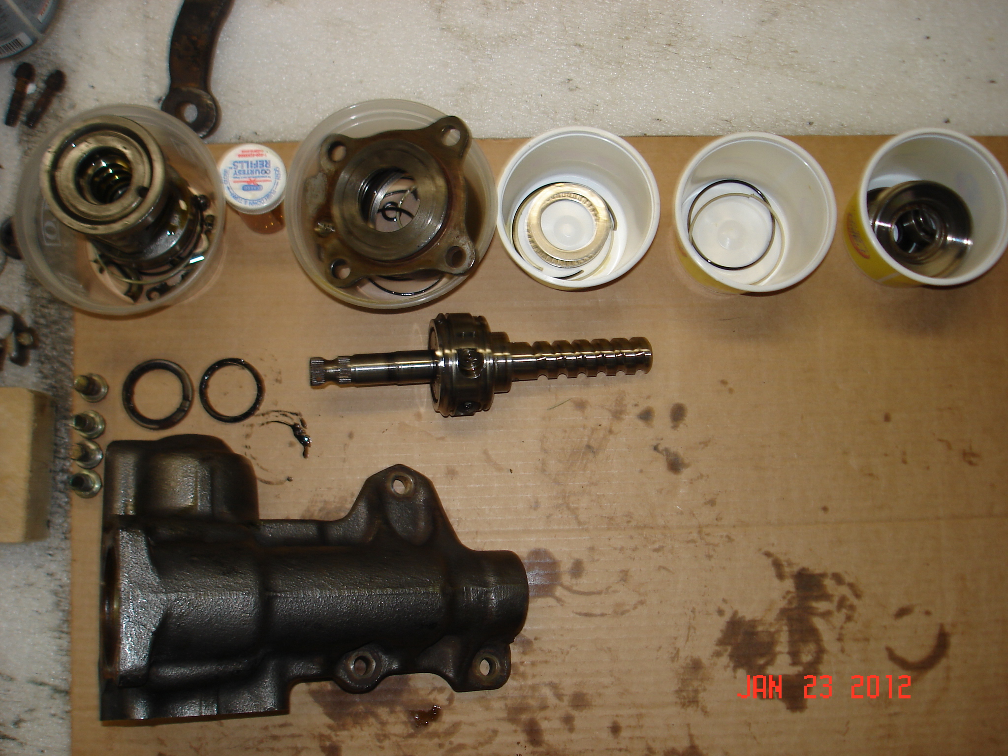

Ok, it's fully disassembled!   Now...go thru your parts.  Make sure you know where each one came from.  Take pics, notes, whatever you need to do for reassembly.  I like to use cups to group things in:
Now.  clean each part in a parts washer.   If you don't own a parts washer, go buy one!  This one was $30 from pep boys.  It holds three gallons of mineral spirits.  I literally have never refilled the mineral spirits in the 4 years that I've owned this parts washer!   The savings in solvent alone pays for the washer:
I didn't snap pictures during the cleaning process (I only have two hands...full of mineral spirits).   But thoroughly clean the parts...specifically the valve body and the main shaft assembly (shown in the washer below).  I let the main shaft soak 100% in the spirits for 30 mins or so...then flush all the ports of the valve body and main shaft out with the parts cleaner.
Clean and dry every part.   Put down a new piece of cardboard or clean your bench.   Arrange the parts neatly so you know what everything is.   And yes, I applied the por-15 on the body components in between these steps.

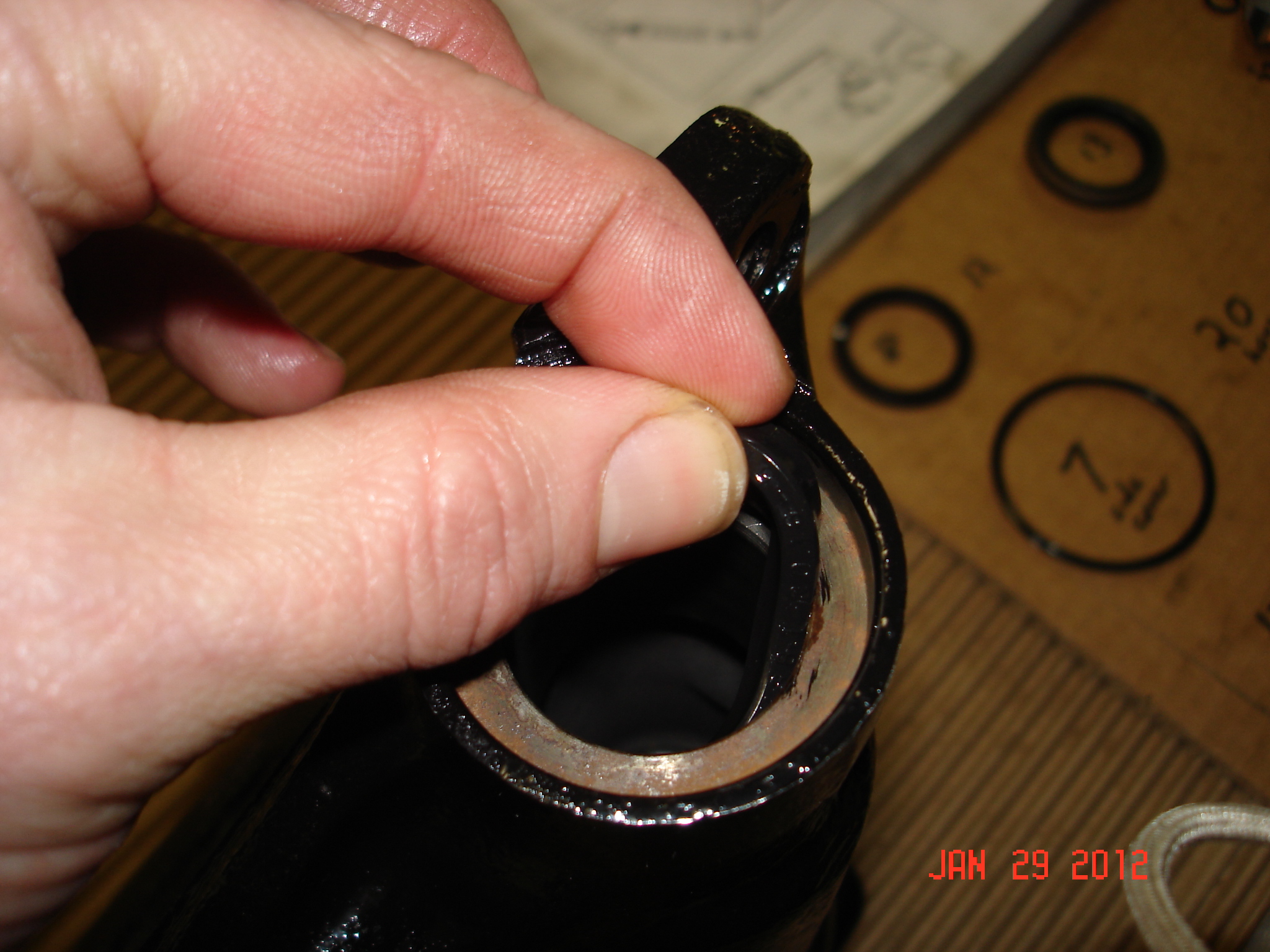

Now go thru your rebuild kit and organize the o-rings, seals, etc.   Compare sizes from the ones you took off to determine which one goes where.   I used the numbers pertaining to each ring from the parts list to label mine.   Note that the orings are organized from thickest to thinest.  The seals are from largest diameter to smallest.

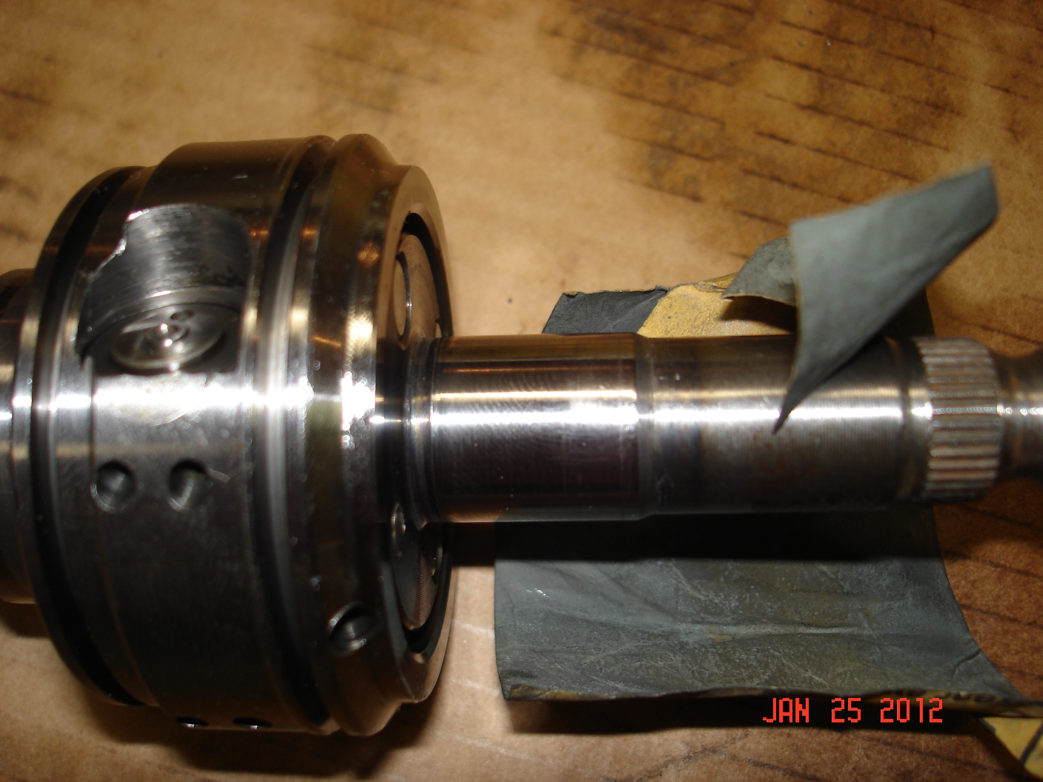

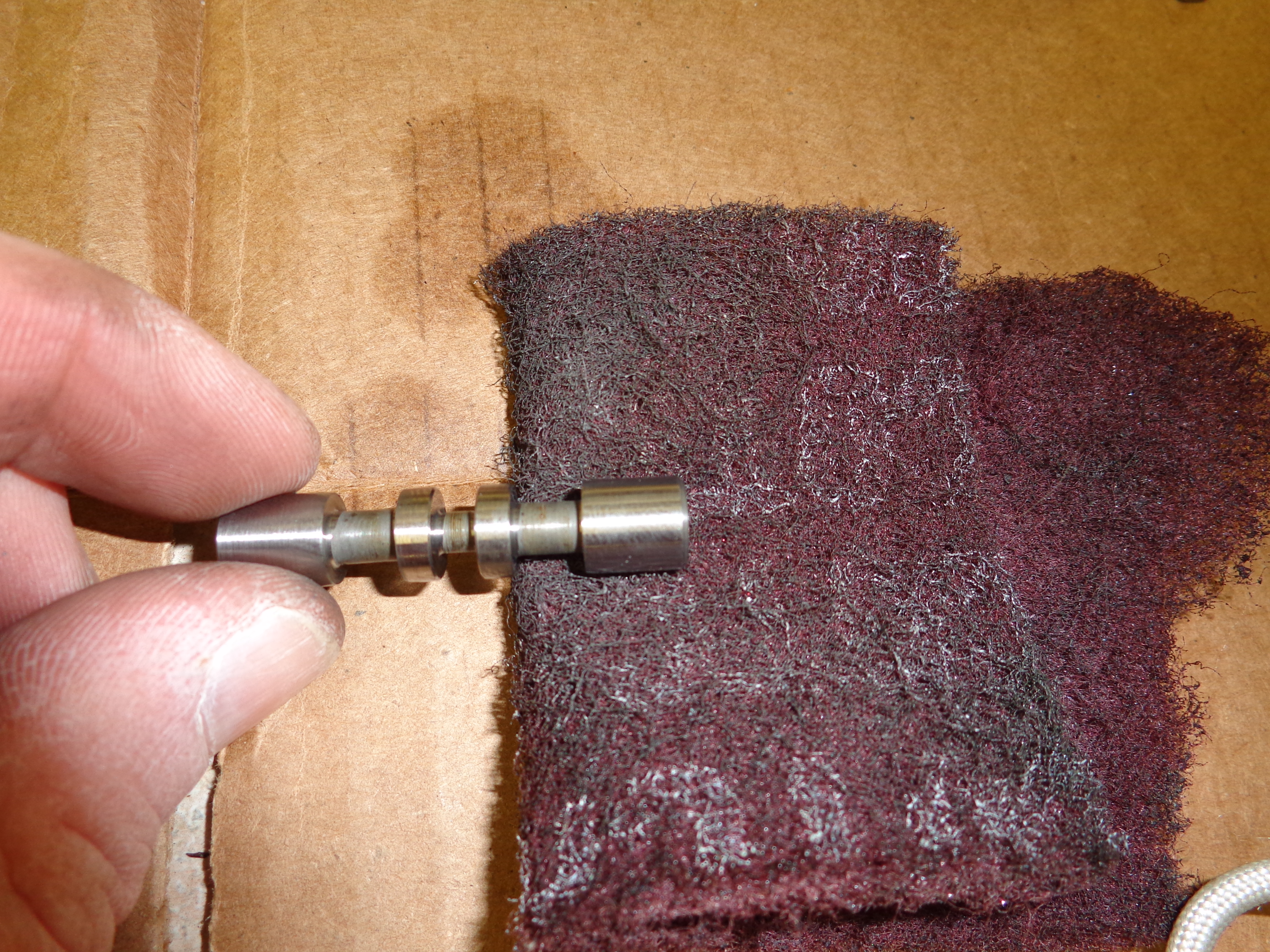

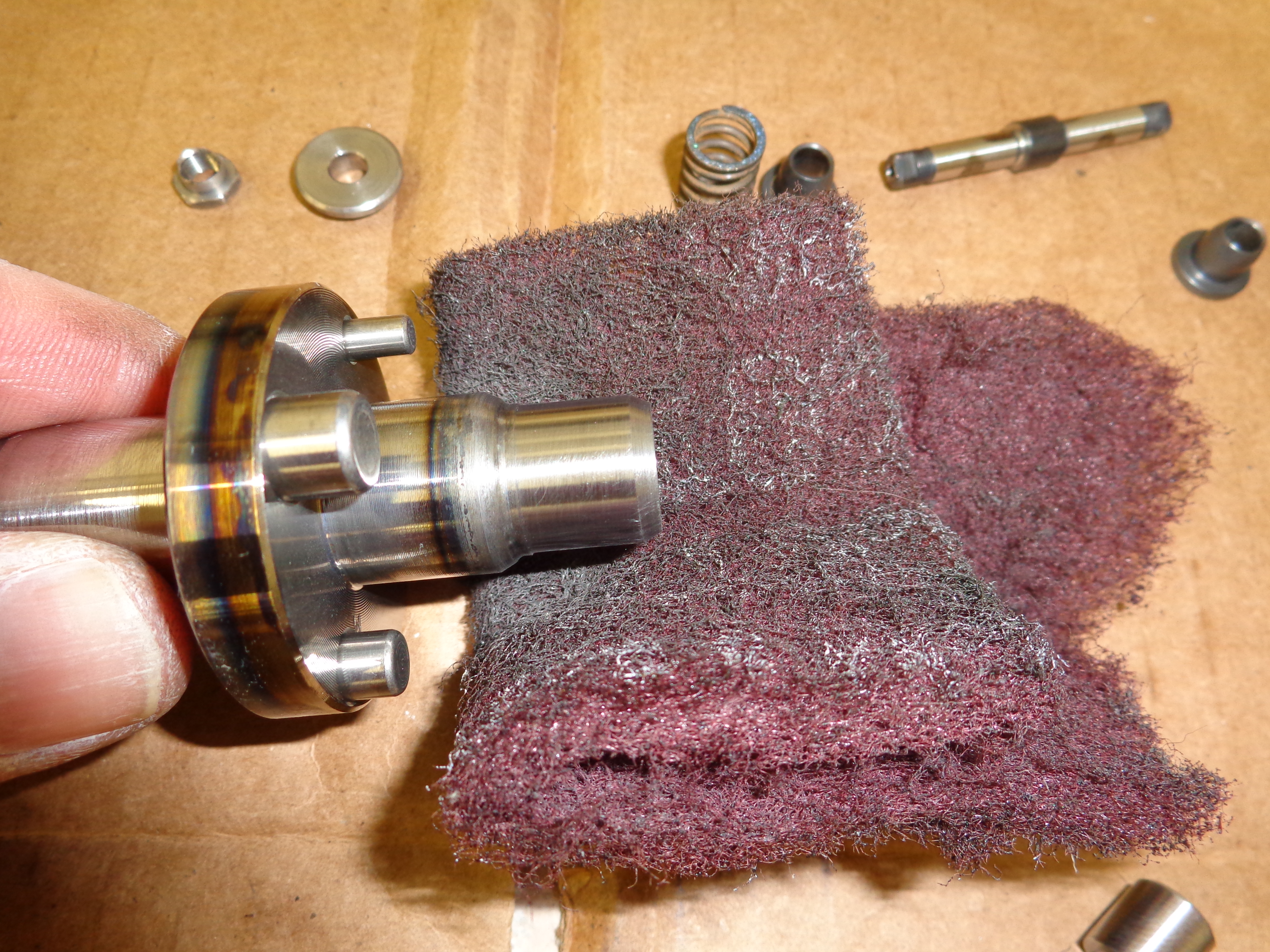

I used a piece of 2000 grit emery cloth on the ends of both shafts where the oil seals go.   Note the condition of the primary shaft.   This is the number one reason why boxes leak.  Dirt/grime builds up and makes it way to the seal.  Corrosion sets in and the shaft leaks.   This particular box did not leak prior to rebuild.  So I used the 2000 grit to clean it up and make it nice and smooth.  I wasn't willing to remove material from the shaft...you may have to do so if  yours was leaking badly and you have a lot of pitting. Removing material and/or leaving the pitting may result in a leaky box even after rebuild!   You make the judge to determine where to go from this point.  I simply smoothed it up and will heavily greese the seals.
Here is what you will need for reassembly:  some grease (any type you like to use, ive always liked green grease) and some ATF.

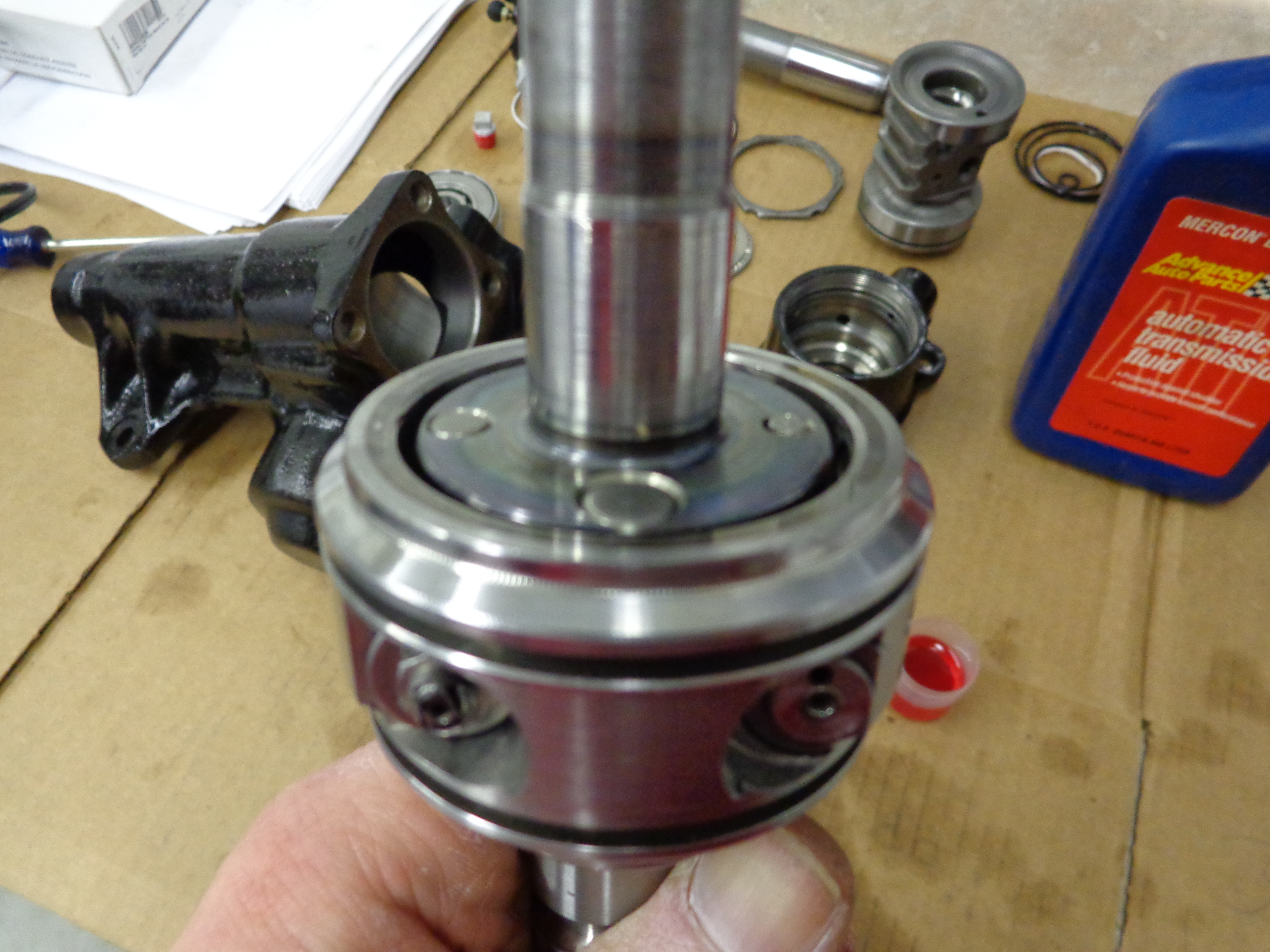

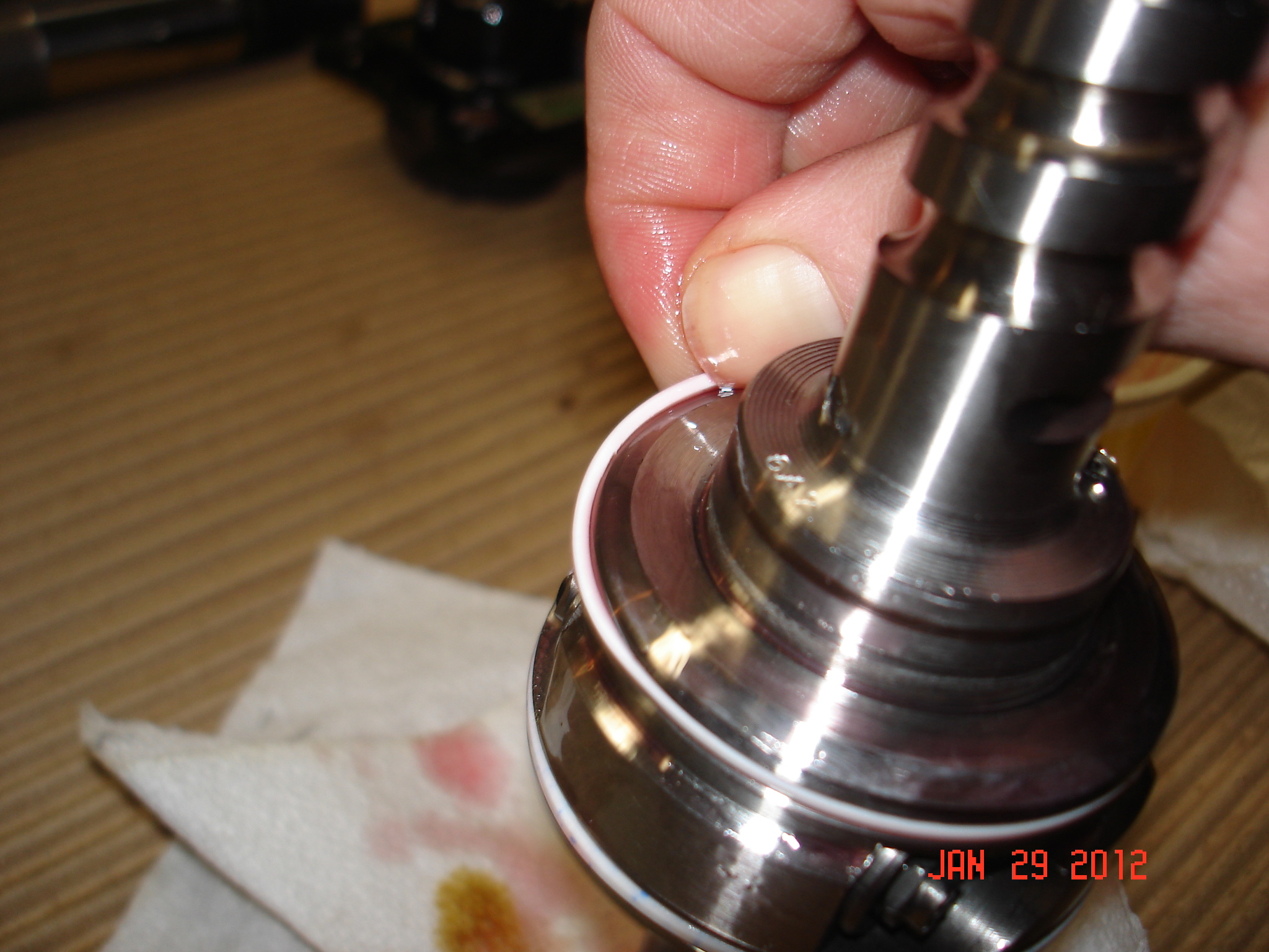

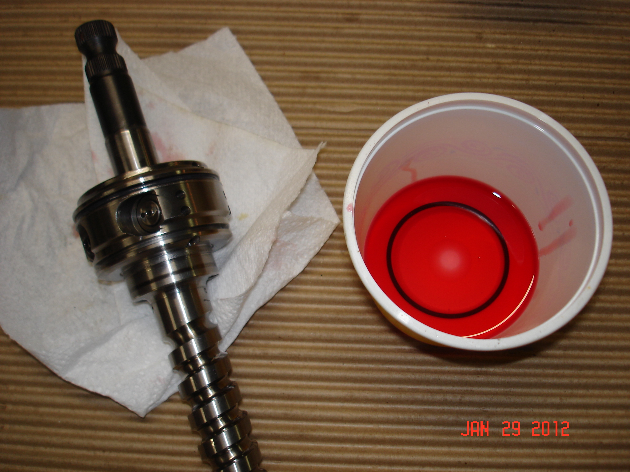

First install the o-rings and seal rings to the main shaft.

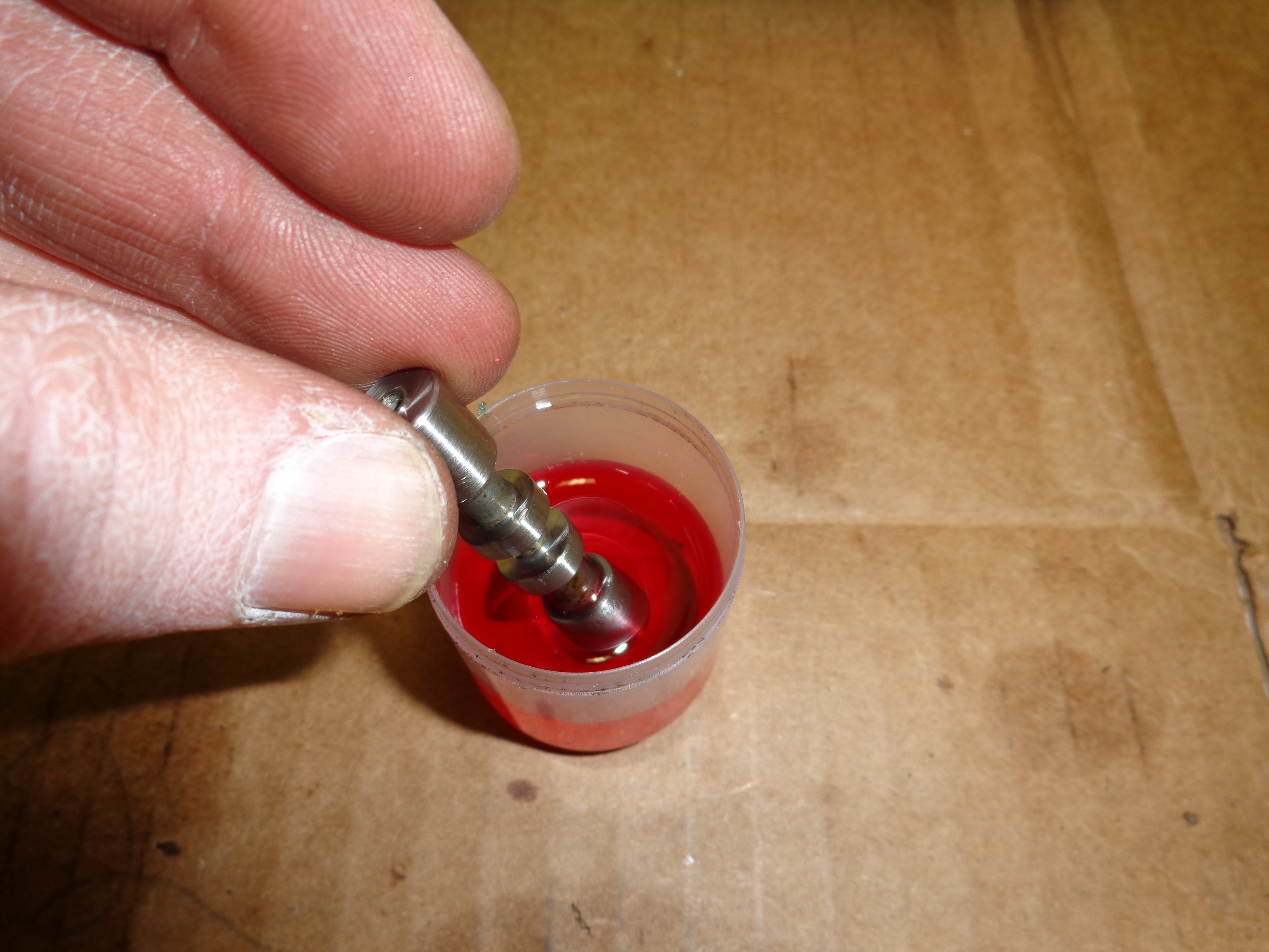

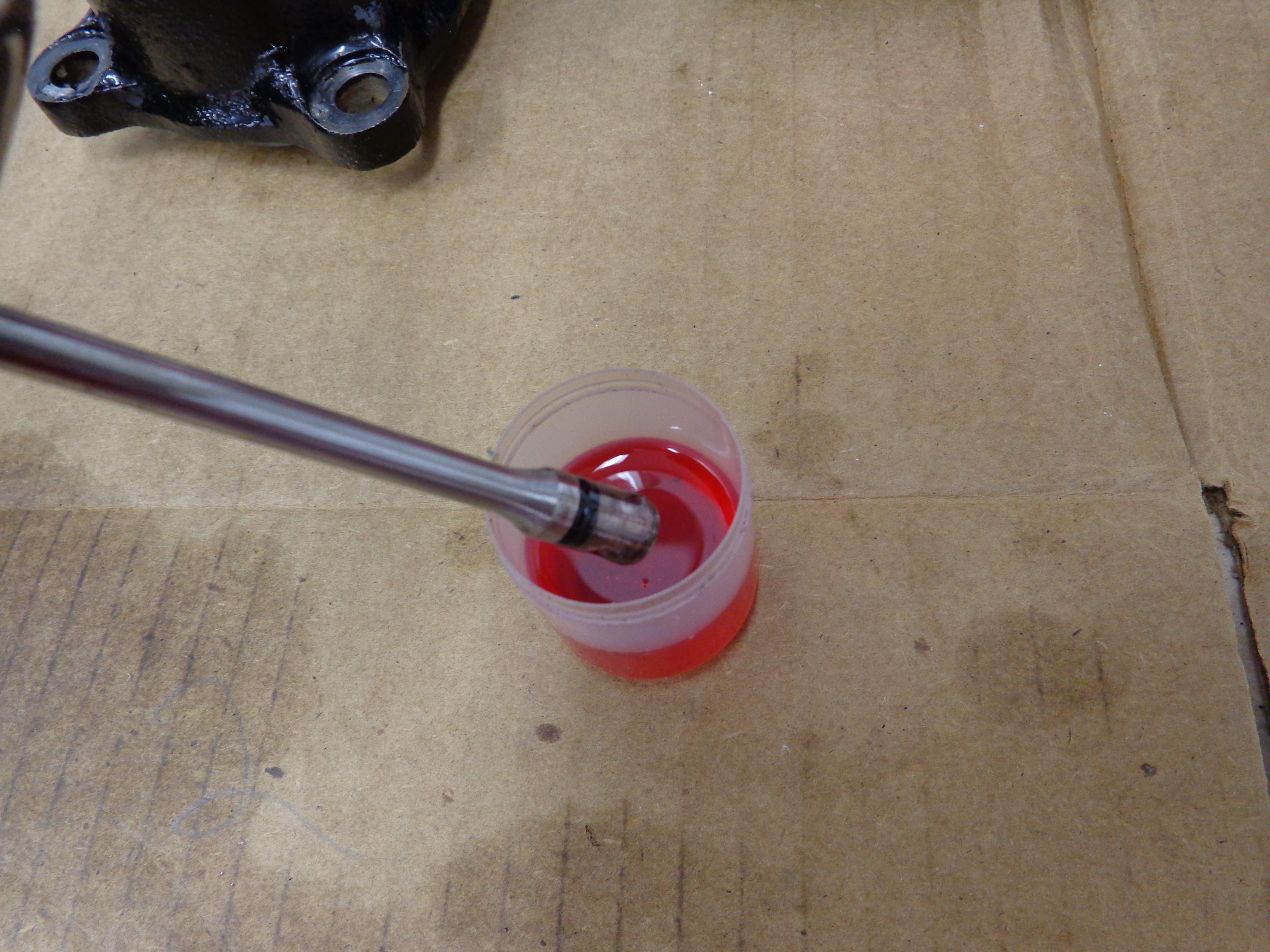

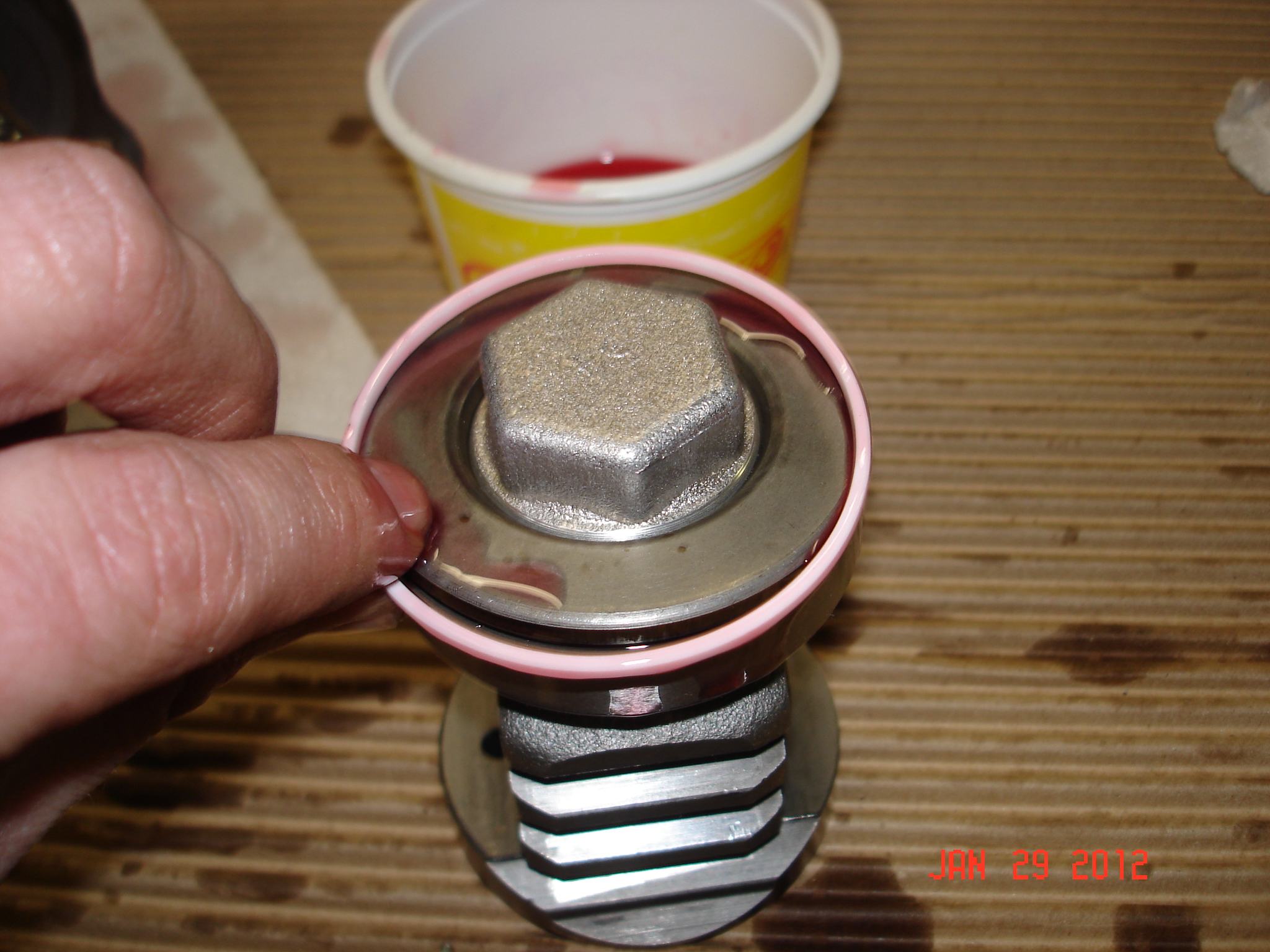

Soak each o-ring/seal in ATF prior to assembly.  Make them nice and sloppy with fluid.
Install the O-ring into the slot groove.  Try not to 'roll' the o-ring on assembly.  Rolling it causes more damage to the ring than carefull 'stretching'.  Take your time intalling the o-rings and especially the seal rings.

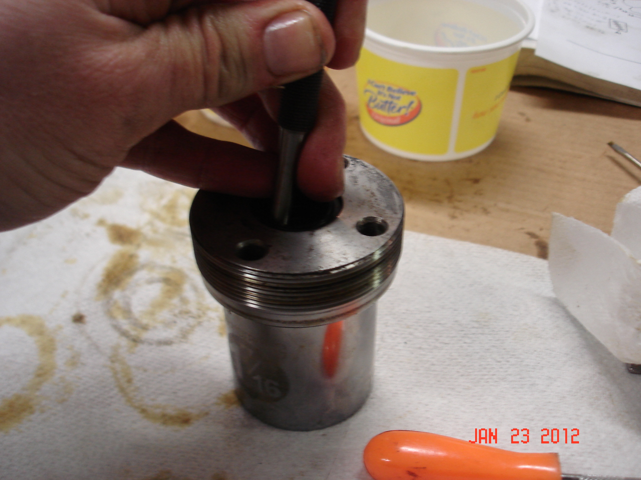

Next, install your oil seal to the top cover using a seal installer (or select size sockets).  Be very careful driving in oil seals...it is easy to damage them.
Now greese her up good.

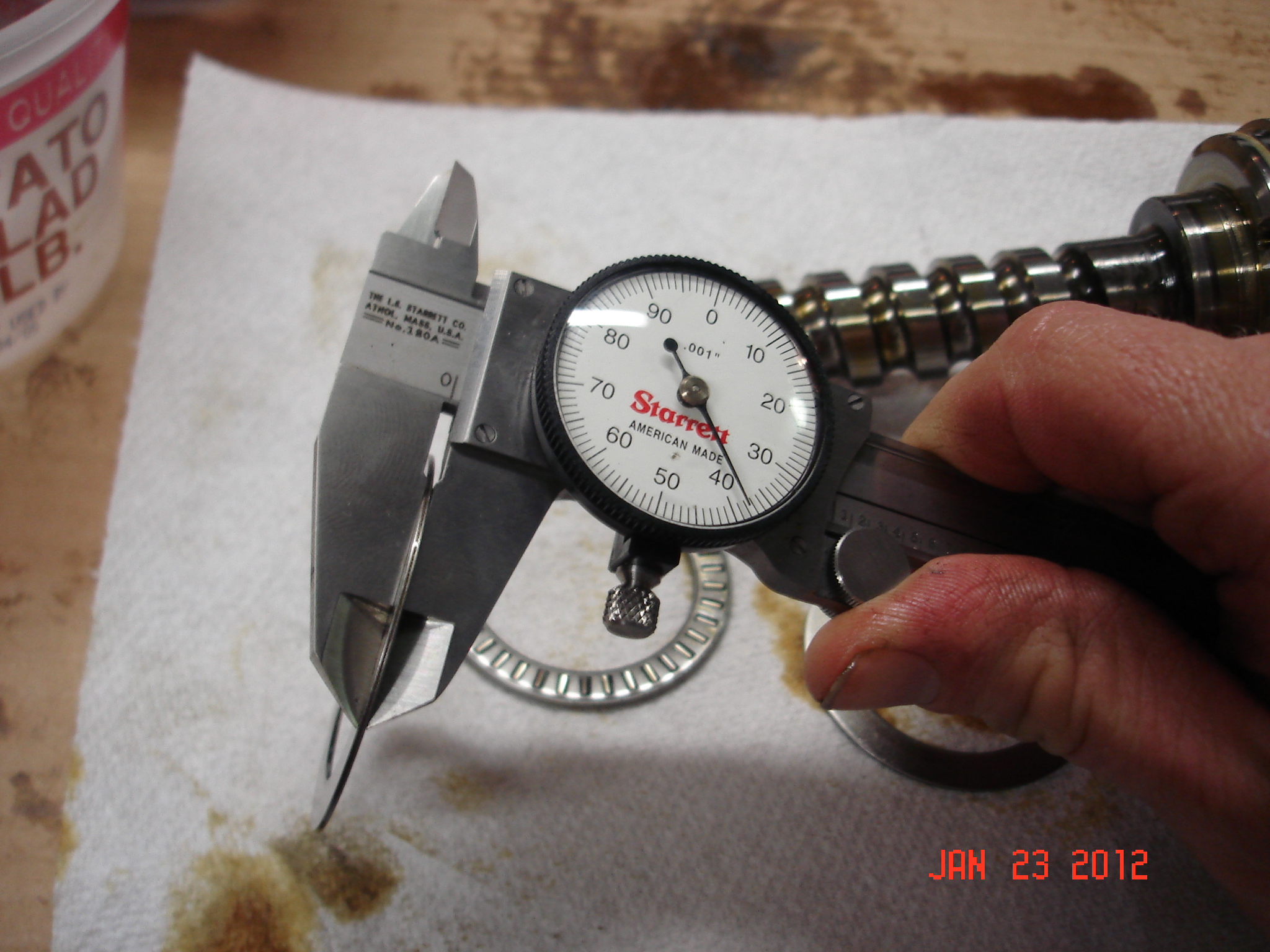

Next; the larger diameter thrust bearing.  Measure your thicknesses and install them onto the top cover in the proper orientation (thicker one goes towards the valve body...I.E. last one installed in this stackup).   Use dab of greese to hold them in place on the top cover.

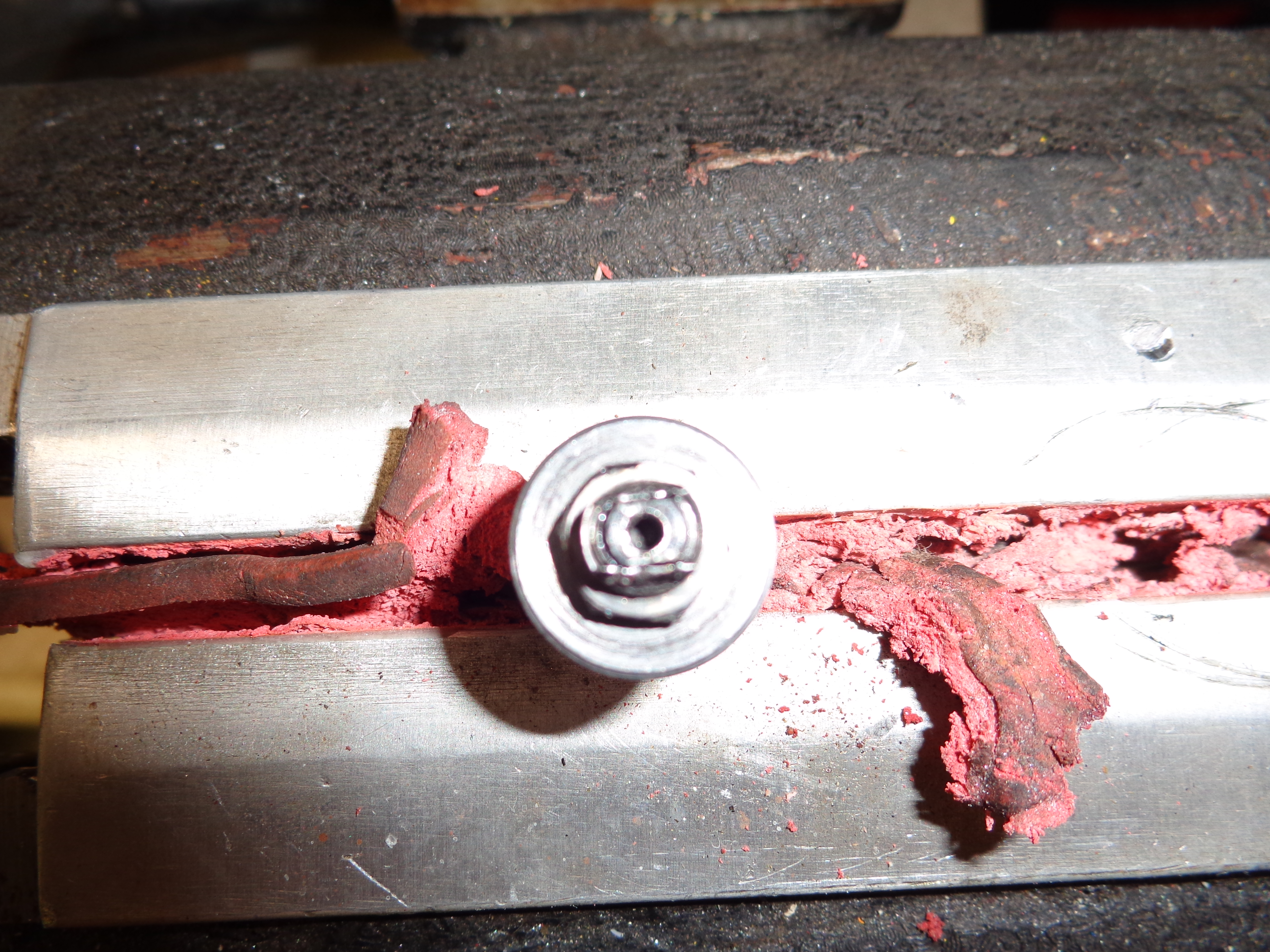

Now...the manual calls for an installation torque to seat all components.  This torque is higher than the set torque will be when done!   The manual specifies the use of a specific spanner wrench and a spring scale to provide 20 lbs of force to the wrench.   Well..it leaves one important factor out...what is the length of the wrench to determine the torque?   I simply scaled the cartoon in the owners manual.  I estimated that the spanner wrench is 6 inches long.   20lbs * 6 inchs = 120 in-lbs...which equates to 10 ft - lbs.   This doesn't have to be extremely accurate...it is just to seat all of the bearings/seals...but needs to be in the ballpark.
I put a bolt/nut on my spanner wrench (borrowed from my angle grinder).   I used this to apply a 10 ft-lbs torque to the top cover.
After you applied the torque...back it off!   It was just to seat the assembly.   Take it about a 1/4 turn back until the top cover spins with ease.
Then tighten the top cover to align your marks!   Check your height and compare to the value you had during disassembly.
Next.  Install the jam nut.  Using your 2.75" wrench, tighten to the marks on the nut align with the marks on the top cover...make sure the top cover doesn't spin during tightening the jam nut.   May need to hold the top cover with the spanner during this.
All your marks should line up good.   Note:  My marks on my jam nut were a little off of the original position.   After spending a few minutes pondering this, I finally figured out the issue...I applied some por-15 on the mating surface of the valve body to the lock nut.  I could have ground off the por-15 to verify but was very happy with the measured height of the top cover in relation to the valve body as well as my primary mark...so I moved on.

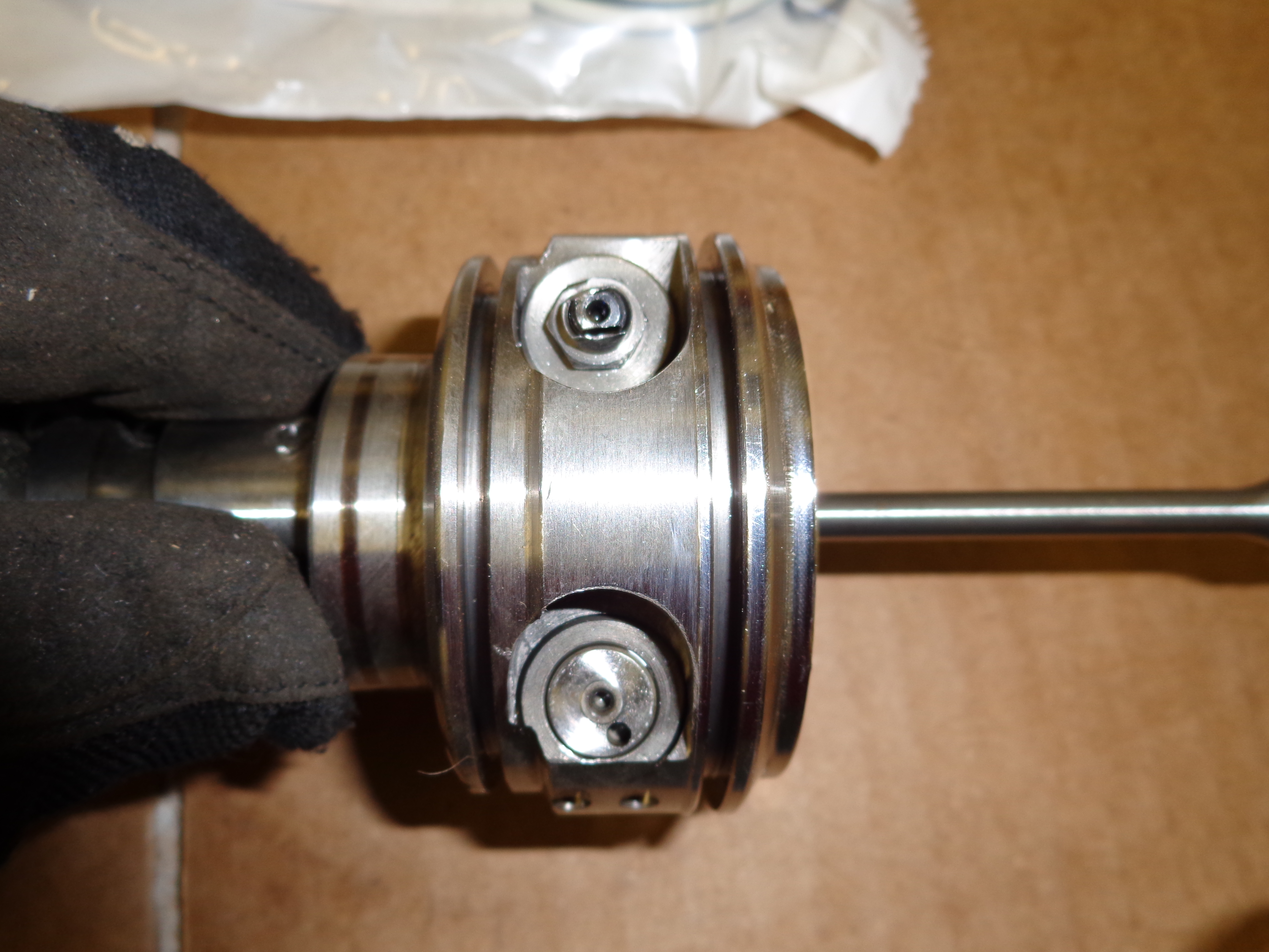

Install o-ring/seal ring onto the piston.   Lube it up good with ATF.

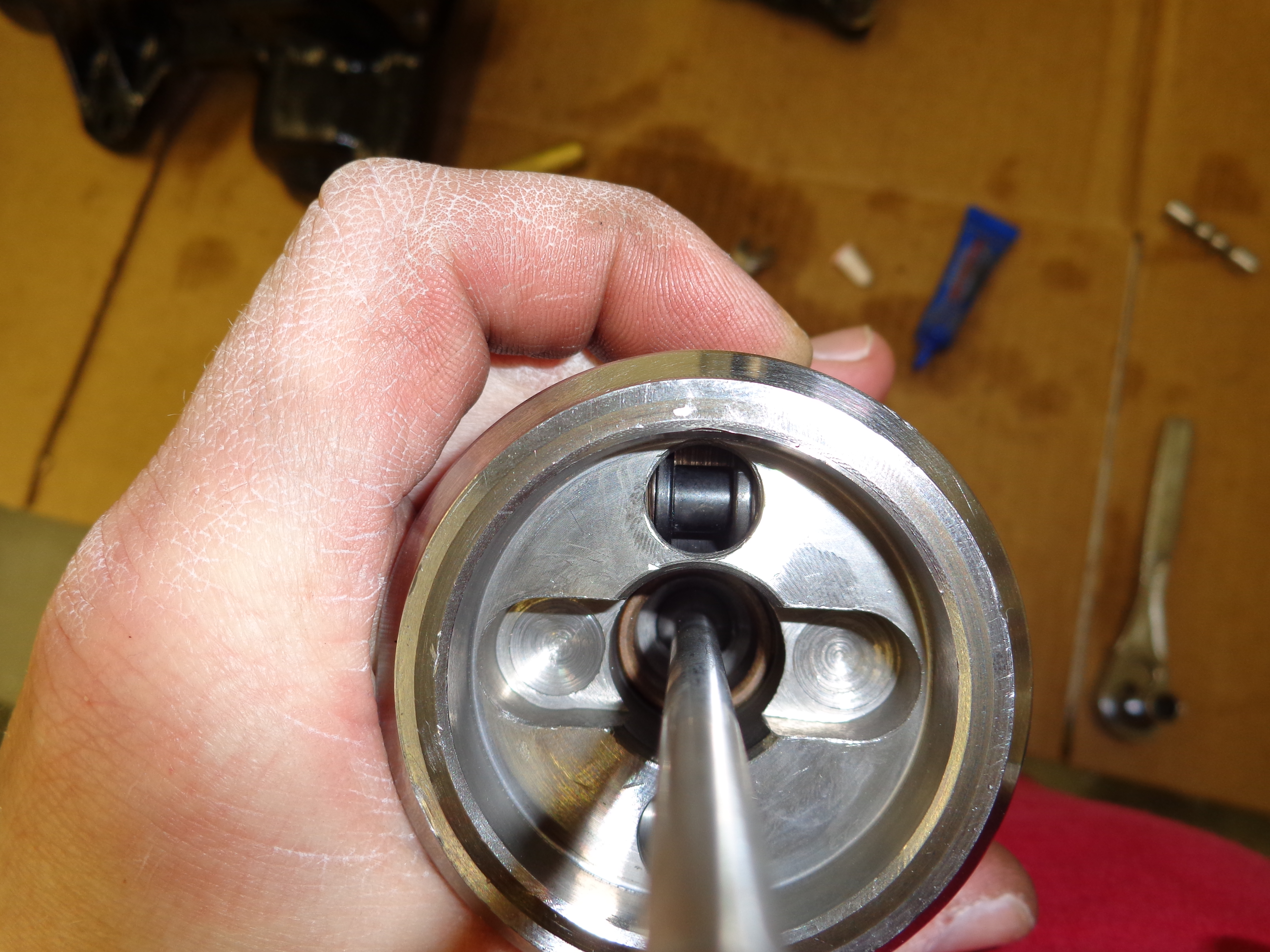

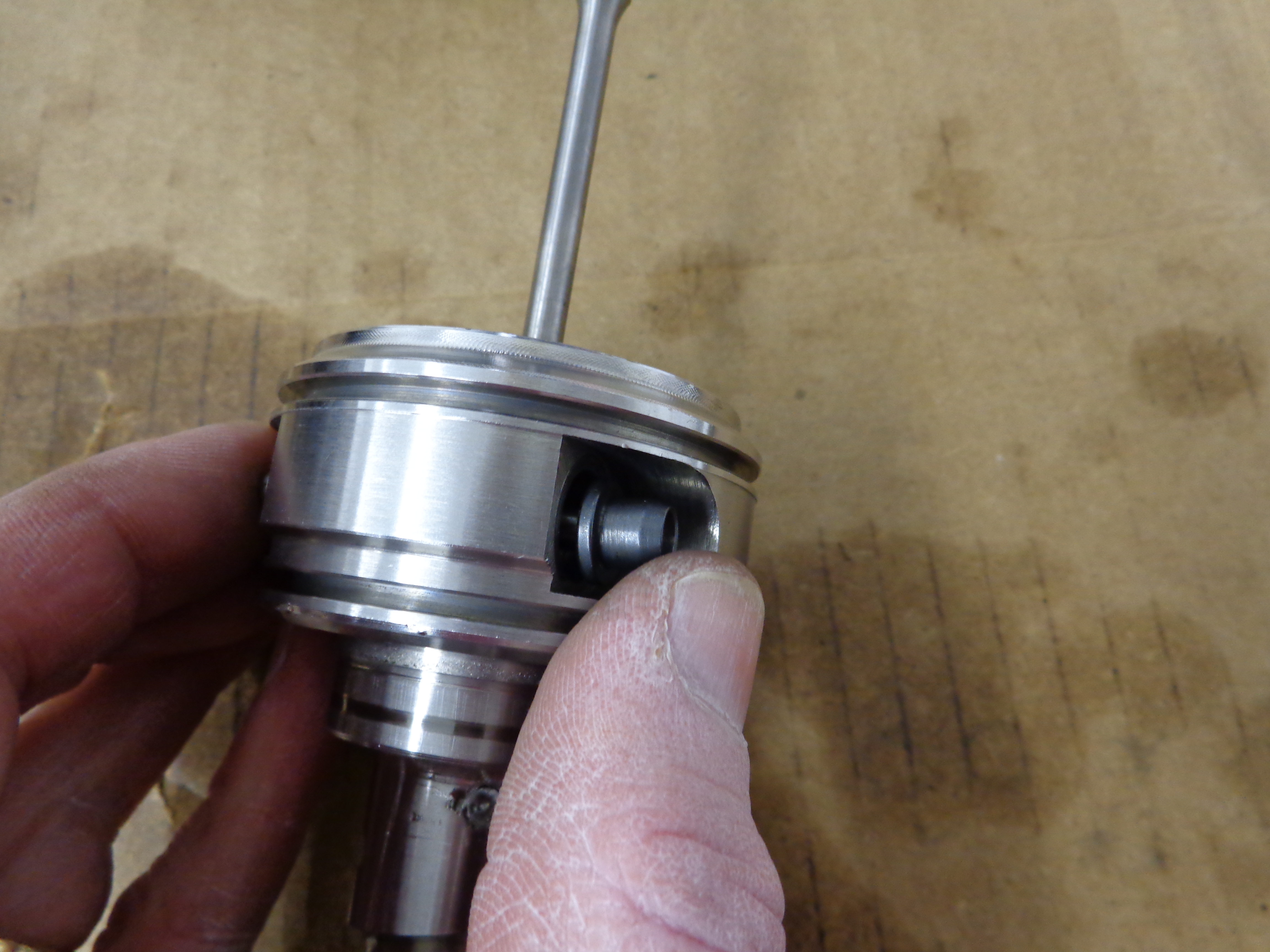

Spin the piston onto the valve body assembly.   Look down in the two holes on the side of the piston until they are nice and in-line with the groove on the main shaft.

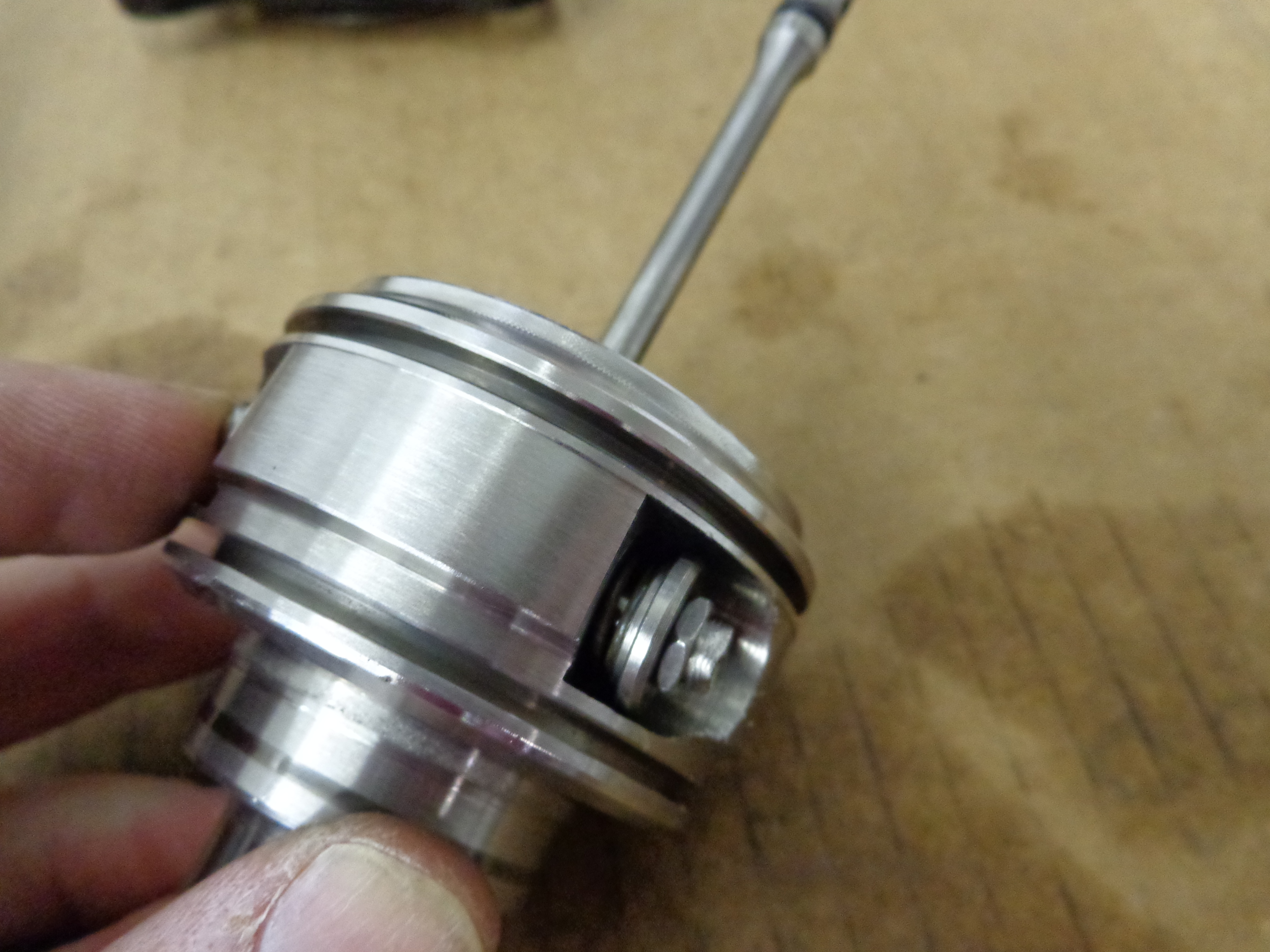

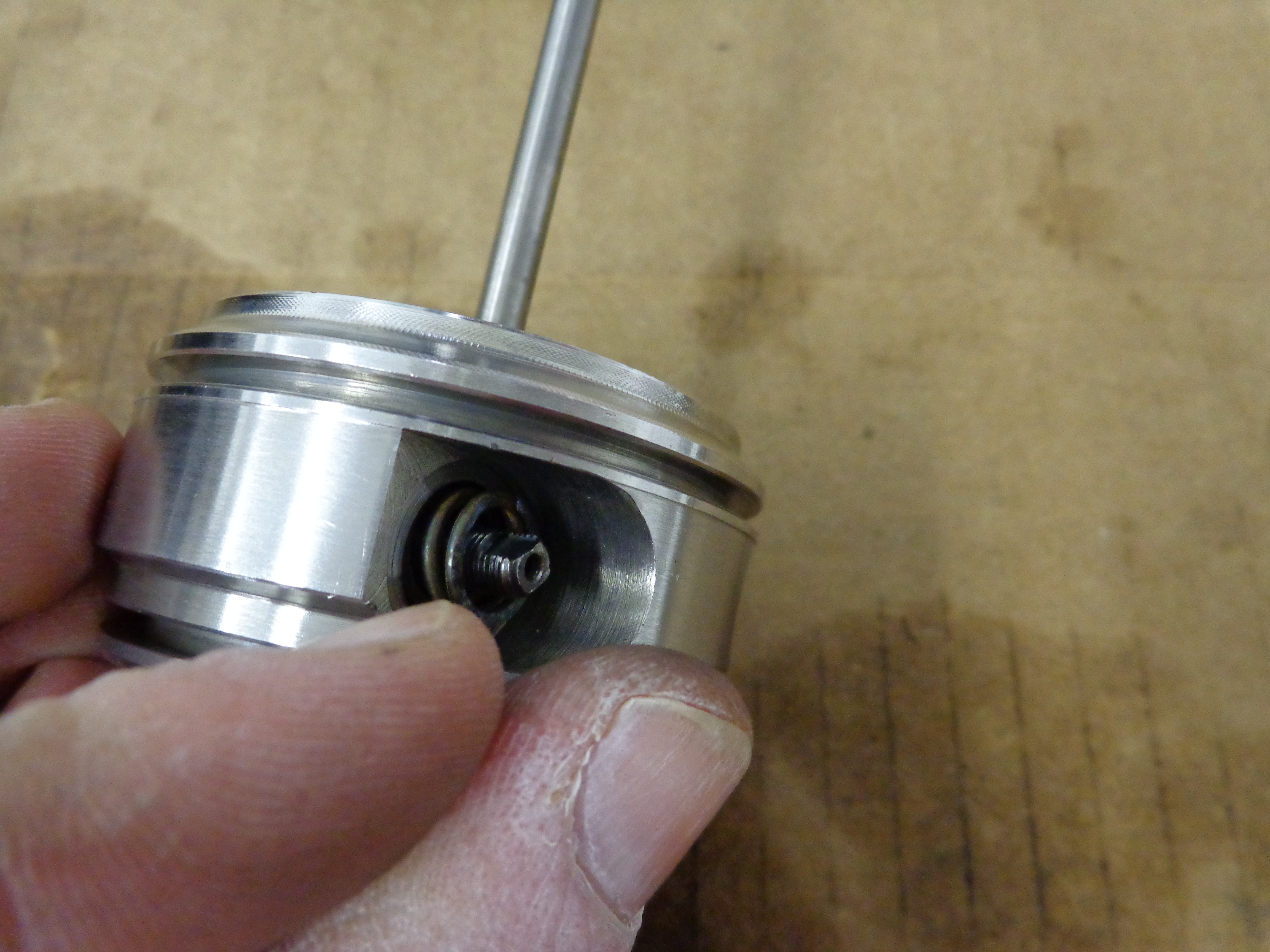

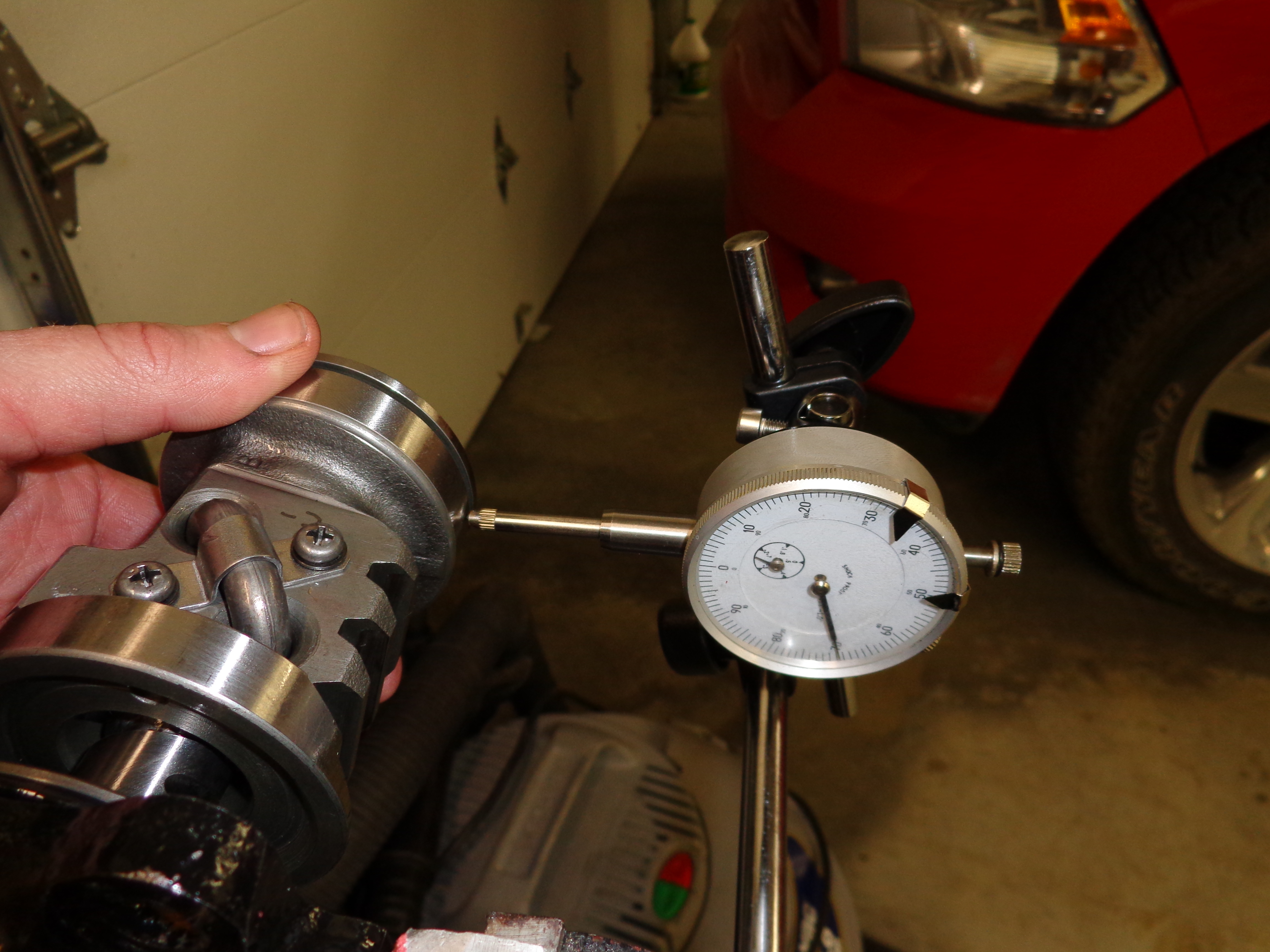

Ok, here is the tricky part...install 19 of the 26 bearings into the two holes of the piston.  You want to install one ball at a time and use a small screwdriver or something to push each one down into the groove.  What you want is to fill the space between the two holes.   This makes sence when you study the parts.   Push the balls in the opposite direction of the notch in the hole for the U-pipe!   If one of the balls goes in the wrong direction, spin off the piston, collect the balls,and start over.
Once all 19 balls are installed...take a measurement from the side of the piston to the leading ball on both holes.  It should be 0.5 inches for each hole!   What this measurement does is prove that one of the balls didn't take the wrong path and aren't captured by the soon to be installed u-pipe.  This is very critical!   You will kill your box within a few minutes if the balls aren't installed properly.

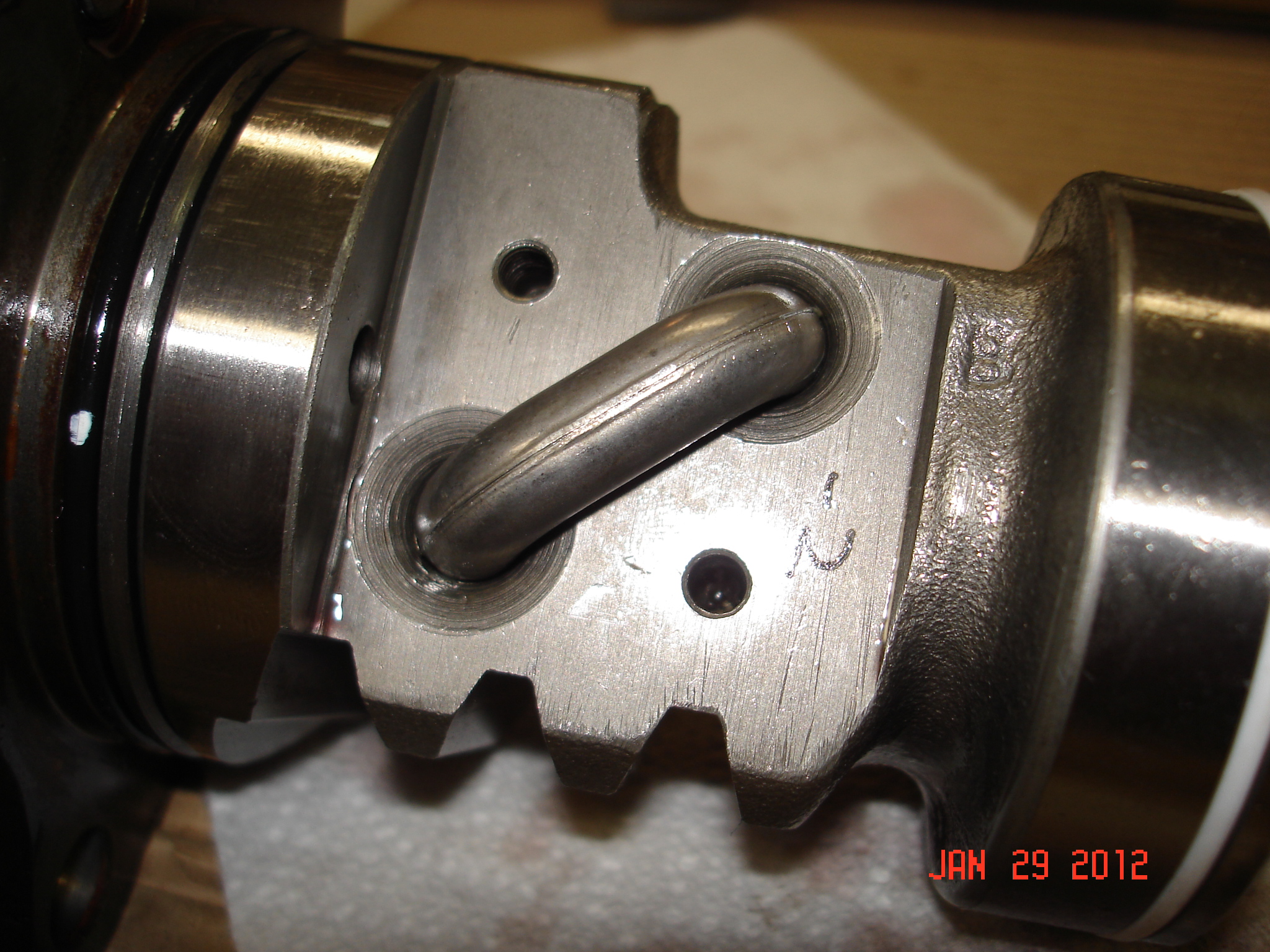

Now take some greese and put it in one of the sides of the U-pipe.  Then install the remaining seven balls into the U-pipe.  Install the other half.
Install the U-pipe..doesn't matter which way.  It performs the same function whether it is 180 out or not.
Install the clamp and two bolts.

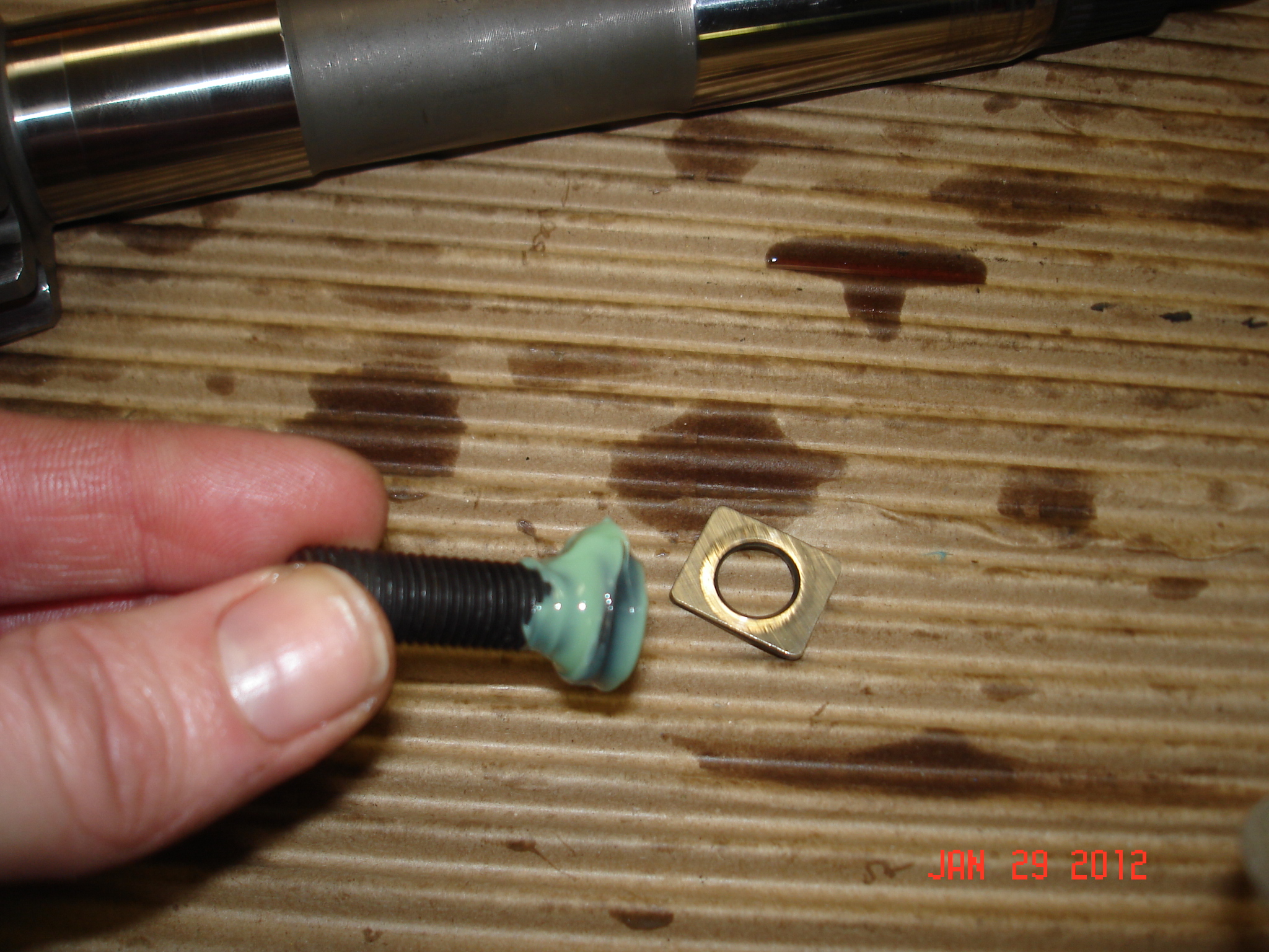

Greese up the stud and shim.
Install the stud/spacer onto the shaft.  And install the shaft assembly to the side cover assembly.
Thread the stud until it has the same elevation as what your records show during dissassembly.  Line up your marks after you are comfortable with the stickout height.

Ok, now install the oil seal onto the box body.  Make sure it's installed in the proper orientation (check your records/pics)
Install the dust seal with the seal driver...note orientation. Goop the seals up really good with greese (greese not yet applied in this picture).

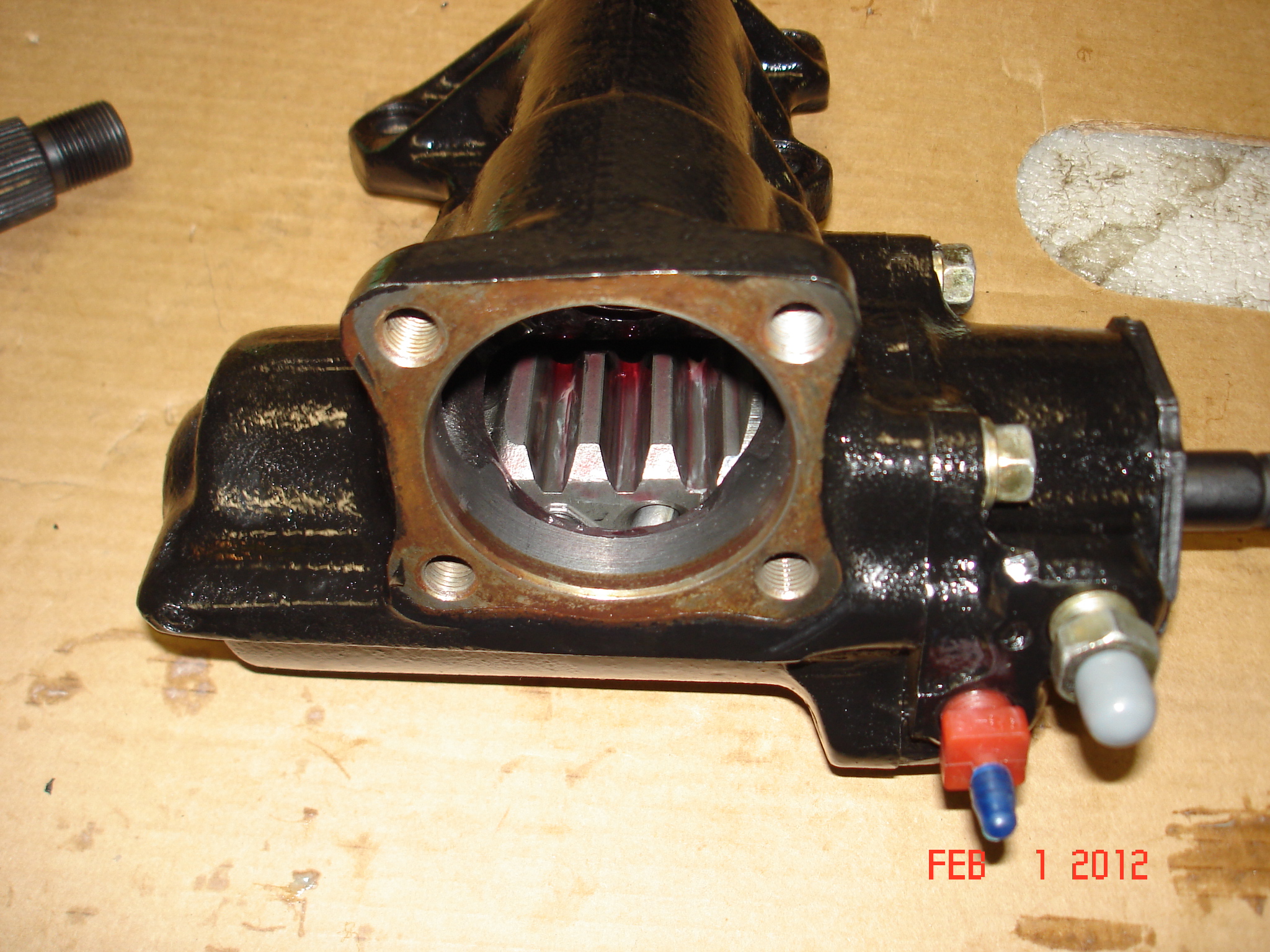

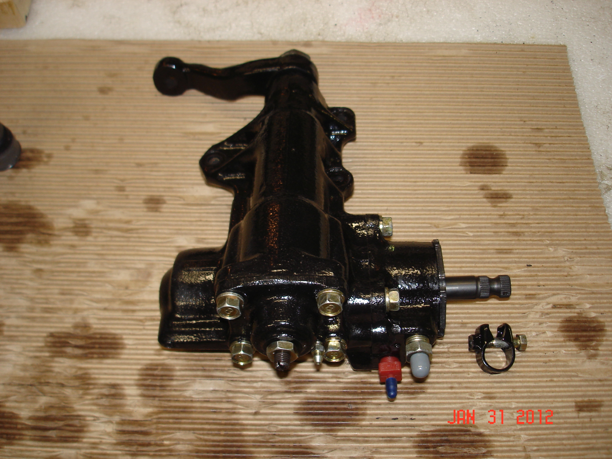

Here is what should be on your bench...two assemblies and the box.  You are five minutes from being done!

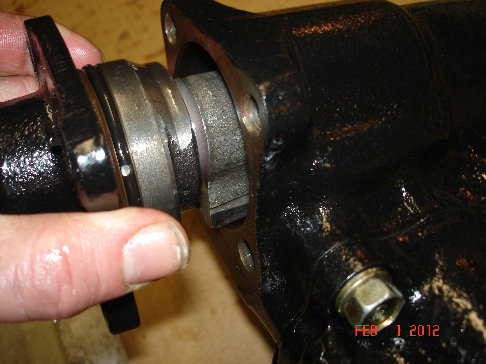

Now install the valve/piston assembly into the box.  Be very carefull during install.  The seal ring on the piston will jam up in the bore.  Take your time, don't damage that seal ring!!!
After valve/piston assembly installed.  Rotate the main shaft until the gears of the piston are centered with open hole.  Then goop up the gears with ATF.
Lube up the shaft really good with ATF.  Line up the gears with the piston and install.
Tap into final position and install your four bolts.
Last.  Install your pitman arm by lining up the marks.  Note: the pitman arm extends away  from the input shaft.   Don't laugh, I've installed it backwards before!
Install the lockwasher and nut.  Torque to 100 ft-lbs!!!!!!!!
Here is the final assembly ready for install.

New Updates (03-26-2015):
I have recently rebuilt another power steering gear box and decided to take the rebuild one step further by disassembling the ‘main shaft’ to access the hydraulic spool. The ‘hydraulic spool’ is the key component of a hydraulic system.   It is simply a piece of bar containing precise notches.  Sliding the spool opens or blocks the pressurized hydraulic fluid to internal passages in the system. In the case of our power steering system, the spool is housed in the main shaft of the box.   The main shaft is two pieces constrained by a torsion bar that is pinned to each piece.   The operation is simple, the steering wheel is turned, the resistance of the tires causes the input shaft of the main shaft to rotate, flexing the torsion bar, a dowel pin in the input section of the main shaft slides the spool over and causes the hydraulic fluid to pass into the appropriate passage for the assist.   It is kind of hard to explain the workings in writing, but if you take the system apart and spent a couple minutes looking it over it will make perfect sense.
In my earlier instructions, I simply stated to leave the main shaft soak in mineral spirits for ~30 minutes.   For the case of my recent rebuilt, the internals of this box were nasty and I wanted to access the spool to clean it up for I was concerned of foreign matter being stuck in the system that I couldn’t remove simply by soaking. Long story short, I determined that soaking it would have been sufficient.   But it was worth the time to fully disassemble the system to learn more about it and aide in the confidence of my rebuild.   Do I recommend that you perform the following?   I can’t really answer that…you can decide. But here goes:
As stated before, the main shaft is two pieces connected by torsion bar that is constrained by two dowel pins.   To disassemble, remove either of the two pins.   I started by trying the internal pin…thinking it would be easier to remove due to a lack of corrosion.  It wasn’t in this case.  However on an old beat up parts box, this pin came out easier than the opposite end.   Here is an image of the ‘inboard pin’. Use an 1/8” drift punch to try to remove it.   Note:  support it better than I did in these picks.   It is a pretty tight press fit plus overcoming the stakes.
After a few blows on the internal pin, I gave up and first corrected my support system and tried the pin on the opposite end.   I clamped two scrap pieces of 2x4s together and drilled a hole down the center.  This made cradles to support the main shaft better.  Moved to the opposite end (in between the splines) and the dowel pin came out with ease. Again, this was not the case on my experimental run on my old parts gearbox…the inner pin came out with ease and the one in the splines wouldn’t move.   Doesn’t really matter which one you pull, you just need one of them out!
Carefully grab the two ends of the main shaft and pull apart…it should separate pretty easily.   Don’t worry about match-marking.  I’ll show you how they go back together.
Zooming in to the torsion bar, you can see a small o-ring preventing the fluid from coming out of the input shaft end.   Be careful not to damage it…it doesn’t come in the rebuild kit.  You can swap it out if you like with a standard size o-ring.  I didn’t.  I simply was careful not to damage it, cleaned it up, and re-lubricated it.  Note:  if the other pin came out, you wouldn’t have to worry about this o-ring.
View looking up at the input shaft.  You’ll see 4 dowels.  The two largest ones at 12:00 and 6:00 o’clock in this photo are guides.  The smallest one, 9:00, goes to the hydraulic spool.  The middle size one, 3:00, goes to the springs.
Looking at the mating side, you can see how they fit together.
A side view.   The little crimped nuts you see are for the spring assembly.  This assembly is simply an aide to the torsion bar to restore the default position.  The springs have nothing to do with the hydraulic assembly.   Technically they don’t have to be taken out but I did anyway. The solid bar is the spool.   Note that on one end it has a small drilled hole.  VERY IMPORTANT:  Record which side of the shaft it is on, it must go back together the same way.

Simply push out the spool. It is best to push it from the side WITH the drilled hole. Take your time, don’t force it. There is a small seal in there that you don’t want to damage..again the kit doesn’t come with a replacement. Pushing it out from the side with the drilled hole minimizes the risk of damaging the seal.
Here you can see the seal. It’s only on one side…the side closest to the spool end with the drilled hole.
Close up of the spool. Note how clean it is from assembly being in the 30 minute mineral spirits bath earlier. But we are here now, might as well clean it up even better.
Now to take the system completely apart; use two 8mm sockets on each crimped nut. One will come free. Follow the pics:
Could stop here, but I took the other end down too…not sure why I did and I wouldn’t recommend doing so! Keep track of the order…want to assemble it exactly the same.

Now soak the stuff in mineral spirits to clean it up further.

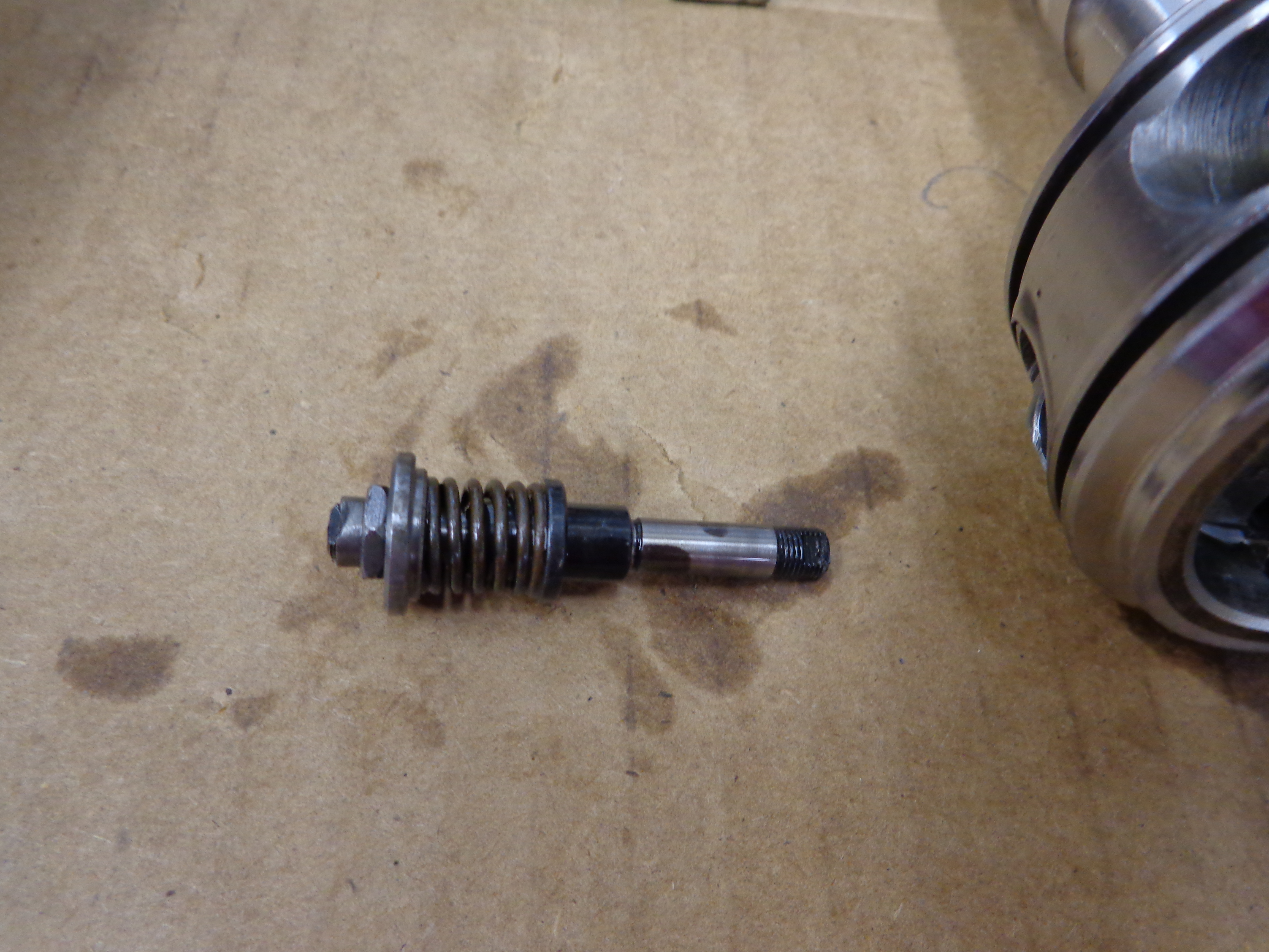

I saw a couple minor marks on the spool. I used a piece of red scotchbrite to carefully clean them up. Don’t go overboard, you don’t want to make it worse. I did the same for the end of the input shaft that fits in a brass bearing on the mating component.
I didn’t take pics, but clean up all the larger parts too in mineral spirits prior to reassembly…self-explanatory. Get it all nice and clean…that is why we did all of this.
Now, let’s put it back together:
I used a little Loctite on the threads of the stud for the spring set up:
Reassemble one end in the vise with soft grip jaws. Tighten the nut until it just clears the end of the stud…no further.
Use a brass punch to crimp the ends like it was. You could wait and do this after in the main shaft but it is easier to do so now…providing you have that crimp cap just a hair below the end of the stud.
Insert it into the main shaft…same side it was on originally.

And reassemble the remaining parts. Put Loctite on the threads on the opposite end too. Just added assurance in case your crimps aren’t strong enough.
Before you crimp, make certain the spacer is pretty much centered in the hole. You don’t want the springs applying load when the system is in the neutral position. On my experiment run on my junk box, I noticed that orientation mattered. If I flipped the stud around and installed it backwards, the spacer wasn’t centered. Thus it is very important that you assemble it exactly the way you disassembled it.
Then crimp the other end.
All of that work to just clean up the springs….probably not worth it…could have left the spring assembly go. But I do believe cleaning the spool was worth it even though it wasn’t that bad. So let’s put it in now. First lubricate the spool with AT fluid.
Insert it. This time come from the opposite end as the white seal. Don’t want to drag that spool across the seal any more than you have too.
Looking down into the shaft
Lubricate that o-ring on the torsion bar and the end of the input shaft:
Put it together carefully. Remember the orientation…small dowel to the spool.
And reinstall the dowel. No need to stake the dowel on the spline end the steering coupler does the job for you…but if you are installing the dowel on the opposite end, make sure you stake it REALLY GOOD using a center punch. Don’t want that sucker walking its way out while you are driving!
That’s about it. Now you have thoroughly cleaned every part of the system and should have added confidence the hydraulic spool won’t stick now during operation (hence the typical loss of power steering on our cars when you first start driving and it is really cold out).
