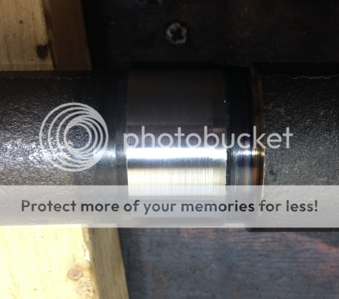

I pulled the chains off and found this:
I also pulled out the silence shaft and am wondering if I'm looking at a BSE for good measure:
I pulled the side cover and the bearing feels even worse.
Edited by mbruneaux, 22 December 2015 - 07:37 PM.

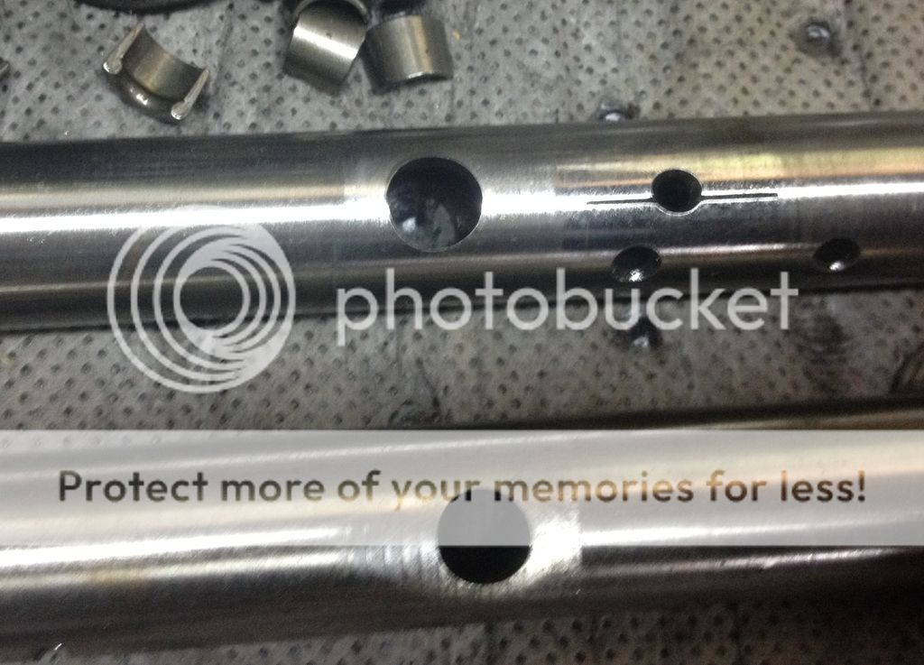

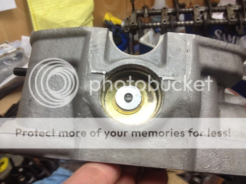

Posted 07 February 2016 - 04:41 PM
I actually got something done!!
Stripped the head
Cleaned all the caked-on crud
Lapped the Stainless Steel Valves
Checked the head an block for straightness and they are both perfect
I tore down one of the hydraulic valve trains to clean it and I found some wear marks that I think make it junk.
I also found on the rear of the head where it looks like someone drilled a hole through the freeze plug and then re sealed it.
The brand new cam is nice and shiny!!  Same manufacturer as the head
