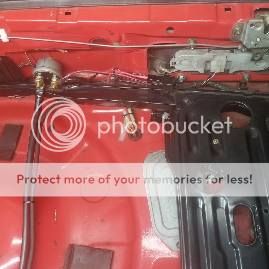

I just did a re-wire on my A1000 pump. I used to have the 30amp relay turned on by the tec2. Then power was sent via the test port on the passenger side of the engine bay. Now i run a 70amp relay with 8ga from the battery to the relay. Then 8ga from the relay to the pump. Turn on or switched is still from the tec2 and sent through the test port wire.

This is the kit i used
