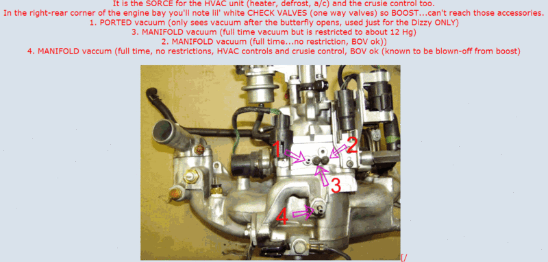

QUOTE (Dan @ Apr 3 2008, 10:53 PM) <{POST_SNAPBACK}>
Does someone have a schematic of OEM before and proven after vacuum line elimination that they can post to this thread? It seems the original poster edited his post and the info went pooof!
Thanks,
Dan
Can i second this?
heh im curious!   :S
#48 Star_V8_Quest
Star_V8_Quest
    Star_V8_Quest
  • Restricted Member
  • 5,438 posts
  • Location:Sweet Home Alabama
  • Interests:No Replacement for Displacement
Posted 06 April 2008 - 06:27 PM
is this what you need?

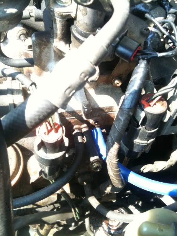

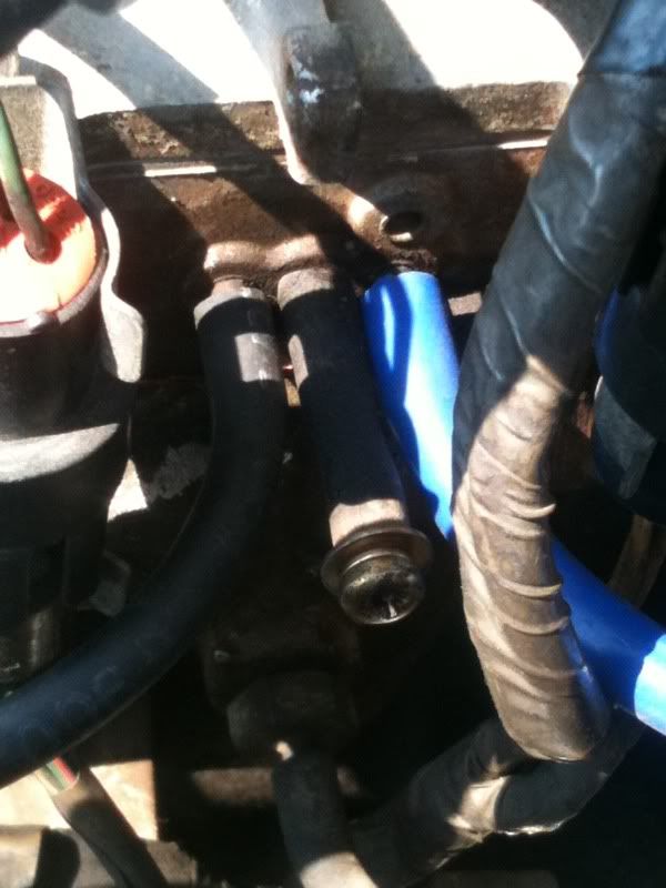

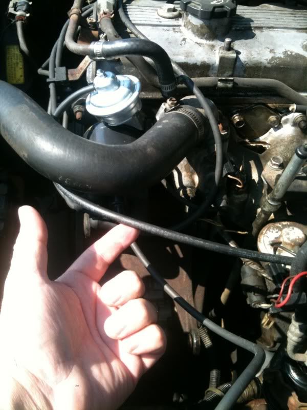

Posted 11 September 2012 - 10:20 AM
Post supplied by 'importwarrier':
This is what i did for my Vac Line Delete my car didnt have AC and it was all removed.Also my car didnt have a charcoal canister underthe air can on passenger side. it was vented in theback near the gas tank. Also there is no BOV so this is absolutly the basic Vac line setup. I was hoping to ADD this to the topic in the Tech section.http://www.starquest...showtopic=28042  The Blue Hose goes to my Boost Gauge on dash. The Center is just blocked off. the Black Hose goes to the Distributor Vac Advance. Below the 3 in a row is the vac line that goes to the Foot FaceActuator for your heater controls. also note the last pic it is #4 if you have a BOV, T off of the Blue vac line shown in the 1st Pic. Thats It.
