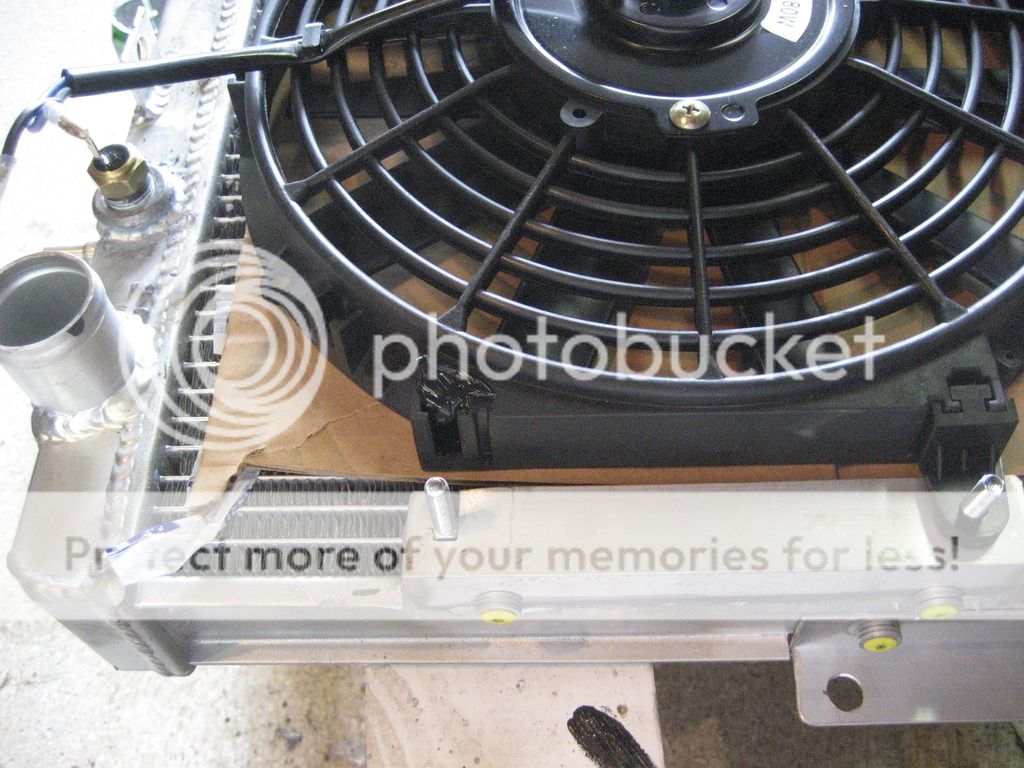

Just got mine in the mail and I'm not happy with it. The thing looks slanted. The core is bent slightly and so are some fins. Did anyone else's come this way? Here's a picture of what I received. Doesn't look as bad in the picture as it does in person

That's the thing about it, it was boxed up pretty good. When i mean it's slanted its like a freaking parallelogram. The box doesn't show evidence of being squished.

I see it. It is out of square. In your picture the top is shifted to the right. It probably pulled when it was being welded. Aluminum moves and pulls really badly when it's welded. Measure across it diagonally each direction, ( top left to bottom right and top right to bottom left) to see how badly it's out of square, then contact CXRacing and see what they say about it. At least then, you'll have actual supporting data to present them with aside from it looking slanted. Hopefully they'll make it right.

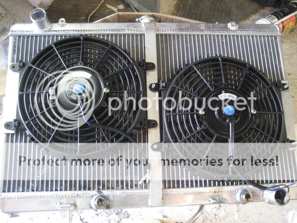

Here's a pic with the shroud on it.
